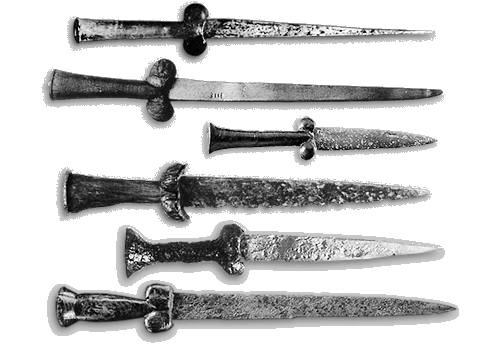

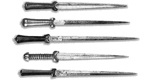

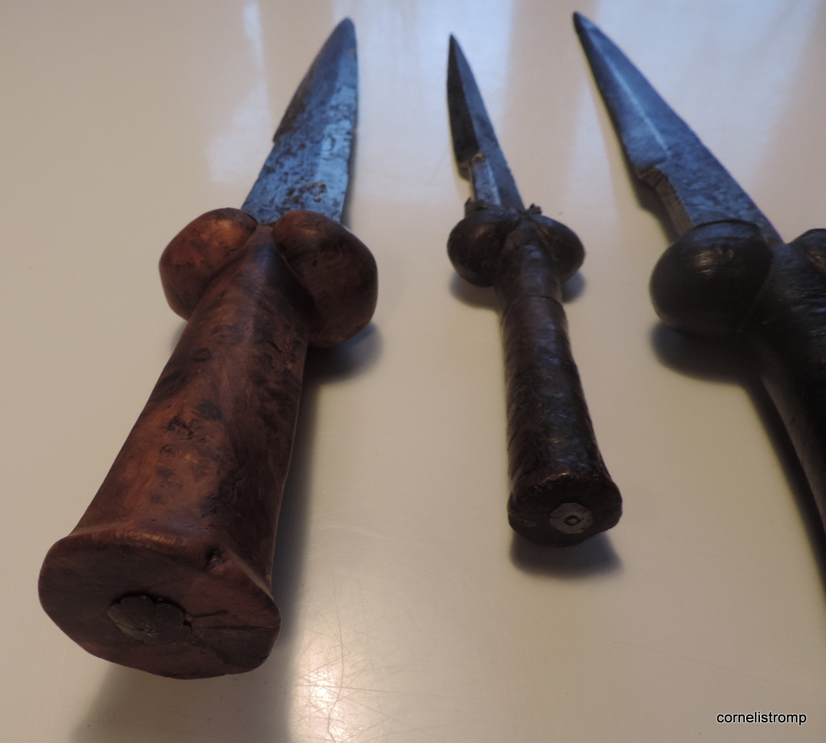

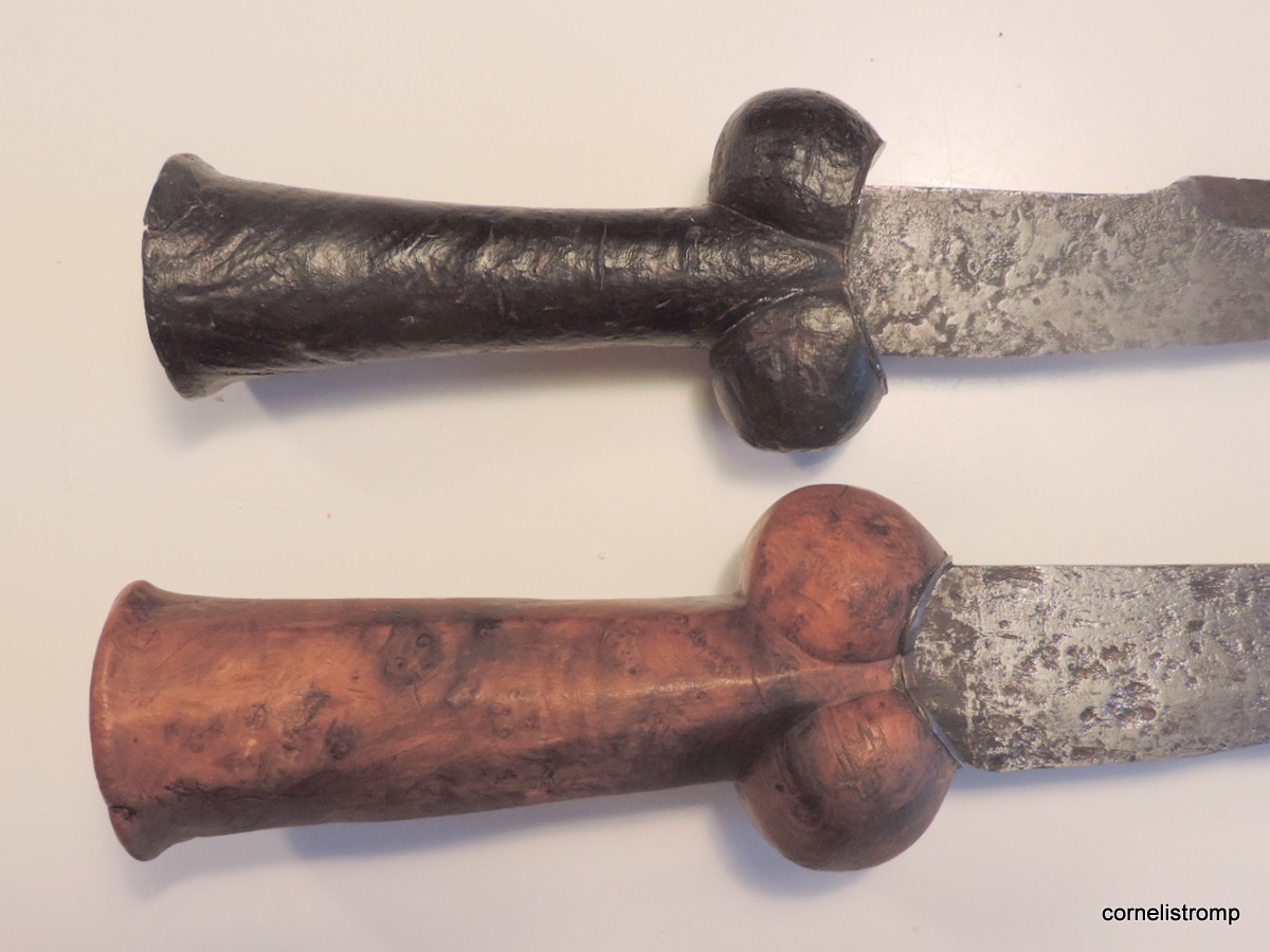

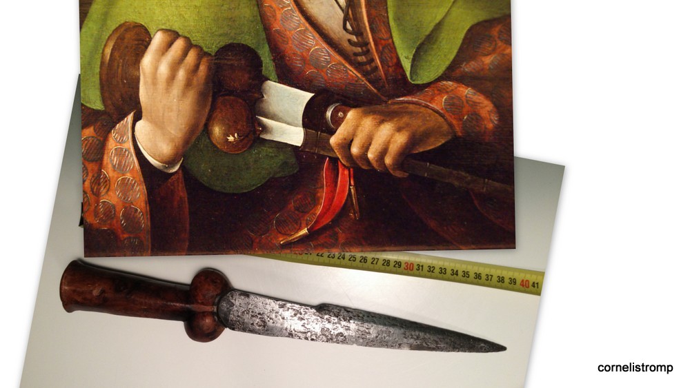

I call this dagger THE Ballock , because it is one of the earliest and perhaps the finest of its kind .
This dagger came between the end of the 14th century and the middle of the 15th century. it consists of four parts;
a burr or walnut often blackened grip outof one piece with two large bulbous protrusions.
a simple guard plate.
a multistage blade often with a reinforced point.
and a washer .
The theory behind this multistage blade is that it has a blunt back and only one effective cutting edge so it could qualify in the early 15th century as a knife and therefor was allowed within the city walls, daggers were in fact prohibited.
The point is reinforced , this has nothing to do with the stabbing through armour (a Panzerstecher) but is for security for the point if you accidentally drop it.
These daggers are immense in size , around 40cm long with big grips.
Of this type are today still examples found in ancient canals in the Netherlands, probably thrown into the water by the city guard.
In art , the finest example of this type can be seen in a painting by Hieronymus Bosch , the arrest of Christ .
very clear is the blunt back, the multistage Blade and large bulbous balls.

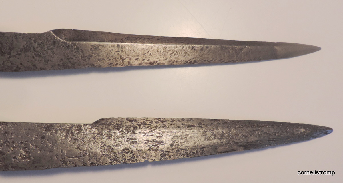

herewith three exemples from my collection.
best,
jasper

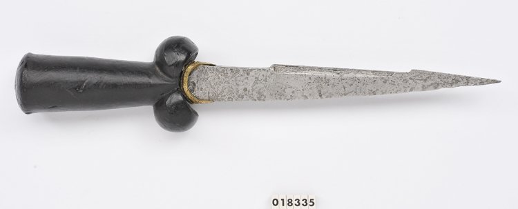

Here is a ballock dagger of the 15th century possibly found in the center of Hamburg, Germany. At display at Museum für Hamburgische Geschichte (hamburgmuseum). Unfortunately there are no further details available as it is an old archaeological find without written record.
thank you for the example, precisely the same type.
nice to see the dating, 15th century
Heribert Seitz dated this type in Blankwaffen I, end of the 14th century .
I think this is probably on the early side, this type occurred between 1390 and 1460.

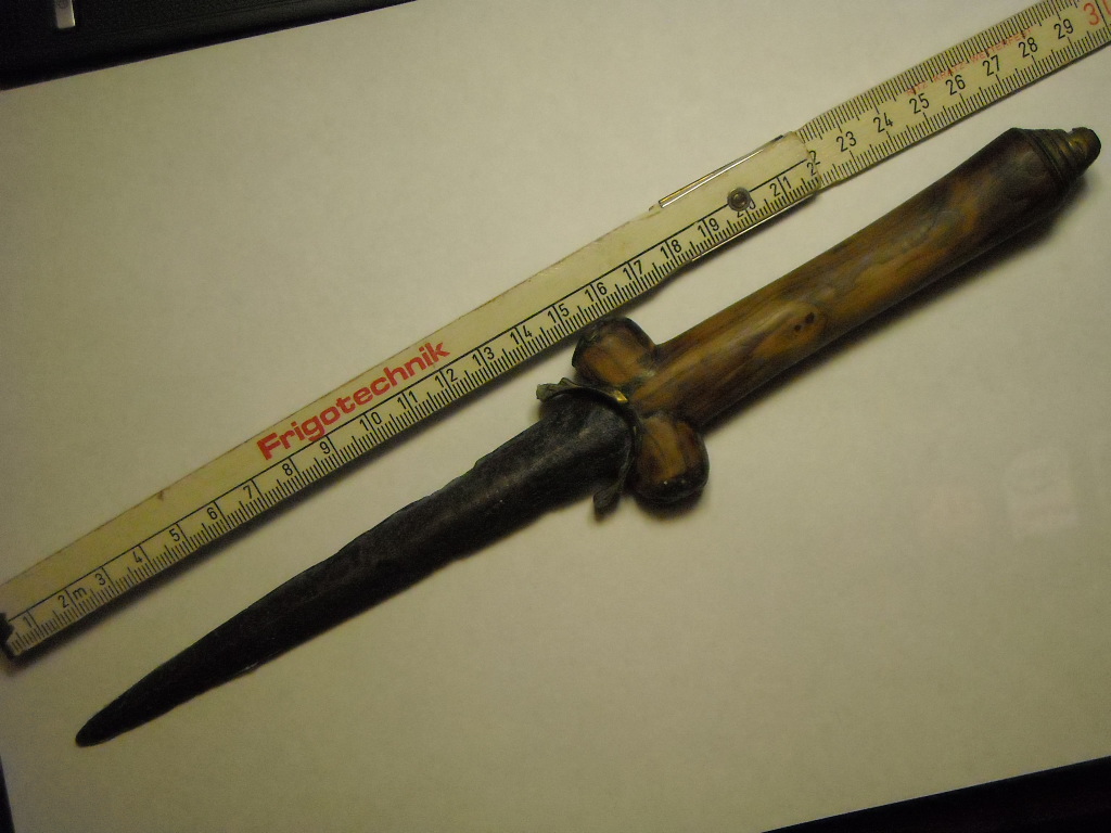

Default mine

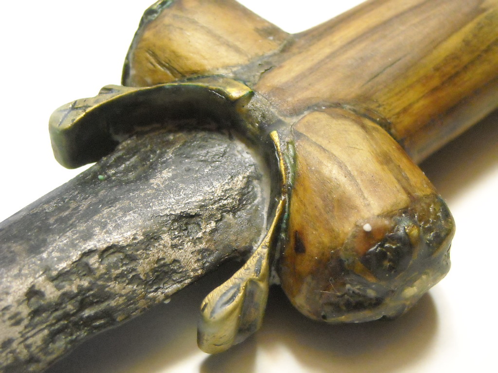

so I like to share mine as well.
It s one of the shorter ones and has a type of composed grip ending in some brass plates. The quillon / guard is decorated with some carvings and the ballocks with a sun or star shaped.
The item was found in Rotterdam, what the seller told me.
junker is offline   Reply With Quote

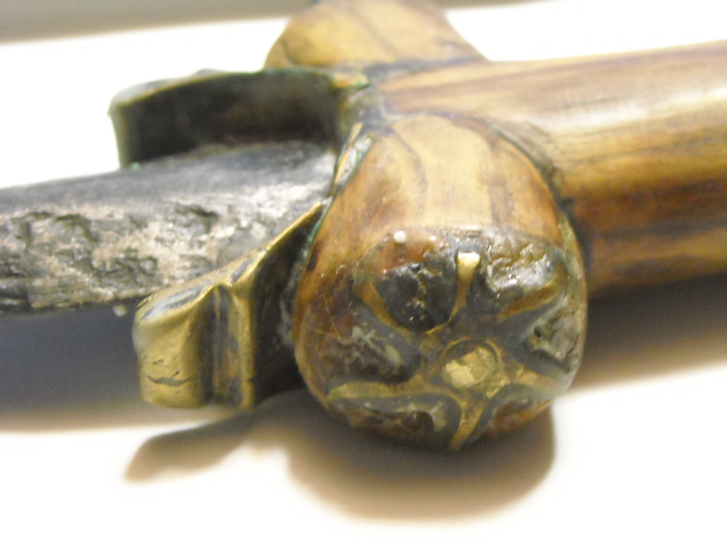

Hi Junker,
thanks for the nice example, the grip seems to be a (later) restauration but all the brass parts are Original around 1450.

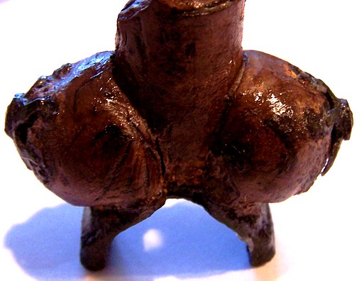

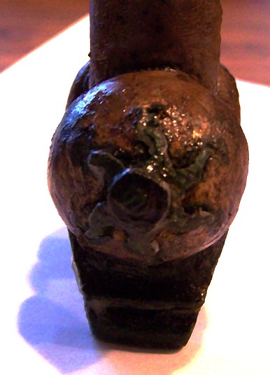

here's a picture of a similar excavated grip with balls with the sun, as seen on the painting the arrrest of christ.
best,
jasper
cornelistromp is online now   Reply With Quote
Old 13th February 2014, 10:34 AM   #11
junker
Join Date: Dec 2009
Posts: 140
Hi,
the grip shoud be the original but it is to much restored.
Thanks for your picture with the grip and sun.
Is it also from the netherlands ?
Dirk

Originally Posted by junker
Hi,
Dirk
Hi Dirk,
yes found in the Netherlands, exact location is unknown to me.
The reason I think the grip is redone is because all ballock daggers have a grip made ​​outof one piece of wood.
when you see the grain at your dagger, the protrusions are glued to the handle.
further, the protrusions are not ball-shaped and the recess in the brass parry rod does not fit exactly appropriate the wooden grip between the balls. at your dagger the recess is smaller.
please compare other Ballock daggers for this.
The wood used here is also unusual for a ballock.
best,
Jasper

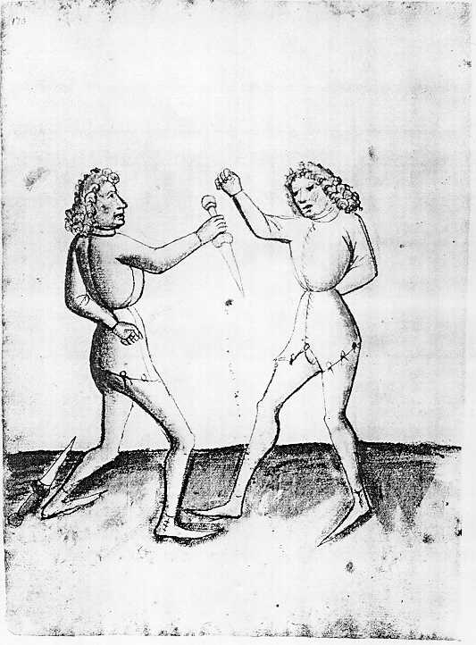

Meanwhile three pictures illustrating medieval art which includes bollock or ballack daggers...or variants.

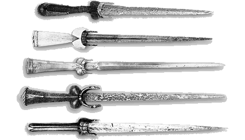

and I thought to include a few more...The first picture shows a set of differing styles for comparison...Of special interest is the fragmentary set of Bollock daggers from the Mary Rose, and the amazing stone relief showing the knight with his hand on dagger.

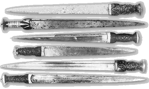

Default The Dirk Development from the Ballock.
More Bollocks....
It can be seen that the Ballock dagger gave rise to the Scottish Dirk as worn in the portrait by Painting below of George Gordon, 5th Duke of Gordon (1770–1836) in highland dress. The two lower pictures show Dirk development in the sketch and the photo shows Dirks....
Please see my main reference on this subject at ~ http://www.myarmoury.com/feature_spot_dirks.html for an excellent review of Ballock and Dirk daggers.
Ibrahiim al Balooshi.

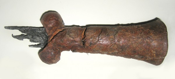

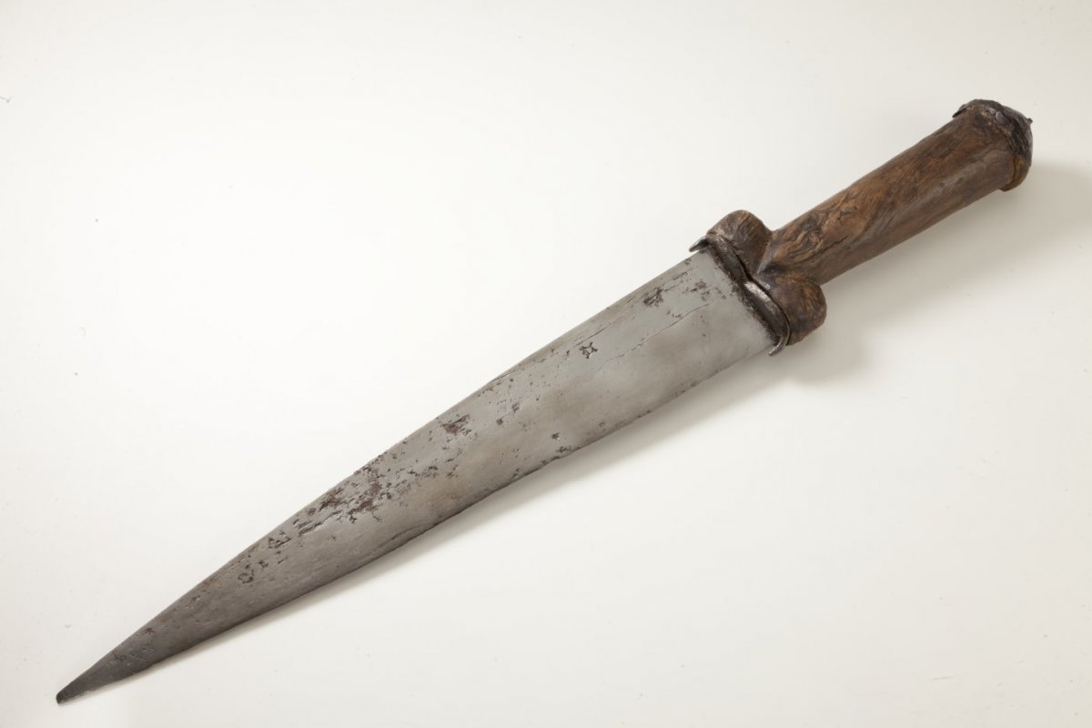

two ground finds from the Netherlands of this type

thus etching and drawing when, where and by whom. Bottom find the site,(tomb) effigy the person and place and so on.

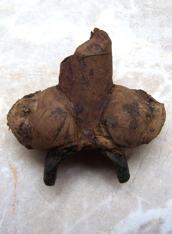

these english ballock dagger grip artifacts are discovered in 1971 in the mary rose warship wreck. they are of a different type as the continental daggers under #1 and also of a later date; first half of he 16thC.
They have a simpler blade geometry, 3 planes.
this type has more the shape and appearance of a phallus than its predecessor, the type was also popular in the Low Countries.
See an archaeological discovery from Netherlands, Dronten, Flevoland 1971
In General hard burl wood remains remarkably well preserved in the soil and water, fe all three daggers in post # 1 are finds from Netherlands.
the wooden grip still has the smell of cigar boxes after 600 years.

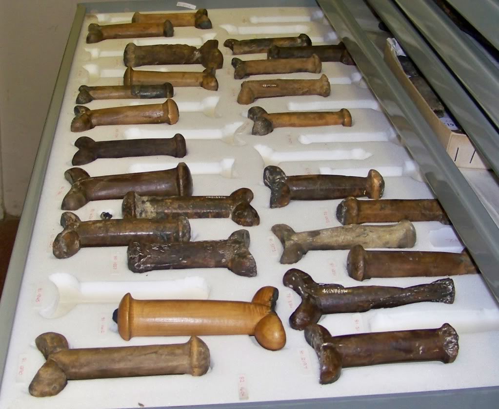

I was hoping for more examples and details of this specific type.
(attachment is from collection of Dutch army museum)
best,
Jasper
