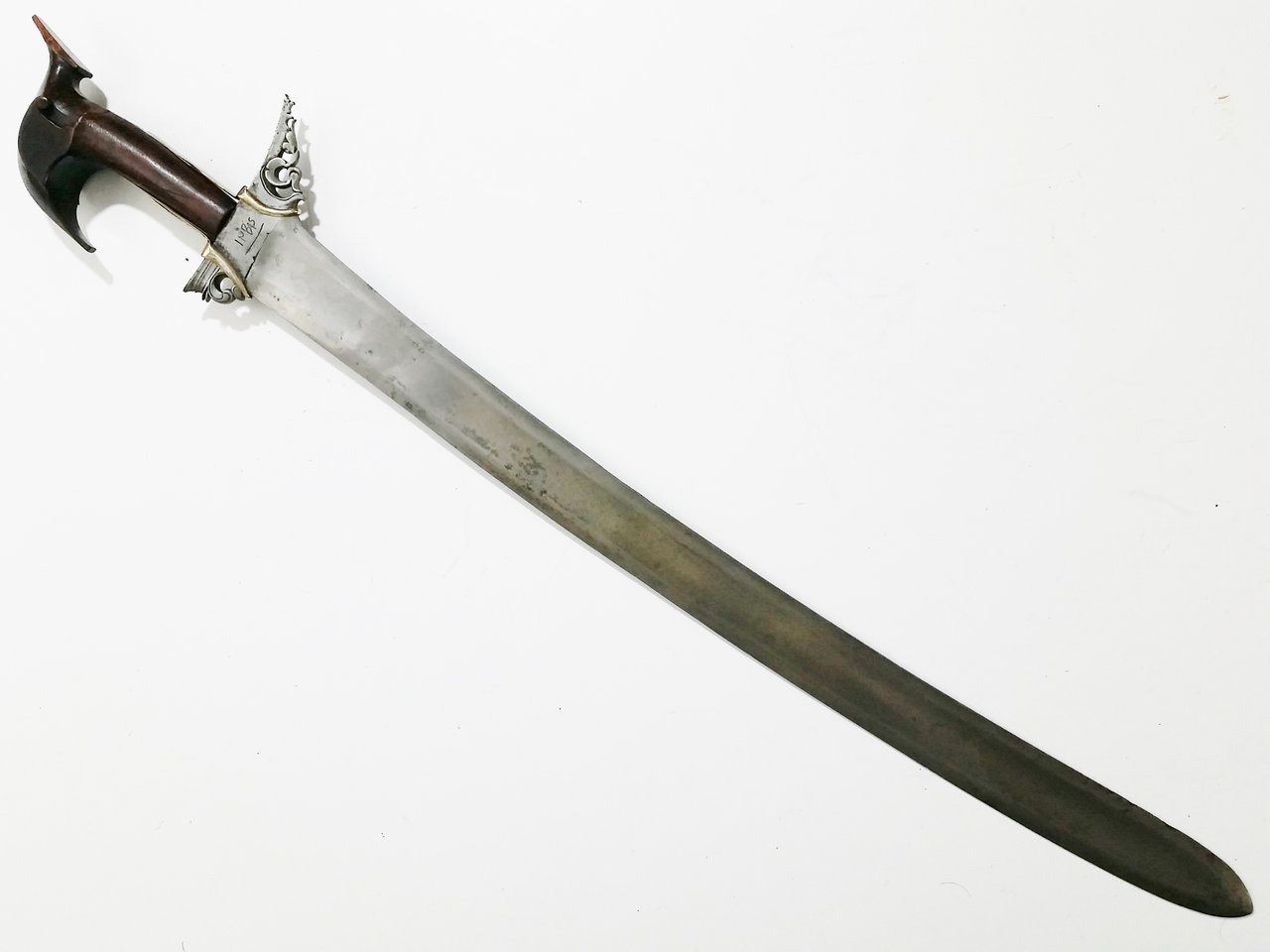

hello,

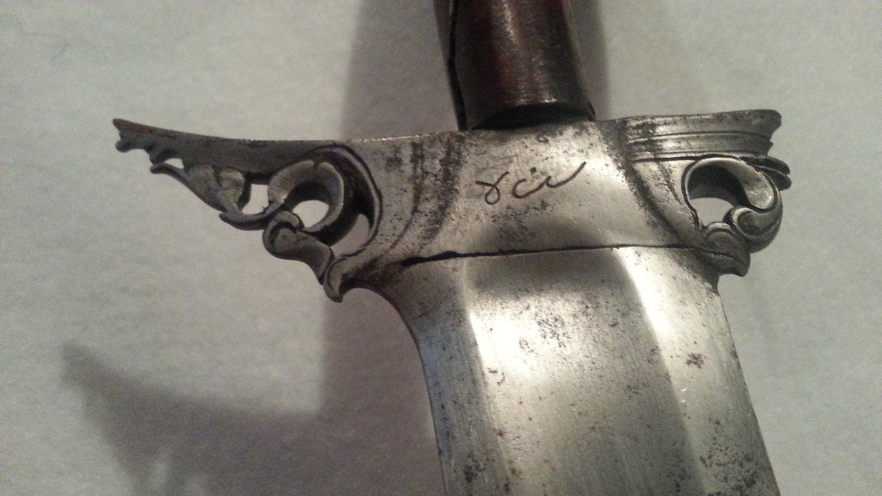

i was wondering if someone can help me translate the inscription on this particular kris. it appears to be arabic script, but most probably jawi. thank you in advance

At first glance, I thought the hilt's orientation was wrong.
The curve of the blade seems to go the opposite way or is it just the photo. What a nice Kris!!! Congrats Bro. Sorry no translation from me. |

Well, my goodness...just when you think you have seen all the variations...
More than the translation Ron, i am really curious what you think about this blade. Origin, time period... Very interesting to say the least...

thanks kino!
David, it's an unusual one, alright. as far as age, i believe it's an older piece. what i like about it, is the blade. it's hard to assess based on the picture, but it's actually a variation of the saber kris. although the blade does not have the relatively typical shape where the lower blade edge sweeps to meet the upper edge, it just feel like a saber, meaning, when i swing it side to side, you can feel the blade sway. yes, it's that thin. also it would explain why the curve of the blade goes the opposite way. i know we discussed about restoration vs. recreation; i think this is one of those where i can add the asang2x safely, then re-wrap the handle. if i can get the script translated, it might help where the blade is originally from. |

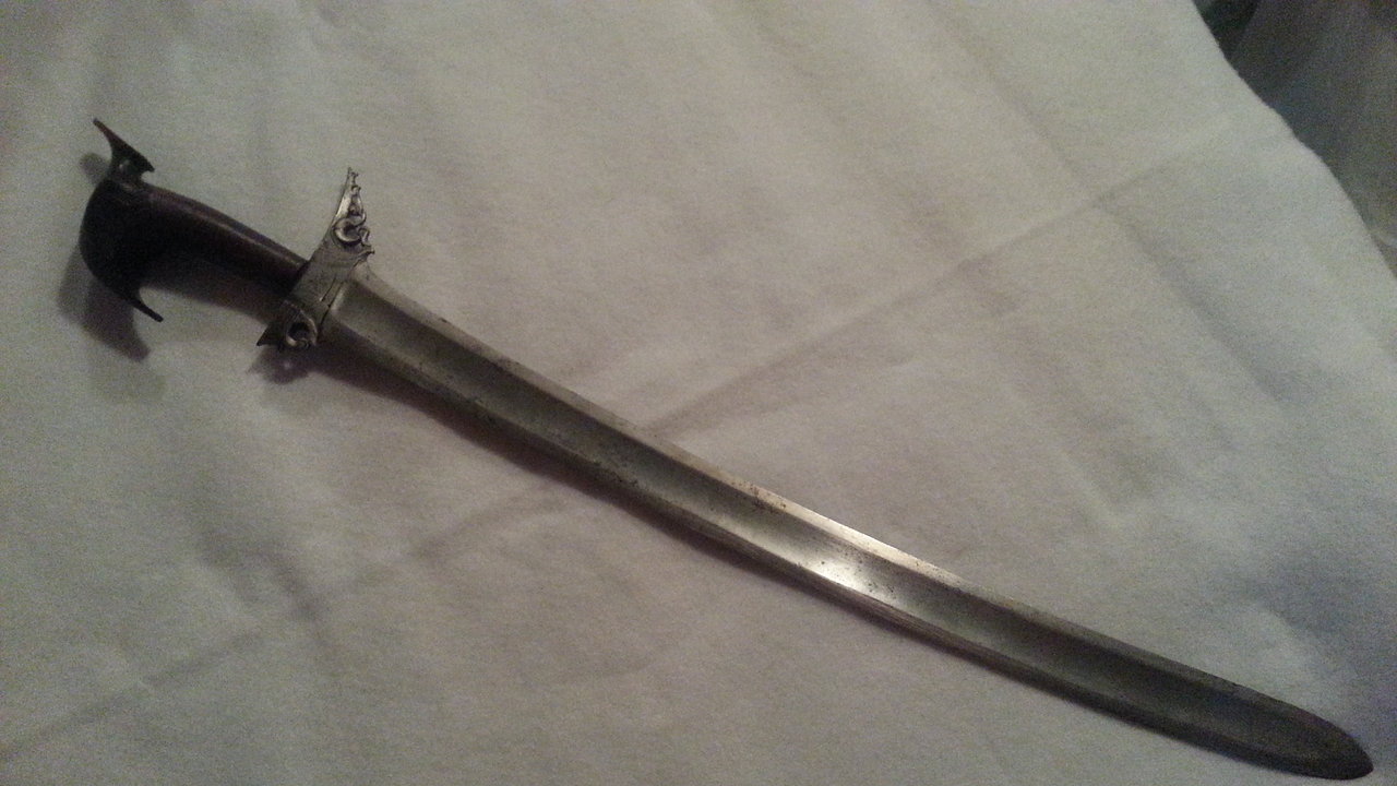

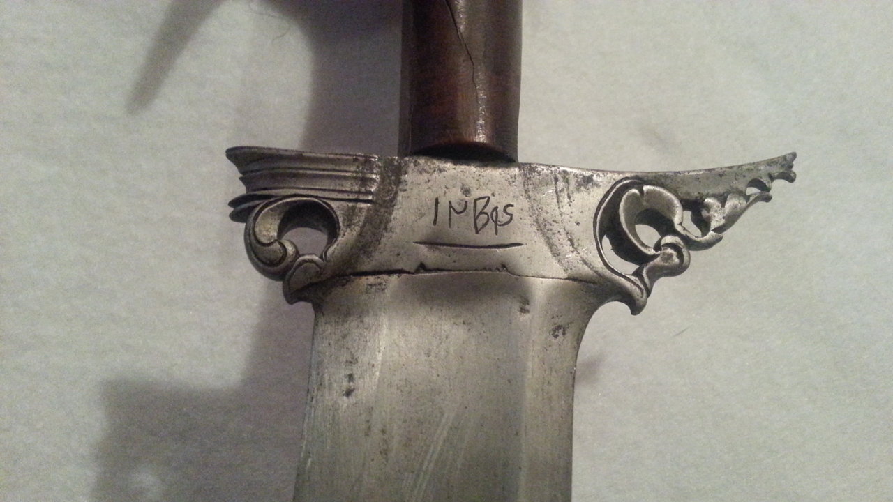

Oliver, thank you once again from for your help! as far as a significant event:
the Moros of Mindanao were not really into commemorating a particular event or occurrence, and if they did, it did not carry over when they got assimilated with the rest of the archipelago. good point as well, in regards to this particular piece being from a different culture (i.e., Malay). i can't think of any other reason on why the date would be there. perhaps someone can chime in? kino, the only progress i've so far is having a couple asang-asang added to it by Jose. can't find the time to wrap the handle up. maybe this fall? here are some pics... |

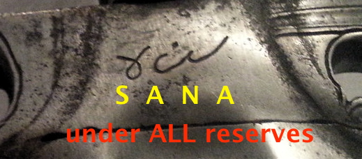

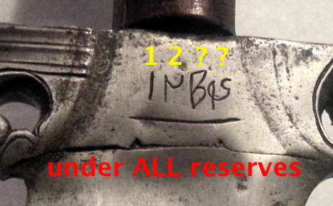

Join Date: Oct 2005
Posts: 1,142
the Arabic writing, seems to be Old Malay script, nevertheless, but under reserves here what we have decrypted S A N A (letters not sticked to each other) either YEAR but under reserve 12 ?? may be the date ? 18 ?? I guess that a search in "Jawi" alphabet could complete the date "Inch'Allah" à + Dom |
#10 |
Posts: 1,730
thank you so much, Dom! so if it's a date, it could be between 1782-1885. regardless, it's a start...

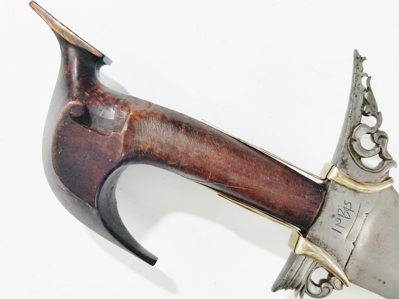

reviving an old thread...
talked to a fellow forumite regarding the translation of the Jawi on this particular kris. been bugging me for awhile, but after talking to Oliver here's what he have to say: on one side it says "SANA" (year) and on the other, it says 1234 (hijiri) which translates to either 1818 or 1819. i don't know of any reason why this particular date was inscribed other than perhaps when it was made? |
#12 |
Join Date: Sep 2012
Posts: 478
Ron, the presence of the word sana (year) clearly indicates that this is a date, however I reiterate for the forum that the third digit from the left isn't well-executed and for that reason may or may not be a 3. As for dating, given the unusual (and striking) work on the gangya and the grip, it may well date to the beginning of the 18th century. But such a date can also be referential; were there any events which took place in that year that would be commemorated by Muslim groups of Mindanao... if, as we discussed, it is in fact from one of those cultures?
