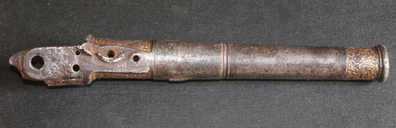

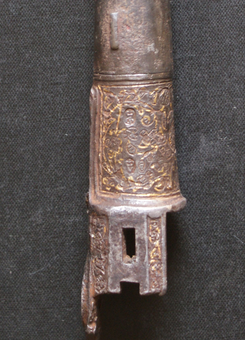

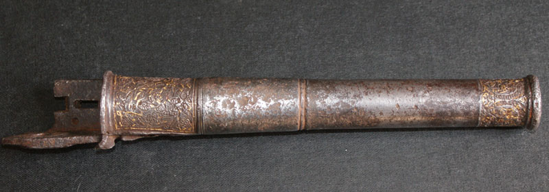

This sad relic turned up the other day.From an early cannon barrelled turn off flintlock. Clear London proof marks. Decoration on English firearms is unusual and in this case consists of a sort of false damascening of punched and chiseled work with mercury gilding which must have once looked wonderful against a blued steel background. Suggesting a date of around 1670 ?

After Blackmore, British Military Firearms these proof- and view marks of the London Gunmaker's Company are from about 1740. I think this is a turn off barrel of a Queen Anne pistol.

Guess you take your choice. Personally I would rather go on style.
