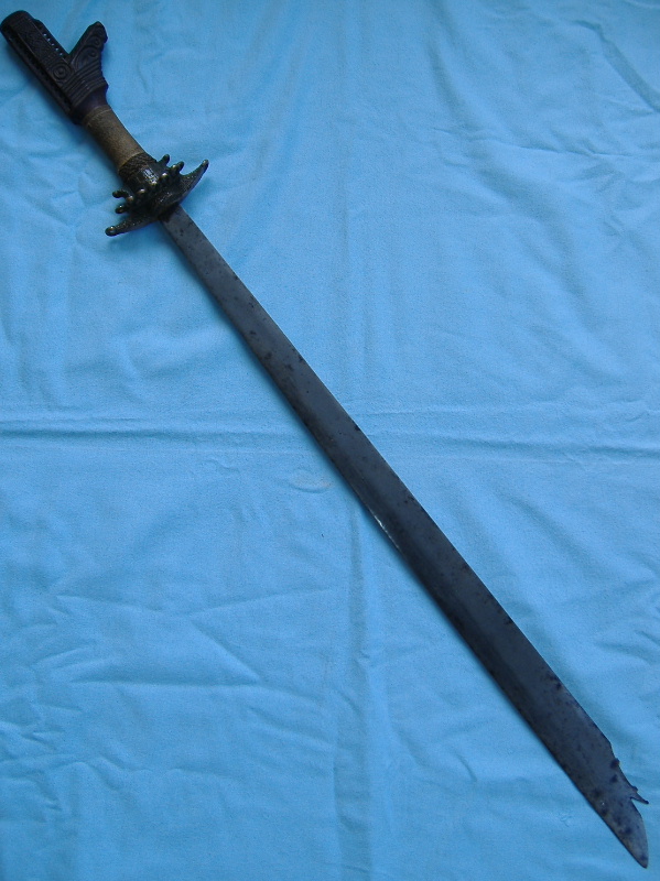

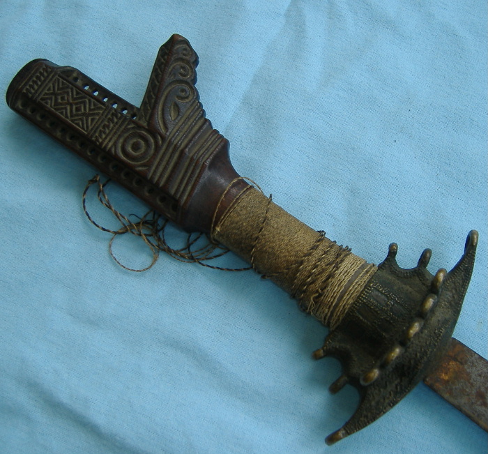

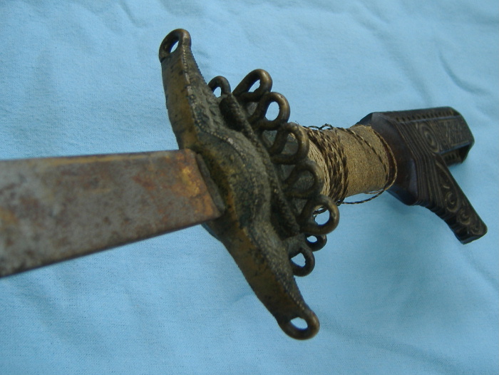

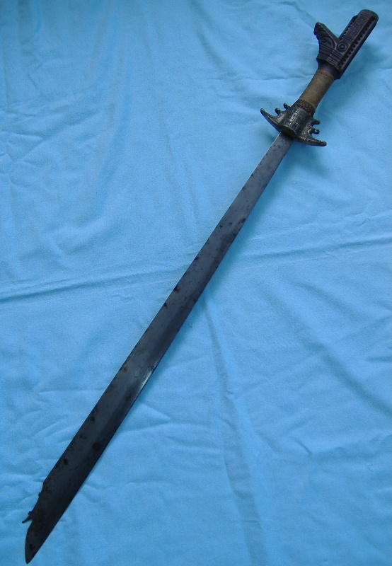

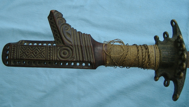

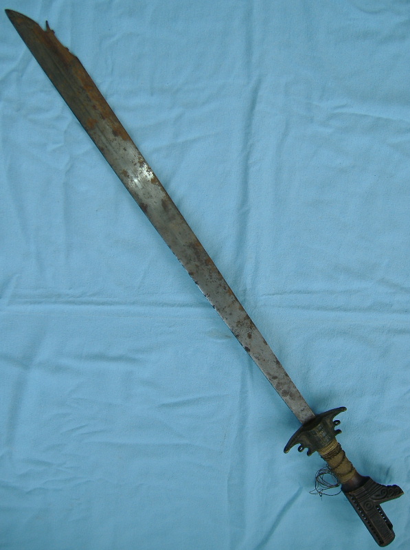

I saw this piece on it Ebay and it immediately caught my eye as it appealed to my fascination with cross cultural pieces. My biggest worry was that it might be a new piece like some others coming out of the Philippines now. Once I got it in hand that worry was put to rest as the piece is clearly old...I am guessing the first quarter of the 20th century. The blade showed old and active rust. This hilt was filthy with old dust and dirt and the brass/bronze guard was practically black, with some green patina. The hilt's wrapped cording was partially dry rotted.
I gave it a mild clean-up to at least get rid of the active rust and the superficial dirt and green patination and highlight the raised areas of the guard. I also acted to try to preserve what was left of the 2 hilt wrap cordings.

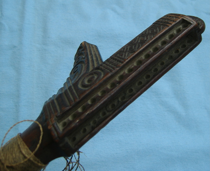

The piece immediately reminds one of a Moro kampillan, and no doubt takes its overall concept from the kampillan, but once you get into the details, especially regarding the hilt, it bares little resemblance to a Moro version. Only the modest wave motive carved on the hilt hints at Moro aesthetics, perhaps along with the circular motif.

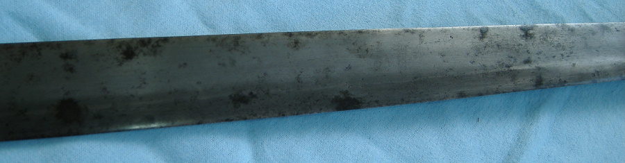

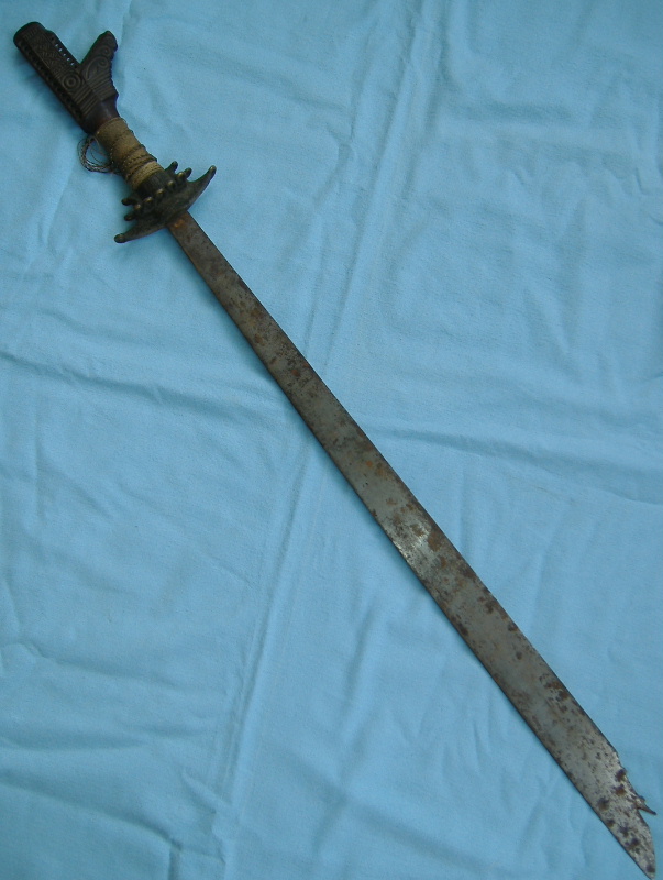

The blade is just slightly shorter and lighter than a Moro kampillan and shows a very well defined heat treated area. Note the chiseled motifs to the spine.

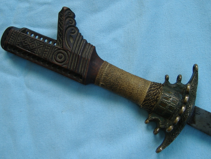

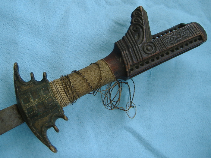

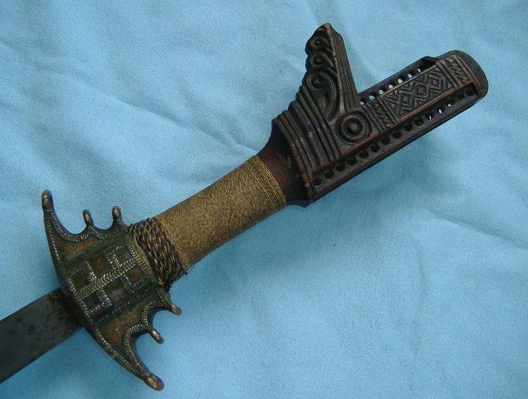

The oddly shaped brass/bronze guard has a knuckle protector and is cast with the lost wax method. It is attached to a wooden hilt and pommel carved to host two rows of brass rings to the bottom(these being carved almost identically to what we might see on a Bagobo scabbard) and one row to the top, with 4 at the end of the pommel.
Overall length: 37in.
Blade length: 27in.
Overall hilt length: 10in.
Brass guard: 2in. wide and the actual guard is 4.5in. from top to bottom.
The first few pics here show the piece in its original condition. The last few are after a mild clean-up.
So, is this T'boli?? Bagobo??...I suppose we could even suggest that it is a Moro variant, but I would have a hard time buying that as the hilt simply diverges too much from Moro styles.
I am anxious to hear the opinions of other Moro and Philippine weapons collectors!!

Nice kamp Charles! I think the blade is most likely "Moro" (Maguindanao or Maranao) but the hilt is distinctly "Lumad."
The guard looks very much like to T'boli work, especially the brass loops. The carving is harder to place--could be T'boli, Bagobo, Kaolu, etc. I would say this piece was put together in south-eastern Mindanao by one of the indigenous Lumad tribes using a Maguindanao blade. If there was a scabbard it might have told us more about which Lumad tribe.
My guess is that this one is from the T'boli, although their own version of a kampilan is pretty good if somewhat shorter.
Ian.

Rick: I never even thought about the bells! Good thought!
Ian: Thanks for your input. Do you think I am about right on the date being around the first quarter of the 20th century? I can't imagine it being any older.

Great find! I agree with Ian it's probably T'boli. They are known for lots of brass/bronze casting abilities. I also see the holes for T'boli hawk bells. Moro trade blade. Even the pattern on the "nose" of the hilt is T'boli.
I think your age is reasonable (really, really old! ).......er........I mean being from the 1st quarter of the 20th century.

Yes, Charles, I think you have a good estimate of age on this one. The blade is probably older than the hilt. Early to mid-20th C seems right for the hilt.
Very interesting and attractive sword!

My humble vote is against T'boli. The motifs and patterns are decidedly not T'boli, which are generally very specific. The "loops" where chains and bells may have hung is also not T'boli patterned. The loops, patterns and other shapes point to more Bagobo influence.

The rope motif and motif on the nose as well as the loops for me point to T'boli. The Bagobo were very close though, easy to confuse.

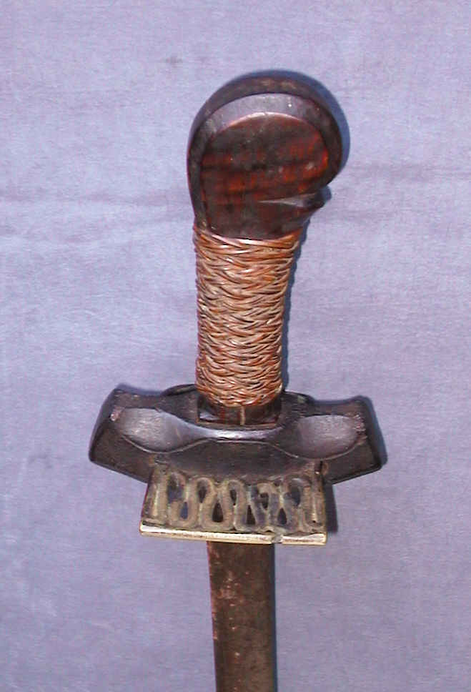

Sandcast brass Kampy guard .

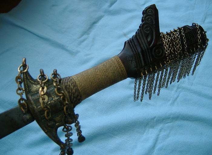

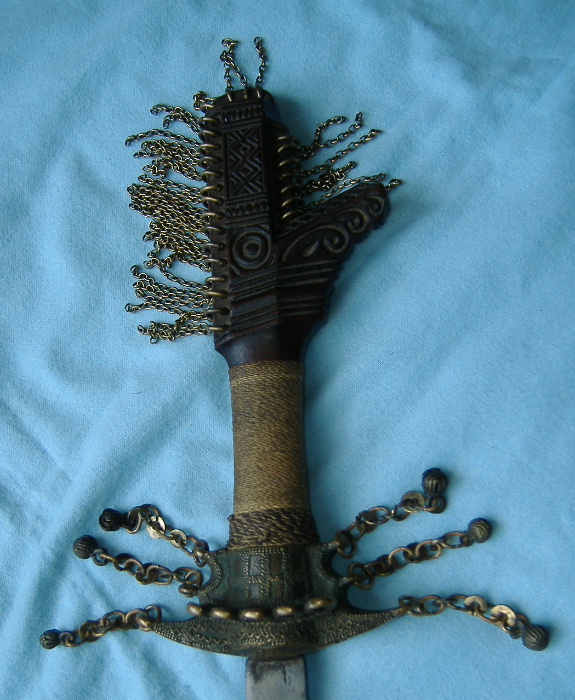

Battara has recently restored this in a typically T'boli style with brass chains and antique T'boli bells.

I did this in T'boli fashion since as Ian mentioned, the characteristics lean more toward T'boli rather than Bagobo, especially on the cross guard.
Notice that the small chains on the top "jaw" fill in the place of hair on Maguindanao/Maranao kampilans.

Jose, what did you use as an example to go by when you embellished this sword ?
Nice work .
Old 5th March 2015, 05:08 PM   #17
Posts: 7,374

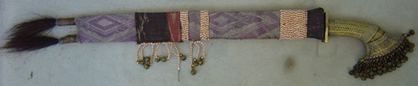

I looked at T'boli scabbards and T'boli hilts, as well as the type of chains they used.

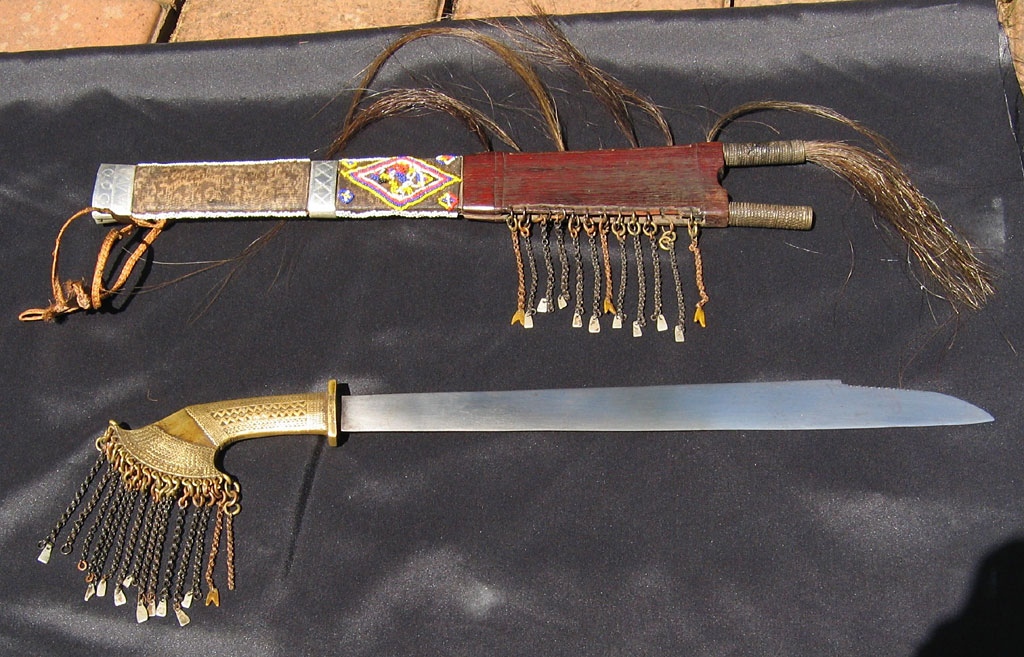

I believe these types of hilts and scabbards were Battara's inspirations:
