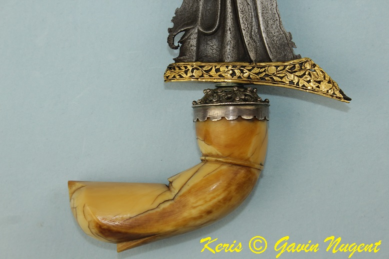

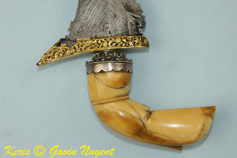

Battara,
Here is a Royal Malay keris from my collections for viewing in part. Similar images on Face Book for those who follow there.
I have shared it with several privately, it is one that is well received by visitors.
As Mr Henkel mentions, beyond the gold there are often special features too...in this instance note the different faces with completely different, separate and important features, including the perfect 25 luk.
Gavin
