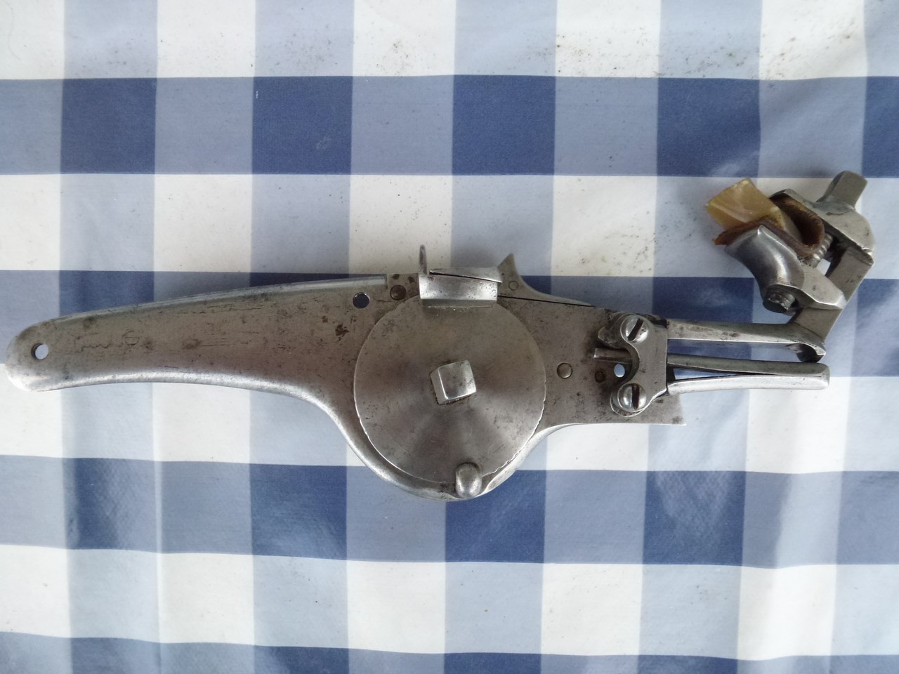

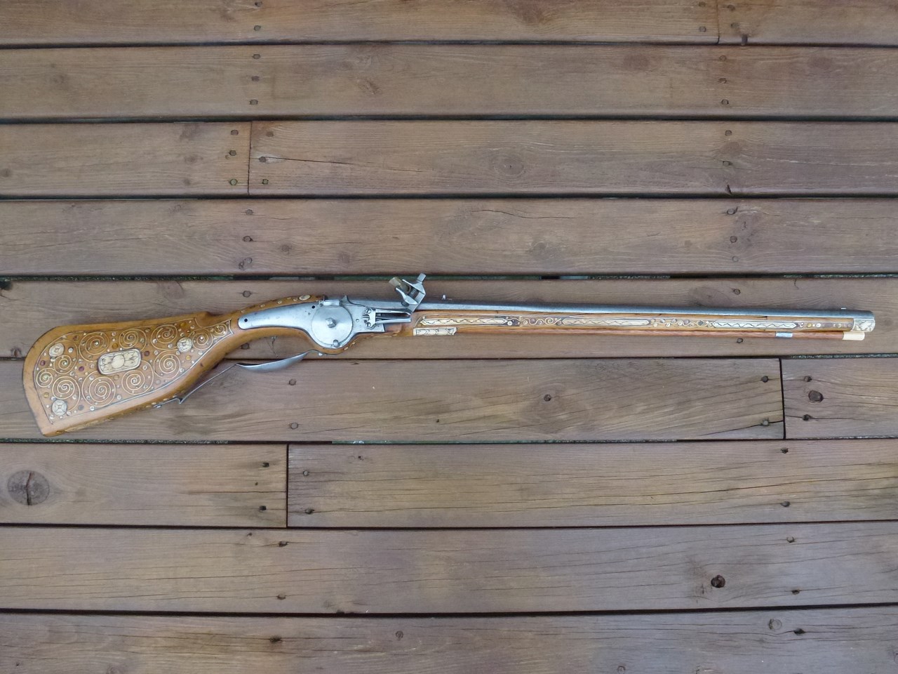

I have a Suhl Wheellock carbin, and I wonder if someone can help me with some information about this. When I bought it, it was informed that it was produced around 1630, but it is marked 1592 on the top of the barrel. The stock has a lot of inlays, I guess this is done later. The barrel har some Suhl markings, and the inside of the lock is marked FR over a wheel or something.

Hi Morten,
And welcome here.
I can defintely tell you every little detail about your carbine.
1. It was manufactured in Suhl after the Thirty Years War (1618-1648), in the 1660's, as a plain undecorated military saddle carbine

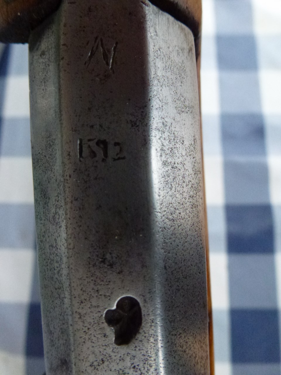

2. The date 1592 is spurious and a later addition, and so are all the bone inlays in the stock.

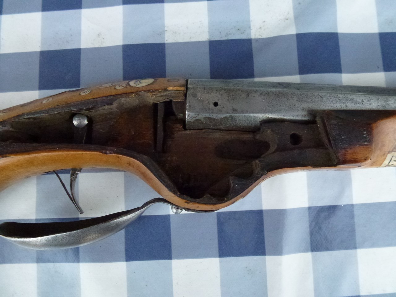

3. The original riding bar which attached the carbine safley to the saddle by a leather sling is missing from the opposite side of the lock; formerly, it was fixed by one of the of the sidenails and a forward screw also acting as a transversal pin for the stock and barrel;

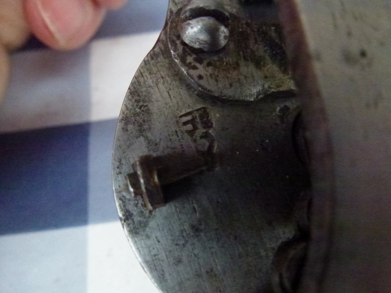

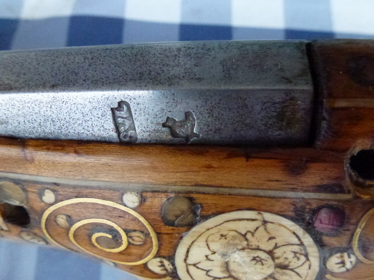

I once owned a very similar example, yours has more stamps on it though.
My suhl carbine, also inlaid with bone plaques was made for the saxony market or even the Polish nobility. I would date this carbine to 1640-1650s.
I couldn't find the date of 1592 on the barrel in your pictures. The lettering ISE (?) is most likely what you meant?
The pin holding the trigger could be a replacement.
Still a nice gun on its own right.

Thanks for information Michael, I also thought that it was later than the markings. I cant see any of your picyures.
Marcus, it's 1592 no letters there only numbers.
I did some photoshopping on Morten's picture.

may I ask when and why the brass and bone inlays added?

Thank you Michl, but i still have doubts about the interpretation of this mark. It might just be my perspective beeing a bit off.. but i can see either a crude 1592 (especially the 5 and 9 are vague) or ISE with the E not in good shape.
The question is if you should read this as other mark SUL? The SUL are stamped within a square and are raised, the ISE is in the same manner. 1592 would be stamped without a boarder/sqaure around it and stamped inwards.
I have no knowledge (beeing 0-5%) on how stamps where made in those days.. i do know it is more common for dates to be stamped inwards without a boarder to highlight them.

The thing about that spurious date 1591 is dead easy: it was done very dilettantely by some fool who neither knew what cyphers looked like 400 years ago nor could he strike them with a sure hand; all that obviously happened only in the 20th century.
Hi Detlef,
Those plain wheellock and matchlock guns soon became technically outdated by ca. 1700 and were replaced by flintlocks. The obsolete guns were sold off cheaply in large numbers by the city arsenals, and many noblemen bought them and had them "embellished" in late 16th c. style in Poland and Czechia; they then "decorated" their castles with that stuff that now looked much nicer hanging on the walls than it did before.
Such items, of course, are an absolute "no go" for any serious collector.
