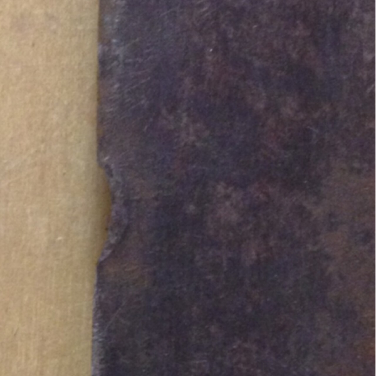

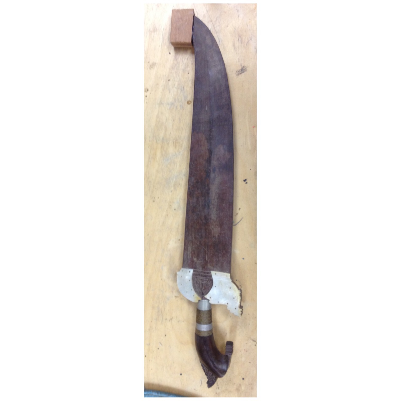

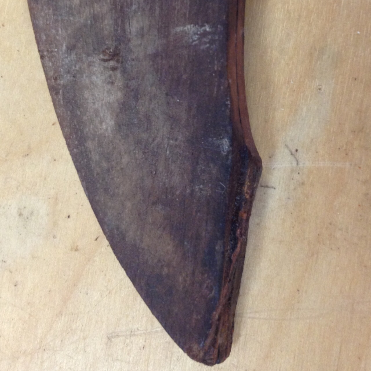

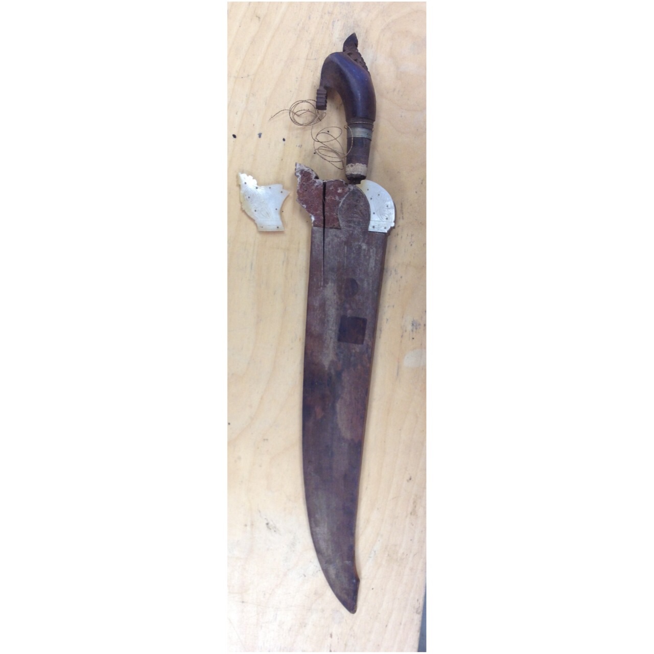

Here are a few images of a barong that I pulled out, showing it before any cleaning was done.
I will add more pictures of the work I did in the last few days.
Any comments, pro or con are welcome.

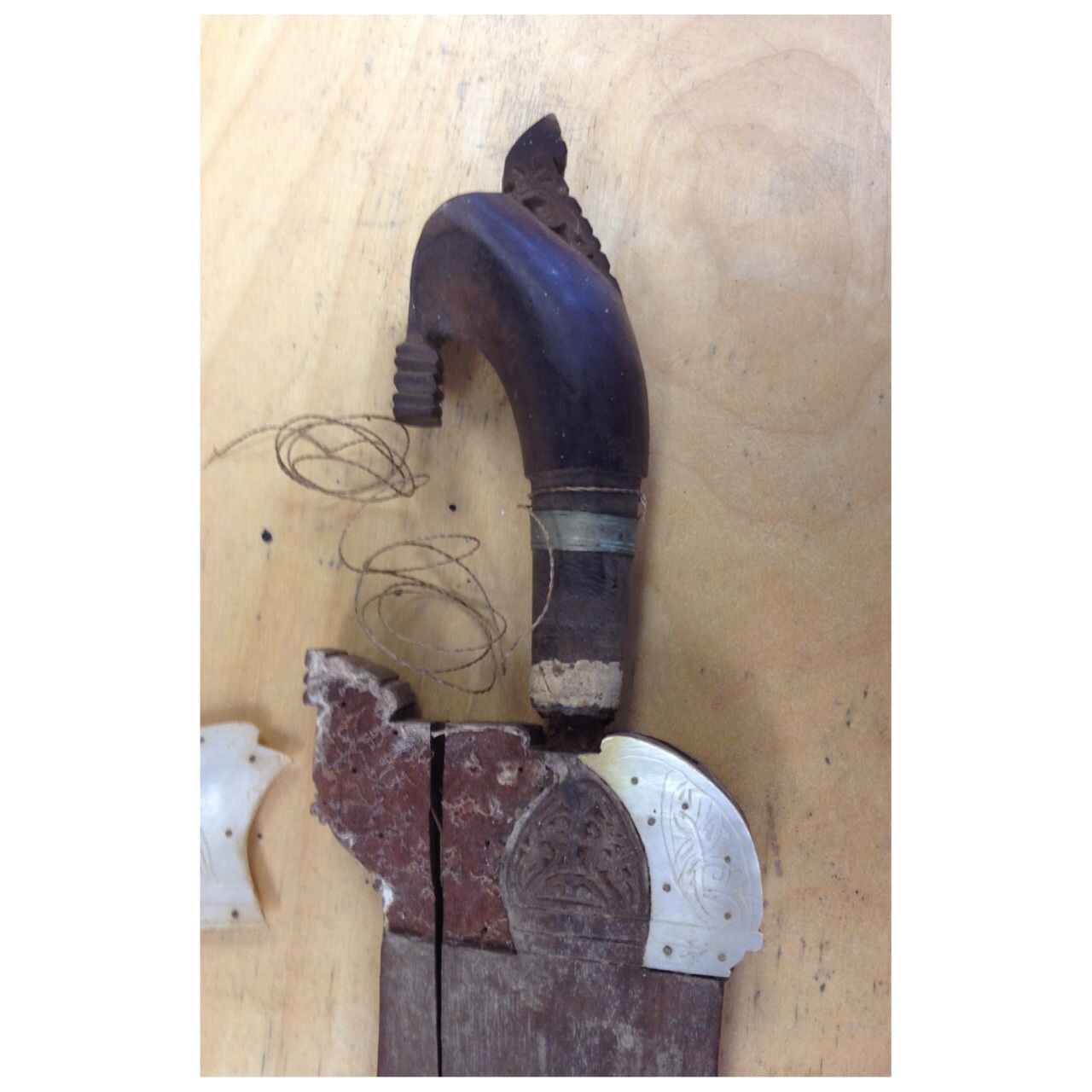

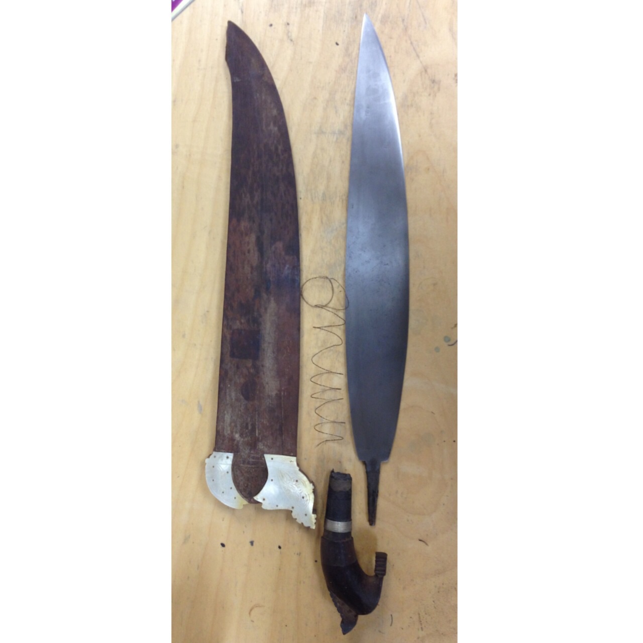

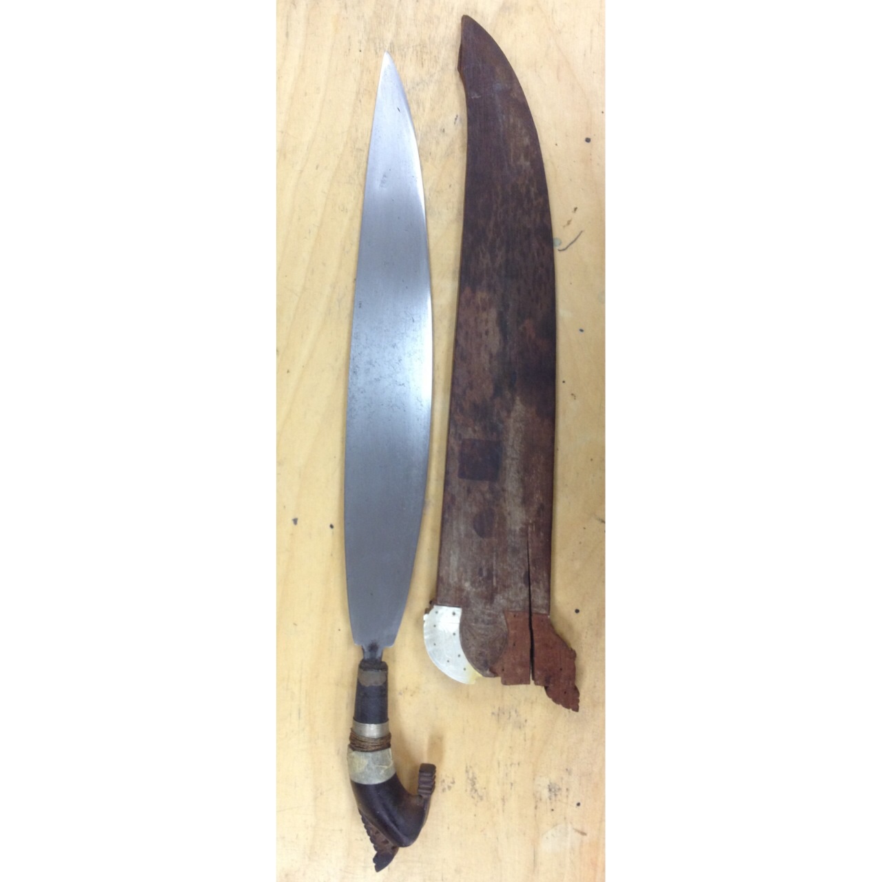

Here's an update after hours of work!
The blade is more or less clean, small dings and chips were polished out, old glue residue removed.
The scabbard appears to be made of golden teak. Once I find some I will update this post again.
Please, as usual, comments and suggestions are welcome.
The terminal of the scabbard is missing, as well as the grip covering. I taped up and out of the way some handmade string that I don't think was external wrapping, but, again, I'm no expert!
Any guidance here is most appreciated!

A NICE PROJECT. I DON'T KNOW HOW MUCH RESTORATION YOU PLAN ON BUT SOME ELMERS WOOD GLUE AND A CLAMP TO CLOSE THAT CRACK AT THE SCABBARD TOP WILL ALLOW YOU TO PUT THE LARGE MOTHER OF PEARL SECTION BACK IN PLACE. THE MISSING SCABBARD TIP LIKELY HAD MOTHER OF PEARL AS WELL AND THERE MAY HAVE BEEN A METAL FERRULE NOW MISSING THAT COVERED THE BLADE TANG. IF YOU REPLACE THE TIP PERHAPS A REFINISH ON THE SCABBARD WOULD BE NECESSARY BUT IF ITS NOT REPLACED YOU CAN REFINISH OR LEAVE THE SCABBARD AS IS DEPENDING ON WHAT YOU LIKE BEST. ONE WAY TO DO IT IS A PARTIAL RESTORE OF THE SCABBARD, RE- FINISH THE FRONT OF THE SCABBARD TO ITS ORIGINAL LOOK BUT LEAVE THE BACK AND SIDES AS THEY NOW ARE SHOWING THE OLD PATINA AND DIRT.

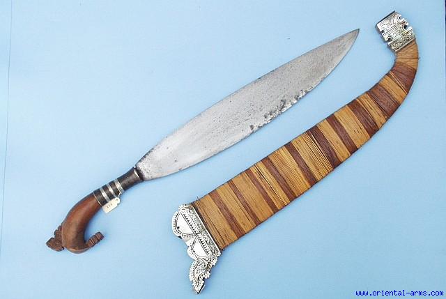

HERE ARE TWO EXAMPLES OF BARONGS WITH MOP PANELS SHOWING THE TIP. PLEASE PARDON MY USE OF THE PICTURES IF THEY ARE SOMEONE ELSE' S PICTURE I CANNOT KEEP TRACK OF WHERE OR WHEN I GET THE PICTURES. PERHAPS SOMEONE CAN SUPPLY INFO ON THE PROPER DESIGN TO MATCH THE OLD MOP OR A SUGGESTION OF WHERE YOU COULD ORDER A PROPER PIECE MADE. THEY STILL DO THE MOP WORK IN THE PHILIPPINES AND MOLUCCAS. GOOD LUCK

very good cleaning job of the blade, ready for etching. I think that this barong is much later as the other one, 1930 or later but a very nice one. From which material is the remaining ferrule? I think there is missing a second and maybe a third one. I would let work them in the same manner new, replace the missing wrapping and attach the handle firmly again in correct manner, clean carefully the wooden pommel without removing the patina and oil it with linseed oil. The scabbard don't show a nice patination so I would clean it carefully with steel wool to show the potentially nice grain of the wood. Glue the split in up and reattach the mother of pearl piece in the way it was originally. Restauration of the finish of the scabbard will be a great concern, there was once most probable as well attached a MOP piece, personally I would let it like this.
The best reference book about Moro blades is "Moro Swords" from Robert Cato, difficult to get and somewhat expensive but with good luck you will find an example.

As the scabbard on your example seems to have a raised central ridge I would say that making a new toe piece similar to the lower one shown in Vandoo's photo above would be a fair representation of how the original on yours would have looked. The mother of pearl carving would just be an extension of the simple line and floral pattern shown on the throat pieces you already have. The ferrules and what they were made of would have depended on how much the owner had to spend on dressing up the hilt. As your example has modest quality carving on the mother of pearl I doubt that the ferrules would have been very elaborate either so possibly three would suit this piece. Again, the wrap could have been made of a few different materials, but in this case I would guess that simple braided cotton fishing line might have been originally used and therefore would also serve as a proper replacement. Now, as far as your showing some of the work that you have done it would depend on what it is. We do have a section of the forum called "Ethnographic Miscellania" and depending on what it is you would like to post it might fit in there. Just read the ground rules posted at the top of the page and decide for yourself. The suggestions I posted on your barong are my own opinions and others here might not totally agree and give you other advice on how to proceed with your project.

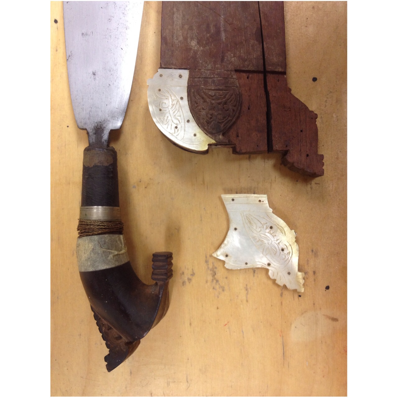

A progress report: the grip has been removed and the scabbard throat repaired and the original MOP plaque remounted.
I used hide glue after a quick soak in hot water to elasticize the split. The clamp remained in place for about 24 hours. During the clamping, I blasted the A/C down to 65 degrees which lowered the humidity. This pulled any latent moisture from the wood and glue allowing it to dry thoroughly.
The plaque was trial fitted after a cleanup of the joint, glue applied and pressed in carefully.
Next I pulled the grip by carefully with a straight acetylene torch held a distance from the blade. As soon as the resin started to bubble, it was no problem loosening the blade and drawing it out.
An examination of the grip revealed that the string wrapping appears to be made of plant fiber, two strands wound together to the left. Two of these strands were then wound together to the right. This gives a loose, interwoven feel to the finished string. I figure I need about 200 inches of it to do a good wrap. I guess I'll have to make it myself, as I don't think anything like it is available commercially.
The ferrule is of thin nickel or Monel, with two hand filed grooves about a sixteenth of a inch from the edges. I looking for some of this material, as today's nickel silver that is commercially available is a different alloy from that used pre WWII. I'll have to go to my junk pile and cannibalize something!
More later.

Progress report:
A couple of new images.
I found some line that closely resembled the remaining foot of original fiber used. I figured I needed about 100 inches of twisted, two strand line to complete the wrap. I next waxed each length to make it more manageable and twisted them together by hand a few inches at a time. This gives a slightly inconsistent rate of twist for a closer match to the original.
Next I made a ferrule of some old white brass that I rolled to the correct thickness. The lines were filed in by eye and quickly giving them a certain randomness that the old one has.
While wrapping the grip the wax helped maintain a tightness and evenness. There is less of a tendency to unravel than un-waxed line would have.
Once the line was in place I put a dab of hide glue inside the ferrule to lock in the loose end. A good push against the edge of the table to seat everything into place, put it down, walk away for a day or so.
Next the blade tang was heated to a high red heat for about the first inch. It was plunged into the original resin full depth and propped up to cool off in correct alignment. I also made it a point to leave a bit of the line loose beneath the ferrule that I trapped in the liquid resin for added security.
Next, the scabbard break was cleaned of any dirt or gunk and hide glue applied. It was clamped and secured. A jig needed to be made due to the curving asymmetrical shape of the scabbard. Left overnight to dry, with the AC turned down to 65 degrees to pull out any ambient humidity.
Once dry I scraped a slight inconsistency from the backside and did a little artificial aging, using cigar ash and several different waxes.

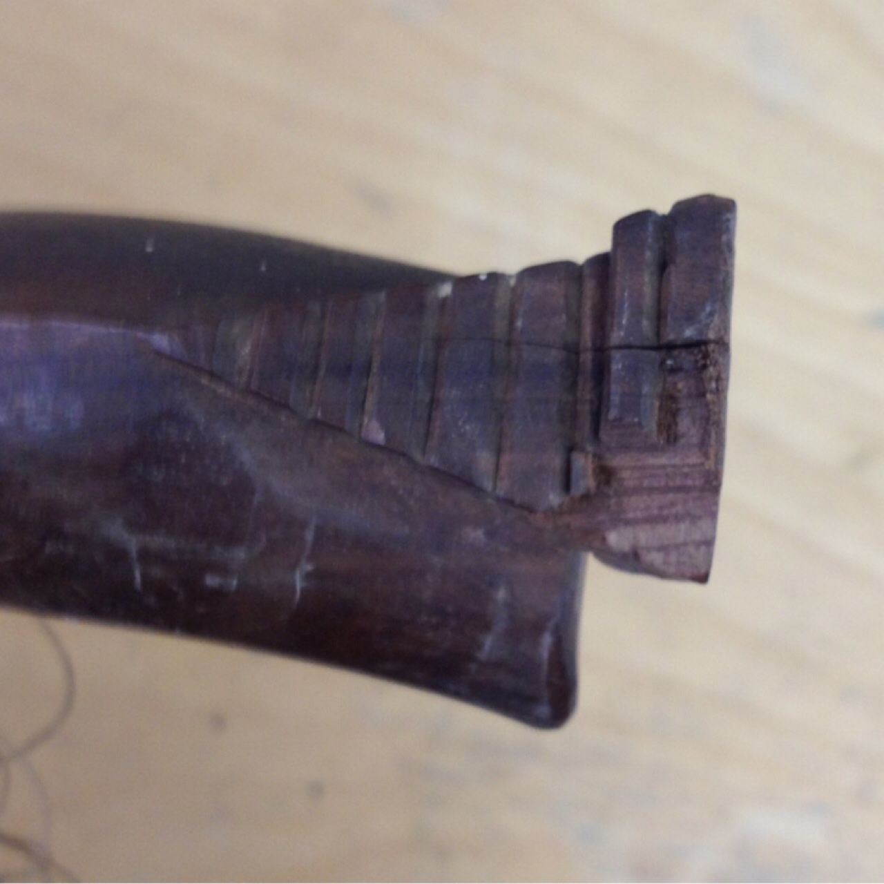

Thanks to several images posted by members, I now know where I plan to go with the scabbard tip. Everything is glued in place, still needing a bit of carving.
Once I finish I will post some final images.
Any comments are welcome and encouraged!

Once I cut out and carve the scabbard tip I will play around with the finish. Matching new wood and old can be quite tricky, but I might have a few tricks up my sleeve!
The last thing I plan on doing will be to make a M.O.P. tip overlay. Before I consider this I need to get the form right and determine the decorative engraving.
As luck would have it, the existing engraving is not very masterful, so I might be right in my league with that!
