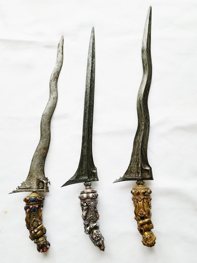

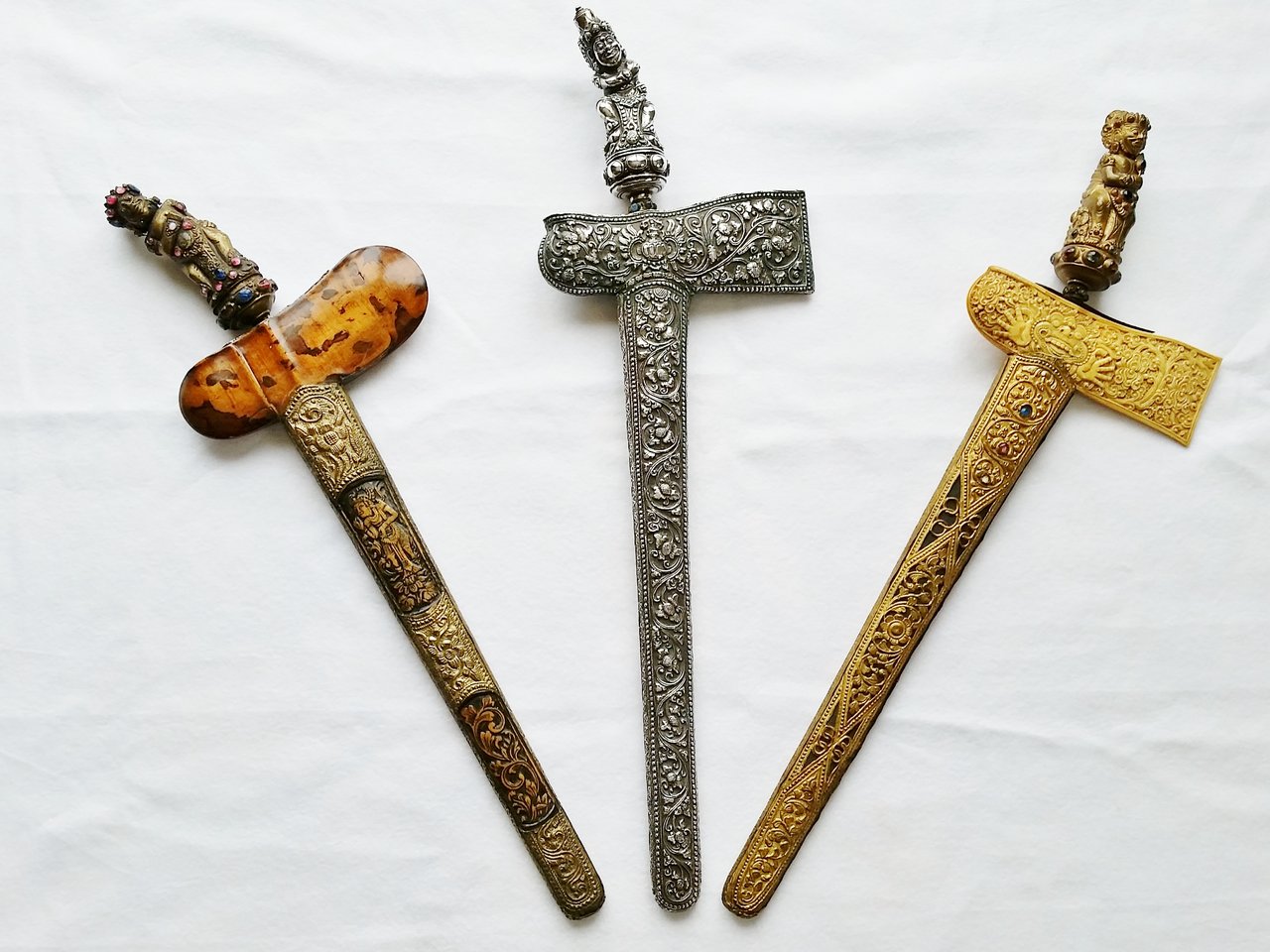

new territory here, fellas. i'm hoping i didn't get blinded by the bling associated with these beauties, and that i made the right choices. as far as i'm concern, they're all Bali pieces, and from the way they look, it took a lot of man-hours to make these beauties. they are very, very intricate, so without further ado, here are my first krises. i will break these up into three different posts, since it's going to be photo-intensive. i would love to hear your comments on my first acquisition.

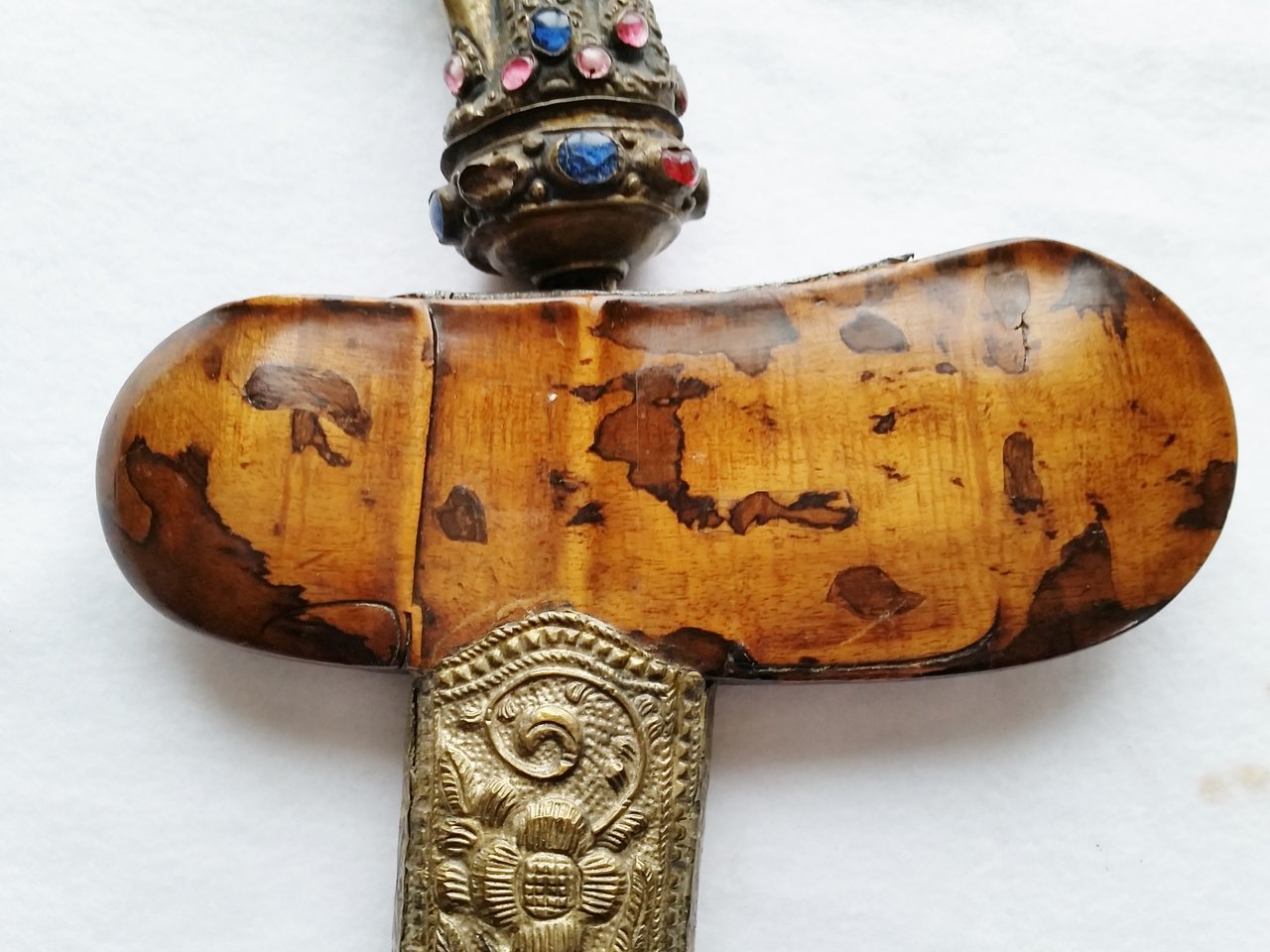

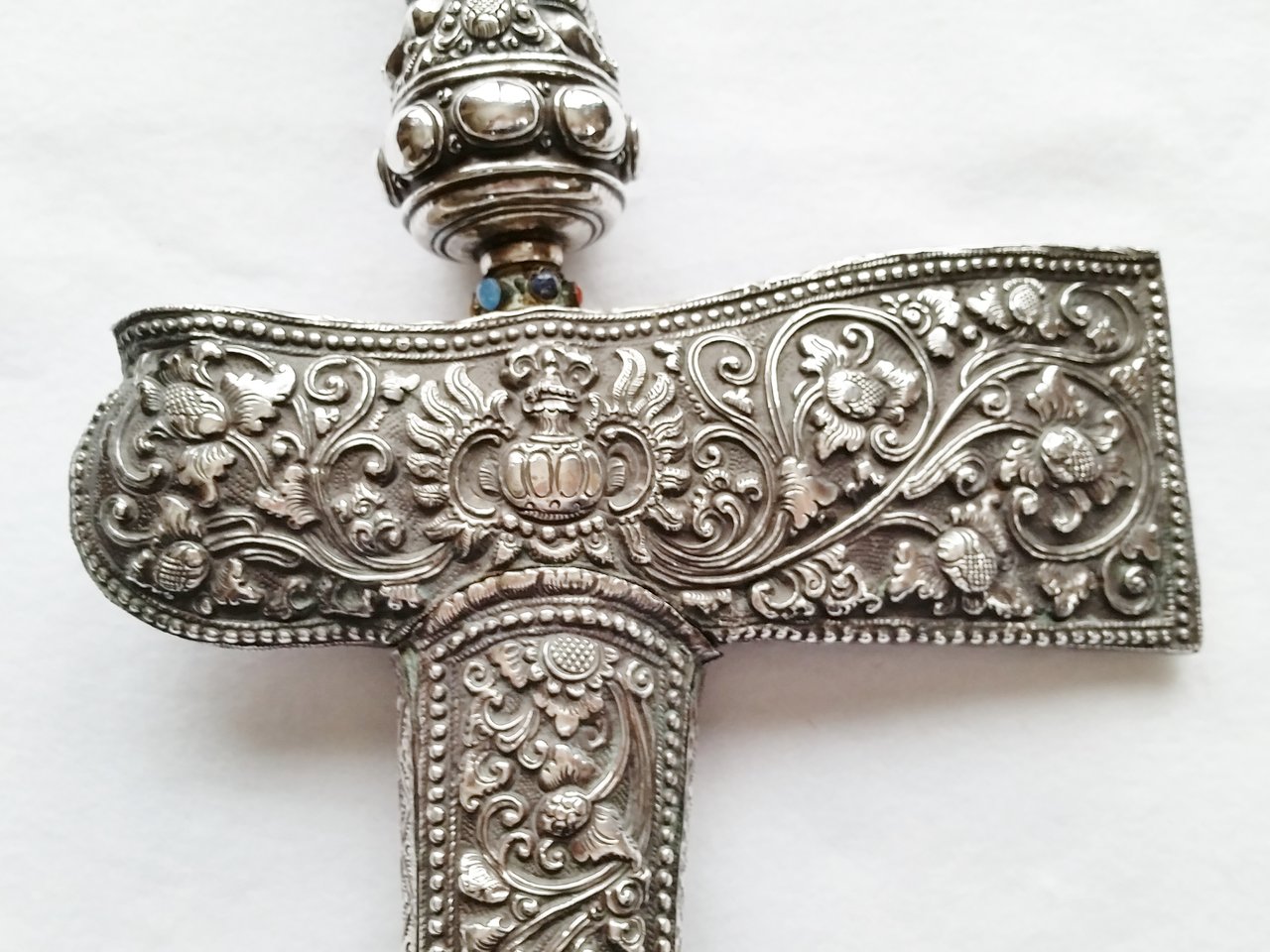

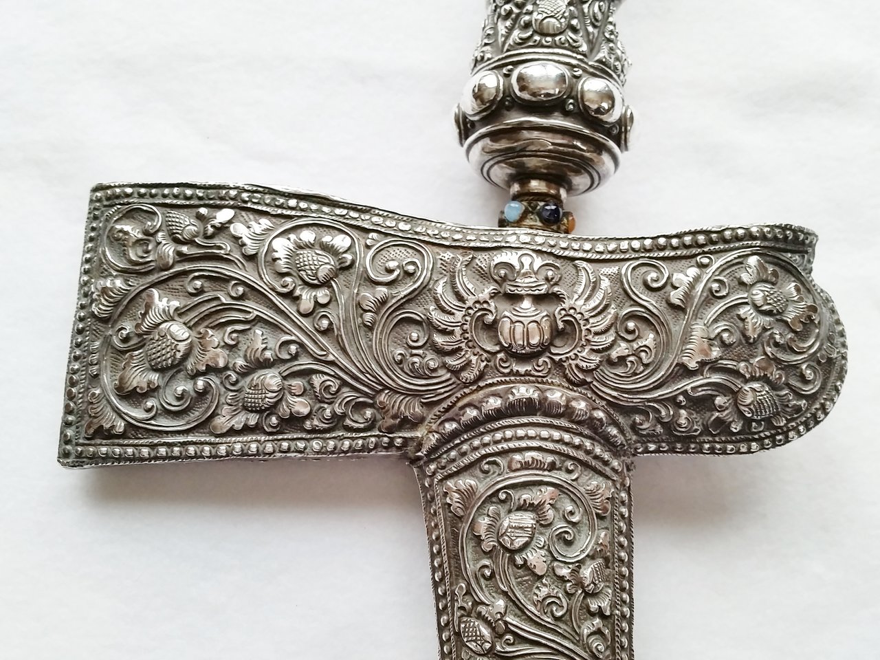

here we have the detail on the dress. the first on is covered with silver, and it has a very intricate design all over. i was wondering if the crown on the wrangka means anything.

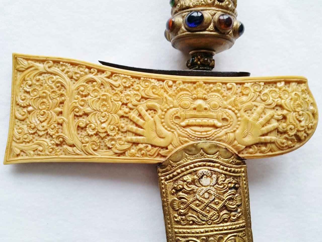

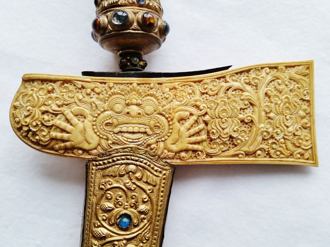

the second one has a wrangka carved out of a solid piece of ivory. all i can say is, "Wow!". very detailed; so much so that there are life lines on the figure's palm. both sides appears to be of mirror image.

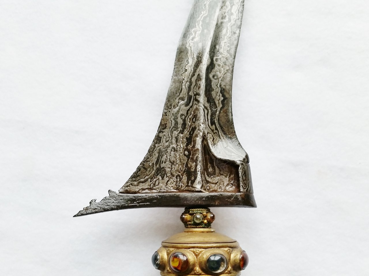

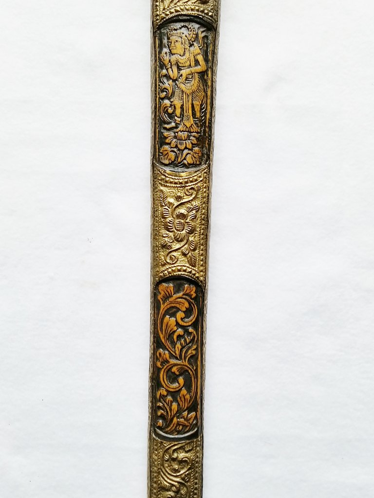

the third one has a beatifully carved what looks like a wayang puppet on the side. these carvings are interspersed with metal, and it appears to be gold washed.

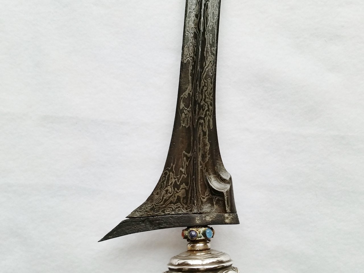

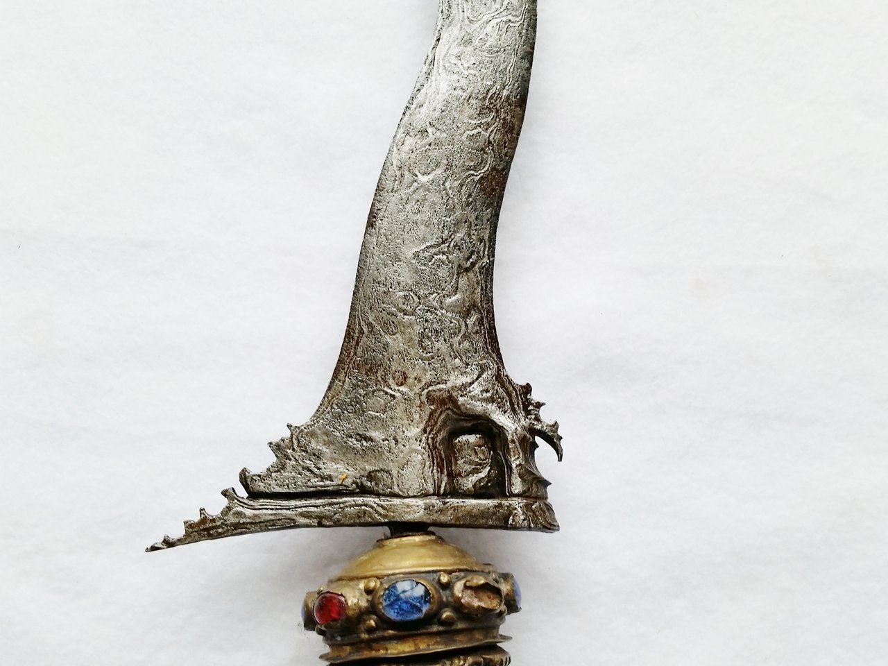

the third part are the blades. i noticed keris aficionados tend to post the blade pointing up, and David has explained the reason why. two of the blades still have the original stains, while the third one needs to be stained, i think. each one appears to have a different pattern, and i would to know what they are, and what it meant (if there's any meaning behind it). any comments is welcome, and i would love to hear it, as i'm still learning. thanks for looking

I do love that silver dress. This is the one out of the three that i find most attractive. I'm not sure that i read that as a crown exactly on the wrongko, but i guess that's a possibility.
You ask if you were blinded by the bling and i would say that perhaps just a little. The silver dress looks like very good quality to me. The ivory Kala carving is nice, but i'm not sure the whole ensemble works for me. I haven't seen the fit on these keris in their sheaths (other than the silver one) to know if they were made for the keris, but i suspect they are newer than the blades (nothing wrong with that). Do you feel all these sheaths where made for these blades (i think i remember the silver one had a nice fit).The blades are respectable, but they are not extraordinary examples of the classic Bali form. But that doesn't necessarily make these less collectable. Still a much nicer start to a keris collection than most of us ever had. ;-) You'll remember in our discussion yesterday that for me it is always the blade that is most important. I would probably choose an extraordinary blade in very plain, understated dress over a average blade in fancy gold and ivory dress every time.
….but i do really like that silver dress.

Agree with the most David has written. Some thoughts more: I really like the carving at the ivory wrongko, beautiful! But like David I think that the ivory and silver wrongko much newer as the blades, nothing wrong by this like David write. The wooden scabbard seems old but modified to let it become more fancy, means the metal sleeve and carving are of newer date.

Ron, all three of these are very nice keris, and I congratulate you on their acquisition.
Yes, it is accepted that the correct way to view a blade is with the point up, and the gandhik to the viewer's left.
I was told that this is the only way in which it is possible to assess the pawakan, the overall visual impression.
This is because when we view a keris, we view it as if it were a man, we apply similar parameters to the ones that we use when we view a man.
Ideally, according to the Javanese ethic, a man will appear to be strong, graceful and humble. If we look at a keris, these same qualities should appear.
When the keris is viewed point up and with the gandhik to the left, the result is that the keris leans slightly to the left, this lean is likened to the posture of a man in the presence of his lord, indicating his humility.
The opposite of this is if a keris too upright, and this upright position in a man would be interpreted as arrogance.
Possibly the most disliked personal attribute of a man in Jawa is arrogance.

Very nice keris, and a wonderful entry to The World of the Keris. All three keris are very pleasing and artistic examples of the Balinese keris. The two darker blades are good examples of middle quality Balinese blades, the blade that is out of stain is very probably Madura, I would need to handle it to be certain, but it displays a number of Madurese physical qualities.

What do you think about the work on the silver dress? To me it seems older. I realize that a lot of good silver work is still done in Bali, but i guess i have a tendency to assume that quality work in this sphere is more likely to be older. But that my well be the wrong impression on my part.
I also wondered if there is any chance the out of stain keris was of Lombok origin as they sometimes diverge from what we generally think of as Bali style keris.

Yeah, that out of stain keris could be Lombok, and I considered adding this possibility, but then I had another look at that wimpy little kembang kacang, and I decided that I'd opt for Madura. Madura has been a supplier of keris to lots of places for a long time. I have a 19th century Brunei keris that gives every indication of being Madura work.

Yes again, the wood is possibly older than the pendok, but this means nothing, because parts get changed constantly. Quality of workmanship is not necessarily a good indicator of age of anything, very often the very best quality work is done right now --- as well as the lousiest work.
The silver dress is probably 1980's forward. Its good work, and the early full silver stuff from Bali was pretty primitive. Right now it seems to have slipped back in quality, but during the 1980's it was very good. I've had a few of these, some I thought were probably older, some I knew were 1980's.But is the age important? To me its not. Its not even relevant. This is art. If you want first quality Bali bling that's old you need to be looking at royal keris, and old Bali royal keris mean very, very big dollars, and there are very, very few of them.
If you're happy with royal quality of yesteryear, but made some time since about 1960 you're looking at something that even a bloke who stacks supermarket shelves can afford --- yeah, he'll have to cut the after work drinks for a while, but he can get it if he wants it.
The best Bali silver work that has ever been done is done right now. But it costs.
