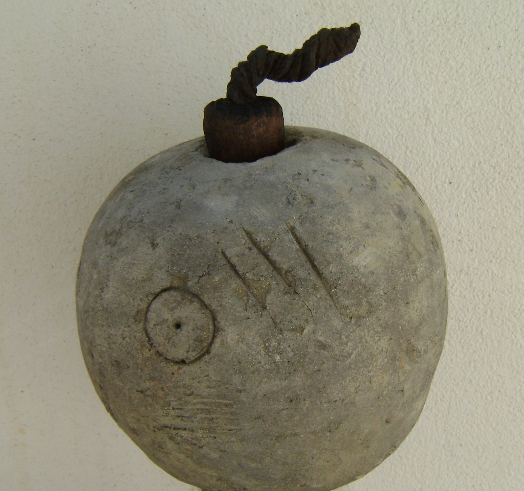

Default Incendiary device? Grenade? Or what?

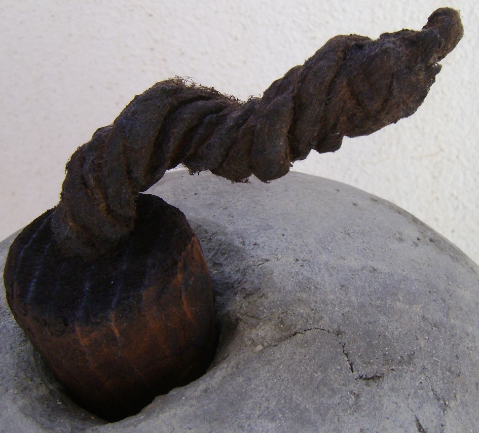

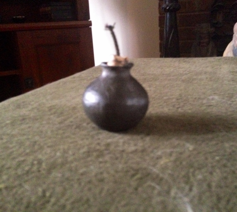

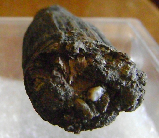

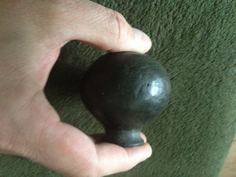

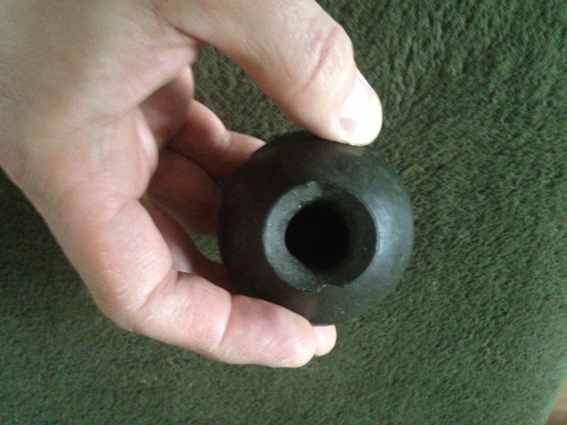

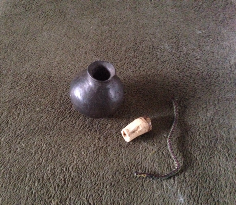

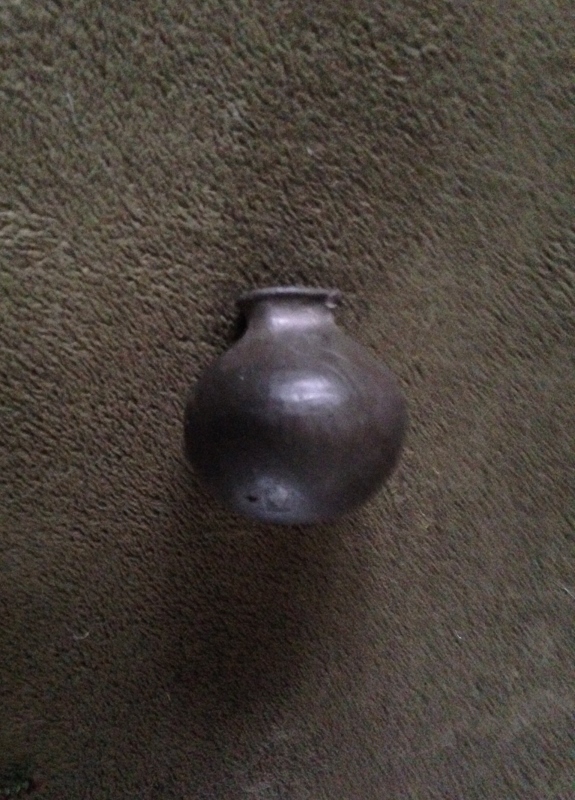

I picked up this odd item a number of years ago (note in the second and third pic that the 'wick' and wooden cap are for show only) at an antiques mall with no provenance or explanation as to what it was. The item appears very old, is made of a light-weight black clay and while fragile, I can squeeze it in my hand without cracking it (i.e. It's not so delicate that it can't be handled). It is slightly bigger than a gulf ball and completely hollow. It measures roughly 2 1/2" tall and approx 7" total diameter. My hand gives a corresponding size. Now, the question is...what is it?
When I first bought it, it had a very old piece of cork stuffed in the top that crumbled away. I wasn't sure if I smelled any residue or not. I can't tell if it is scuffed or had weal markings on the outside at one time. Perhaps I'm being fanciful, but I think this is an incendiary carcass or stink pot/bomb? I think we can rule out a few things it's probably not. I doubt it held incense, candle wax or a plant! The bottom is completely round and it wouldn't have been practical as any of those type devices. As a container holding liquid, it would be very prone to spilling. I guess it could be a one-off pottery piece, but I can't imagine it would have been easy to make such a thing just for fun? It reminds me of the early grenadoes that were used by the buccaneers of old, but they were made of iron (same shape and even with a raised lip. See Warren Moore's 'Weapons of the American Revolution' ,pg 215, ex.A-166 grenade found at Fort Ticonderoga). What got me thinking about this piece was Matchlock's incendiary grenade thread with it's glass French bombs, which are similar, but much thicker. In use, this little item could have very well held a volatile liquid or even black powder. In Gilkerson's 'Boarder's Away', he mentions clay stink pots, so I thought this could be another possibility?
Has anyone seen anything like this? Was black pottery used for such things? Were there Spanish colonial grenadoes like this? What type of clay was used? Anyone want to weigh in on this odd piece?
Pictures to follow! Have to resize them!

Hi Mark,
You called and here I am, right at your service ,

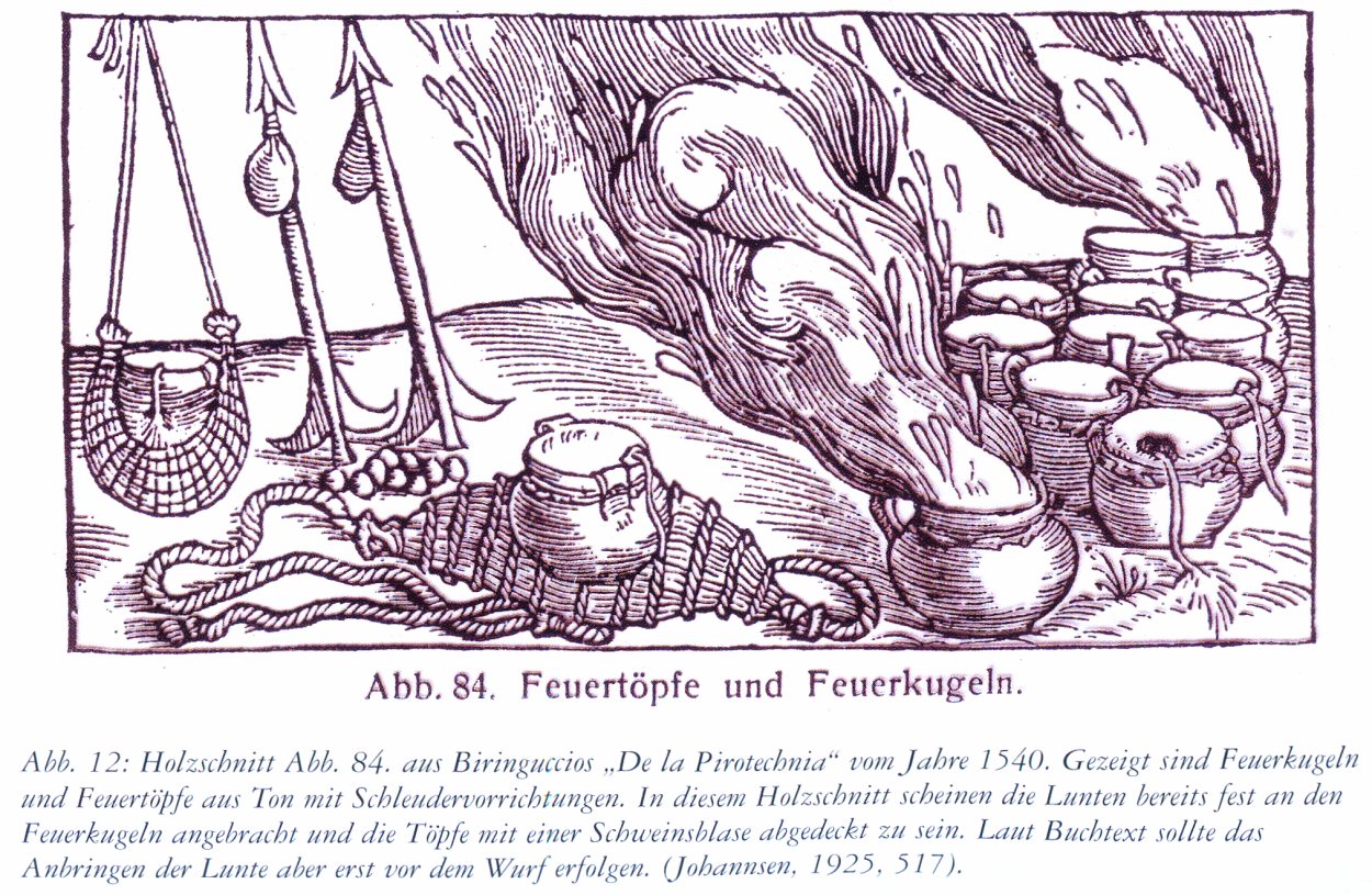

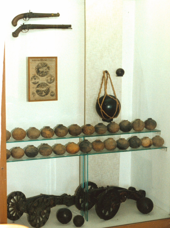

What you've got here may well be a small clay hand grenade of ca. 15th to 18th c. type. This does not necessarily mean that your little clay guy is of Western provenance; it may be Oriental and go back to ancient times when Greek Fire was employed.

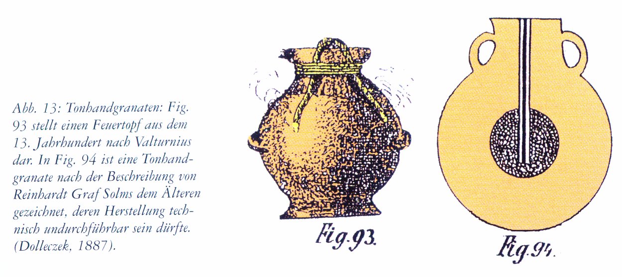

As I tried to show, hand grenades often even consisted of greenish to yellowish glass in the 17th and 18th centuries. I attached photos of some, together with clay grenades, from the vast supplies of Forchtenstein Castle, Austria, and two period illustrations.
There is a very detailed recent Austrian study by Franz Felberbauer, "Die Handgranaten der Grenadiere der Fürsten Esterházy aus Gusseisen und Ton im Zeughaus der Burg Forchtenstein" (the cast-iron and clay hand grenades for the grenadiers of the Princes Esterházy, at the Armory of Forchtenstein Castle), in: Waffen und Kostümkunde, 2012, vol. 2, pp. 181-220, and 2014, vol. 1, pp. 1-52.
I scanned a few images from that essay and posted them here for you.
The two photos at the bottom of the clay grenades in the glass case, together with the two model cannon carriages, I took some 25 years ago in the Fortress Oberhaus, Passau, Lower Bavaria.

Well, Nando,
It is tiny, indeed.
On the other hand, if I remember it correctly, the 1,000 year-old samples from the Egyptian period of the Fatimids were quite small and delicate as well. And the 17th c. clay hand grenades at Forchtentein Castle, Austria are of an average diameter of only ca. 10 cm.

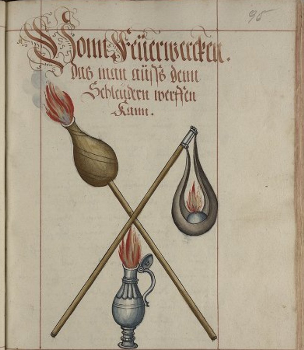

But untill than, something i believe to be a grenade thrower or a very cruel trick on a homeless person.
http://dla.library.upenn.edu/dla/med...urrentpage=195

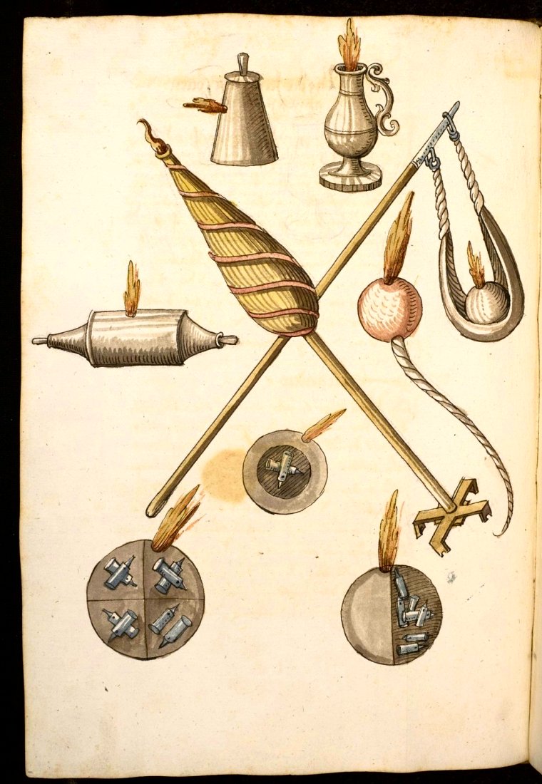

Excellent find, Marcus ,

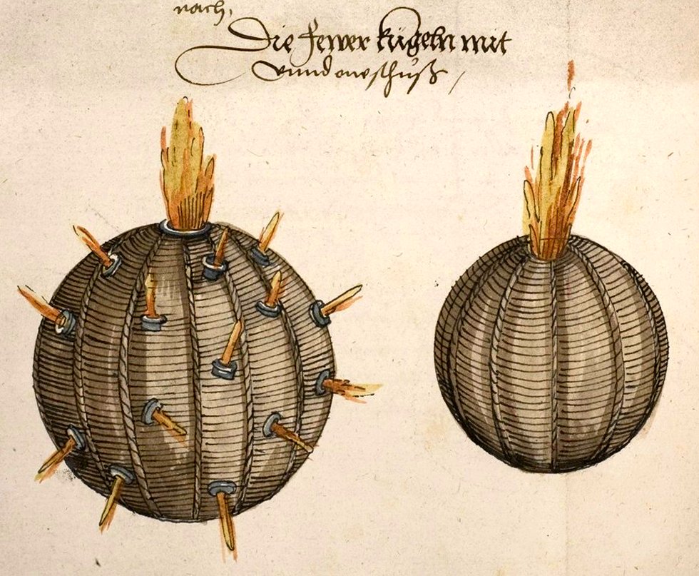

This is from the well known book by Franz Helm, Von den probierten Künsten (on well-tried arts), 1535.
It does show a device to hurl a grenade, and the attached pages are very notable for depicting related stuff that is of interest for our thread!
Old 18th March 2014, 09:02 PM   #11
Marcus den toom
Marcus den toom's Avatar
Location: Netherlands
Posts: 543
Thank you Michl,
I was already pondering about the possible ways to hurl these grenades around, but i had no clue about relevant sources until i found this manuscript.

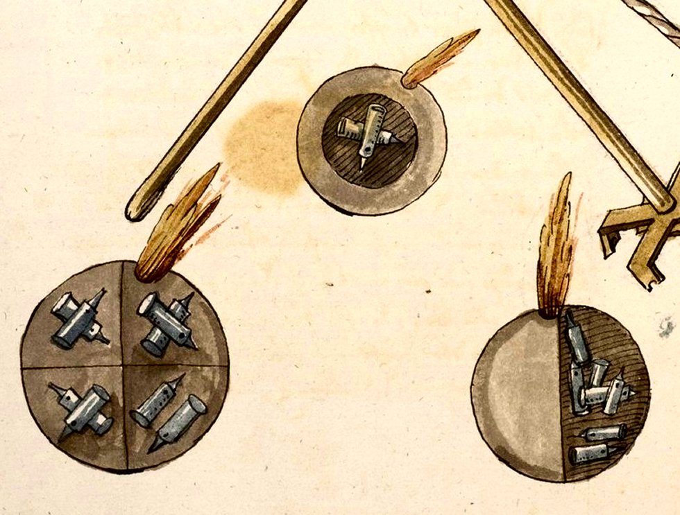

The 'red' grenade on the second image of your above post, is this some sort of rope with a grenade at the end which was hurled trough the air like a scottish highland game (sorry for the weird phrasing).
and the grenades at the bottom of the same picture, do they have secondary charges inside metal containers/explosives (there seems to be a little hole in each of the grey tubes).

Thank you, gentlemen, for remarking on this piece. Yes, Michael, you really did come through for me and I truly value your knowledge on these. I read your other thread from end to end, but didn't post this there until I knew it might be the real deal. I do hope the scholar you mentioned might have something to add as well.
Fernando- But of course I would need one of these if I am to take any ships in the Indies! Cap'n Mark
Nice find on the grenade launcher, Marcus! I've always been fascinated by the flintlock musket types with widened barrel.
Fernando- Small!? Are we comparing sizes here!?
The interesting thing about mine is that it is completely hollow, not like the thicker examples such as the size-ways viewed illustration of a small pocket amid the thick clay 'walls'. Although not eggshell thin, this piece seems made to shatter on impact. Although small, it would have held a similar amount of powder due to the open cavity. Perhaps it was only used to ignite flammable textiles? Distract an opponent with a small flash of powder? In Gilkerson, he mentions stink pots and smoke pots being made of breakable pottery, but unfortunately doesn't show any pics of such items. To date, I have only seen one verified stink pot from an Elizabethan wreck, complete with barnacles. It looked basically like a clay jar with small ahndles on either side, but was flat bottomed. I've seen the early stink pots and clay incendiaries from the Middle East dating to the Crusades, but they were also larger affairs of mostly gray clay.

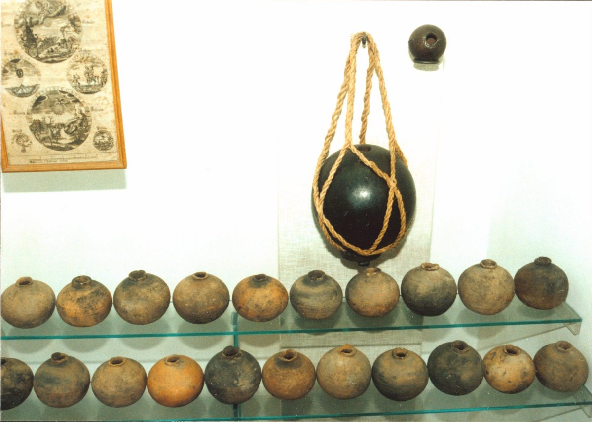

I brought those Italian grenades over here to your thread as well; they deserved it.
The caption reads that the first two grenades are dated to ca. 1700, the third 18th c., the fourth and sixth 18th/19th c., and #6 is 18th c.

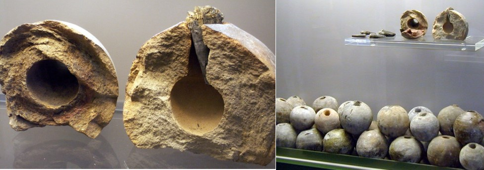

Yes ... and i was later cherished with an early real fuse by an illustrious acquaintance; but it so delicate and fragile, that i decided to keep it in an acrylic box and let the fake stay in the grenade.
This Ingolstadt example measures 13,5 cms in diameter and weighs 2680 grs.

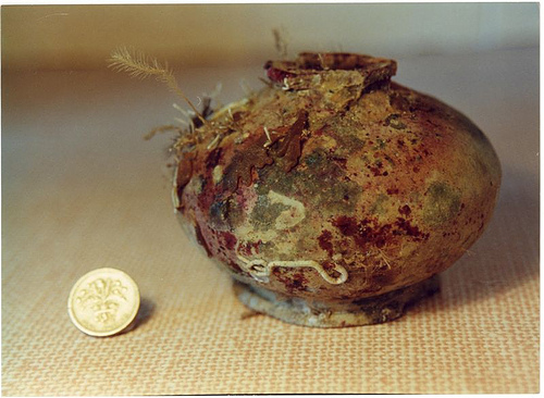

A Grenade or Fire Pot found in the Elizabethan shipwreck off the Island of Alderney of the 1580s/1590s. And a drawing of a publication cieted as "Andrew 1964". The Alderney Museum, Alderney, Guernsey
http://www.alderneywreck.com/index.p...facts/grenades

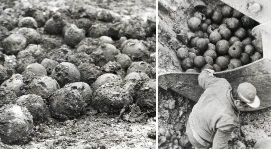

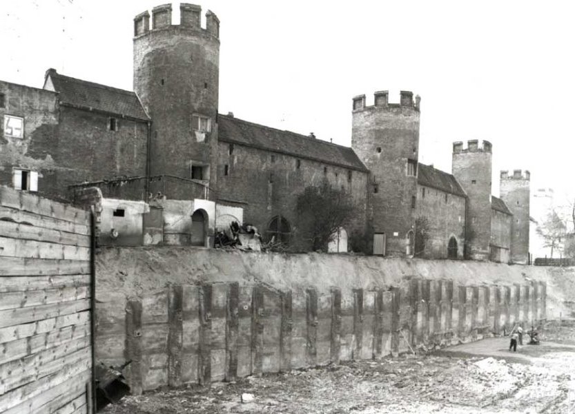

For general perusal, here are pictures of the place where the grenades were found, the recovery and a crosssection of one of them at the museum.

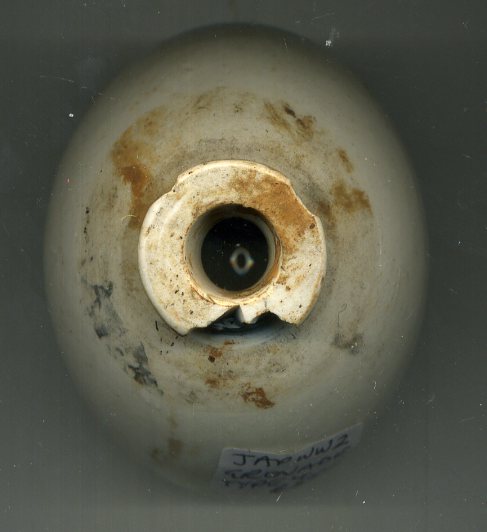

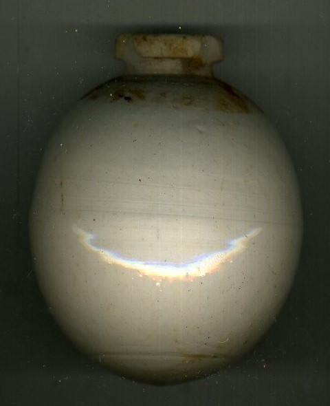

Of course towards the end of WW2 the Japanese also manufactured pottery grenades as an emergency measure known as Type 4 I think .... here is one I have. The size is that of a cricket ball.
