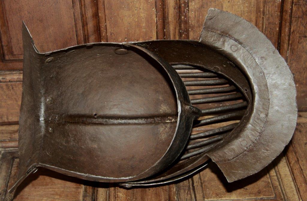

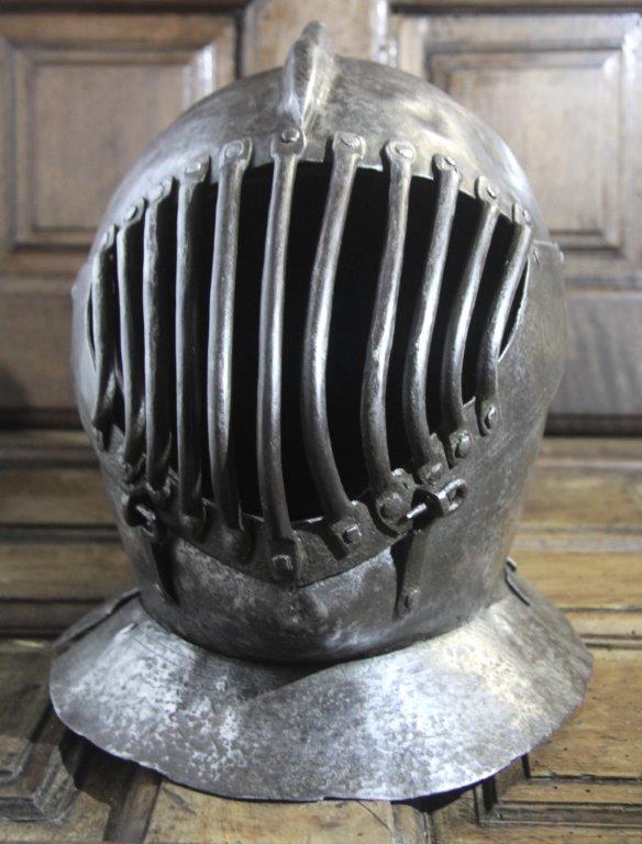

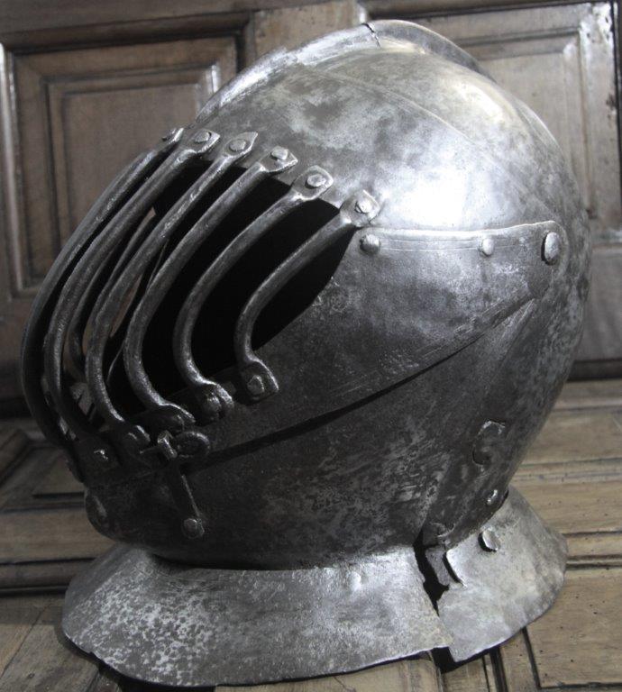

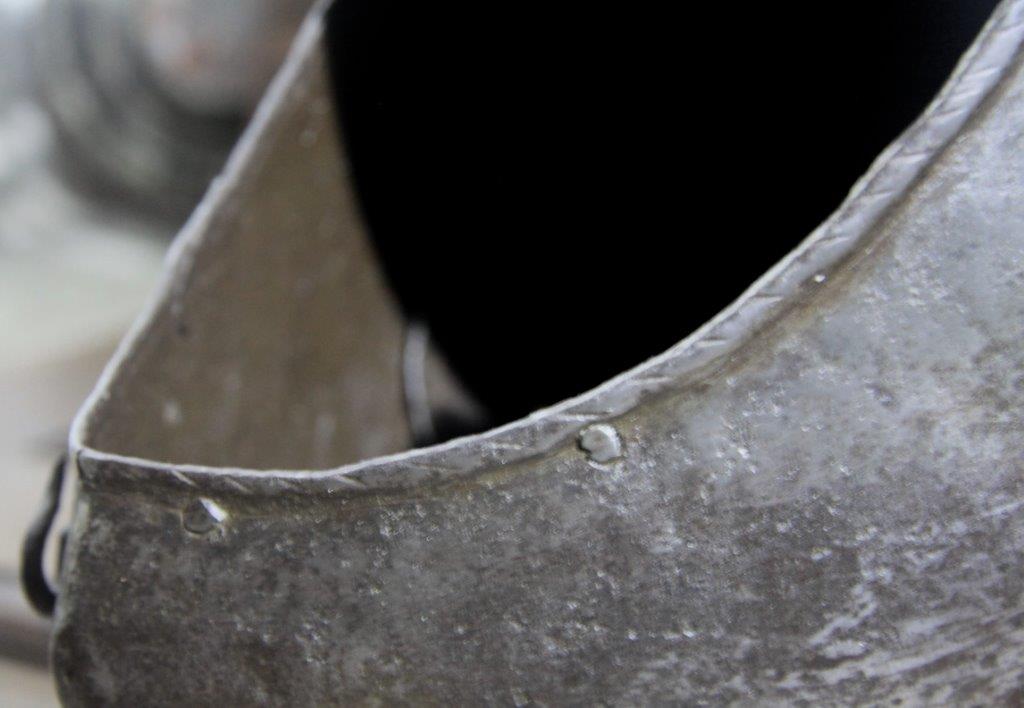

Default An Italian visored close helmet for the Pisan Gioco del Ponte

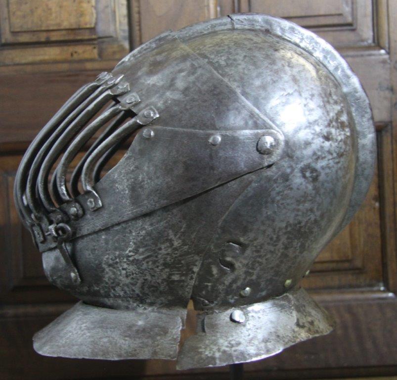

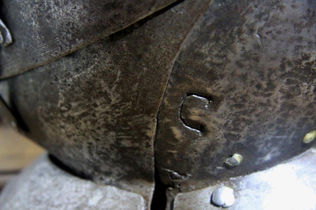

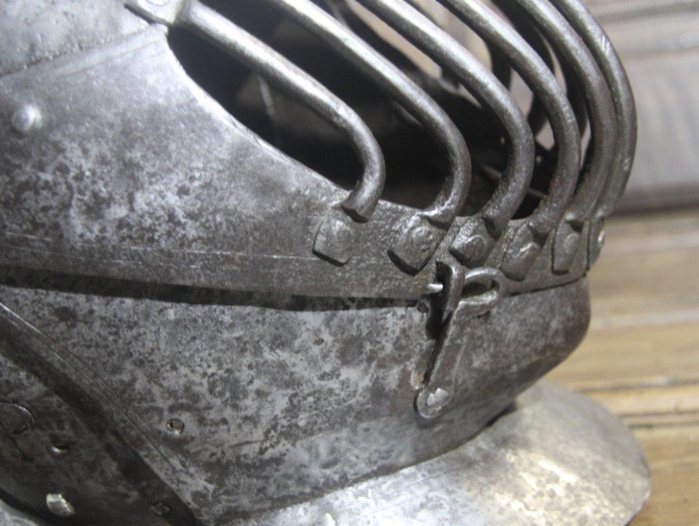

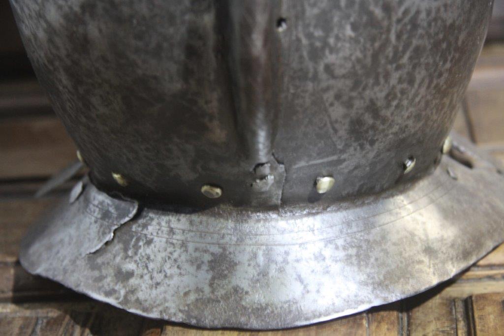

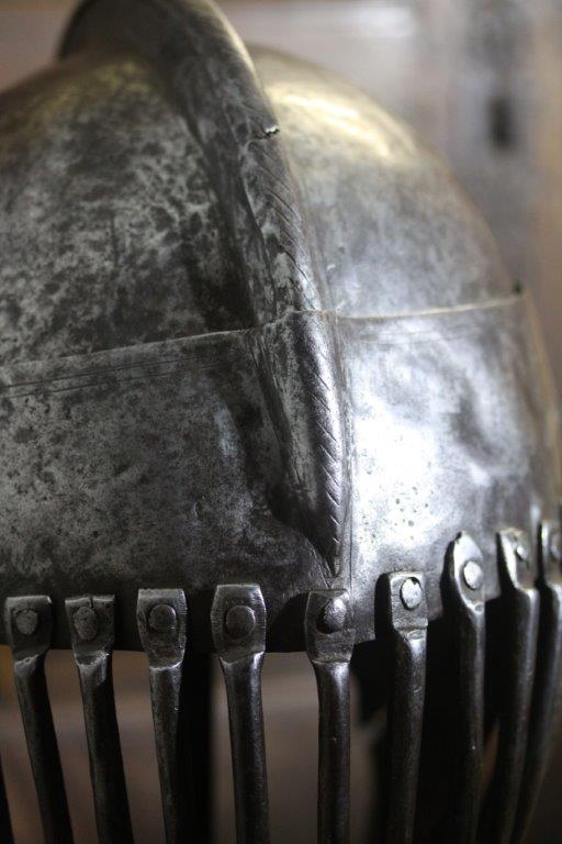

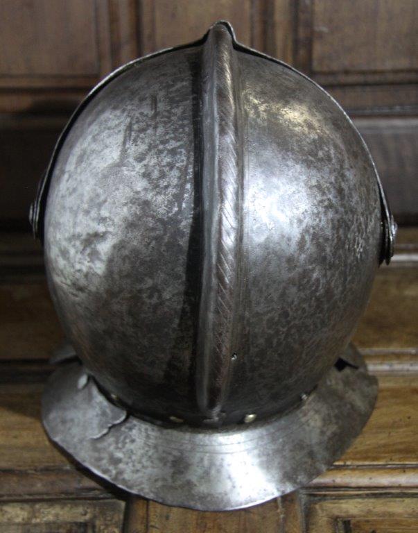

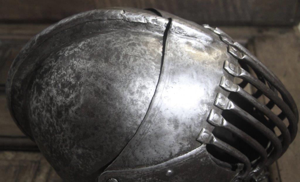

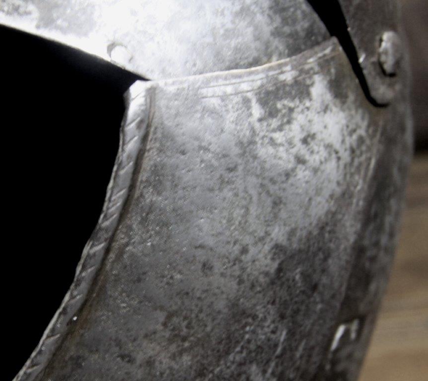

Here some pictures from an Italian visored close helmet for the Pisan with a 17TH century alteration ( Visor) specially made for the Gioco del Ponte.
Are stamped in one side the letter G and in the other side P For GIOCO DEL PONTE
Any comments on it are welcome.
Best
Cerjak

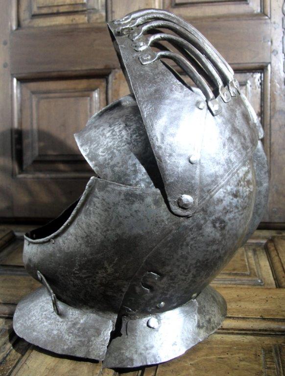

Old 2nd November 2014, 06:03 PM   #2
Cerjak
Cerjak's Avatar
Join Date: Jan 2012
Location: FRANCE
Posts: 1,065
Default more pictures
more pictures

Old 4th November 2014, 12:41 AM   #4
A Senefelder
Join Date: Jul 2009
Posts: 214
Nando, actually Jean contacted me about both before buying and they both seem to be nice examples of interesting/hard to find types. The armet with its articulating neck in the manner of a casquetell burgonet and striking visor is something not often seen and the 17th century Italian closed burgonet is also a somewhat tougher to find variant of the burgonet family. Based on the pics he sent to me I believe he's done well with these two.

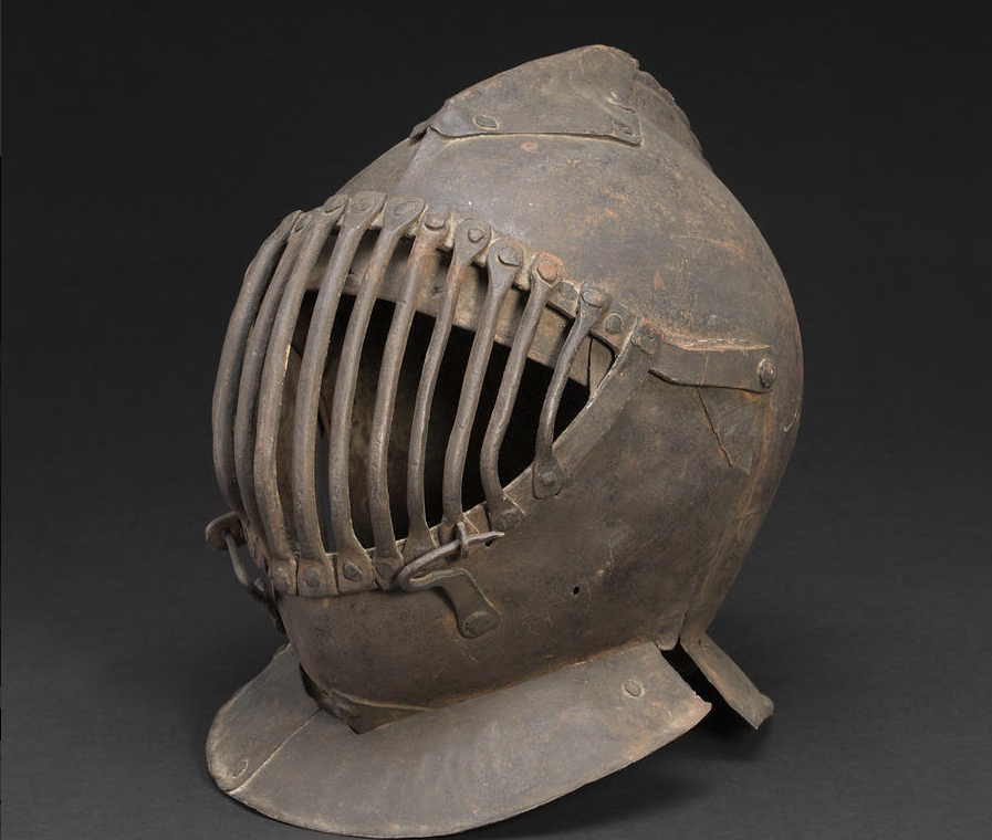

Default G P stamped signification

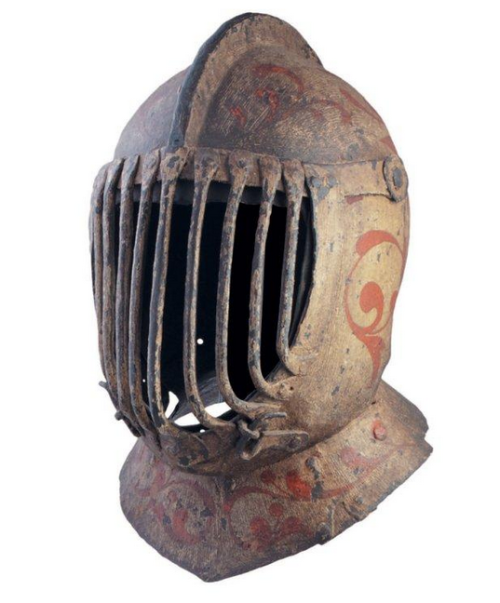

about the G and P letter stamped in each side I found two explanations :
according to Christie's 'GP' (for Galleria Prima), or as I wrote previously G P for Gioco del ponte may be Lorenzo know ...
Also some extra pictures: one similar and one beautifull painted .
