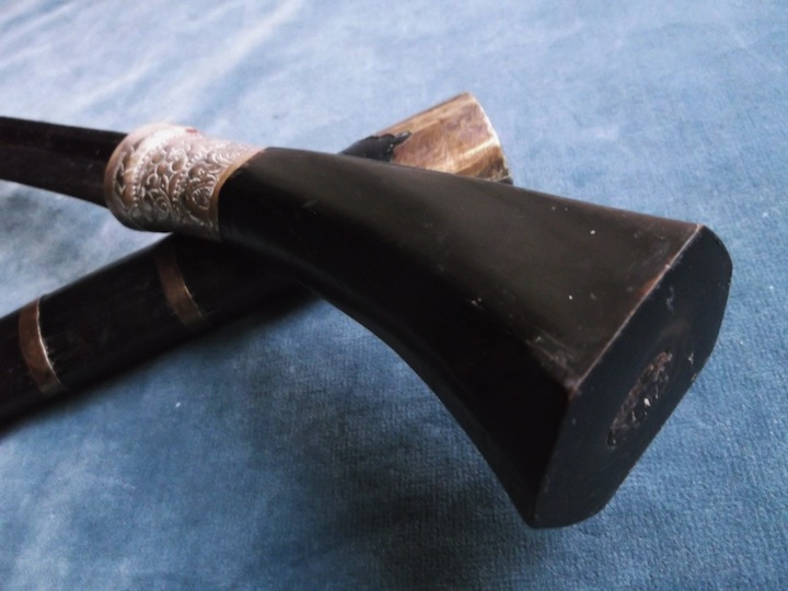

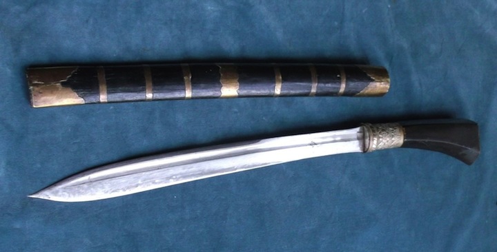

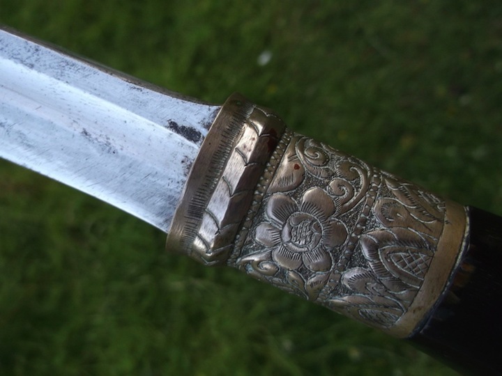

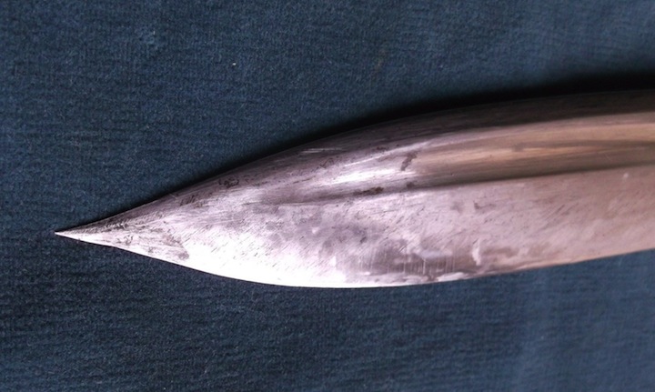

This auction just finished and I wonder if one of our Forumites is the new owner.
The knife/sword appears to be from a cut down longer dha/daab blade. There is a ferrule that runs all the way through to the tip, and it appears that the tip has been reworked into a tapered point in the fashion of many Burmese, Thai or Cambodian knives.
The handle is unusual. It has a brass ferrule with some vegetative designs, and an hexagonal horn handle that flairs towards the end. The hilt has a partial tang. The shape of the horn hilt is reminiscent of Malay hilts, and I think it is most likely from southern Thailand.
The scabbard, however, is in a well described Lanna/Shan style and therefore of a northern Thailand origin.
So we appear to have a marriage of conflicting styles, and I would say that the sword/knife and its scabbard did not start their lives together.
I cannot confidently assign the style of vegetative decoration on the ferrule to a particular group. Perhaps someone else can provide some more precise guidance and identify the origin of the changes made to this dha.
Ian.

Hi Ian,
The hilt is strange to me, Hmong Vietnam mountain flavour to my eye but the material is equally at home in mainland SEA and looks practical enough for a large knife.
The rest of it looks Burmese to me, the scabbard and its fitting types/design, the low quality repousse white metal and the blade. All typical features of Burmese Kachin swords.
I do not think the blade is recyled as there is a forward curve and the the rest of the features are typical Burmese...as far as pin pointing exact minority/region of Burma I dare not guess.
If I was to throw it out there I would consider it East Burmese Kachin region.

Lastly, I'm pretty sure this tip has been altered. Some of the seller's pictures show a different hue to the last couple of inches at the tip compared with the rest of the blade. The final version of the tip is not found on Burmese dha and the Thai forms of pointed tip on sword length dha are more rounded and not as tapering as this example.

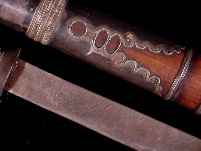

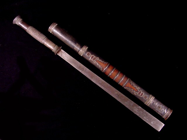

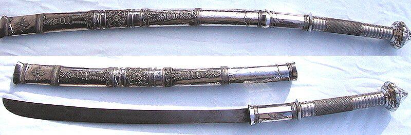

Just to highlight the ambiguity that exists between designating dha as "Kachin" or "Shan," consider this example that has extensive silver work on the hilt and scabbard.
The blade is clearly in the straight, narrow, square-ended style that we associate with the Kachin and it has a characteristic Burmese hilt with the symmetrical silver ferrules flanking a silver wire mesh central section. Ten years ago, I would not have disagreed with anyone who called this a Kachin dha. But I don't think that is the correct designation today.
Instead, I would call it a Burmese (Shan) dha made in the Kachin style. Why Shan? Because of the silver decorations on the scabbard, which are very similar in style to the decorations on sword C0052 in the Dha Index. Note particularly on the one shown here the UUUUUUU wire design on the silver ferrules of the hilt which is also seen on the top and bottom pieces of the scabbard in the pictures below. The sword and scabbard came from the same place and I have no doubt that they are original because the sword fits perfectly in this scabbard. An excellent example of Shan work IMO.

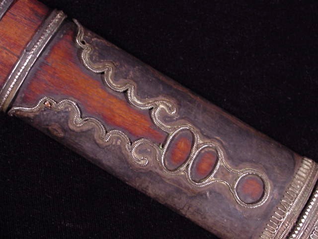

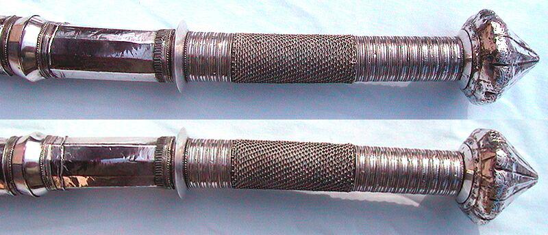

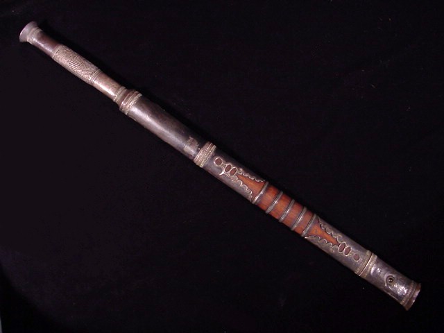

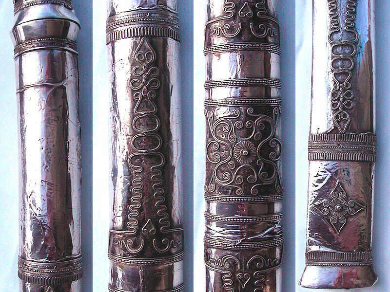

Default Silver Dha from the Dha Research Index (C0052)
And for comparison with the last example I posted, here are the pictures of my silver covered dha that appear on the Dha Research Index. Note the similarities in silver work on the scabbards, and again the UUUUUUU shapes in silver wire work that seems so typical of Shan work. The hilt on this one is what I have called Shan/Lanna, except for the wire mesh hilt which is indicative of Burmese influence.
Again the fit of the sword in the scabbard is perfect and another fine example of Shan work.

I should make my position with this knife in the original post clearer as the use of the Kachin has clouded the conversation about it somewhat.
Firstly the age of the dha in question should be looked at, it is modern. I quantified modern previously and I don’t think I need to repeat modern throughout the points I make below as the whole knife is of modern times.
The dha knife must then be looked at in modern context as there is nothing antique about it and it is too far removed from antiquity to draw too many parallels other than what is at face value.
The specific, plain brass and white type of banding in this style and placing on the scabbard is Burman. They are seen on the longer Burman sabre type and are seen on the longer Burman kachin blade type.
The blade type, starting at the root is a Burman blade. The spine and fuller speak volumes in this respect.
The tip we can go back and forward on many times but my opinion is that it was made this way.
If it was a shortened sword it most certainly was reforged rather than reshaped and broadened in the belly and a piercing tip added.
I would consider the tip and handle as a smiths or owners personal preference rather than a modern sub category.
I think it is too far a step to consider Malay for the handle when the Hmong are so much closer in culture and location.
Personally, the Lanna attribution is not added value, it only clouds the waters when speaking outside of the Lanna kingdom time frame. Trying to be so exact on one hand but not on such a critical aspect of classification is amiss.
It would be much more appropriate to express, especially when discussing research of an item to name the culture and locality as you did. Referencing Lanna can be done when referring to a specific item or design from the period.
Back to the scabbard fittings manufacture and the specific flat crude modern type that they are.
These are 95% on the time found on Burman proper swords and Burman Kachin blades types mentioned above.
To follow a massively consistent aspect surrounding the scabbard fitting type having such a relationship with these two Burman blade types it would be fair to say the knife discussed is Burman with specific cultural influence added in the hilt and blade tip. The types are so plentiful in the market place and in collections that it must have been quite a manufacturing centre to pump out so many.
The Shan aspects and sword presented should be held for a separate discussion as it is from another time period altogether.

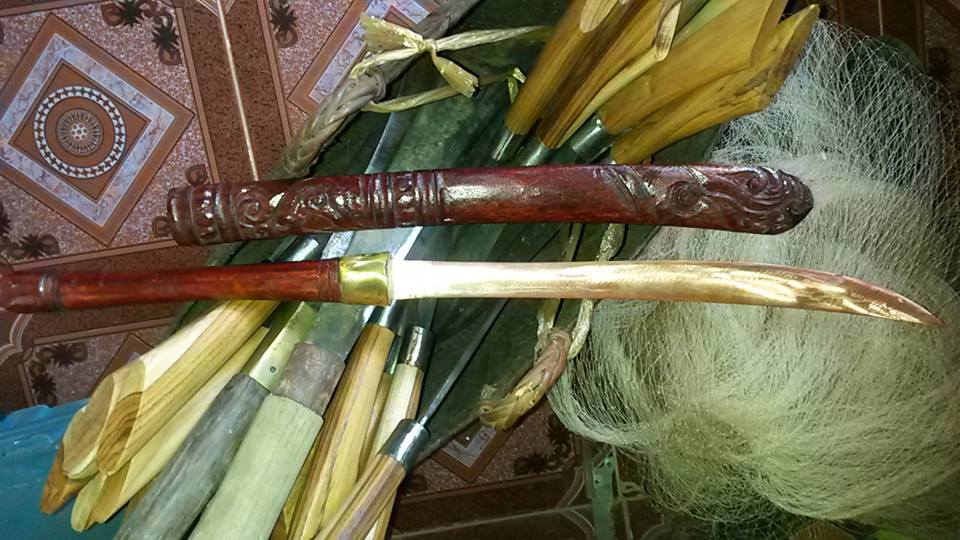

Default Modern day
The hilt form is still made and used in Modern day Laos, see the image below.
I am unaware of the specific region these were seen in but in relation to the original item posted, perhaps, as a random stab in the dark, Akha made/influence in Burma with old Hmong influence to the hilt. I see there is well documented modern Akha Kachin relationships in these borders too.
