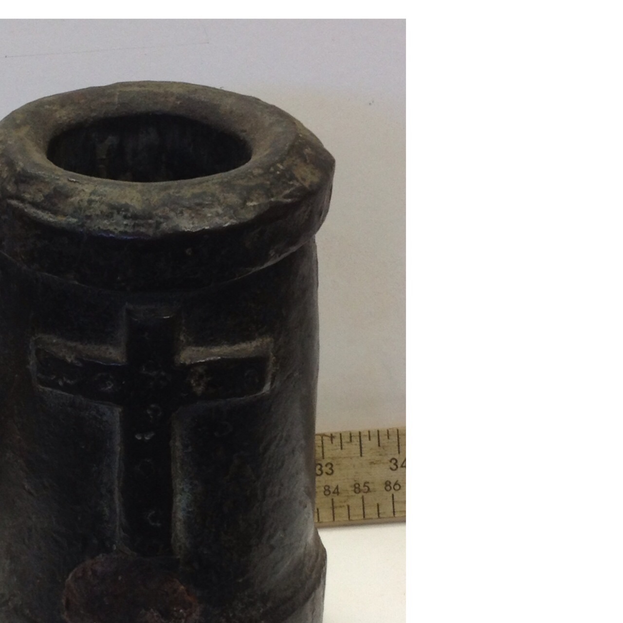

Gentlemen:
Some time back I picked this item up at an estate sale. The bore is roughly 2 inches in diameter. I included a ruler in the photo to give an overall idea of the scale. The bottom was filled with lead a long time ago up past the vent, which has been spiked by what appears to be a large headed iron nail!
It just reeks with character, and I have no intentions whatsoever to do anything to it.
My guess is that it is either French or Spanish, circa 17th century, but I defer to you guys, as my experience with firearms of this early period is limited!
Any info or ideas as to its point of origin and age would be appreciated.

Sorry, I am a beginner with a new resizing app. Here is a better image.

Not a cannon breech but one of these multiuse 'noise makers'; in this case to go bang during religious festivities, judging by the cross. No ammunition needed, just gunpowder and a wad. It is used upright.
I wouldn't think that it is spiked to avoid its functionality but to have a new life ... like for melting lead, as per your words.
The one (among several) that i have with a cross was bought in a French site.
They can be very old. Difficult to precise; maybe someone with more knowledge.

Hi Shakethetrees,
Don't let yourself get troubled.
Congratulations on the acquisition of what is doubtlessly a fine and very rare detached brass/bronze breech piece (chamber) from a breechloading wall gun, with its barrel mounted on a tripod or a wheeled carriage (German: Bockbüchse or Doppelhaken auf Bocklafette), and dating from the era of the Emperor Maximilian I, ca. 1500-10.
The barrel, originally cast together with a number of such interchangeable breech pieces, thus allowing rapid firing, was most certainly wrought at a Nuremberg or Tyrolean bronze foundry workshop which also specialized in church bells.
As a religious symbol, the cross on your detached breech piecewas cast in high relief integrally, and contoured by chiseling afterwards; the punched decoration of circles is characteristic of many wrought iron barrels and other items of ironworks or wood all made between ca. 1490 and 1530.
Following the three reworked images, I attached photos of a heavy wrought iron barrel of ca. 1480/90. Its top flat, too, shows the Late Gothic/Early Renaissance standard ornament of
punched circles. On my barrel, three of these circles are struck in line.
Actually, 3 has always been the most important of basic magic cyphers, in all cultures and from the earliest times. Its most common representation in Western European art history is the
Late Gothic/early Renaissance trefoil (German: Dreipass).
As I stated formerly, the trefoil ornament originally
derived from the shape of a bunch of grapes, being its most simplified and stylized representation, and contemporarily used by artisans of all arts and crafts alike - except when it came to illuminated manuscripts and illustrations in printed books. These arts, as well as paintings, engravings and woodcuts, to name just a few, usually depicted the real grapes, mostly within a running grapevine pattern.

The general stout mug-like shape of this breech piece, as well as its rear (German: Bodenstück) and forward (German: Mündungskopf) bulged reinforcing sections, all account for a close and early dating of ca. 1st decade 16th century.
Please cf.
the dating criteria defined and set up for the first time ever by me:
http://www.vikingsword.com/vb/showth...dating+barrels
http://www.vikingsword.com/vb/showth...t+iron+barrels
What is most remarkable about your item is the fact that the touch hole got spiked
at some later date, with a wrought iron nail.
That simple way of rendering a cannon uselesss within seconds was a practice commonly applied in war - after the line of cannon
got overrun by the enemy's cavalry of infantry.
Spiking (German: das Zündloch (einer Kanone) vernageln) was also often employed as a means of repair to close a burned-out touch hole that allowed too much gass loss. The spiking done, a new and smaller touch hole could be either right struck while the nail red hot, or drilled.
In the case of your breech chamber, it seems that the gun it belonged to saw secondary use which as quite different from its original purpose: to receive, hold and eventually blow out a load of black powder, and a wooden muzzle plug, all of which would finally expel the ball ...

I am sorry if i gave you a wrong perspective on your item. It wasn't a bad intent; only the way i saw it ... and still do .
Old 1st August 2014, 06:27 PM   #9
Originally Posted by Shakethetrees
... reinforces at the muzzle and breech ...
It was precisely these rims that took to realize that this wasn't a breech chamber. All chambers that i happen to know (and those that i keep) don't have any protuberances in both back and front. Such features do not help at all the matching of the chamber with the breech cavity and barrel entrance ... specialy considering that, once the chamber is introduced in the breech, you have to push it into the barrel and, in some cases, rotate it.
Actually what is often seen is a significant tapering of the chamber mouth, to provide for a better sealing when you push into the barrel.
Although i found somehow problematic that the front of handle is placed so far and close to the mouth, nearly preventing the chamber introduction into the barrel.
The absence of a lip in the touch hole, although often seen in noise makers, doesn't exist in many other cases; probably because in such case a match fuse is used, instead of loose priming powder being poured.

I don't think it is a breech block from a breech loading cannon.
Breech blocks don't have/need reinforcing rings and the mouth of the block must be conical/tapering to to obtain a good seal.
I believe it is a thunder mug, but probably a early one 17th, 18thC . see large picture.
