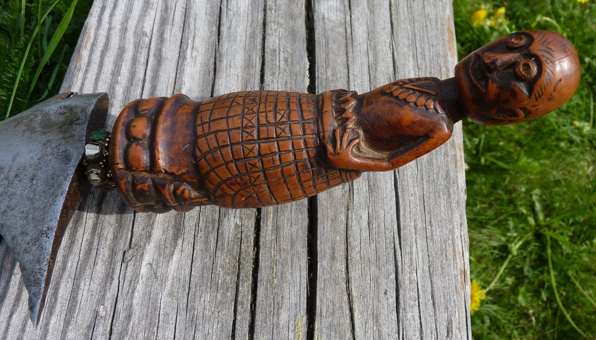

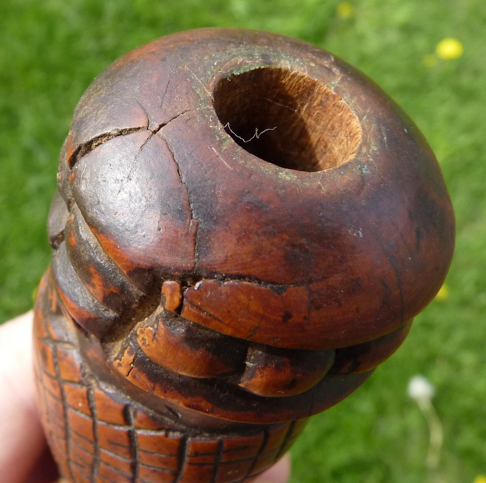

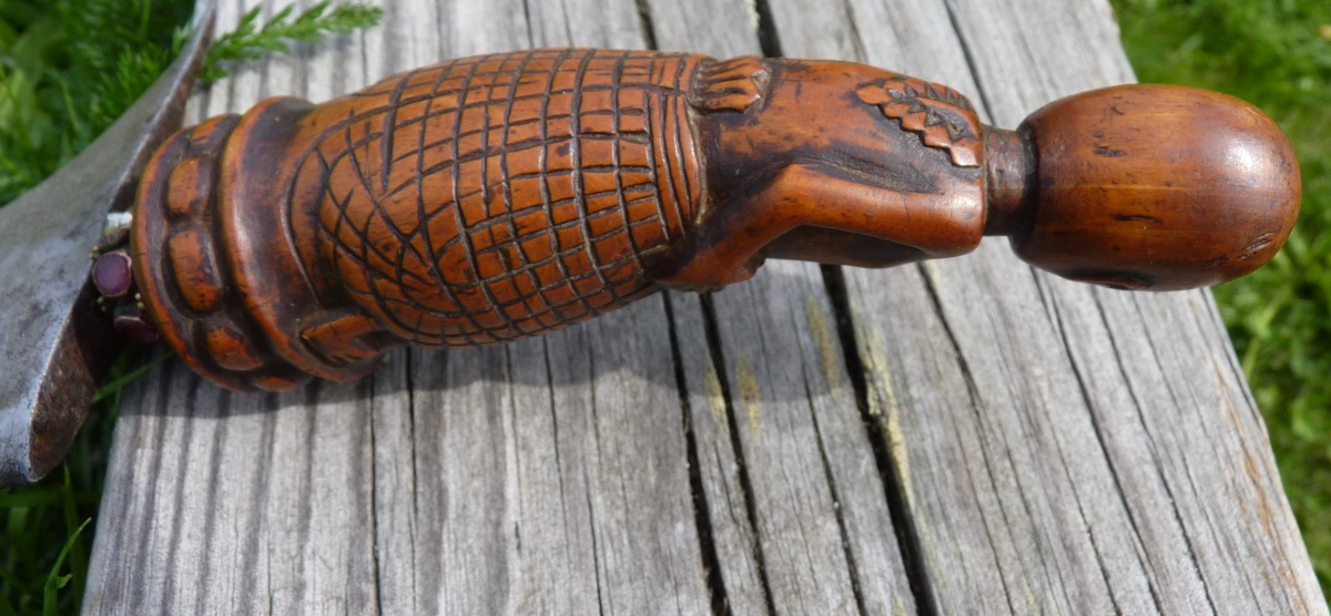

This keris is a result of my itchy auction fingers. I was bidding on one of those auction houses where there are five items at the time and you have like 30 seconds to bid. I was actually bidding on something else but since I was going to pay for shipping anyway my itchy finger bought this keris. I like primitive art and like the handle that was all.
I know very little about keris since it is outside my field of intrest. What I have concluded is that it is most likley missing its ganja, the upper most part of the blade. The mendak is crudly made and some of the "stones" look like there made of some sort of resin. The handle is actually made of wood, when I looked at the auction pictures I feared it was resin but it is not. The patina on the handle looks artfical to me but at the same time it feels like it has age to it.
Also there has at some point been someting in the eyes that is now gone.
So any comments regarding age and origin would be welcome.

I would attribute this rustic but old & interesting piece to Lombok from the hilt especially.
Yeah, the ganja looks like missing but I am not fully sure from the pics as the wadidang (rear part at the bottom of the blade) is quite long, and is the pejetan extending to the bottom of the blade or not?
The indistinct pamor pattern seems to be Uler Lulut or equivalent.

It also looks like it could possibly be an iras blade.
There is one in my collection with a very similar pamor pattern that is a close cousin of this fellow.
From what i can see Jean i think i would e willing to accept this as gonjo iras. As you note, the wadidang fairly long and if i am not mistaken i believe i see the remnants of greneng along it.

Yes, ganja iras is a fair possibility, the bottom face of the blade is smooth, but if it is the case I would say that the sor-soran seriously lacks harmony! (gandik too short, poorly carved pejetan, kembang kacang, greneng, and curvature of the bottom face).

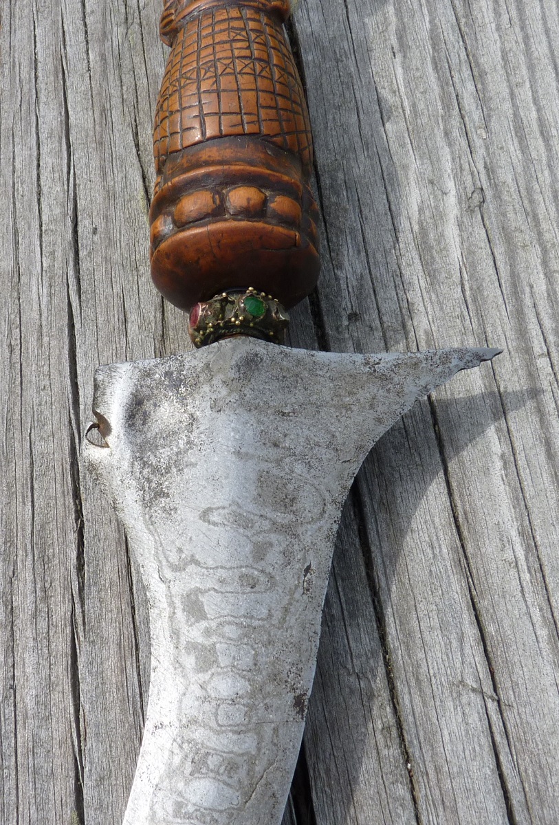

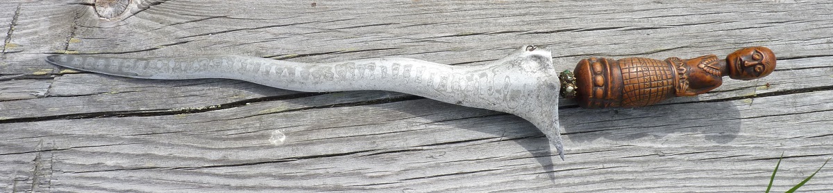

I have etched the blade. Perhaps I could have etched darker but I stopped when I thought it looked allright, no point in overdoing it. Anyways, sharing some pictures of the result.

What did you use to etch this blade?

I read that the correct way to etch keris is with arsenic and lime. I had lime-juice but no arsenic, lime juice alone did not etch at all. Lemon juice did not do much either. Finaly I tried dilluted Ferric Chloride (about 20%) that etched pretty quickly, I did not etch very long since ferric is rather strong.

I think if you used arsenic & Lime you would see a reverse effect.
Almost like negative to positive in photography.
My cousin to your blade was done with arsenic & lime.
I don't know if you can get any where you live, but iirc it must be white arsenic.
Interesting. I cant get arsenic here so that is not an option. But it would look better if the effect was reversed. Is there any alternetive method that would produce a result similar to arsenic and lime?
