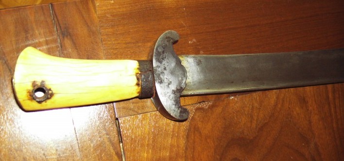

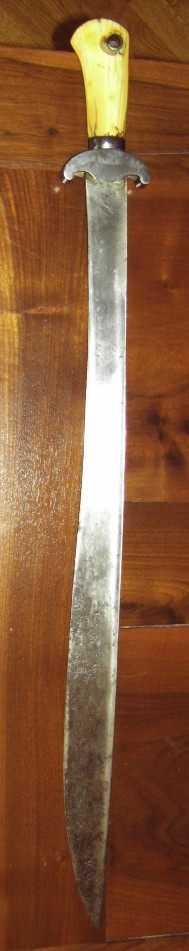

Hi!
I've been offered that puppy and I don't actually know what it is. Seems a german reinterpretation of a turkish yataghan The hilt is ivory? and the quillon section seems verry german to me or might be actually turkish simpler design of their WWI ordonance swords. The blade i verry plain and no decoration on it apparently. Is tat some sort of turkish ordonance short sword/dagger ith obvius simplified design?

Looks almost like a hunting sword
Old 2nd February 2006, 07:02 PM   #3
Posts: 6,027
The guard has a Chinese look which I am not sure is quite right it just seems a little ill fitting. I am also suspicious about these file marks? Tim

I am really sorry, I am hitting this pretty hard. The lanyard hole in the handle does not look as if it is through a tang, central to the blade or from the blades back. I am not sure the handles are blind like this on yataghan, if that is the correct terminology. Tim

This looks like a composite sword to me? Yataghan blade with a European style hunting sword hilt.

Yeah, I'm with you Louie on composite puppy.

It might be wise not to write this sword off too quickly as an assembled piece.
I recall there was a thread a few years back regarding the Pandors, in fact there was even a photo of one forumite dressed as one? They, among others, used such hybrid weapons-- or influenced them, in any case. There was endless warfare throughout the 17th and 18th century between the Turks and most of the Eastern European powers. This is probably a captured Ottoman blade fitted up for a German or Austrian. The bladeform is consistent with an earlier dating, and this type is also often pattern welded.
Though the grip is provincial relative to others I've seen, I will venture a guess in the latter 18th century. Someone who is more knowledgeable about this form of guard can probably place it within a decade or two.

If it is an assembled peice, it looks like the work was done quite some time ago. It also looks as though the new handle failed in use. So whomever bought this thing intended it for more then a simple wall hanger.

I am with Battara on this one. I suspect this has been assembled fairly recently. I too feel the guard is Chinese and recent, just have a look at the guards on some of the Chinese offerings from ebay.

Tell you what, gentlemen. If, after one of you bothers to look into how European hunting swords were hilted (in a book, not eBay please) you can confidently say the mounts are Chinese, Stout's all round on me.

I enthusiastically agree with Ham....ebay as reference resource...NOT!!!!
I also concur with Ham on his assessment noting the very plausible Pandour associations with this weapon, and I would consider this sword homogenous, although possibly taken apart in restoring or cleaning components.
The Pandours were essentially auxiliary units of the Austrian army during the reign of Maria Theresa, who very much influenced subsequent units that were added to the armies of several other European powers.
These swords were basically fighting variants of 'hunting' swords, or couteaux de chasse and these evolved from similar hunting or riding swords of the 17th century. The Pandour examples were of mid 18th century, and this example may be one of the form probably used by as a fighting sabre by European officer in one of the latter auxiliary units modeled on the Pandour regiments. An illustration of these Austrian Pandour attributed swords is found in "Les Armes Traditionelles de l'Europe Centrale" by I. Lebedynsky (p.69) and the deep bellied blade is virtually the same. While the decidedly oriental crossguard seems atypical, one of the key elements of the dress of these Pandour styled units was the fearsome appearance enhanced by varied and fearsome looking oriental garb, scalplocks and drooping mustaches etc.
It would not seem unusual that such a guard might have been added on one of these swords.
This example may be a yataghan type cavalry sabre of possibly Balkan or Austrian use from latter 18th to early 19th c.

No ebay is not the new bench mark. I still cannot see this as a genuine hunting weapon. In Europe hunting was and still is in many cases the preserve of the rich. This knife is not that. I prefer bitter it is sharper and lighter to taste. Tim

That is very interesting Ham and I will agree that you have shown a similarity but just look how weak the handle of the one in discussion is, and then compere it to the one you have post. What do you make of the fresh file marks? Tim

As for the scratches on the guard, I can barely make them out I'm afraid. However given the condition of the ferrule relative to the guard, I would suggest that the scratches are indicative of cleaning which was more enthusiastic than skilled. Finally, I don't seem to be able to find any Chinese swords in any of my references with guards that bear more than a vague similarity with that of the one under discussion. Can you provide an example please?

Oh boy I know I am gonna get it now, taking on both Jim and ham, But, this one smacks of a pieced together specimen. At minimum it has been heavily and poorly messed with. 1) I will start with the corrosion on the hilt lanyard rivet and ferrule are completely different than the guard and the blade. Accepted that the guard and blade have been heavily cleaned, but I would expect more pitting if it started the same. 2) the ferrule is broken, that is usually a sure sign that the hilt has been switched and did not fit correctly. 3) the ferrule does not fit the guard ie; it doesn't curve to conform to the curve of the back of the guard. is that a piece of leather in between? lastly and the weakest 4) the over all appearace is "off". Now I will brace my self for the replys . As ham has stated this is a pleasure.

Jeff, my thoughts exactly. The handle although ivory is so clumsy on this weapon especially as it is purporting to be a gentleman's accessory.
