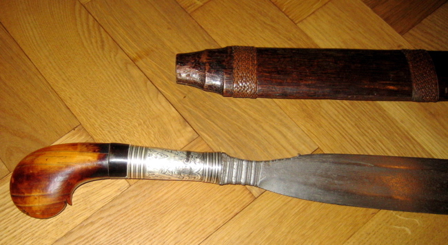

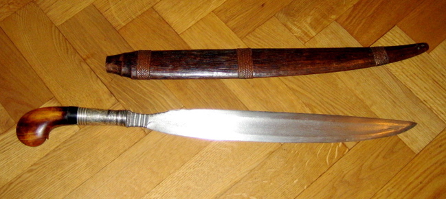

The second strange blade I found has a Barong resembling
blade with a broad fuller.
It's much lighter than an ordinary Barong.
Ivory hilt and silver ferrule with flowery pattern.
Any ideas what it could be?
Old 6th February 2006, 11:46 PM   #2
LabanTayo
LabanTayo's Avatar
Location: Kansas City
Posts: 177
michael,
dang, where do you come up with these pieces???
thats one hell of a mixbag of influences.
it looks like a cut down barong, rehilted in Leyte.
i'm stumped too. send it to me so i can study it.

Old 8th February 2006, 12:49 PM   #4
VVV
VVV's Avatar
Posts: 1,637
I recieved an e-mail from another collector that he think this is a Moro Shandigan Barung with a variation of the Naga hilt (see Cato).
I find this info very probable.
Old 8th February 2006, 02:49 PM   #5
Posts: 6,429
I can see why he would think so but the barring on the blade and the way it is cut down to a neck at the hilt seems very un-Moro to me .
I (like Shelley) wonder if it has not been modified by another culture .
Is this blade chisel edged (flat on the other side) Michael ?
Can we have some more pictures ?
I'd like to see the detailing on the punto and the other side of the blade .
Old 8th February 2006, 05:20 PM   #6
VVV
VVV's Avatar
Posts: 1,637
Rick, LabanTayo and others,
Here are a couple of additional pictures.
The blade looks identical on both sides.
Please note the peculiar small hook close to the hilt?
Look forward to your comments.
Old 8th February 2006, 07:30 PM   #7
Posts: 6,429
Arrow
I've got to admit to being stumped .
The decoration on the punto does not strike me as quite traditional okir patterns . The blade seems a bit thin for a barung but I have never handled a shandigan so I may well be off on this observation .
What is the material between the ivory and the punto ?
The filework at the forte of the blade is pretty puzzling as it does not quite look like the work seen on tenegre/sansibar/binangon blades .
Maybe we should be looking toward Borneo ....
Old 8th February 2006, 08:12 PM   #8
VVV
VVV's Avatar
Posts: 1,637
Rick,
It's a horn ring.
I have seen a resembling decoration as on the silver on two of my Melanau
(NW Borneo) parang - a Sadap and a Parang Pedang.
Enclosed pictures for you to compare.
Otherwise usually the Melanau parang have heavy and thick blades.
I just noticed that there are 3 dots in a (female) triangle at the bottom
of the scabbard which is usually attributed to Sumatra?

Old 10th February 2006, 06:33 PM   #14
MABAGANI
MABAGANI's Avatar
Posts: 221
The blade shape, forte and scabbard point towards a rehilt of a Moro spearhead. There's too much metal around the forte to be a cut down barung. I've seen this forte form on a kris shaped spear. Double edged barung usually go half or two thirds of the blade spine, this shape goes down much of the rear. The punto design is still consistent with Sulu ukkil and the horn ring is not uncommon. The pommel is odd in that it was made to match the hook on the blade, intentionally designed to show that it was not a traditional barung. Possibly retired to a sword or rehilted to look like a sword for trade, nicely done work. Thinking out loud, btw...lolz.
MABAGANI is offline   Reply With Quote

Old 11th February 2006, 09:29 AM   #17
VVV
VVV's Avatar
Posts: 1,637
Hi Spunjer,
It's 4,5 cm. Nice thread with some great spearheads, thanks.
And my blade is just slightly longer than the XXL Budiak posted.
I do have a Budiak so I put them next to each other.
From bird perspective I agree that there are some resemblance.
But looking from the side the Budiak resemblance is lost.
Also my blade has both a different tip and tang than a Budiak.
If you look at the blade thickness picture above it's obviously much flatter
than a Budiak and thinnest at its center.
Maybe Mabagani had another kind of spear in mind?
