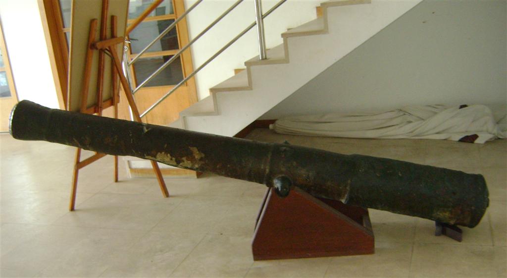

This cannon was found some thirty years ago at 3 Kilometers from my hometown (Portugal Northern coast), a couple hundred meters from the shore.
A couple young divers, maybe for reasons due to its large dimensions (some 3 meters) decided to give it to the local Naval club; not without resistance from the next city and even Lisbon Museums.
It has been placed at the inland historical club entrance for some thirty years and later moved to the club's marina restaurant entrance, a much more recent construction.
For reasons connected with lack of investigation interest, neither the divers nor the club management (a rather small institution) ever cared to identify this cannon which, in my humble opinion, belonged in a foreigner ship. All i managed to know so far is that there are more where this one came from, although of cast iron, reason why the young divers had no interest in bringing them up, aware that special equipment and immediate treatment were required.
I have taken a couple poor pictures with the intention to post them here in the forum, with the remote hope that its details would sufficient to identify its possible age and provenance.

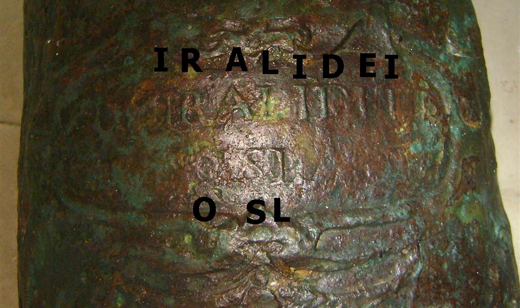

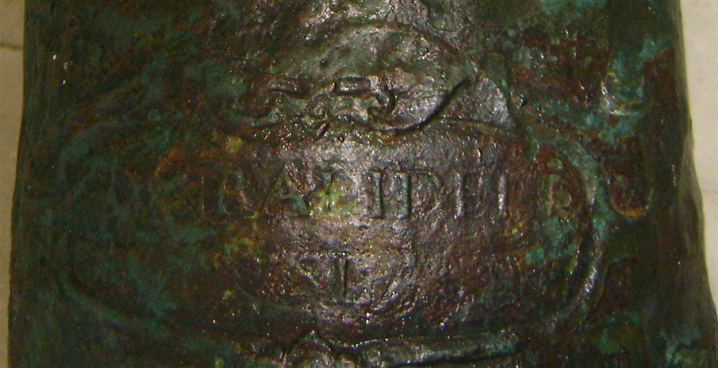

So ... no gunners around ? .

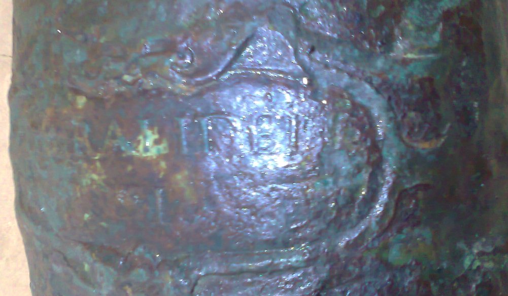

Here is the poorest atempt in dechipering those letters, which meaning ... has no meaning to me

If it wasnt for the inconvenient couple of letters in the middle it would be 'IRA DEI ' ..wrath of God , which seems a great name for a cannon !

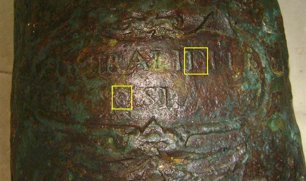

To my untrained eye, it looks like the ending is an 'EU' vs 'EI". The last identified letter seems to curve that way. Perhaps ending in '-eus', like 'Perseus' or "Maritaneus'. The construction of the gun itself, being bronze and relatively plain compared to most Spanish and Portuguese pieces makes me think another nation. As most nations highly decorated their pieces, could this perhaps be from one of Portugal's colonies? I keep thinking that it looks rather like many of the early petraroes I've seen. Not as decorative as the lantakas, more plain, but some were undecorated I believe. The Portuguese and Dutch were throughout Indonesia and Borneo. Could it have been made in Brunei or being shipped to such places? Very much thinking aloud, so don't mind me!

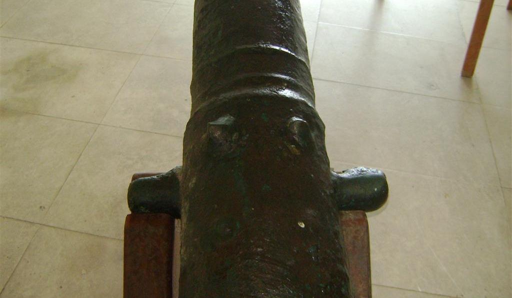

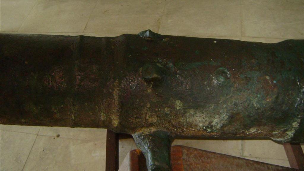

Just noticed that the trunnions are not centered on the sides of the barrel. We see this on smaller swivel guns and cannons meant to be angled sharply downwards on a ship. Perhaps this detail may help in identifying nation?
Thank you for the nice suggestion , although assuming the extra letters impede such composition. Even probable Latin subsidiaries, like Castillian (LA IRA DE DIOS) and Portuguese (IRA DE DEUS) don't do it .
Ah, Captain ... i though you'd never come
Not that my eyes are sharper than yours (much older than you ) but i don't see in the faded letters the kind of composition you are aiming at .
I agree that Portuguese (and Spanish) guns would have more decoration, Royal insignias and all. But when you think about great conflicts requiring gun casting under emergency needs, i don't know.
One non solid possibility is that this cannon was equiping a ship of the Invencible Armada which, after all odds, ended up wrecking all over. The basic fleet departure was Lisbon and the return of the surviving ships was in Galicia, not far from my hometown.
... And it is assumed that a great number of the Spanish cannons were made in a hurry and assumedly of low quality.
Yes, we had foundries in Asia (Goa and so), but i don't see them cannons coming all the way to wreck in my shore; and those would be also decorated all the same ... or again, not.

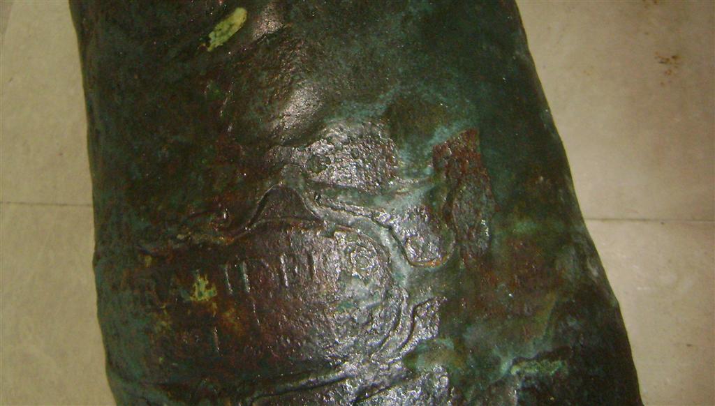

One detail that would put some light into this is the lower short inscription; not being the casting date, as the figures look more like letters than numbers, it could be the foundry place.
Not sure whether the trunions are not centered, or passive of optical ilusion in the pictures; will go around the place where it stays (close from my habitat), to check it at naked eye.
I thank you anyway for your input; it keeps the thing warm

I have had a local suggestion that it could be Dutch ... later captured by Portuguese, during these endless wars in the XVII century; i don't know.
One sure thing though is that, it was common practice in the period nations equiping their ships with foreign cannons ... captured and acquired.
You were right in that the trunions are placed well below the barrel center; but i have checked cannons from various origins, in a catalogue of the Lisbon Nany Museum (and not only), and i don't find this to be a pattern of a determined country.

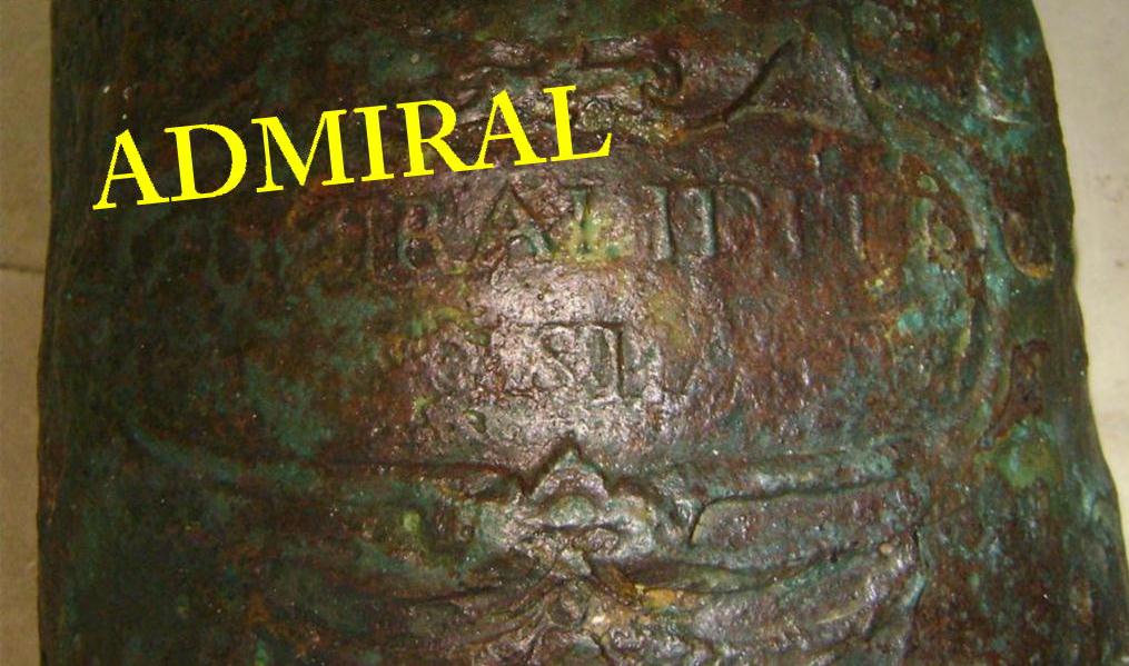

The person who suggested Dutch origin also suggested the word ADMIRAL for the upper inscription left half; something i have already considered but, don't know why, have abandoned. But i reckon it is a heavy weight possibility.

Is the word 'Admiral' spelled the same in Dutch? Very interesting possibility! My last comment I can even think to ask is, what is the bore of the gun and if it tells us anything? I know certain eras didn't have certain sizes and likewise, certain countries didn't use certain sizes. An example of what I'm saying (as I'm not doing so good a job!) were the 2-pounders used by colonial Americans, but the Brits and French smallest bore size was 4-pounder. An era-related cannon bore example were 6-pounders, which were later 18th/early 19th c. affairs, I believe. Just more guesses on how to approach this mystery gun-

in the last years of the 16th century , five different Dutch admiralty colleges were established, In 1795, in the Netherlands and Belgium the designation is Admiralty (admiraliteit) replaced by navy (marine):
the five admiralty colleges were:
1.Amsterdam
2.Rotterdam
3.Friesland
4.Zeeland
5 Hoorn and Enkhuizen

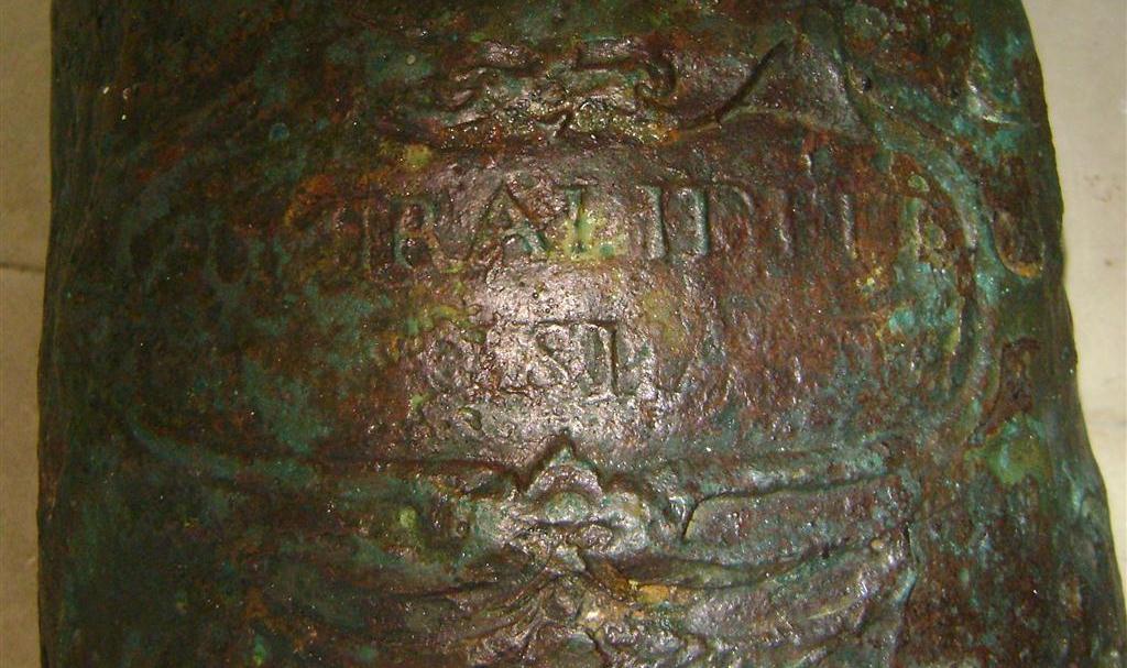

if you read embossing, one can read indeed ADMIRAITEIT and below the letters
ESL
So the conclusion is that the cannon may have belonged to the Dutch Admiralty friesland
ADMIRALITEIT
FRIESLAND
for an early one please see
http://www.friesscheepvaartmuseum.nl...n/Admiraliteit
best,
Jasper

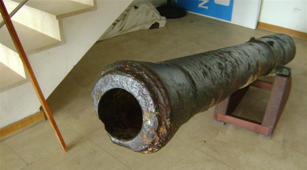

... what is the bore of the gun and if it tells us anything? I know certain eras didn't have certain sizes and likewise, certain countries didn't use certain sizes...
Ah Mark, you are perfectly right ... but this thing of determining a gun calibre is a bone hard to chew You have the concept of the pound weight along time, the gun windage (gap between ball and bore) varying per country criteria, type of gun, founder techniques and so, the wearing of the gun after several shots ... you name it.
This could be a 14 pounder, as hardly a 12 and more hardly a 15

Hi Fernando,
admiraliDeit???
a D and o does not make any sense, the D and O embossing are also very unclear I think that the oxidation did make those characters look totally different.
best,
jasper

admiraliDeit???
best,
jasper
Yes Jasper,
Forget my uncertainties; your assessment is more within reality; and fits perfectly into the considerations of Dutch ordnance researcher Nico Brinck, with whom by pure accident i was contacted, due to my query on this subject to a third party i found in the Internet:
There are only a handfull of guns known to me from Friesian gunfounders. And the guns I have seen were all cast by different founders and in different periods in the Leeuwarden foundry. So I really cannot recognize the founders by their products.
But many of them were only semi litterate, and the spelling of the words had not been established. So there may be odd letters in the cartouche, but the piece is also very worn, so some letters may have a different shape now.
Let me tell you i am very much obliged for your help, Jasper
After all, it was your input that opened the path for a more objective query, which provided the solution of this riddle.
Whereas this cannon was equiping a Dutch ship or another vessel and whether its wrecking was caused by accident (storm, misroute) or battle, is another riddle, apparently much harder to solve.

I thought i should quote Nico Brinck's words in the caliber issue; let me reconsider my previous estimate ... now appointing to a 12 pounder.
A bore of 123mm means a calibre of 13 Amsterdam pounds. Friesland used Amsterdam pounds of 494 grams.
But there was standardization which demanded that the guns should be 6, 8, 12, 18, 24 or 36 pounders. The 12pdr had a bore diametre of about 120mm and an 18pdr had about 14 mm. And there would be plenty windage so the diametre of the shot would be around 110-115mm
So this is most likely a cannon with a worn bore, perhaps by multiple firing or by erosion from the sea.

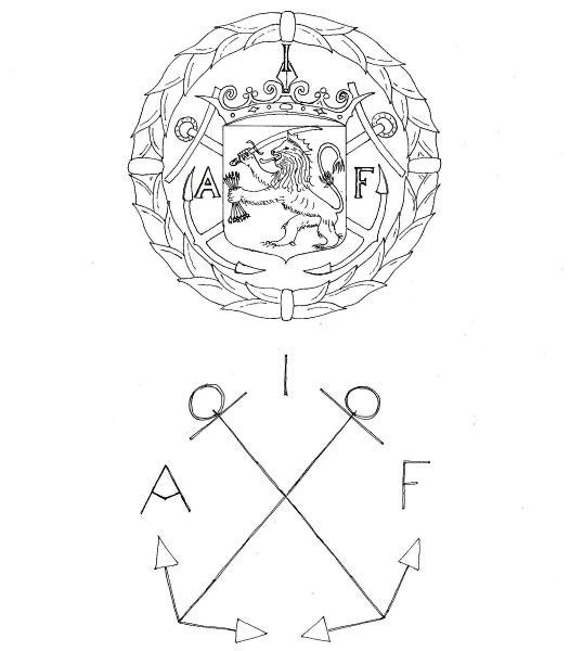

On the other hand, the design surrounding the existing letters is not strange to what is seen in other cannons of the presently discussed foundry.
I am uploading here the arms of the Friesland Admiralty, a motif that might have been in this cannon.
(designs provided by Nico Brinck)
