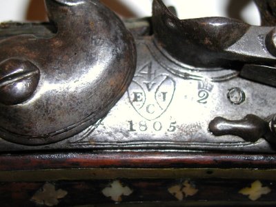

Excellent question, and personally I used to always hope to find an EIC marked sword of any kind. There have been some good discussions recently on these markings which came up with a jezail RDG posted a while back, and it seems many of the locks on these turned up on these native guns put together in the Khyber regions.
As far as I have discovered, the only weapons ever marked with the EIC balemark were the gun locks usually on muskets, and on the bayonets in 18th century to the early years of the 19th. The balemark was replaced about 1807 or so by the rampant lion, though there may have been some use of the flaunched version in certain regions. Again, I am not aware of any such use on swords, either British or native.
I would be very wary of tulwars with such markings, and if seen, would really like to look further into them as distinct anomalies which might present new perspective on these balemarks in use. As we have discussed on occasion, the EIC balemark was often spuriously reproduced by native gunsmiths in Khyber regions, in many cases well into the 20th century on gun locks. We have even seen flintlocks with the balemark and dated in 1870s!

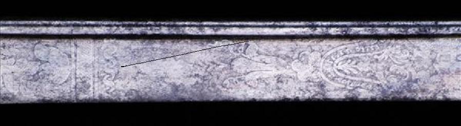

The photo is from a sword sold fairly recently, on mine, the stamp appers as an "E,... line... C".

The EIC as noted used the quartered heart, typically surmounted by a 4 (which was actually a disguised cross, issued with the heart in place of the 'orb' with reference to the cross and orb symbol ). In Bengal it seems that the 'flaunched' style heart using that heraldic feature became popular. Both were supplanted by the rampant lion around 1808.....but as noted, these did not end appearance as Indian makers still copied the stamps.
It is interesting to note that the 'V' in the acronym actually stands for 'united', not 'venerable' as is often assumed. In those days the U was written as a V.
As you have noted, by 1858, the East India Company had given way to the British government in its dominion of India.
The marking you show here seems much more modern and of commercial trademark style, and the EIC never used such a marking as far as I know. Also, as I mentioned, they did not mark weapons with thier markings except for the guns and bayonets.

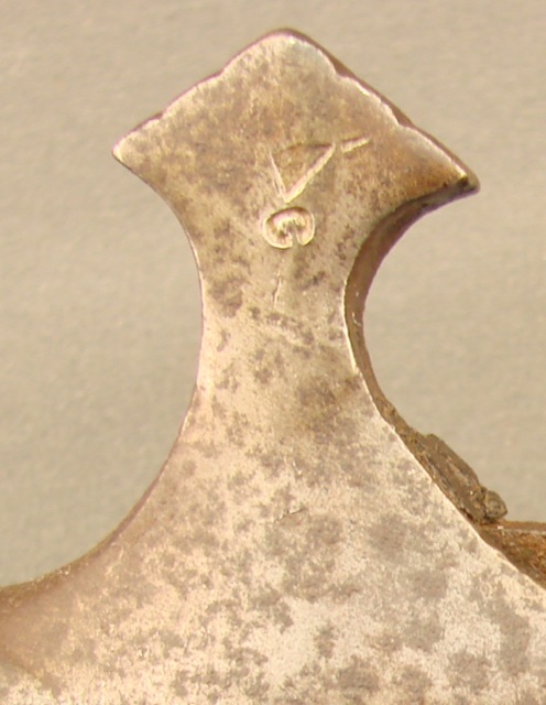

The attached pic of the tulwar quillon is one from a very well known arms dealer's catalogue.
The other picture is from an English auction house, and is of a sword apparently made for an officer of the EIC, in 1827.
(Drewatt's catalogue)
The two swords have nothing in common, but I added the hilt photo as it seems to bear the right marks, and is apparently an example of a sword marked for the company on production. (tho' this is a separate matter really!)
R.

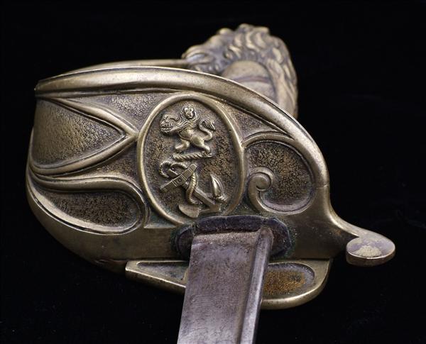

I found a group of notes from research back in '97 including some communication with David Harding, who had just completed publishing :Small Arms of the East India Company", and there were groupings of markings mostly of the quartered heart and later rampant lion.
The 1827 naval officers sword with the lion above the fouled anchor was indeed characteristic, and I have seen them on army swords as well, but as part of the hilt motif, not as markings on the blade.
Gene, thank you for sharing the pictures of the tulwar and observations, which well corroborate the triangle marking Richard posted on these swords.

Here is the blade of the 1827;
All best,

In the Khyber, they were stamping EIC markings on gun locks through the 19th and well into the 20th century.
It sounds like you and Gene have both encountered these 'EIC' or 'EIG' marked tulwars, so they must be out there in some number. Who knows, maybe during the changeover, some armoury smith who hadn't gotten the memo kept using his old EIC stamp. Its been known to happen

firstly love the rule,secondly are these stamps considered genuine?and do they only occur on tulwars?

It is always interesting to see these older threads come up, and I only vaguely recall the detail here, but in rereading the posts it seems that no conclusive or definitive answers resulted on these markings
I would point out that the discussion brought in similar markings which occurred on various arms which included tulwars.
In research on EIC markings back in the 1990s I did find out that the East India Company did not mark sword blades. The only edged weapons with such balemarks were bayonets, and the locks of firearms were so marked.
I have recently found information which shows East India Govt. pre WWI as using stamps with E -arrow-G
After that : I arrow G
Indian inspection marks were IG over inspectors number
I believe this information probably pertained to bayonets and firearms but unclear on swords.
I would like to see more examples or data on these triangle and EIG stamps as they seem to have inadequate substantiation to have been legitimately applied, their rather haphazard, incomplete and inconsistent nature notwithstanding. The letter 'C' instead of 'G' seems telling.
