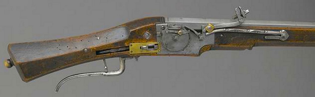

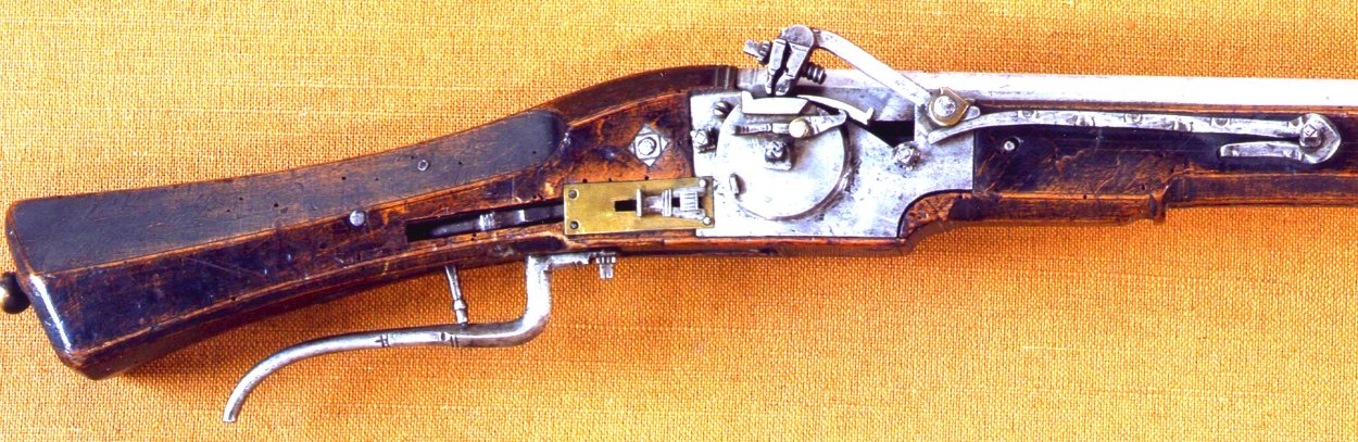

Default A Very Early Wheellock Arquebus, ca. 1530, in the Musée de l'Armée, Paris

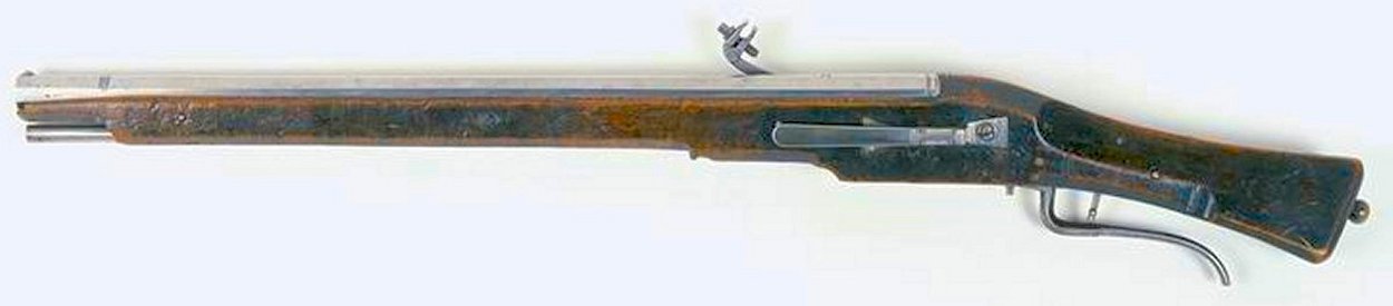

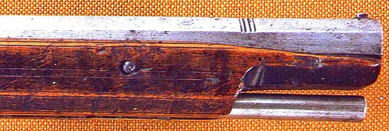

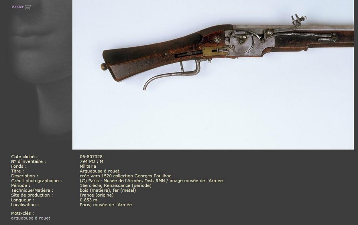

Discussing earliest wheellocks, we may not forget this arquebus in the Musée de l'Armée, Paris. It is French, no doubt, but generally dated 'ca. 1520', which in my eyes is not justified.
The earliest date I would seriously assign to it is 'ca. 1525-35', with a main focus on 'ca. 1530'.
The stock is in all probability limewood, with a lesser possiblity of maple.

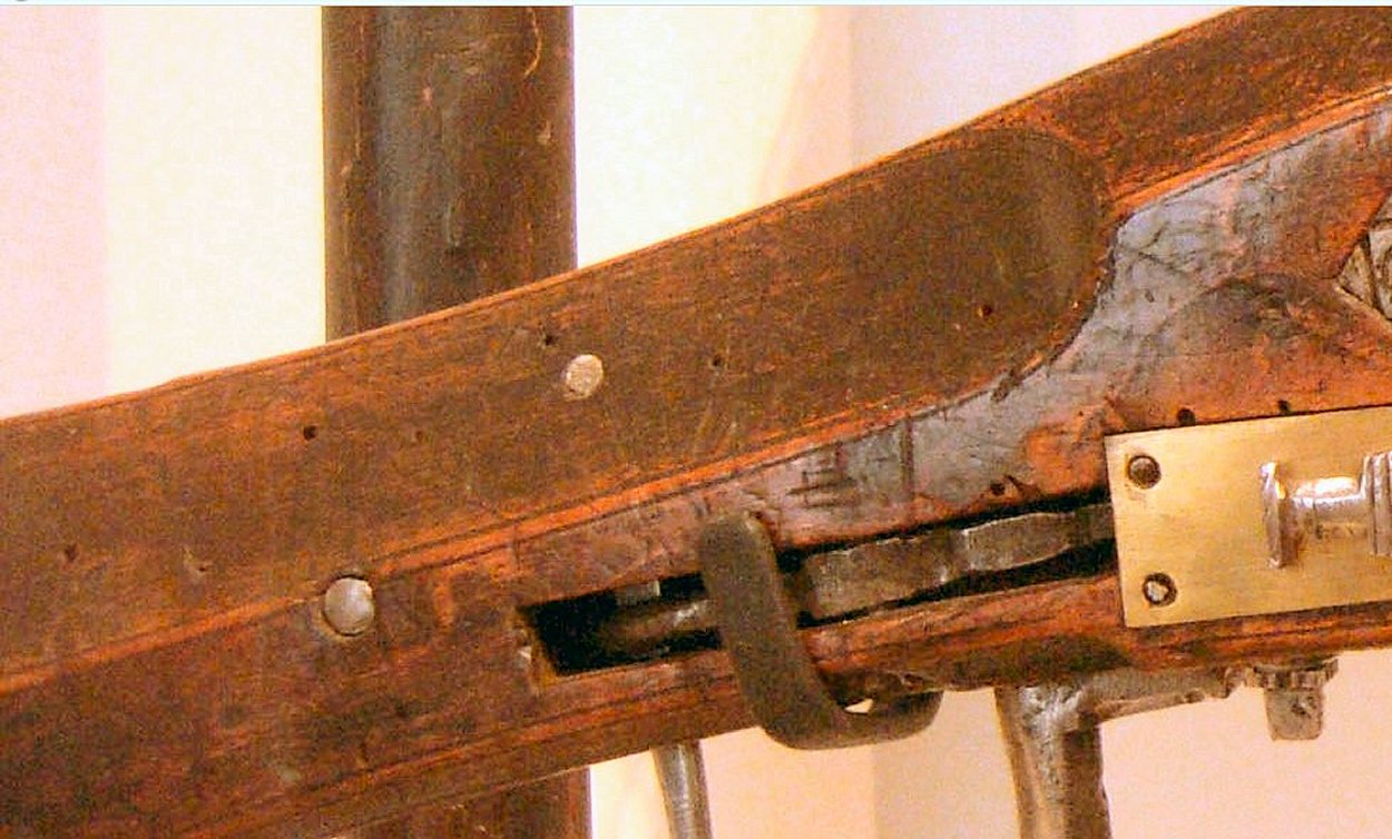

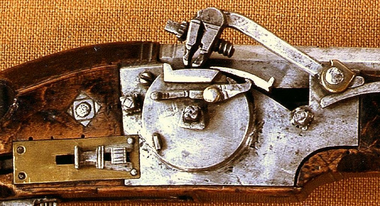

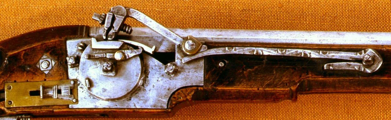

Posts: 4,310

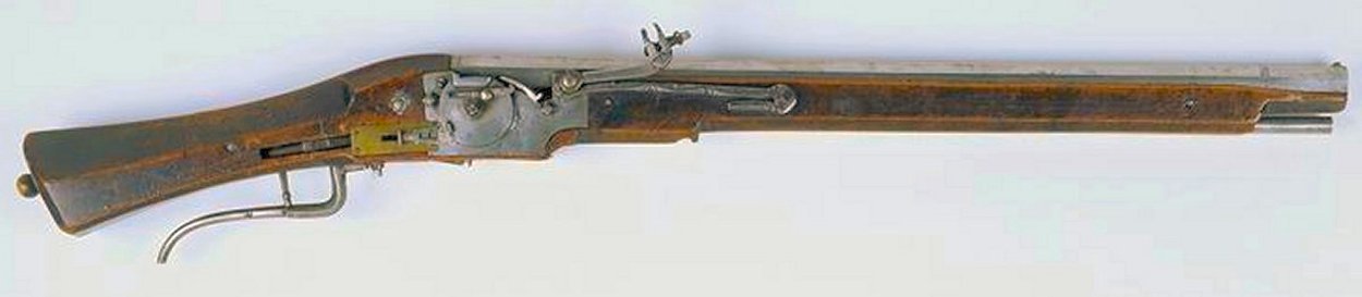

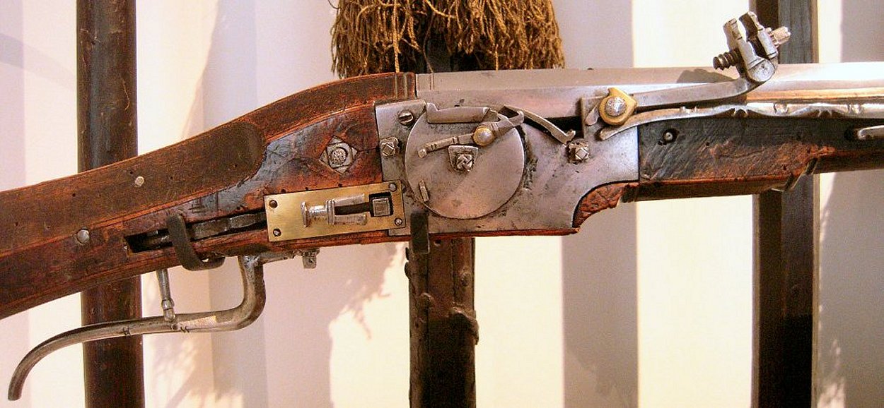

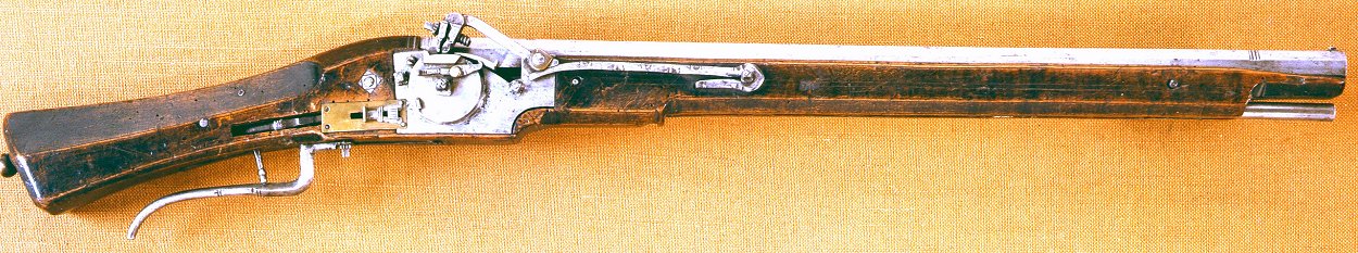

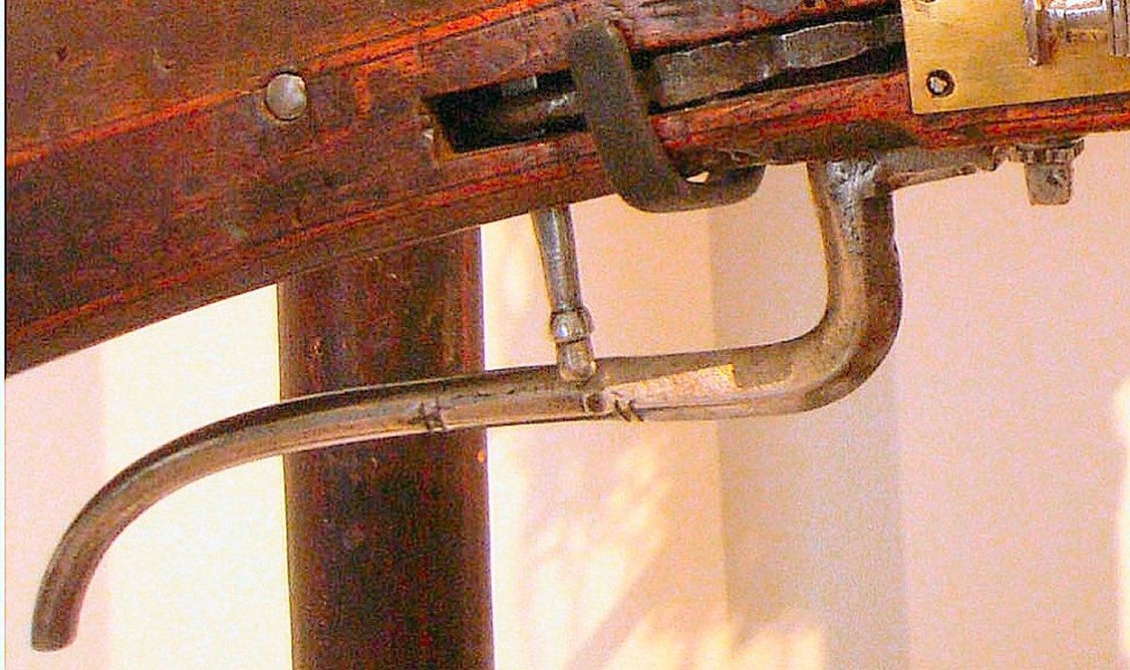

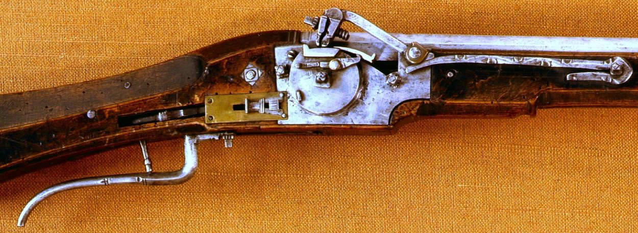

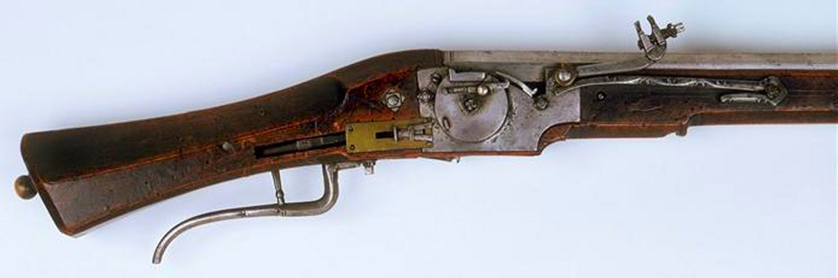

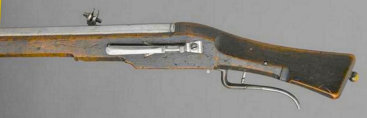

The remainder of the images.

Old 31st December 2013, 10:25 PM   #3
Fernando K
Join Date: Apr 2010
Posts: 672

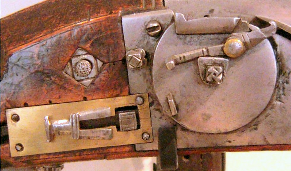

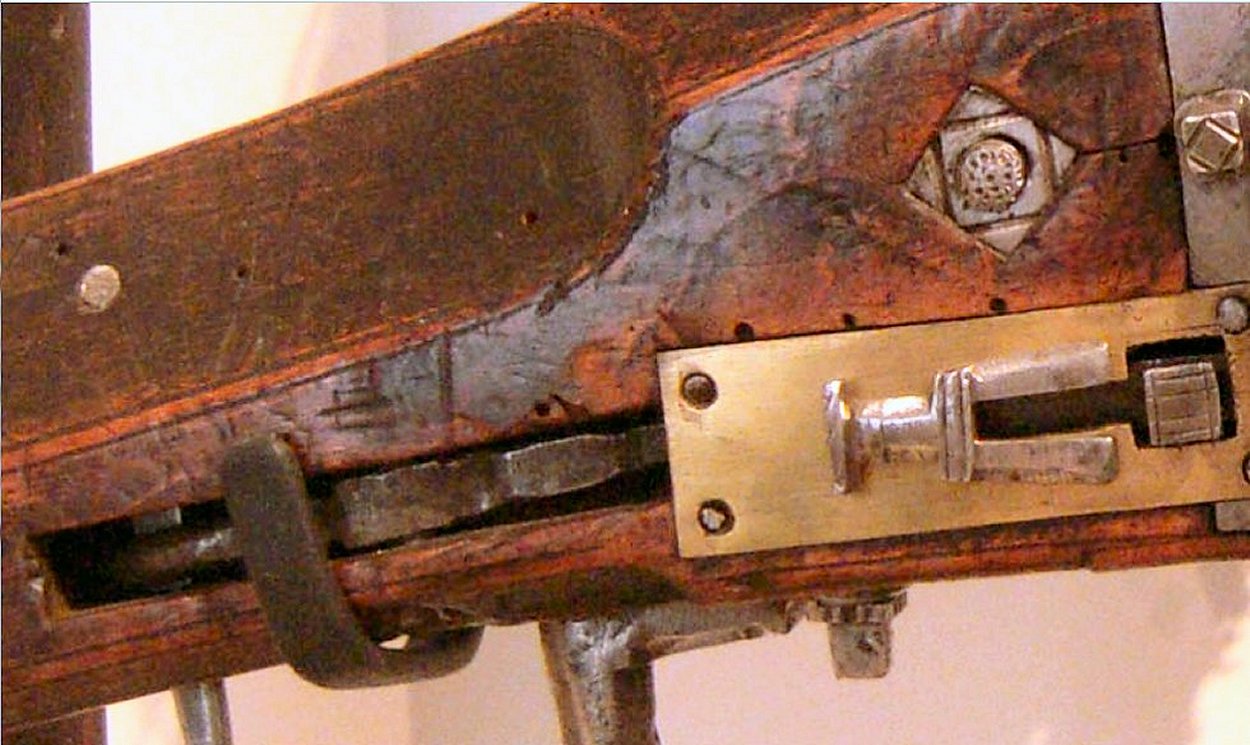

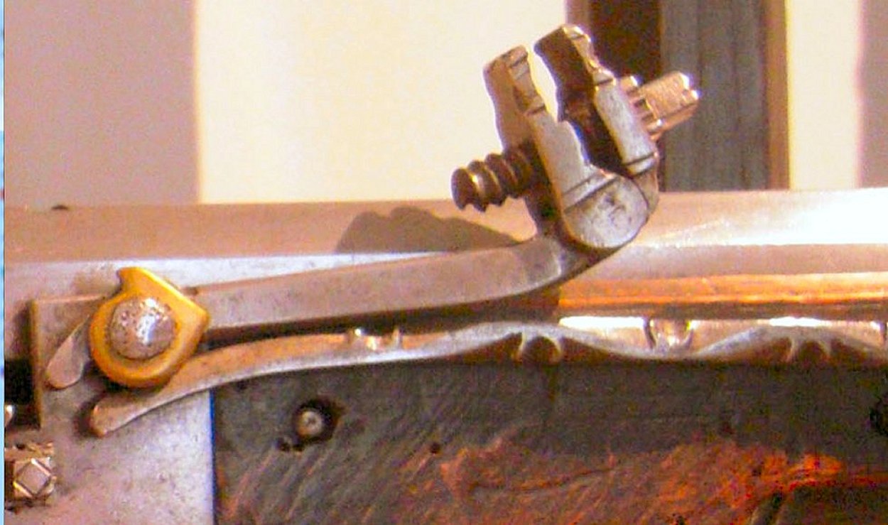

If possible, I would (and other forum members) as cubrecazoleta operation (COVERPAN) and the trigger system. It seems completely strange .....
Affectionately. Fernando K

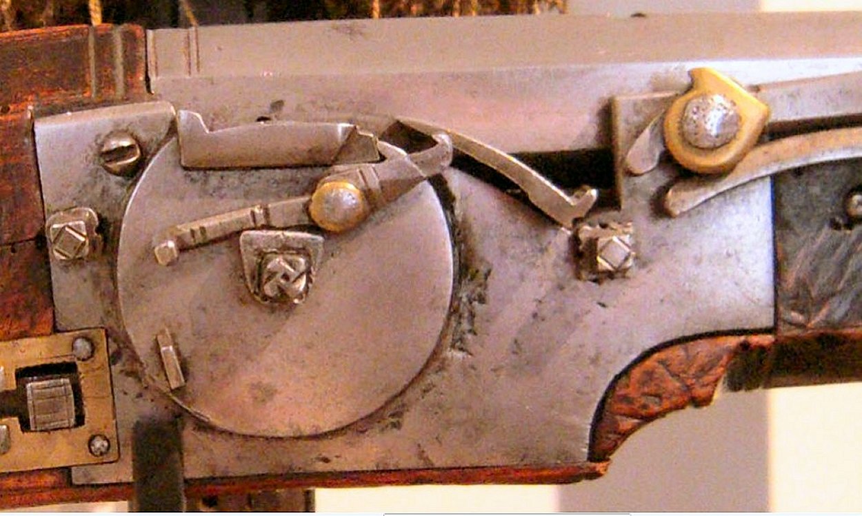

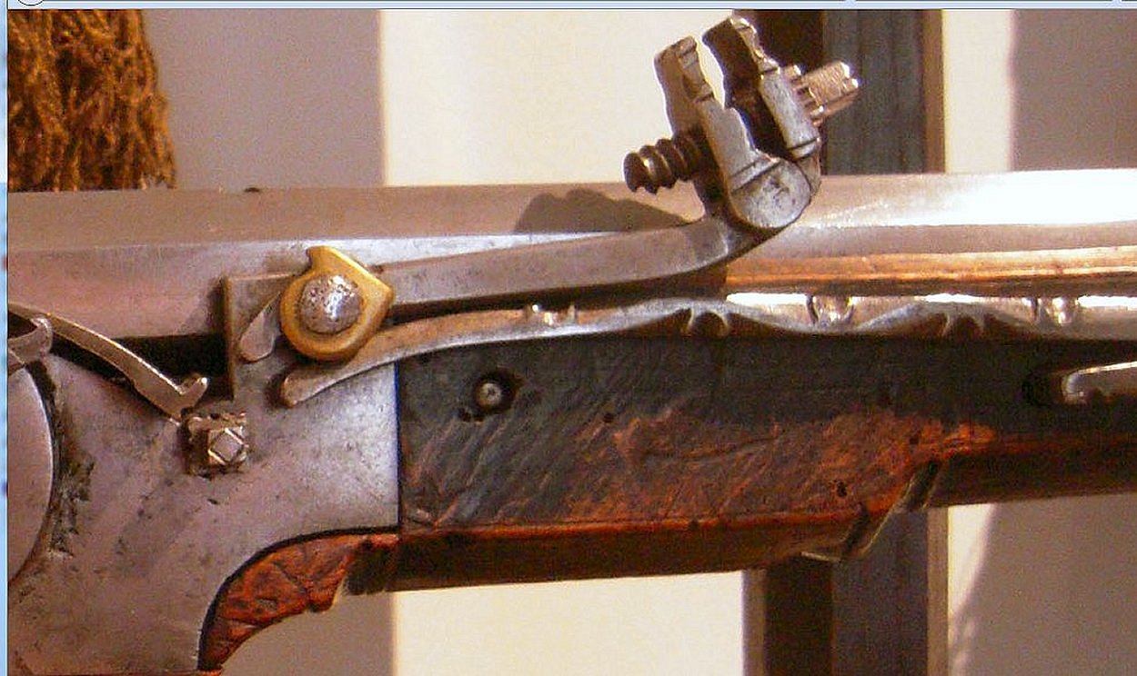

Hi Fernando K.,
The very same type of pan covers of the early 1530's ca be found on the Ottheinrich arquebus of 1533, on another in the Royal Armouries Leeds and on a detached lock in the Dresden armory, all ca. 1530-35:
http://www.vikingsword.com/vb/showthread.php?t=17814

Matchlock Estimate:

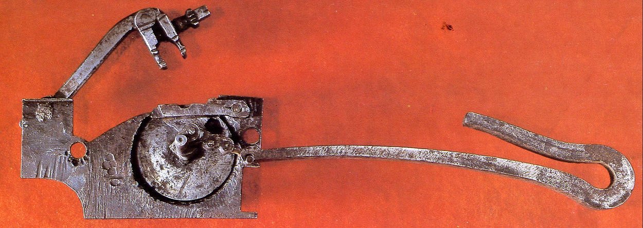

I declare, by a principle of intellectual honesty, I'm more confused: the view from inside the key the cubrecazoleta (pan-cover) is not appreciated, nor as the crank wheel you can move, or that another system was applied . Also, I think I see the hole holding the wheel, but the trigger system appears to be independent of the plate (plate) of the key (lock) ....
Old 1st January 2014, 10:54 AM   #6
Matchlock
Matchlock's Avatar
Join Date: Sep 2008
Posts: 4,310
Oh yeah, Fernando K.,

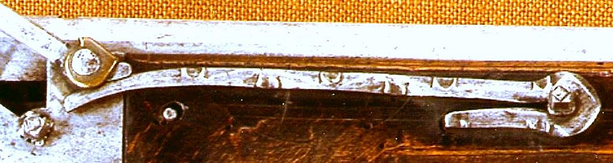

I can see what you mean; the constructer of this lock mechanism seems to have chosen his very own special way, as he did with the specially mounted French main spring for which he had to hollow out the stock, and the long dog spring on the outside of the forestock.
The trigger itself, though, as always, is suspended in the stock behind the lock.

Matchlock Estimate:
I think I see the cubrecazoleta (pan-cover) is opened manually with the lever beneath the bowl (pan), ending in a hook, but I find the spring that opens and the method of attachment. As for the trigger system, anything would be possible .....
Thank you very much. Sincerely, Fernando K
Old 1st January 2014, 12:41 PM   #8
Matchlock
Matchlock's Avatar
Join Date: Sep 2008
Posts: 4,310
I cannot make out the pan-cover spring either - the inside view of the lock mechanism does not show it. Maybe it's missing?
m

Matchlock Estimate:
Perhaps the cubrecazoleta (pan-cover) cover. your cam and spring were attached to the box (stock) as the mainspring. Now that I'm looking more closely, I think the bronze plaque under and behind this key (lock) is the sure shot, which acts through a square button (decorated with lines)
Affectionately. Fernando K.
