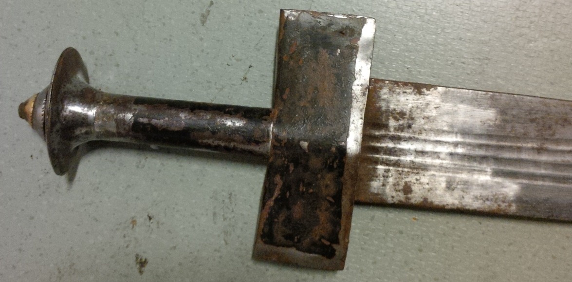

The worst thing about spending time on this forum is that you see all sorts of cool things you can't afford. Specifically, I really took a liking to straight North African swords like the Takouba and Kaskara, and I decided to get a cheap one. Rather than going with E-bay and getting a tourist piece, I got this one off Oriental Arms. As you can see it's in pretty rough shape. One side has 4 fullers, the other side 3 and they're definitely ground not forged. It has the half moons on both sides, but rather than a face it just has a squiggle.

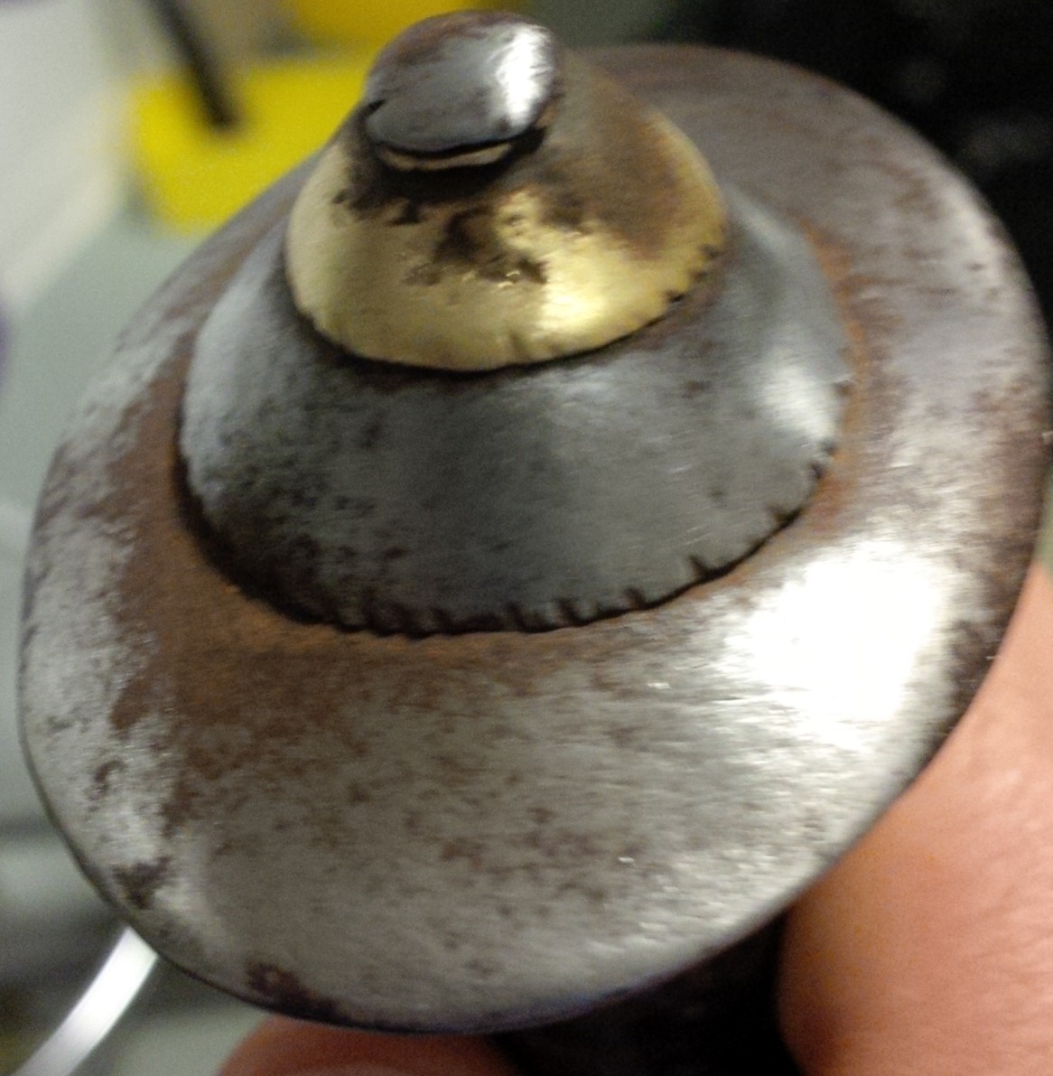

There are some faint striations on the edge towards the top which didn't come out in any of these pictures. There's a ding or two in the edge as well. The blade has good flex to it. The handle is raw metal, I assume it was encased in leather at some point, and it's stuffed with fabric.

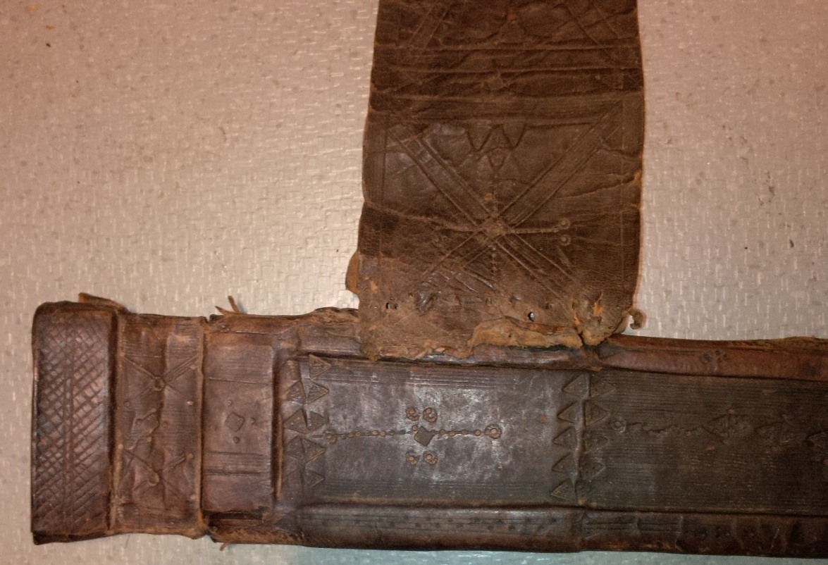

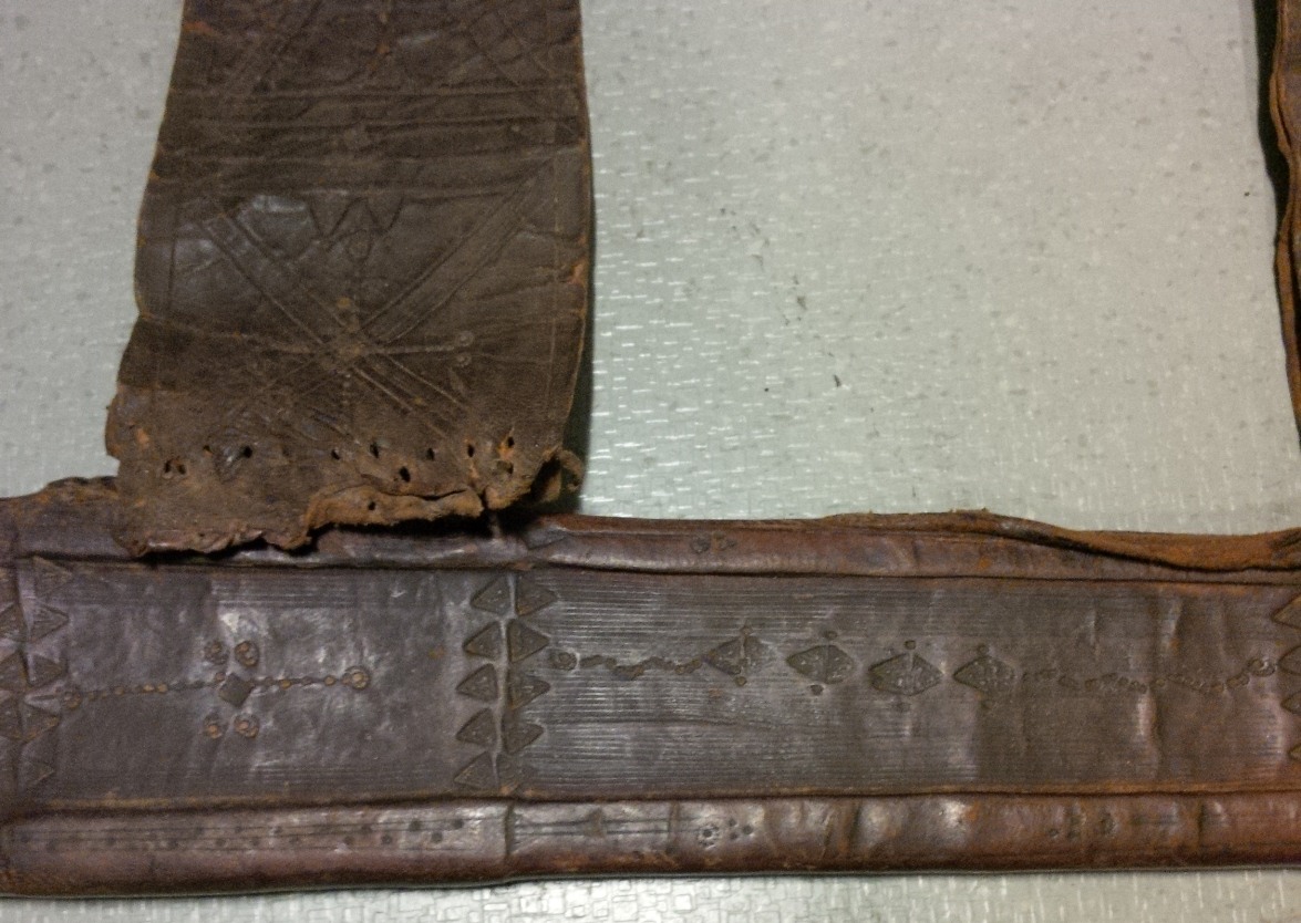

The sheath is pretty ratty, and the end of it is actually missing. The baldric is some sort of fabric, also in rough condition, and the d rings holding it in place look like rusty iron.

Is there any way to date the blade or narrow down what ethnic group it originated from? It's obviously seen a hard life and there's not much left of it, but at least I'm reasonable sure it isn't a tourist piece.
Tourist piece is a bit of a misnomer with regards to takouba in my opinion. While takouba are still made and certainly sold to tourists, they are also sold to local customers who continue to use and wear them, mainly for traditional events like durbars.
Your example is fairly recent, I would guess made in it's entirety in the last 30 odd years.
The scabbard appears Tuareg to me.

It does indeed. On a second look this one might go back to the 1950s or so. The brass scabbard mounts are a good sign, newer ones have aluminium 'triangles'.
Generally speaking though, this sort of blade indicates a scrap steel source like a car spring. Which is not to say it's a bad blade.
Even the more modern swords are occasionally used. I've seen news stories in Nigeria in the last 5 years about the occasional incident with a Fulani herder using their sword. So I wouldn't be bothered by it being a mid 20th century item.

Thank you for your reassurances. I'm pleased to hear the blade is most likely made of spring steel. I have several modern khukris/goloks/parangs made from such and they're all exceptionally tough blades. The edge towards the tip is sharp enough to catch on my fingernail, and I will admit I swung it at a cardboard box and it sliced right through. I promise I won't do that again.

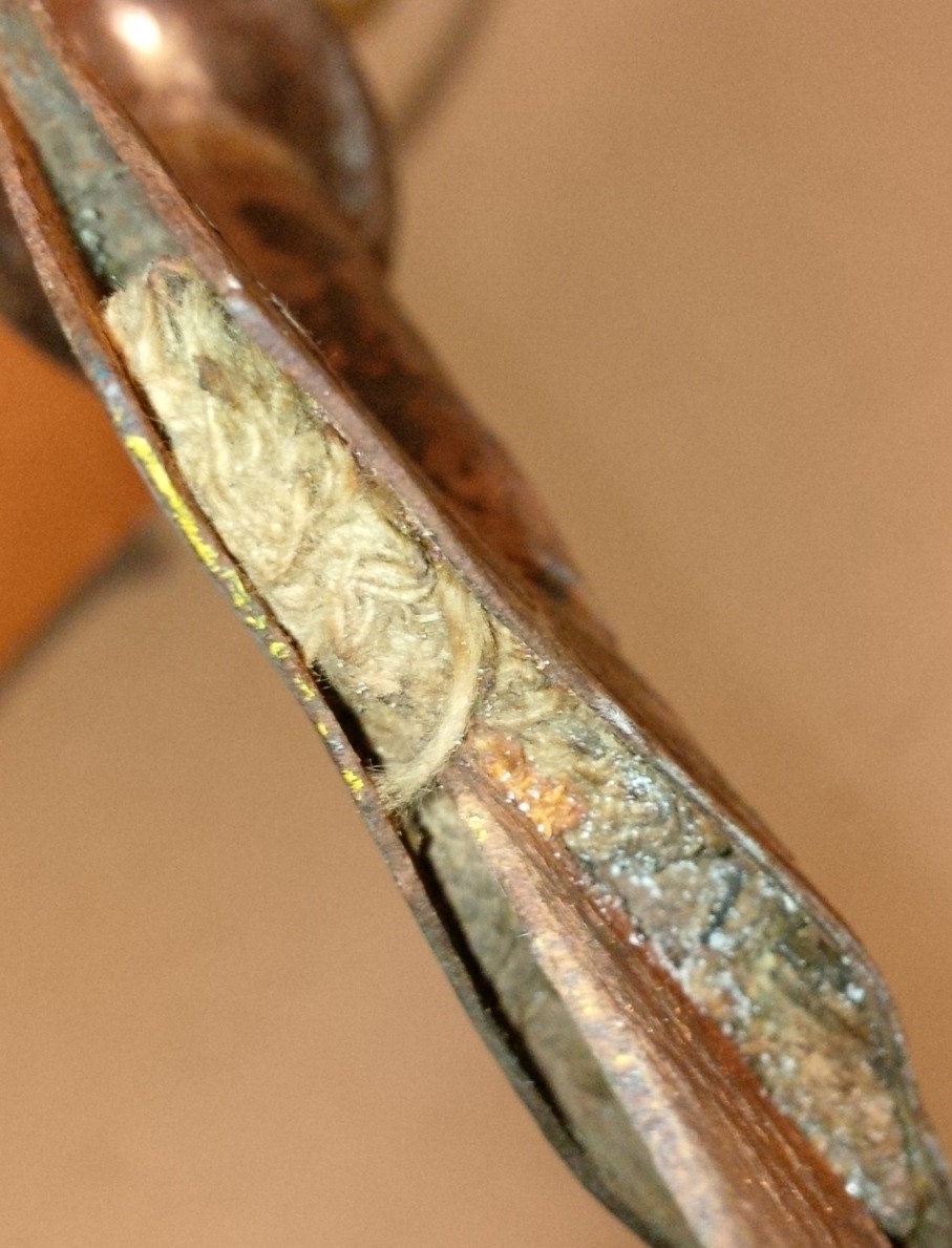

Do you think the hilt was once covered in leather? It looks like it was painted black so I wonder if it was always exposed. Is it typical for the crossguard to be stuffed with yarn or fabric?
With regards to the brass I meant the suspension rings or triangles.
You'll be best placed to judge the blade having it in hand, but some of the recent takouba I've seen and handled certainly don't have bad blades in terms of toughness and holding an edge.
The hilt would have been leather covered - grip and guard. It is not unusual for the interior of the guard to be stuffed with burlap or similar material. This is common on pieces where the guard is a couple pieces of steel folded around the blade, rather than the older, boxier construction. However this style of construction is only seen on very old mounts.
Here's a 19th century example I used to own showing the same thing.

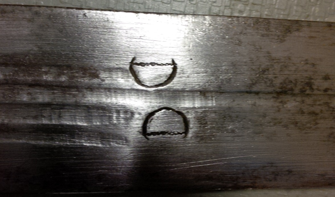

Two final questions on this sword: it's very flexible, like a machete. Not surprising if this was made from spring steel, but I expected a fighting sword to be a little more rigid. Are older ones this flexible, or just modern ones like mine?
Lastly, I've been going through takouba.org and I can't find any other takoubas that have a different number of fullers on each side like mine (3 on one side 4 on the other). Is this uncommon?
First of all I'm glad the takouba site is useful! I always appreciate hearing that someone's made use of it. Sword 88 in the catalog has a single fuller on one side. But otherwise I can't recall any examples off the top of my head.
About the flexibility, yes, newer pieces do often have more flex. However... That said one of my oldest pieces (81) has an extremely flexible European blade. That's perhaps more of an exception though, most older blades are fairly stiff, as are some older native blades I've had/handled.
Still, I think the attribute of flexibility is something that was desired and simply easier to acquire with modern steels.
