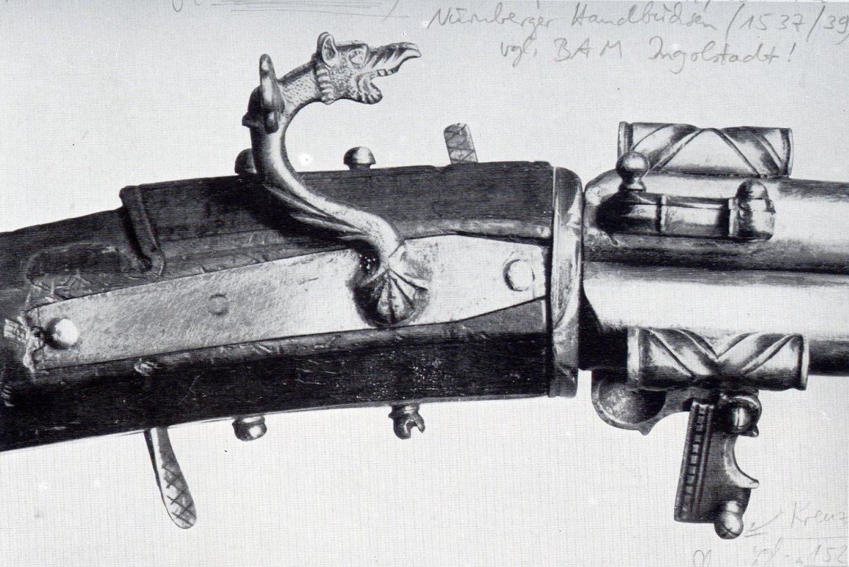

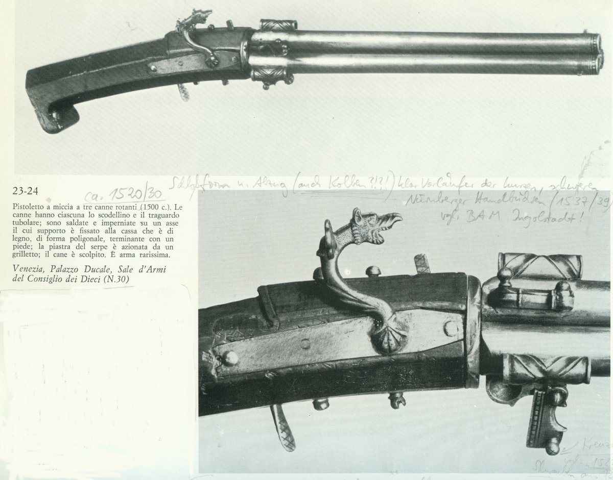

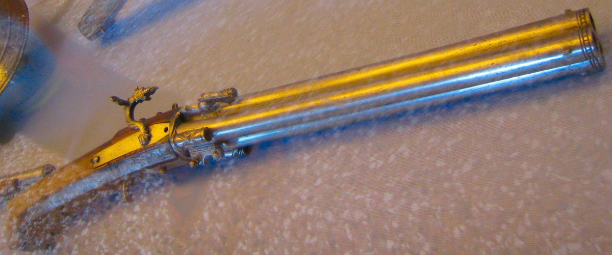

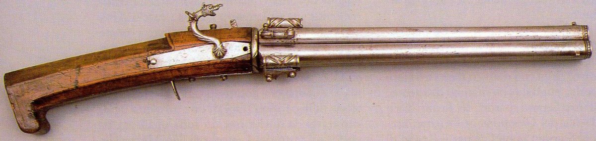

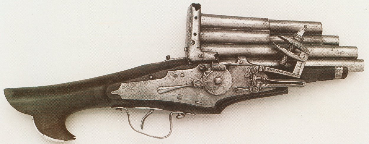

Only one single and completely original 16th c. matchlock pistol is known to have survived but it is clearly an exemptive 'high-tech' weapon: with three manually turned barrels, which actually makes it a matchlock revolver. Each barrel is fitted with its own pan and pivoting cover, plus rear sight with an additional tube and bead foresight; no provision for a trigger guard.
It is made in clearly North Italian (Brescian?) style, ca. 1530's, and preserved in the Doges Palace Venice, inv.no. B 83: 53 cm long overall, the barels 29.9 cm, bore, 10 mm, weight 1490 grams (attachments).

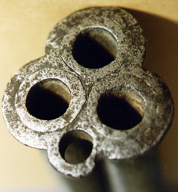

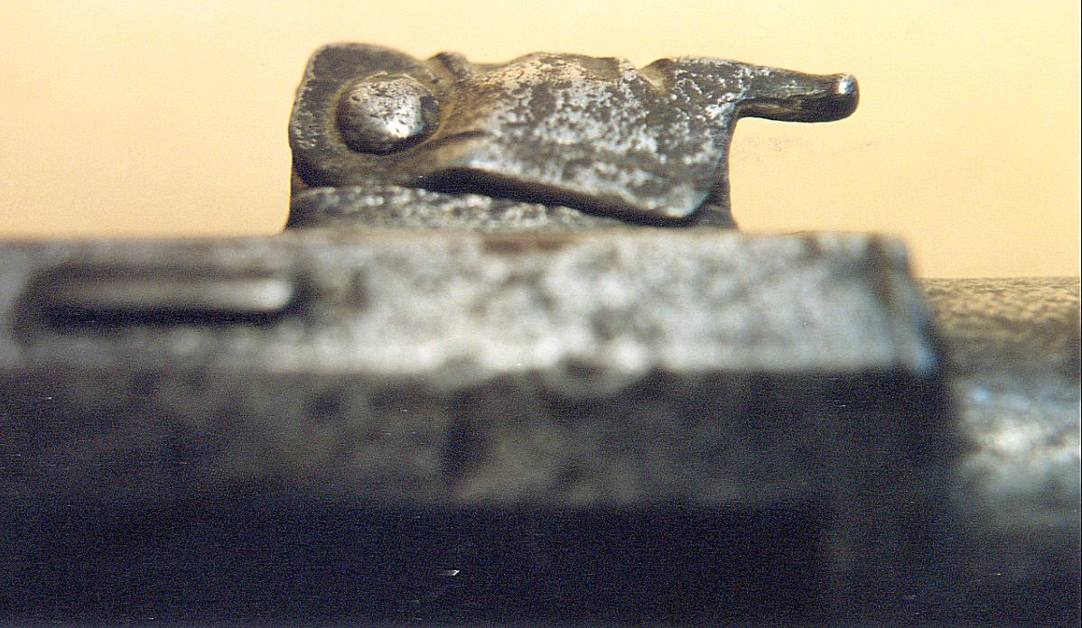

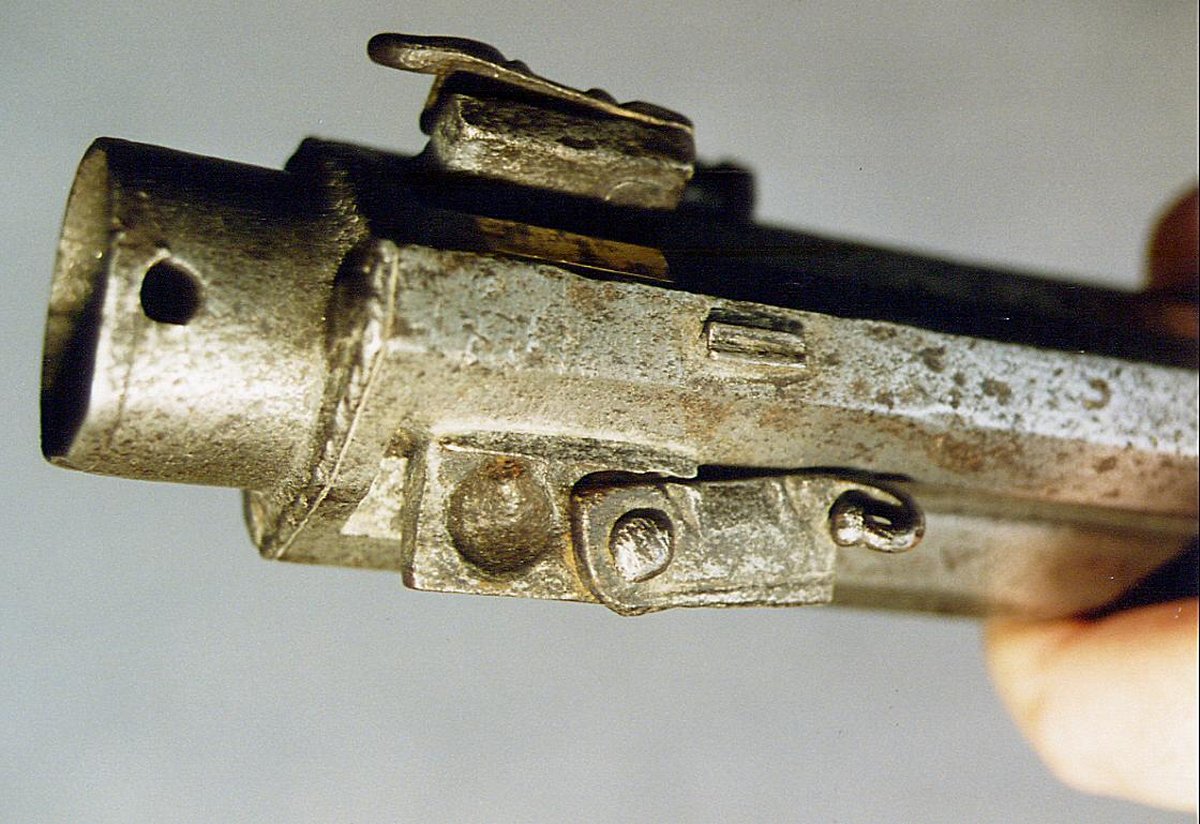

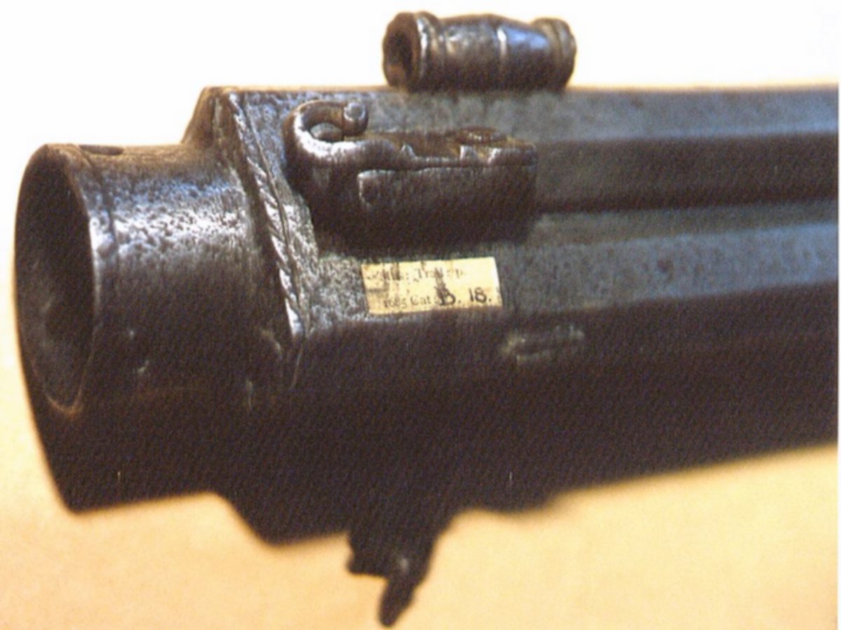

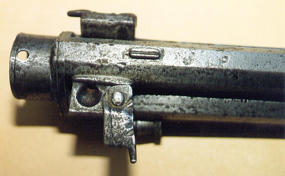

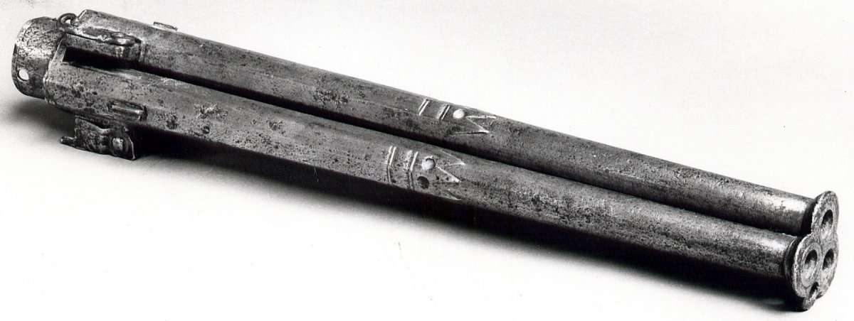

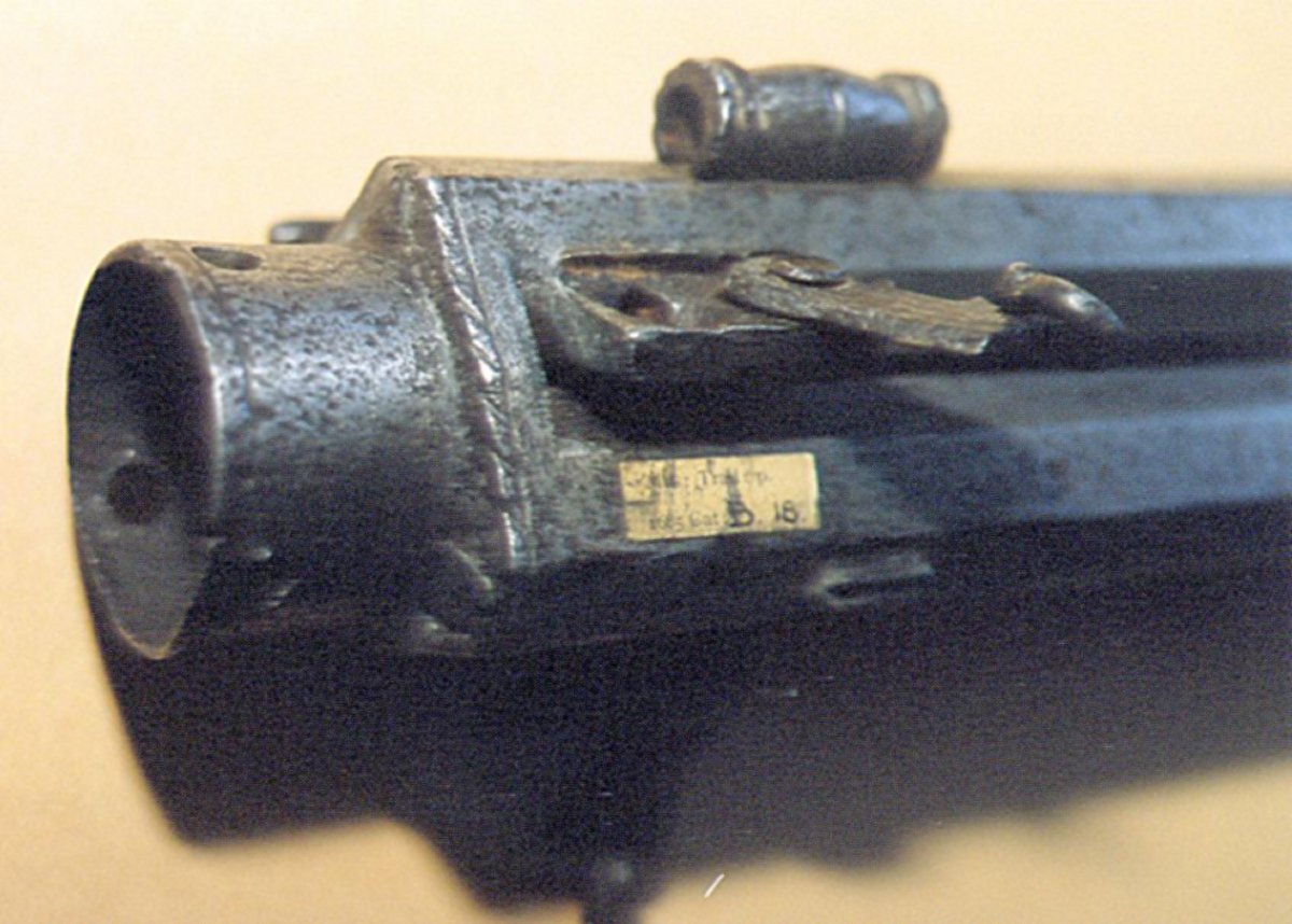

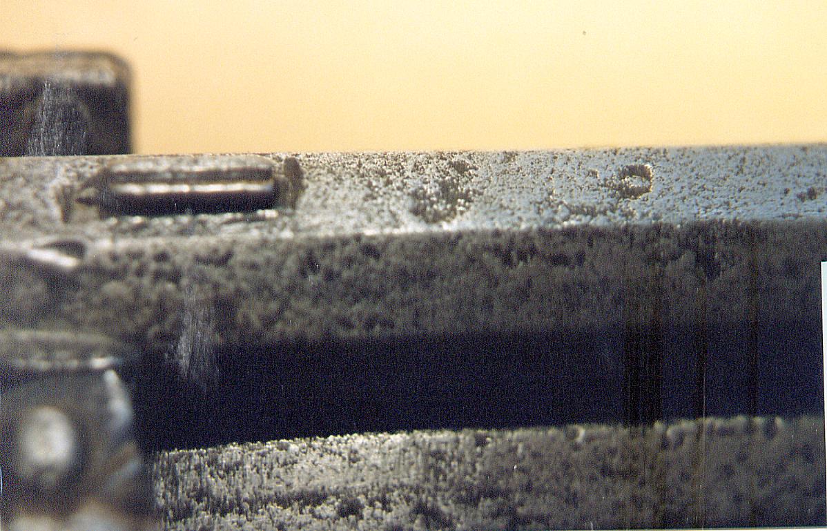

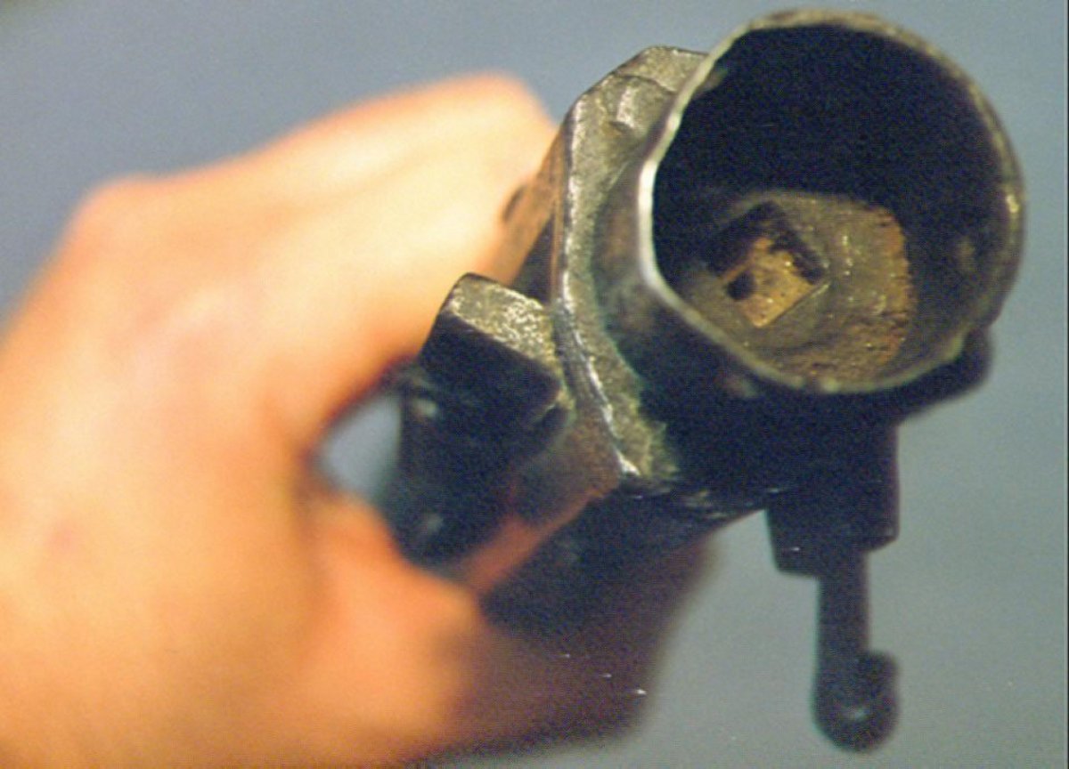

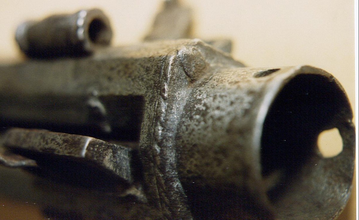

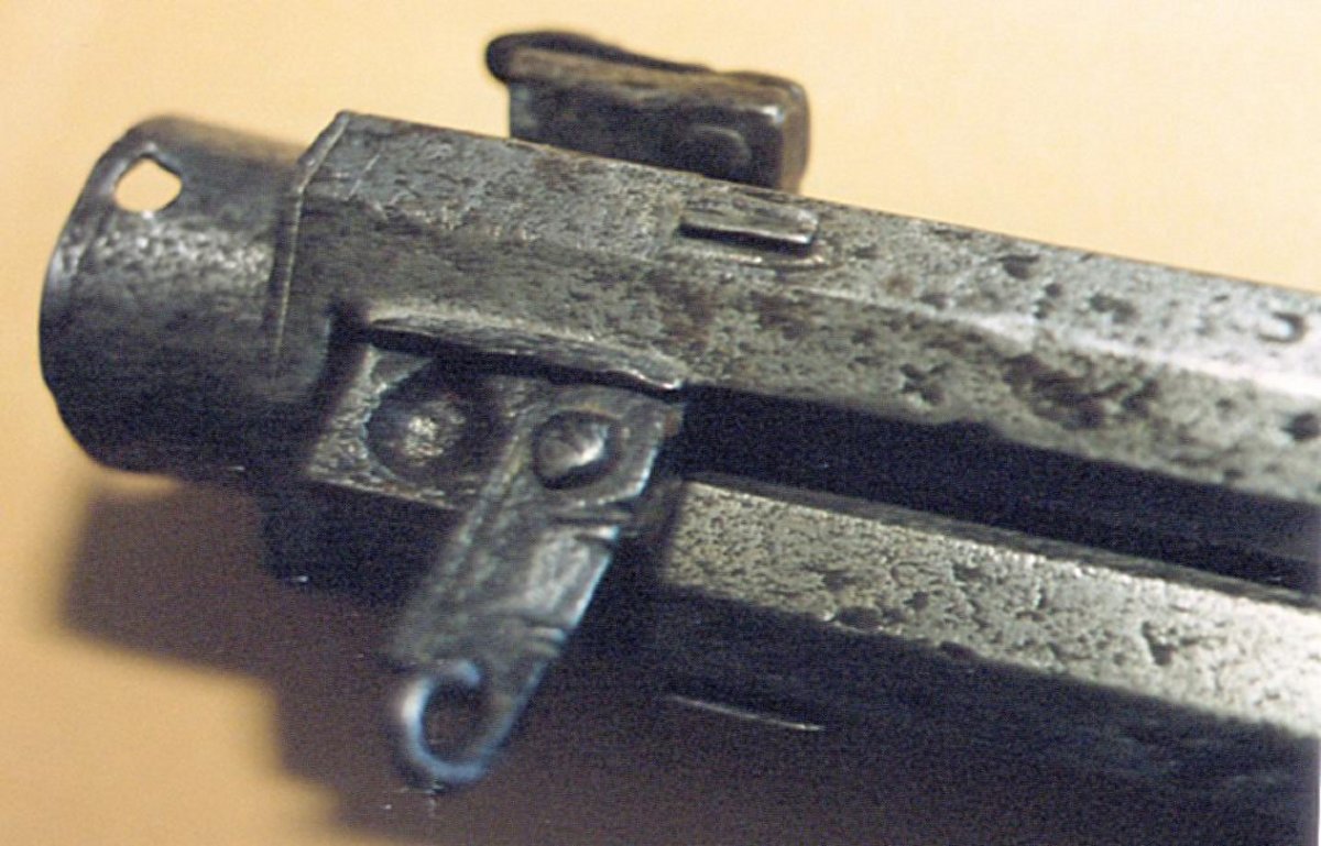

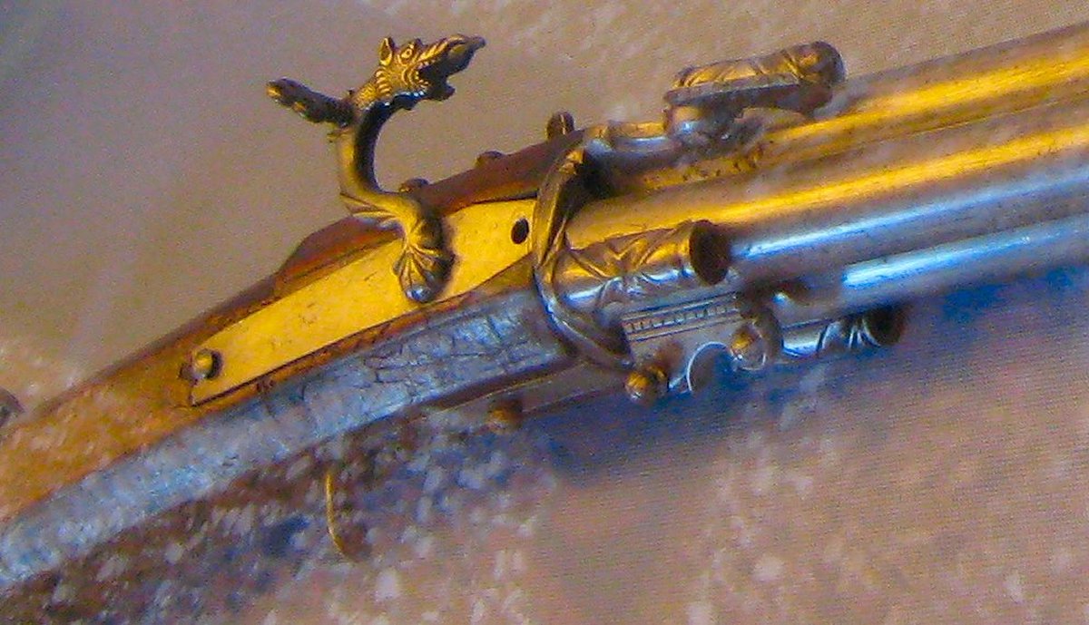

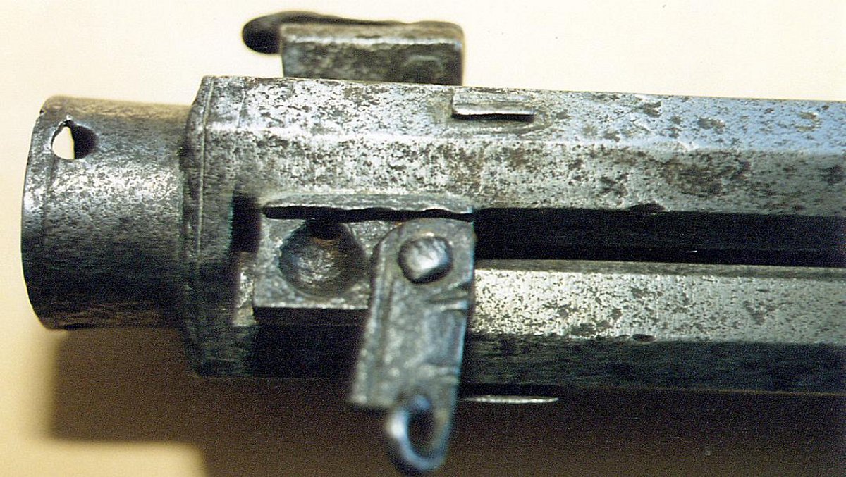

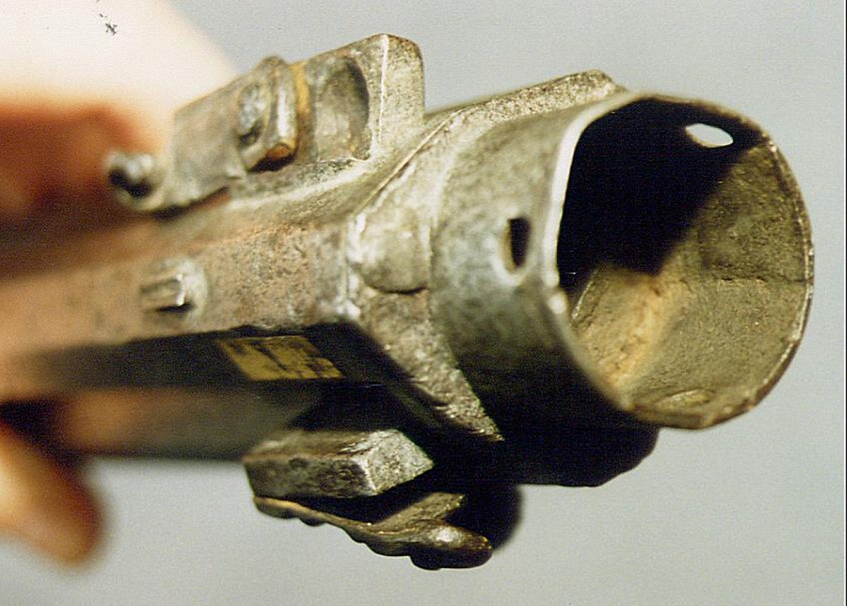

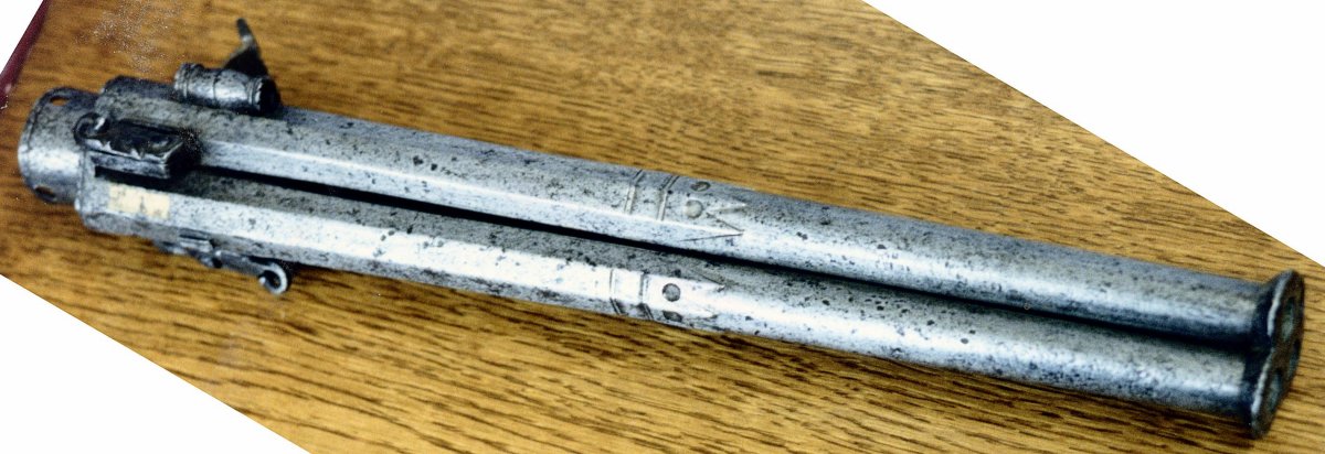

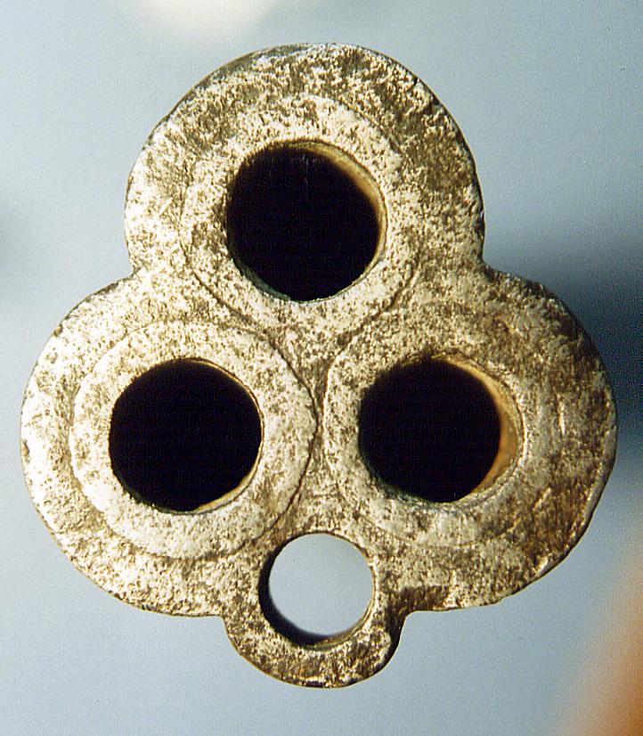

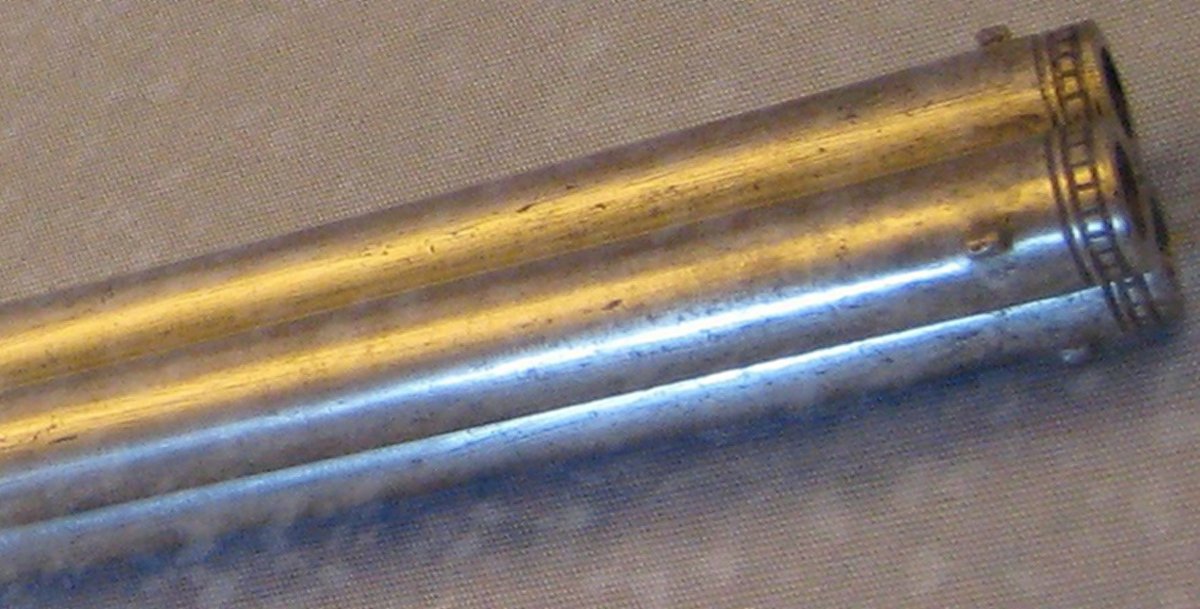

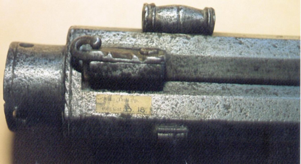

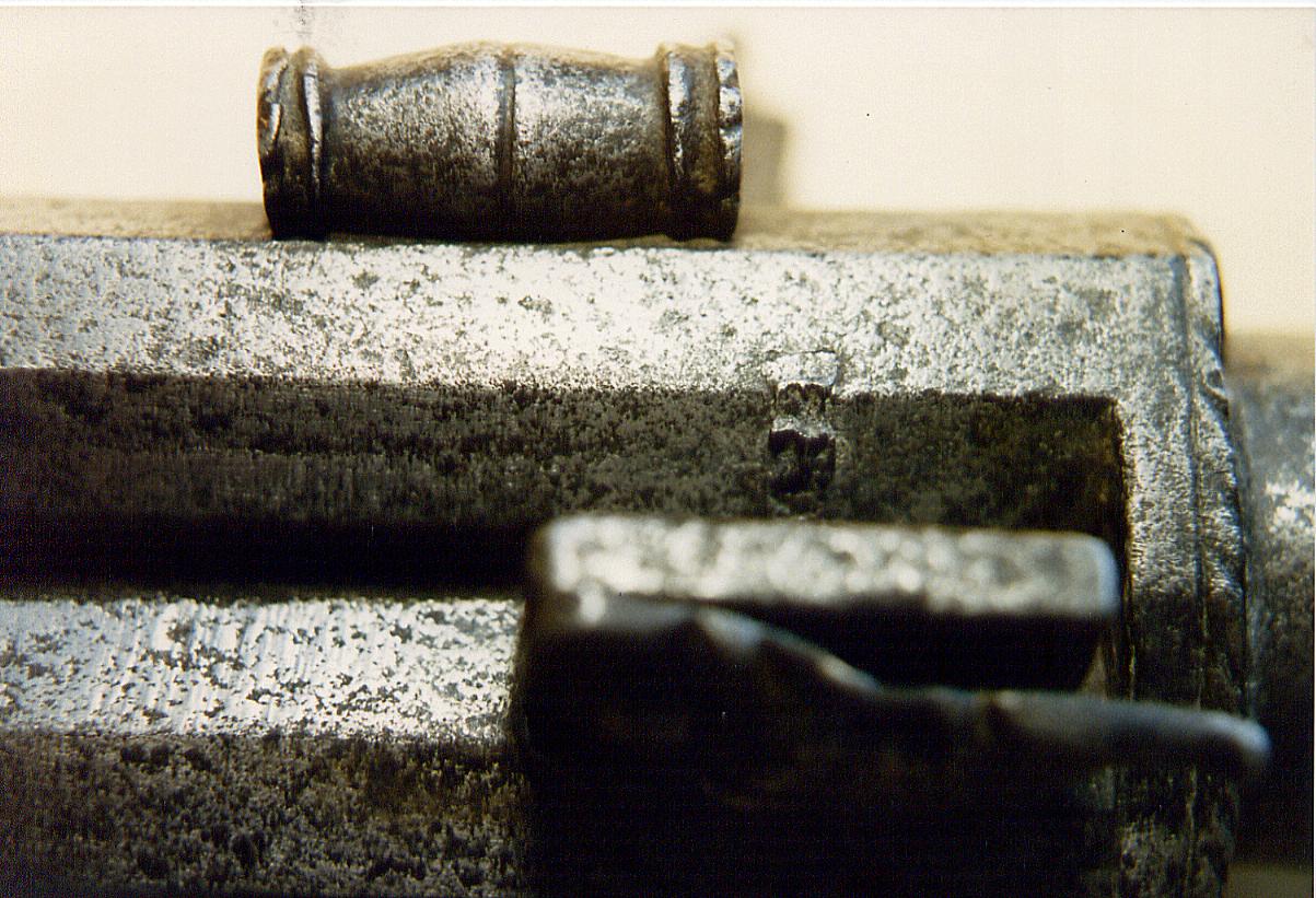

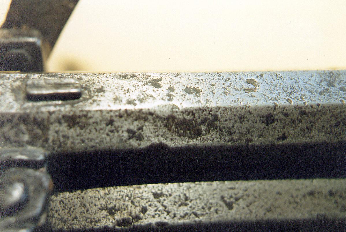

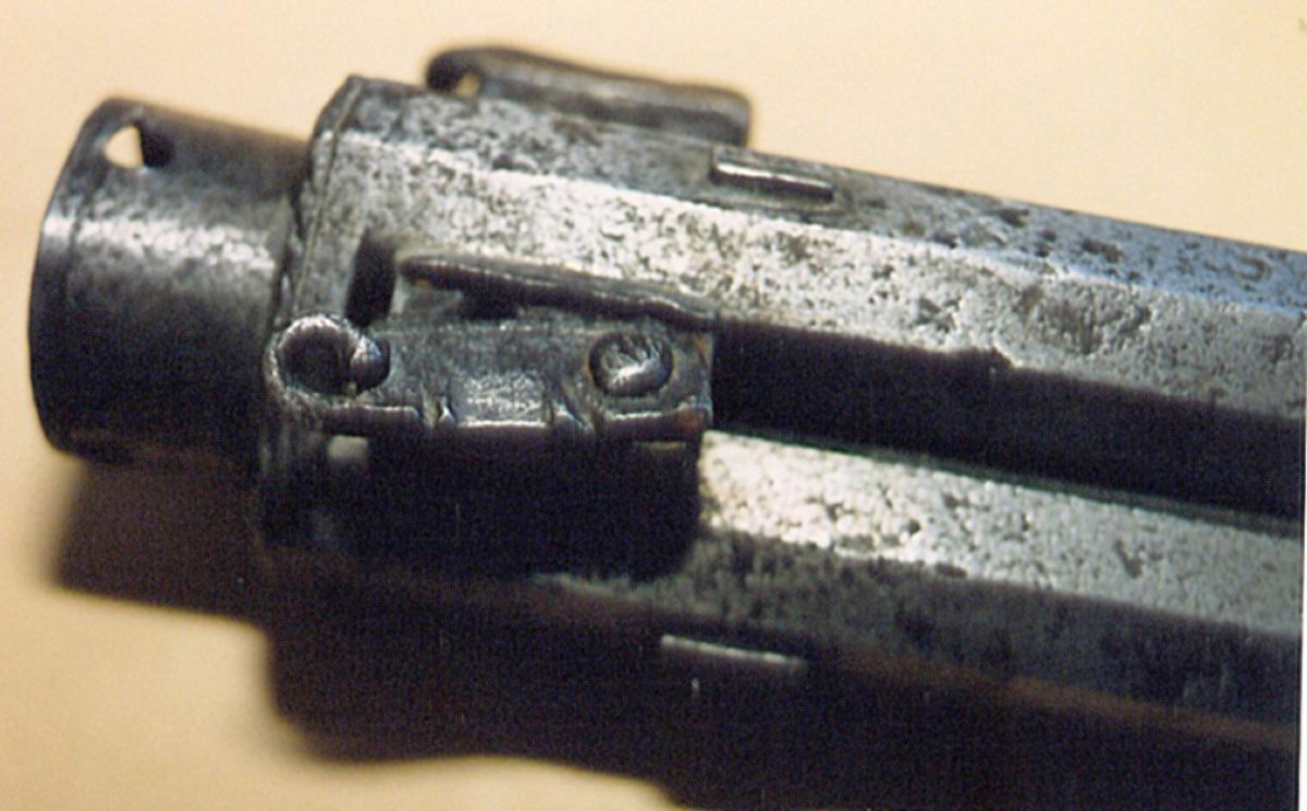

In the reserve collection of the Ashmolean Museum Oxford, I detected and photographed a detached bundle of three barrels, obviously from the same type of firearm but with an additional muzzle ring including a ramrod recess; on two of the barrels the faint rest of an unidentified maker's mark can be seen, and two of the sighting tubes are missing (attachments below).

More photos of the Oxford barrels, all by the author, 1990.

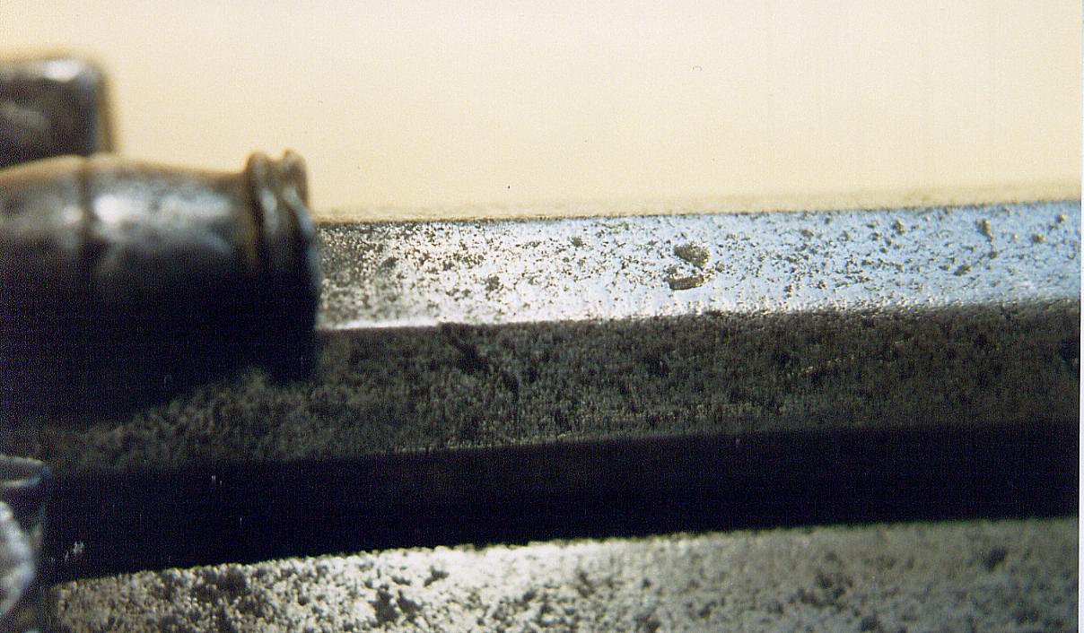

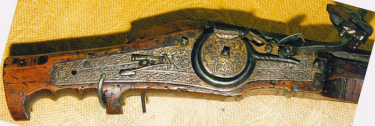

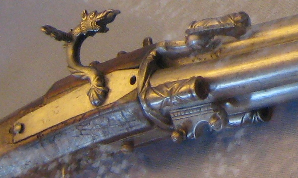

And the remaining three.

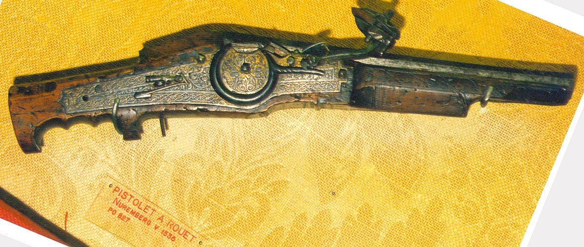

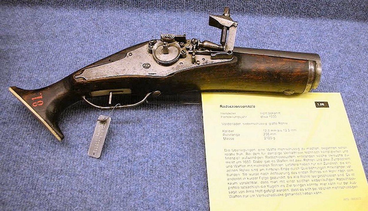

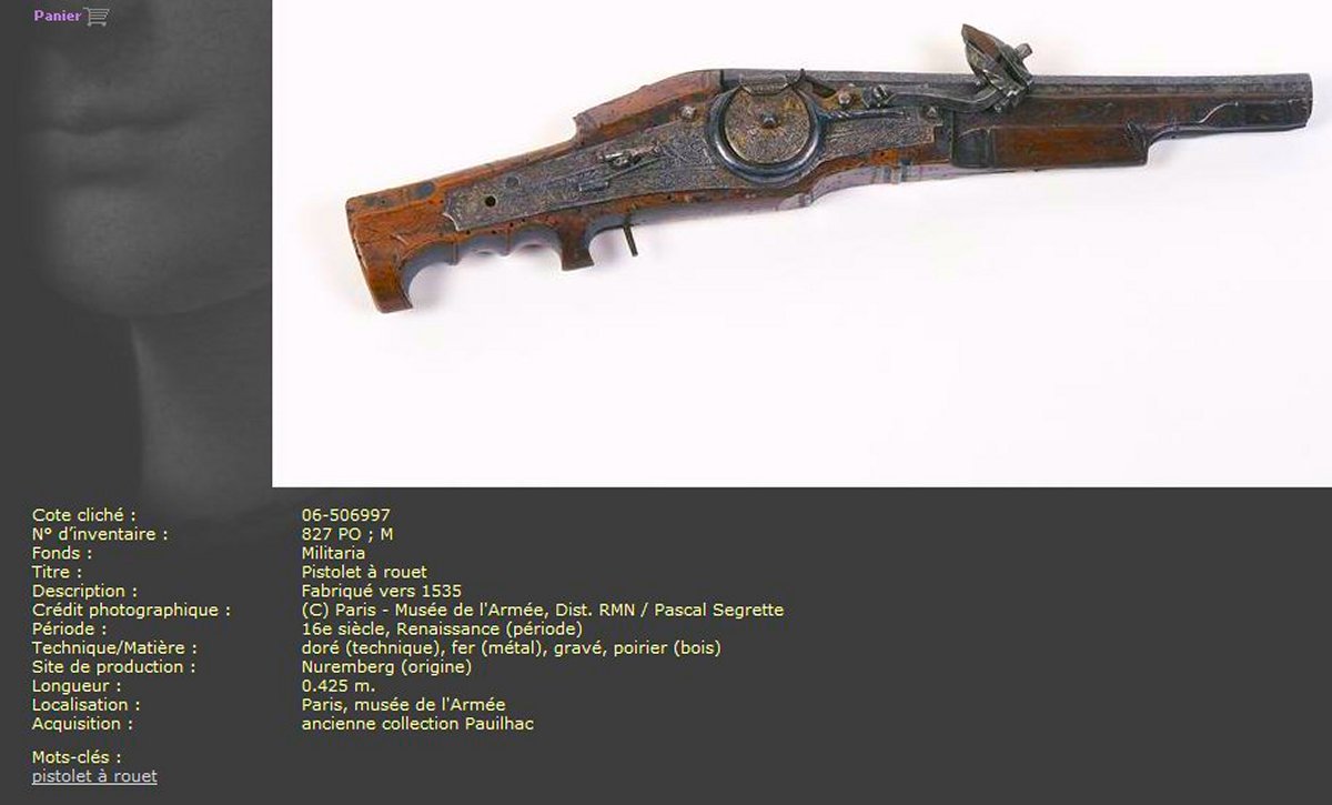

For stylistic comparison, especially of the butt toe, two photo of a characteristic contemporary Nuremberg wheellock holster pistol, ca. 1540, in the Musée de l'Armée Paris (author's photos).
m

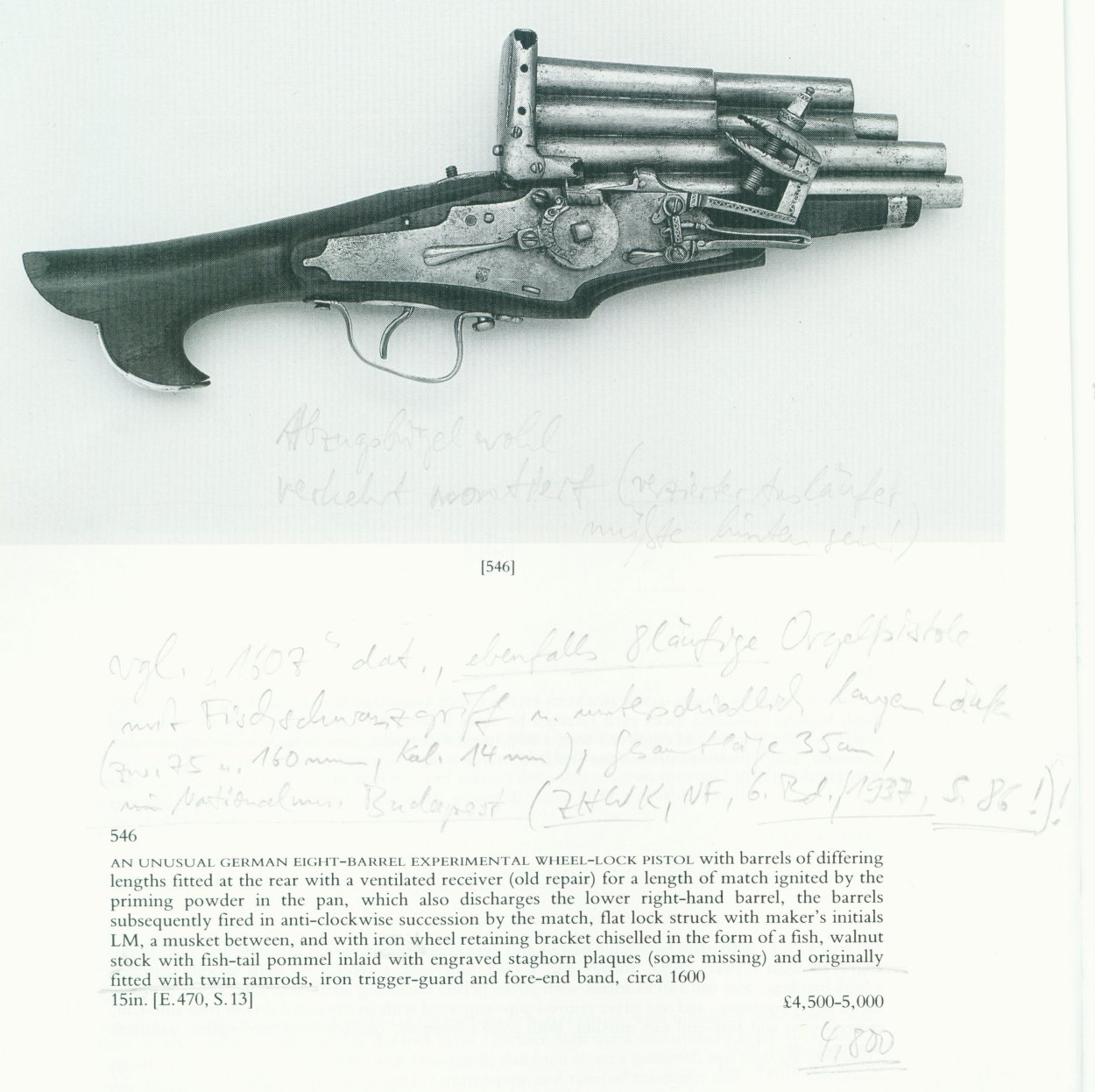

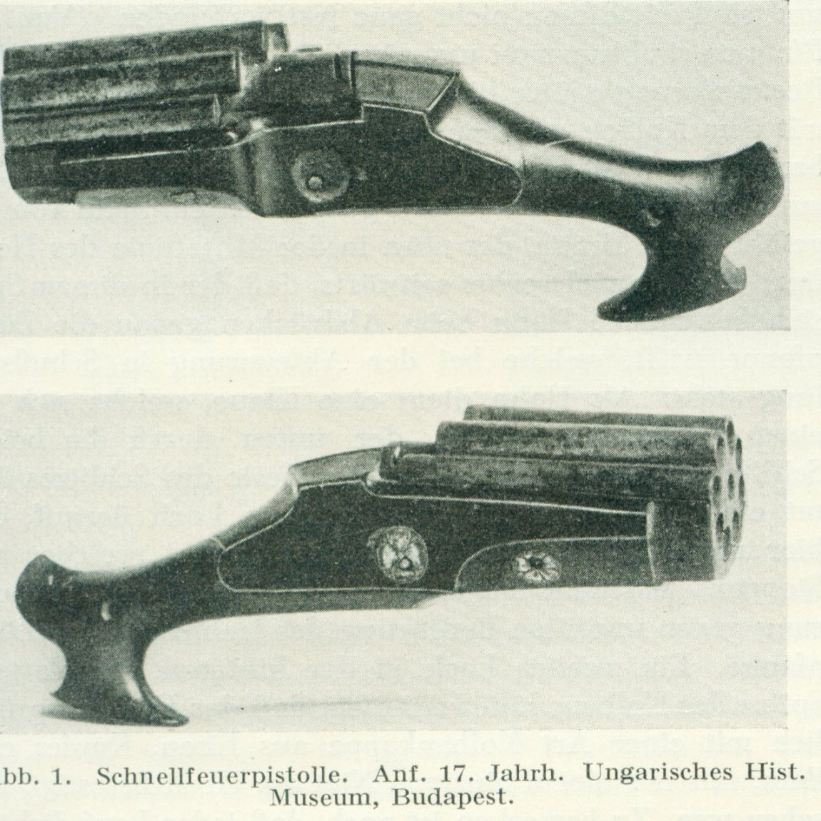

We actually have records of two highly unusually construed fishtail-butted multi-barrel 'organ' pistols: the first ca. 1600, eight-barreled, and ignited by a wheellock mechanism that lit a slow-smoldering piece matchcord in a tubular conduit along the touch holes to ignite the other barrels in turn, and the other once dated 1607 (a former small bone plaque with that date now missing from the stock!!!), on the Roman candle principle, with no mechanism at all but ignited by a hand-held length of matchcord, is preserved at the Hugarian National Museum in Budapest. A third one, ca. 1650, featuring a wheellock mechanism and also built on that Roman candle superimposed-load system, was sold from the Hohenzollern museum collection at Schloss Signmaringen, and is now preserved at the Military Museum Rastatt, Baden, Germany.
The first was sold at Christie's London, from the Schloss Dyck museum sale part I, on April 15, 1992, lot 546, where a German dealer bought it for his private collection.

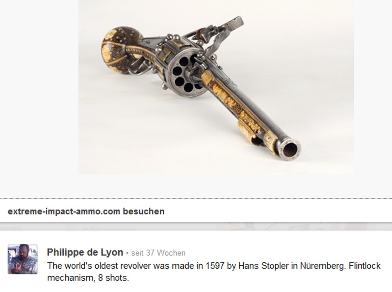

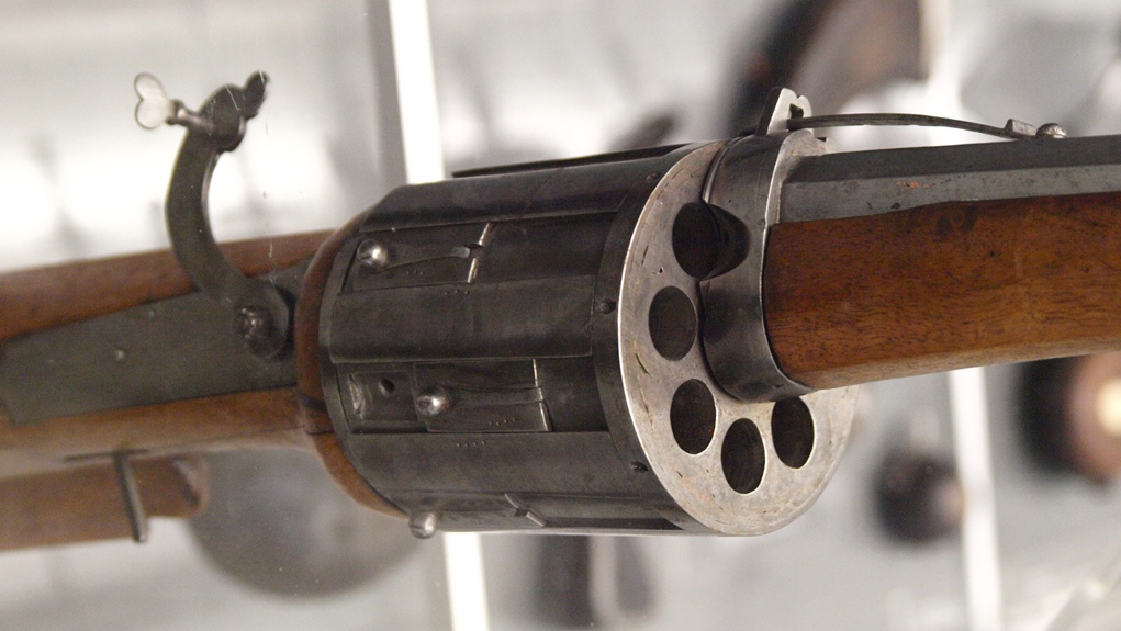

And this detached matchlock revolver barrel and cilinder, it is very short (31cm barrel) but no evidence it belonged to a pistol excists (eventhough the auction states otherwise). It is now mounted on a carriage. (thomas del mar sale 4th december 2013, lot 389).

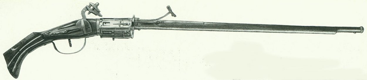

What I do like a lot is that finely made revolving cylinder and barrel now mounted on a carriage. I am convinced that it originally was part of a wheellock or snaphaunce revolver shaped like the 8-shot 'puffer' attached; it bears the mark of Hans Stopler of Nuremberg and the date 1597 - does anybody happen to know in what museum it is?
Btw, this is definitely not 'the world's oldest revolver', as the text states; revolving cylinder systems were known since at least the 1580's. When Samuel Colt undertook a vacation, he employed the idea from 16th c. weapons he saw in old collections, and from Elisha Collier et al.
I am very happy to finaly be able to answer one of your questions the pistol is kept in the Norwegian museum in Maihaugen ( http://www.maihaugen.no/en/Top-menu/...s-collections/ )
http://www.primusweb.no/things/revol...&count=1&pos=0

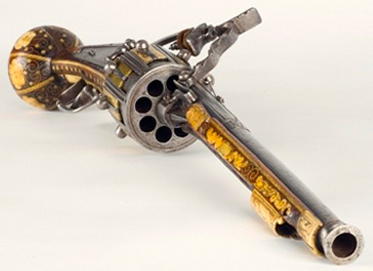

... revolving cylinder systems were known since at least the 1580's...
Are you referring to this nice Drehling, Michl ?

No, 'Nando,
Actually I'm looking for earlier samples in the Hermitage Museum St. Petersburg. The one you posted is in the GNM Nuremberg and should be dated to ca. 1620, and I guess it was me who took the image.

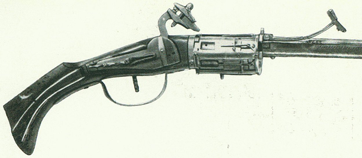

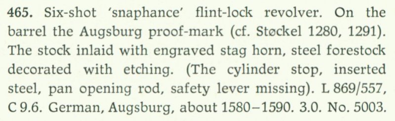

Yes, this German snaphauce revolver petronel, ca. 1570-80, was what I was looking for. It is preserved at the Hermitage Museum St. Petersburg.
m
