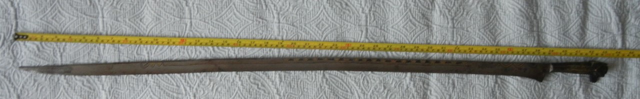

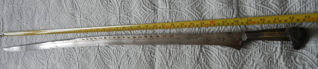

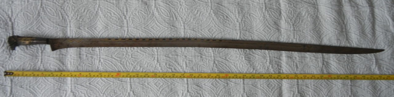

Hi everyone,
Got my hands on an interesting flyssa recently. It's a big one, 42"(110cm) long overall with the usual decorative scheme, a bit crudely done thought, compared to nicer ones.
The unusual bit is the shape of the blade. No wide recurving belly, just a relatively uniform width tapering to a point, all of it, including the spine curving forward.
I looks like a very long yataghan blade.
We've seen an example of a flyssa with a back curve, but this is the first one I see with a full forward curve.
Thoughts?
Emanuel

Interesting piece. I've seen posts here (probably yours!) before with shorter, wide bellied flyssa with yat-like blades.
Any thoughts onto what came first? The shorter variants progressing to the longer examples?
Is there any cultural/status indications with the length? Some of them are pretty dramatic.

I guess it depends on what the original inspiration was.
If the flyssa developed from the yataghan, then the shorter beefy ones came first and got progressively longer as other influences exerted themselves.
If it developed from a Circassian-type sabre, then the very long ones came first and got shorter as they transitioned to a foot soldier's weapon. My understanding is that the very short ones came last when the local Kabyle arms industry was shut down by the French, and the markets changed.
I consider these curved examples to be small, custom runs, deviating from the classical examples we know.
The fine art history student looks for a progressive development chain. In all forms of plastic arts you can follow development from an early prototype of some sort, progressing into something new. It's very difficult to see that in the flyssa. It seems to have just appeared, fully formed, like Athena bursting from Zeus' head
There's also the possibility of the older prototypes having been recycled as something else, or having been upgraded to the classical style. This would explain how the unusual flyssa can deviate in form but maintain the decorative scheme.
Lots of thoughts to sort out...

Could it be possible that this flyssa originally had a straight blade, which was crudely hammered into a down turning one? You have the sword in hand and can judge better if this is a plausible scenario or not, but the crude lines suggest to me that the blade may have been altered at some point.
Teodor

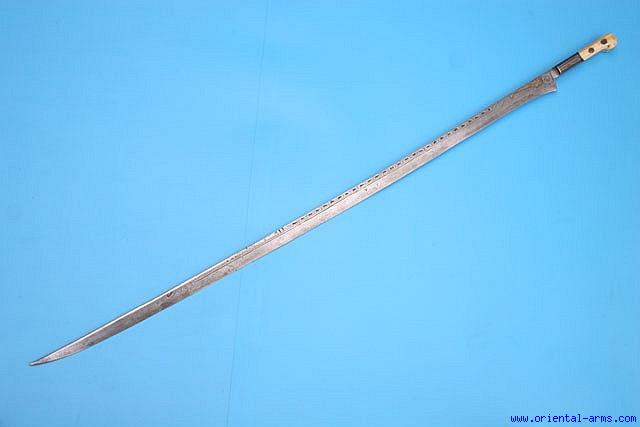

Hi Jim and Teodor,

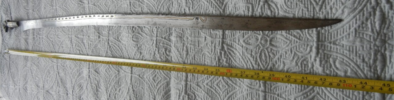

I did consider that the blade might have been curved later in its life. It would originally have looked more like the attached pic from Oriental-Arms.
The blade changes angles at two spots along the blade. I can actually see the areas along the edge that show some deformation due to a forward bend of the spine. This had to have been done on a forge though, or the areas needed to be heated to permit deformation.
I think this was still an old mofification. Camille Lacoste-Dujardin wrote that after 1850 the flyssa became obsolete and the Iflissen pretty much stopped producing them. Other neighbouring tribes started modifying blades to new tastes, with forward and back curves, and selling them to resellers in Algiers for the tourist trade. Interestingly she notes that long blades were also cut down to dagger size. This would explain why short dagger flyssa still retain unnecessarily thick blades.

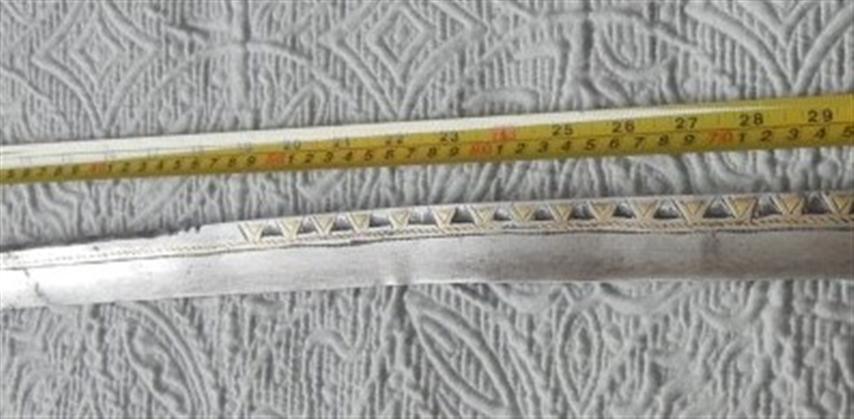

Hello Emanuel, I've noticed what looks like waves on the cutting edge of the blade (pictured below) where the downward curve seems to start. Can you tell me if this is correct? If it is may I suggest that the reason for the down curve in this might have been caused by the blade being bent at this point by having struck against a solid object. I have seen this before on other long thin bladed swords where someone ( not knowing any better) has tried to cut things like a small tree. Just speculation on my part, but it could explain the strange blade profile.

Robert, I am now certain that this flyssa was deformed at some point and that the back was originally straight. I see two points of impact with associated deformation of the edge (the waves you see). No idea how this was done, but flyssa blades were generally made of low-carbon steel so soft enough to bend.
