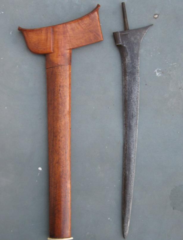

I bought this keris from a dutch family.
The owner was mid 40's and the keris once belonged to her grandfather.
So it probably came from Indonesia just before or just after WW2.
I must say that such a bring back keris confuses me.

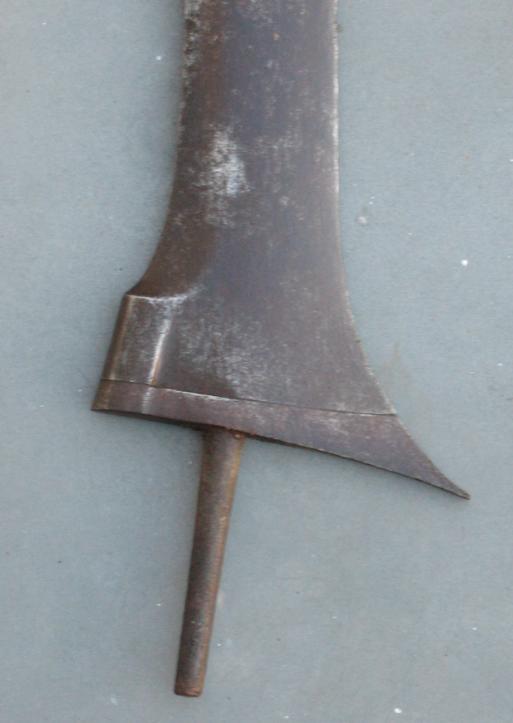

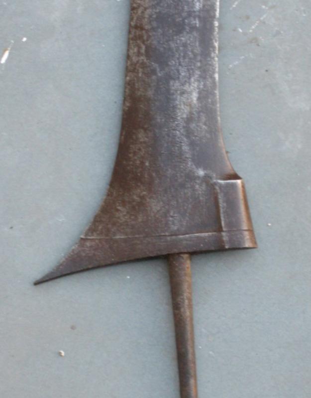

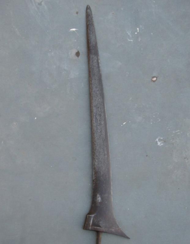

The blade is very simple. is it sumatra ? bugis ? or even malay ?
The fit in the scabbard is perfect.
Please give me your opinion / comments.

congrats, nice keris. Blade is sepokal form, strong Bugis influence and I am sure that the blade will show after etching a nice pamor, maybe ujung gunung.
Would place this keris somewhere between Sumatra and Peninsula. Could be a Bugis Riau keris. Do you get a hilt and pendokok with it? Good worked blade IMO.

Hello Detlef,
Thank you for the help.
Sepokal. Bugis influence .
But if I check other sepokal blades I see that they often have the blade edges that are so typical of bugis blades.
So , would we call this blade Bugis ? or can it be another area ?

I fully agree with Sajen and would also attribute this kris to Bugis Riau but am open to other opinions. Not all Bugis blades have gusen on the edges!

I guess I will start cleaning the blade and see if I can trace some pamor

I believe that you will see some pamor if you clean and stain the blade properly, see attached examples of Bugis blades after and before treatment ...
