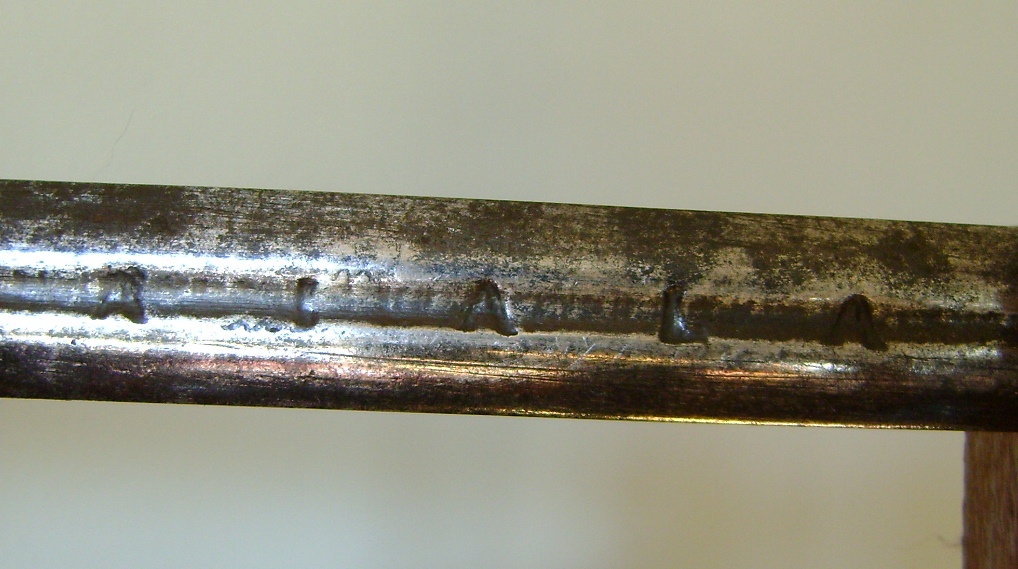

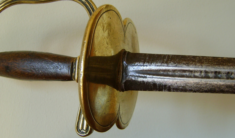

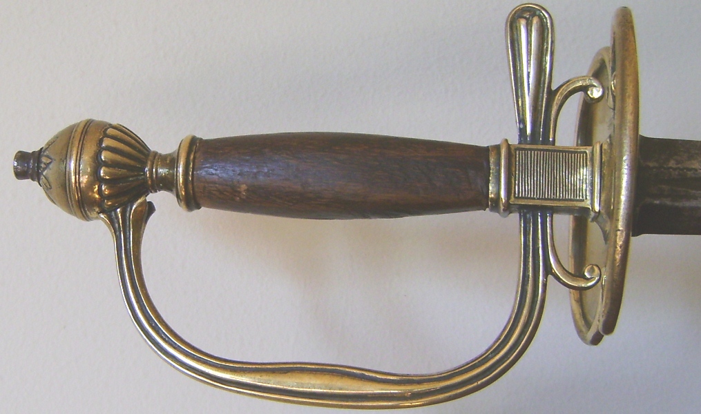

This is another Portuguese regulation sword for infantry/artillery officer mod. 1806 that i got in a swap operation.
This time the blade, instead of being German like the previous one, is an early Spanish ... or it all indicates it is. This custom doesn't constitute a surprise, as period officers had to purchade their swords and, either for sentimental or economical reasons, they ordered their family ancient blades to be mounted, respecting ( + or - ) the regulation length. Hilts had to be made within the rules, with only slight variations, depending on the officer wealth or rank ... brass or silver components. This example has a plain wooden grip: i don't know if this was a decision of the original owner or was a later replacement. These grips are usualy wired with silver filigrane, like te other one i have.

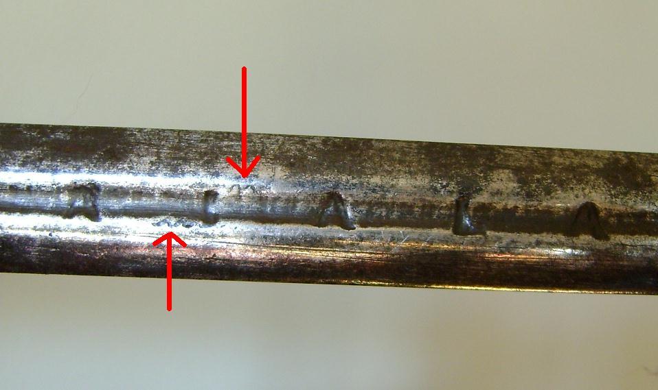

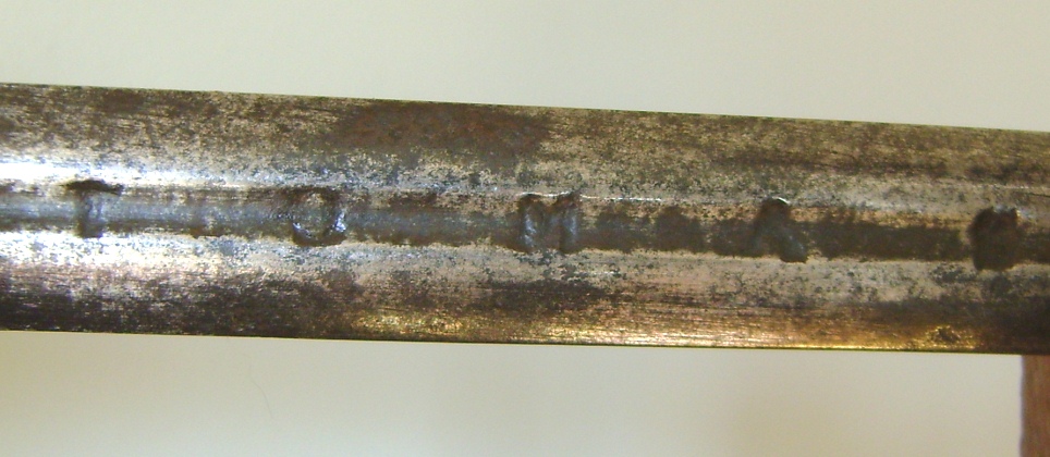

But the issue, such as i would like to emphasize, is the name of the blade smith: TOMAS AIALA; the usual story of the name of this famous sword smith, which was copied by so many competitors of the period. Not that so often blades made by other smiths had the same quality but, fame is fame.
I ignore whether this specific one is genuine; i am ready to accept it is not. An amazing detail are the little wavy signs near the I for AIALA. Given that the actual name of this smith is more often (or also) registered as AYALA, i make it my fantasy that the waves are to remind the Y. Not much sense in this but, the waves are (only) placed in this letter for some reason.
It looks like a nice blade, anyhow. Length 87 cms.
Comments will be much welcome.

Really beautiful sword Nando! and as you have well surmised, it is of course not a true 'Ayala' blade, but one of the Solingen products of the 18th century, and I am inclined to think these were earlier in the century than the well known 'Spanish motto' dragoon blades.
Tomas Ayala was a late 16th century Toledo smith whose name, according to Mann (Wallace Coll. 1962, pp.288-9) was one of the frequently used names as rather a 'brand' well into 18th c. I believe he ceased c. 1625.

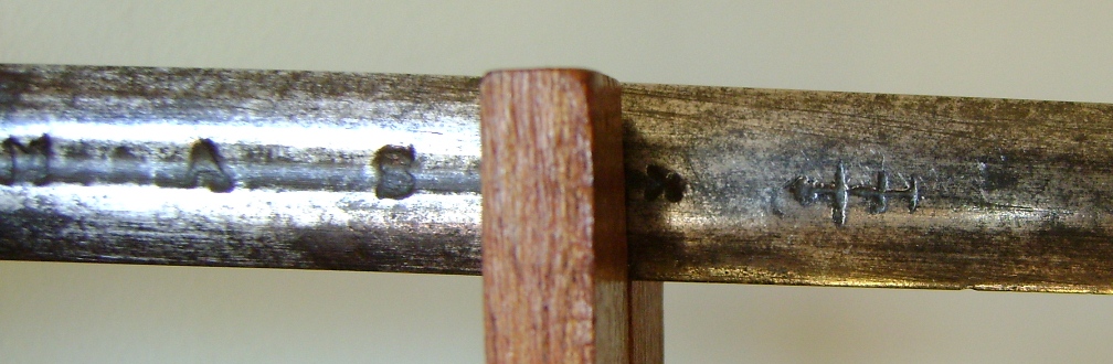

Your note of the curious mark over the 'I' (which is apparantly the German spelling used in place of the 'Y') is a well considered thought. As you know my obsession is with markings, and I am wondering if perhaps this vdery subtle mark could have other meaning than you suggest. A similar mark (looks like a bird in flight) is known in some of the esoterica as a kind of signature associated with the order of friars of Brothers of St. John.
If I recall this or similar order was situated in or near Solingen quite early, and there were numerous symbols etc. used by Spanish adopted in some German contexts.
While of course not necessarily anything supportable at this point, it seems clearly a deliberately placed, yet unobtrusive mark and would be interesting to look more into.
The other mark seems a sort of 'serpentine' symbol as well as the parallel undulating lines at the forte, which seems we discussed some time ago as a recurring symbol on a number of renaissance period blades.
