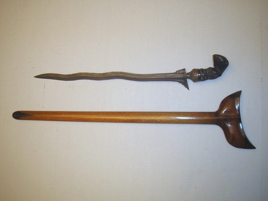

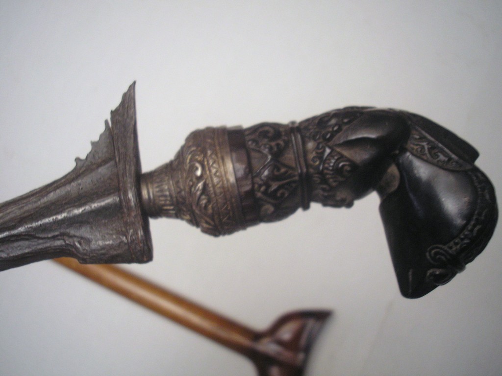

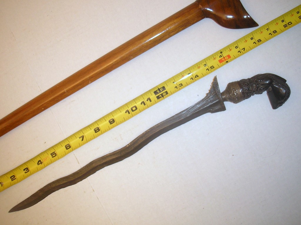

Dear friends,
This kris panjang was just sold on Ebay and I would like to get your opinion about it. The hilt is in Jawa demam style from Northern Java and the selut in South Sumatra style. My question relates to the wavy blade which is very unusual for this type of kris: it seems to me that the waves were made later and are uneven, and the blade seems to have been shortened (15 inches long only and the tip is not symmetrical). Your opinions will be welcome.
Best regards
Old 23rd September 2013, 09:09 PM   #2
Posts: 7,303
Originally Posted by Jean
Dear friends,
Best regards
I tend to agree with you Jean and didn't have much interest in this blade because of those very same observations.

I have actually handled this blade and you know immediately it is way off as soon as you do handle it. I can't remember if it fit properly in the scabbard, but I don't think so. Looks like a parts piece all around.
