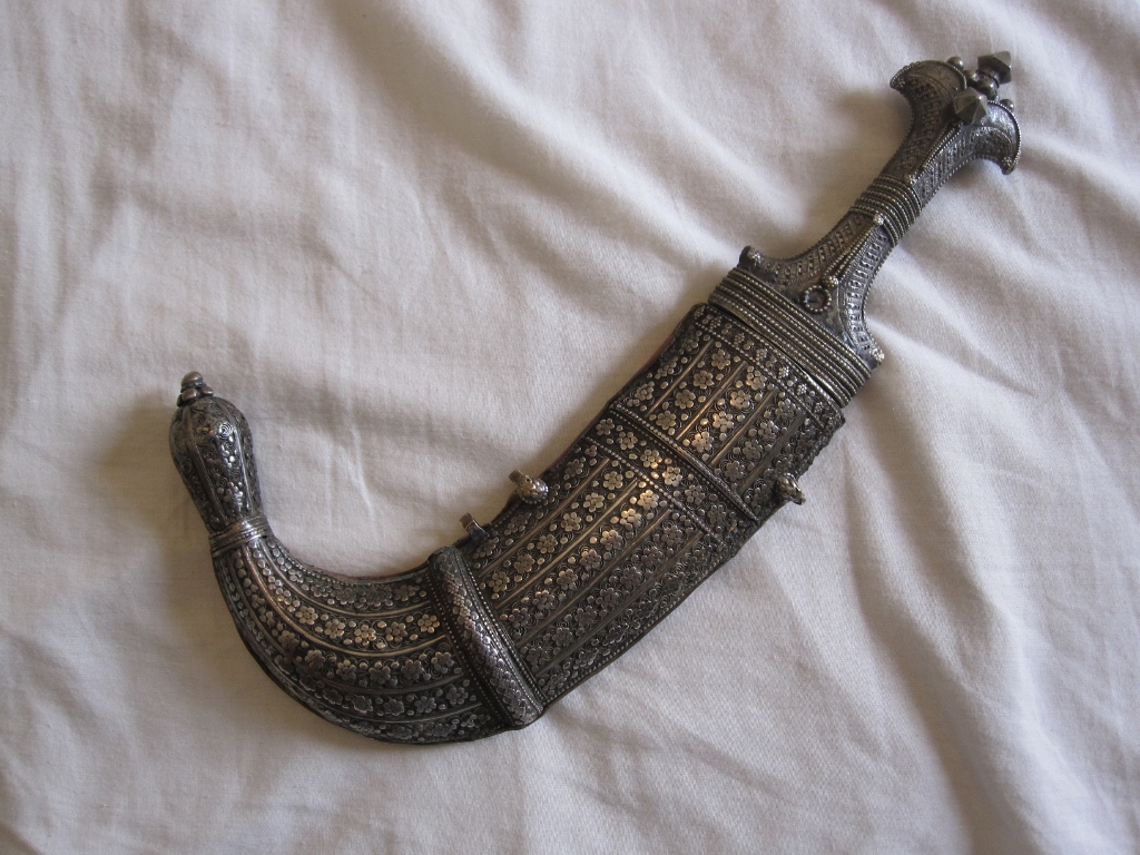

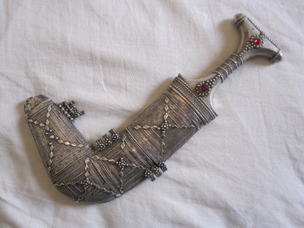

thanks for the info guys. I shall put the pictures of the items I want to clean.. will go with your advice..
Pictures coming later today.
