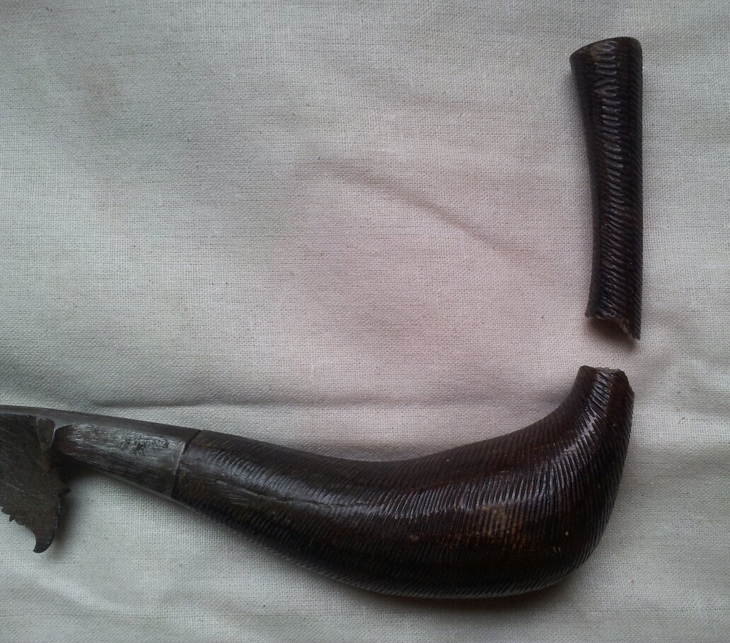

The second Rencong to fall into my custodianship arrived the other day. I picked it up cheaply as it was incorrectly listed. My heart raced as I opened the parcel. Joy soon turned to sorrow, expletives and tears when I saw that the Meucannge Hulu had snapped in transit!
I was/am devastated. Other than the absence of a sheath (sarung?) the piece was in near perfect condition (by my humble standards). The seller had packed it as if he was moving it across the room instead of the planet! He was a lovely guy though, equally upset by his oversight, and gave me a partial refund. He also offered me first dibs on anything he finds in the future which is nice.

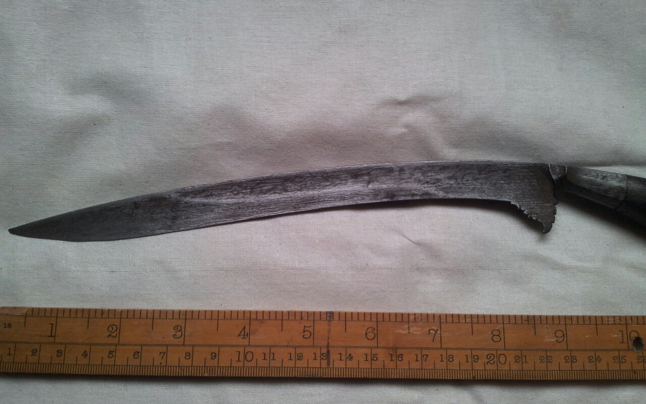

I would appreciate any general thoughts and comments about this rencong: age, quality, origin &c. I am still very much a novice collector, and I am hungry for knowledge.

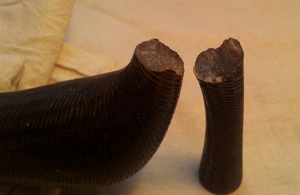

How would you go about repairing the break? As you can see from the photos, the break is very clean and can hardly be seen when placed together. Another collector has suggested CA (superglue), but I am somewhat hesitant to do anything without more advice.
As I would like the repair to be functional as well as aesthetic, perhaps I should incorporate a retaining pin of some kind to add strength (I have seen a similar repair online). If so, what pin material? Brass, stainless, wood, water buffalo horn? What glue/resin? Any advice on techniques/pitfalls? I am no craftsman, but I have friends to help me.
Importantly, can someone tell me if the macro image of the break is showing the natural broken surface of the horn? It looks very "shiny" to me, I was wondering if I am seeing the residue of an old repair.

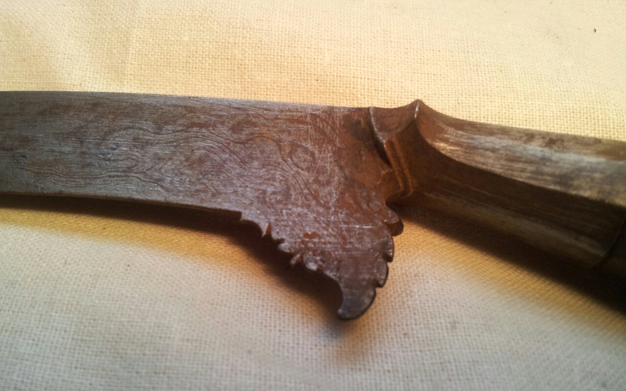

Here is a portion of the seller's photo. On closer inspection I think I can see a repair (or crack at least) in the right location.

Possibly one might apply a very tiny drop of say, acrylic artist's paint or some substance that will leave a mark to the center of one part .
Then carefully and very lightly press the parts together in the proper aligned position .
Pull them apart and you will have, at least a rough idea from the residue of where to drill on each part .
Yeah, there was a previously repaired/restored break in that spot .

Looks like a good 19th century rencong.
I'm pretty sure that the break is old and got glued already.
With the rather thin hilt part, this repair is not easy to do but you'll need a (metal) pin, indeed, and work very carefully.
However, before you start with the repair work, make sure to remove all old glue! The probably best way would be to have both surfaces touching a damp towel for several hours (possibly up to days) until the glue softens and gets whitish, then carefully clean off all glue with needles and forceps; afterwards let the horn dry slowly and let all pieces equilibrate for several days in a well-ventilated place with as little fluctuating humidity as possible.
