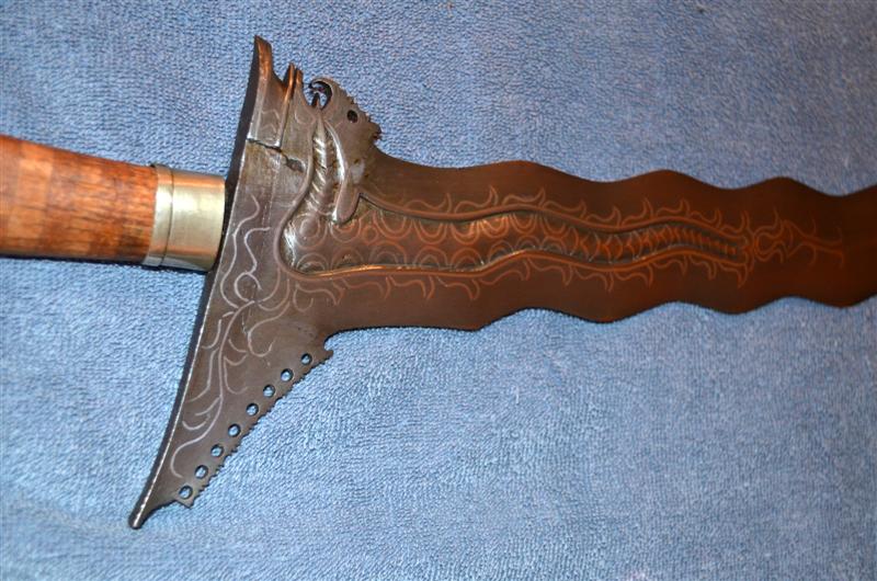

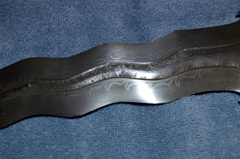

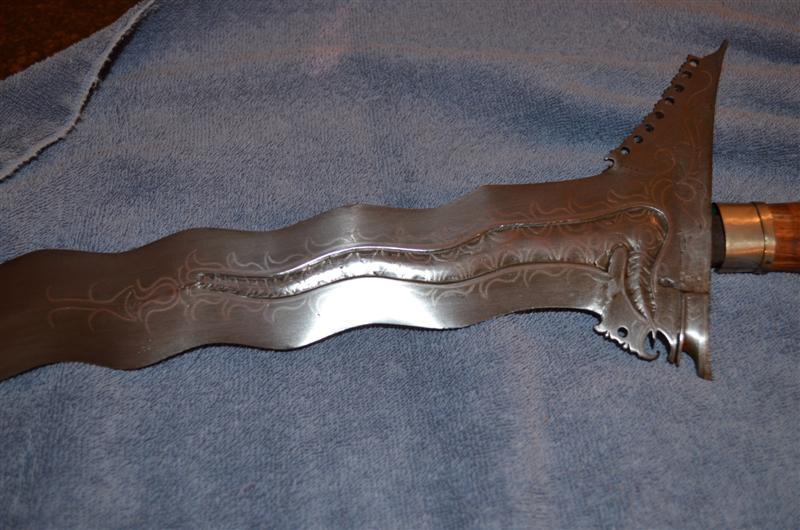

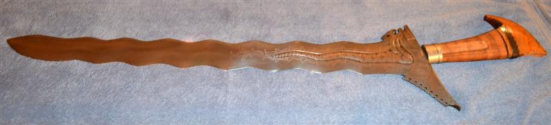

Here is an interesting massive Sundang that I just acquired; as you can see, there is a lot going on in the blade. The handle is in bad disrepair.

drac2k: You have a nice clean blade with good inlays. I think this is an early 50s piece. I have one similar but with an intact asang and handle. Too bad the pommel is broken. There is a dealer on ebay who has some very nice new moro handles that are made in the correct style. This could be one way you could go if you feel like doing any restoration...........Dave.

Thanks Dave, I thought it could be post WW2, but it is of pretty good quality; are the inlays silver ? It is a distinctive blade; any way of knowing who made it ?
It would be great seeing yours, intact.Any chance ?

yes, agree with Dave, a post WWII blade of nice quality, the sharp luks indicate it as later blade. If the inlays are from silver you only can test byself with silver test or let it test by a jeweler. Like Dave said there is a dealer who sell time by time nice handles but maybe you can grind it down to a form like this one from my own collection: http://www.vikingsword.com/vb/showthread.php?t=12825

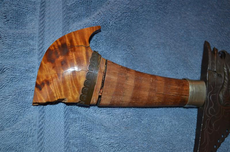

Handle wrapping can be done easily, the biggest concern will be the missing asang-asang.

Wow, the picture shown looks very much like mine ; it could be it's brother. With the distinctive blade, could it have been made by the same "sword smith ," or a family member?
Now, I am confused; generally as a rule of thumb, I thought that the larger kris , with sharp luk(s), were WW2 or later .I have seen old postings from the Smithsonian with such swords attributed to being brought back from the Moro Insurrections, but as we all know, even museums get things wrong : so I thought ,maybe they made a mistake .At this time, I am not so sure .
Great information coming in from the forum !

Congrats, a very good bargain you got there!
I believe this could well be Maranao, possibly from the Lake Lanao area.
I don't think we'll be able to pin down the panday who crafted this blade - it's probably more like a recognizable style which was in fashion during an extended period and possibly crafted by a number of (possibly unrelated) bladesmiths. At least there are varying qualities if you compare several similar pieces.
I'm fairly convinced that the inlay is silver. If it tarnishes like silver a while after polishing, you probably won't need to test it. Brass inlay is more difficult to work with and this is quality work done for a customer who could afford to pay for silver.
I believe that Detlef's sugggestion to recarve the remaining pommel is certainly worth a try. Get Jose to do some metal bands for the gripping area if you like to restore the original appearance as much as possible.

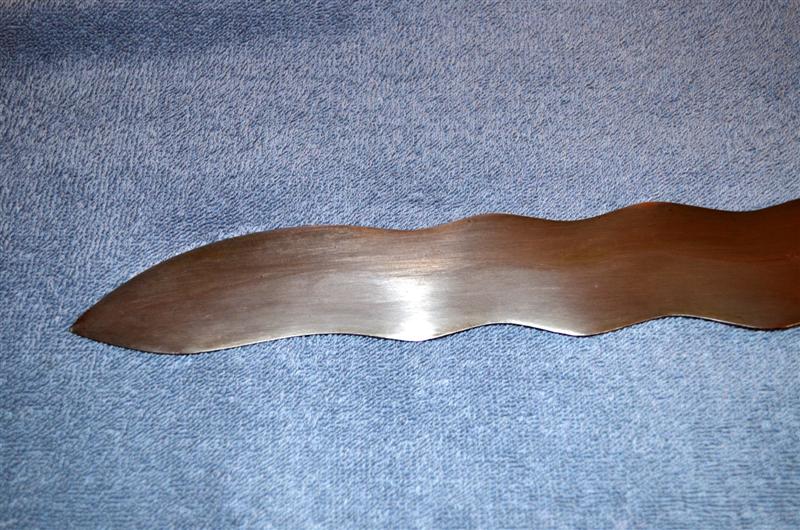

Are you going to etch the blade? I believe it could be worth it!

In regards to etching, I am not experienced enough to try and I rather not harm an item, which by luck has been placed in my care.

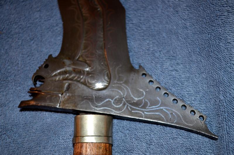

Regarding age, Dave your example is made without a separate 'ganja' and I do believe that one is a later one, but Drac's example has the separate ganja and the workmanship(chiseling and silver inlay) seems a bit crisper, though the curves do seem awfully 'extreme' for an earlier example.
I think that example is more likely early 20th century though the blade's exaggerated curves, especially at the forte, seem to argue against it a bit.

Charles: After looking much closer at his pictures, it does indeed have a two piece ganja. With just a quick look i missed it. It probably does place it a generation or two earlier than at first glance. Apparently sharp lucs might not always be an indicator of later pieces............Dave.

What I find interesting about Dave's kris is that it has a mixture of sharp pointy luk and more typical late 19th, early 20th century smoother flowing luk. If you look at all the pictures, not all the luk are pointy. In my experience, the later pieces have ALL pointy luk. I think the provenance is solid enough on this piece. To name an individual and the fact that the items were in storage since the 1930's I don't think was provided loosely. Auction houses rarely list that kind of provenance. If they didn't have a certain degree of certainty I don't think they would have mentioned that. Then again, I have seen auction houses out and out lie but I don't think that is the norm, I think that tends to be the exception. I think they misidentify way, way more but in this particular case I would have more confidence in the provenance and would say this kris is 1900-1920. Without the provenance, I personally would have placed that sword circa 1930-40 so we are only talking a 20-30 year difference. Where did the dating philosophy of pointy luk originate? Has it ever been challenged? Are there other provenance examples that show pointy luk that pre-date WW2? I think this piece stands on its own and whether it is 1920 or 1950 is pretty inconsequential to its appeal as is.

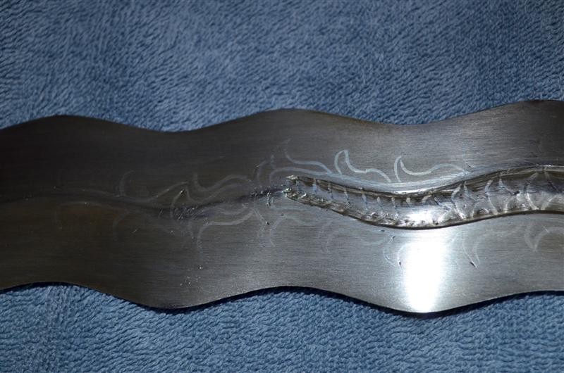

I would still be interested to know if this blade is laminated or mono steel. Drac2k, you don't need to be particularly skilled to do a mild etch on this blade. Vinegar can act as a gentle etching agent, enough at least to show laminations in the blade if they exist. It is also very easy to polish the effect off. Kind of hard to ruin the blade with this method. I still think knowing whether it is laminated or mono steel will go a long way in helping top determine the age of this kris. While i think there are some examples out there of older mono steel pieces, most older kris are laminated and most recent examples tend to be mono steel. Again, if it is indeed mono steel AND has pointy luks it seems a good indication for a later dating.

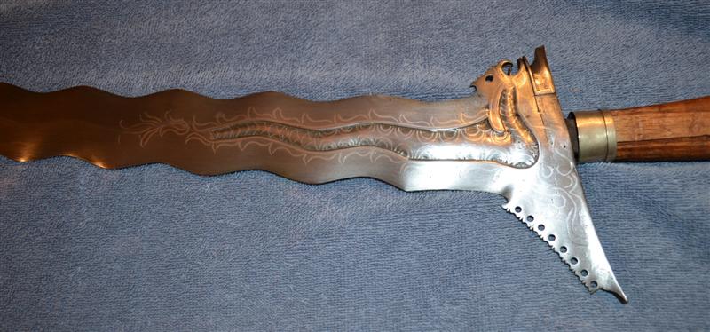

Thanks for the information.I bought an old Philippine blade in poor condition to explore etching.Do you use white, wine, cider, etc. vinegar.Do you soak it or brush it on? How long do you leave it on ? Do you neutralize it with baking soda when finished . Is there any treatment afterwards.

I use vinegar essence and dilute it with water, make it hot and brush it on. Some blades show soon reaction and others not. You will see the reaction. And yes, clean the blade under running hot water and neutralize it with baking soda when finished. You can brush it also carefully with steel wool after all, not to strong! This is how I do it, others will do it a little bit different. Normally it will work.

What percentage of vinegar essence to water; 50/ 50, 25%/75% ? Do you mix them in a pan and heat ? Do you brush on the mixture and steel wool immediately or do you let it sit until you see a reaction and then steel wool after rinsing with water and neutralizing it with baking soda ?

I don't use something to make my mixture, I heat water in a pan and put the essence later in, would guess it is a mixture 10 (vinegar essence)/90 (water)% (look that your wife is not at home and open the window, strong smell) and brush it on with a dishwashing brush with natural hair until I see the reaction, first one site and than the other, when I am happy with the result I rinsing it with hot water, after this neutralizing with baking soda (you also can use soap), dry the blade (blow-dryer) and after this you can polish it carefully with steel wool. Don't forget to oil the blade after all! Like said, others will have an other practice but this works normally for me. But frankly said not every time I have had reaction, I have had it one time that a blade don't show a reaction. Don't ask me why!? A friend have etched this blade with a other solution and have get reaction.
Use the search function with etch/etching and you will find other recipes also.

Dave, one test that Spunjer uses prior to an etch is simply to run some hot water on the blade for a few minutes and watch closely. He can see the laminations in the blade this way. Of course, as soon as you take away the hot water they go away.
