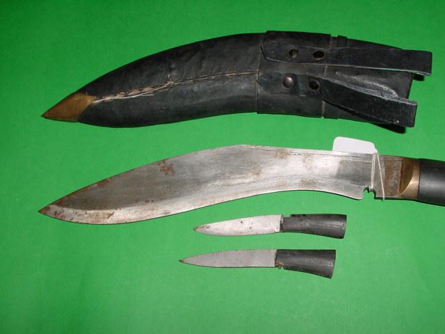

Hi all
I was hoping one or more of the kukri experts here would comment on this one, described as vintage, with horn handle and in very good condition. It looks like a BSI post war to me but I know nothing. With thanks and wishing all of you a good collecting year.
cheers

HI DrDavid,
Well its certanly based on the the post 1960 design, The so called BSI.
2 offcial versians are made of this knife, the standard & the cerimonial .{Although a beater versian sometimes called a jungle kukri is also issued on occasion.} So in reality thats 3 offcial varients.
I would say that for evry one the British army has bought probably 200 replicas are made! So true originals {by my definition.}are sometimes hard to find.
They have been made by many firms over the past 40 years with consequant variations in design & massive variations in quality.
I would say yours is probably the jungle versian. Based on finnish, leather type & frog.
Somtimes it hard to differentiate the jungle from the standard though, given the different makers.
What length is the blade & what does it weight?
Spiral

Hi Spiral
thanks for the input. Further information as requested.
wgt about 600gms (21 oz)
blade length 27 cm (10.63 inch)
overall length 39 cms (15.35 inch)
cheers

Thankyou Drdavid!
Well thats to heavy for British Army Gurkha spec. They are normaly 14 to 17oz.
So its a Nepali copy of the jungle kukri, The added weight {presuming its well tempered.} would make it a good camping tool for splitting kindling etc.
I hope you enjoy using it.
