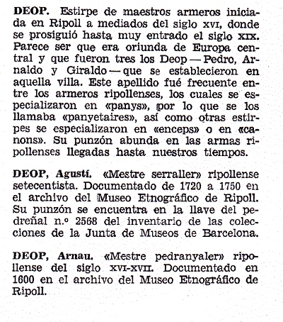

I have been spending a lot of time lately researching Arm and Armor makers from Catalonia. Most of the information I need is only available in expensive out of print books written in Spanish or Catalan. The first of these books that I have been able to purchase is “Diccionario Biografico de Artistas de Cataluna, desde la epoca romana hasta nuestros días.” Biographical Dictionary of Artists of Catalonia, from Roman times to the present. By J. F. Rafols and published in 1951.
Can anyone please help me with a translation on the Deop family of gun-makers. Google Translate is not much help. Here is what I know about them so far from "A History of Spanish Firearms" by Dr. James D. Lavin (1965), Page 219-220.
Deop was Ripoll`s first family of gunsmiths. They supposedly immigrated from Germany in the mid sixteenth century, and were still manufacturing gun locks well into the nineteenth century. The size and long history of this family contributes to the confusion when trying to identify an individual maker.

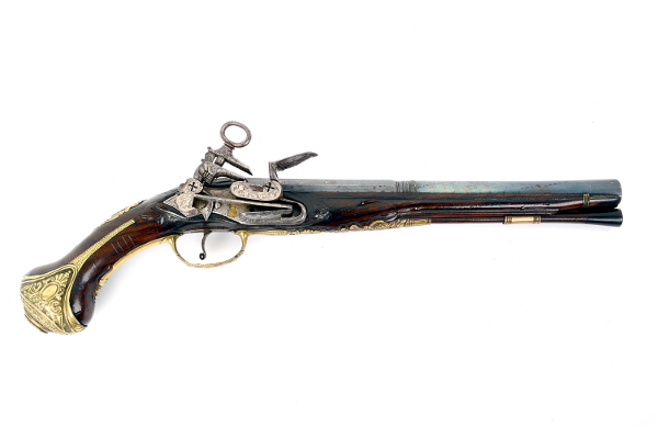

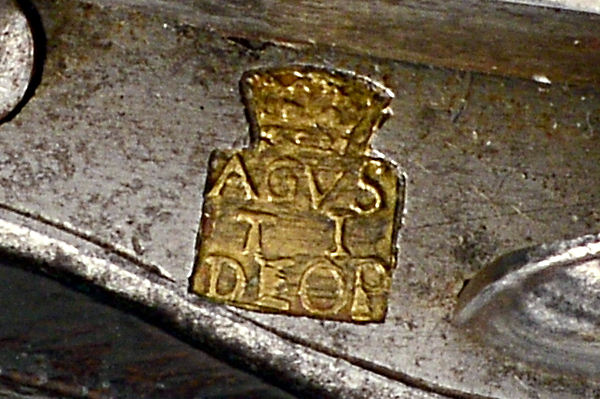

Attached are two photographs of a holster pistol with a lock made by Augusti Deop, and two pages of information on Deop makers in Spanish.

Here is an example of how the on-line translators handle the first section.
Google Translate
Malestros Eshirpe of gunsmiths miciada eu Ripoll xvx mid century, where prcsiguio far into the nineteenth century.
Apparently it was Orlunda of Central Europe and that there were three Deep - Peter, Arnaldo and Gimldo - that establecleron in
that city. This surname was often eutre ripollenses gunsmiths, which specialized in Pany << >> so that the
panyetaixes << name >>, asf estlrpes other specialized in enceps << >> or << cenons >>. Their weapons are abundant in punzén
ripollenses arrivals until nuescros times.
Bing Translate
Malestros dealers miciada eu Ripoll in the middle of the XIX century Eshirpe, where are prcsiguio to very entrance century xrx.
Seems it was orlunda in central Europe and that three were the Deep - Peter, Arnaldo and Gimldo - that is establecleron in
the ville. This last name was frequent bead the dealers ripollenses, which specialized in < < company > > so it is the
It was called < < panyetaixes > >, as well as other estlrpes specialized in < < enceps > > or < < cenons > >. Its punzen abounds in guns them
ripollenses departures up to nuescros times.

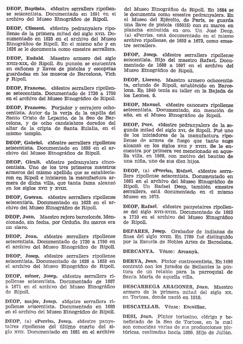

Old 9th February 2013, 02:12 PM   #8
I Guess Fernando K translating engine has betrayed him .
Pedrenyal is a flintlock gun (a sort of big pistol).
Serraller, like Panyetaire, is a lock smith; only that serraller is a more generic name.
If you pick one or two of those Diop guys, i may translate what the book says about them.

Augusti Deop. Master lock smith from 1700’s Ripoll. Recorded between 1720 - 1750 in the archives of Ripoll Ethnographic Museum. His mark (punzon) may be seen in the lock of flint pistol (pedrenal) nr. 25678 of the inventory of the Board of Barcelona Museums.

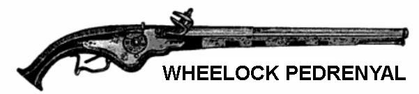

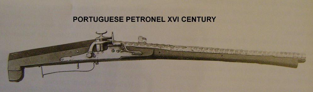

Old 10th February 2013, 01:31 PM   #14
Default Deeper into the question
Well, in the true sense of the term ...

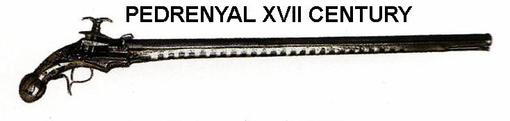

1 - A pedrenyal (Castillian pedreñal - Portuguese petronel) doesn't distinguish the ignition system per se. The term derives from the French petrinel or poitrinal (Latin pectus), meaning that you shot the weapon with the butt against the chest. They are either found in matchlock and flintlock. The sclopus was the prototype of the petronel. The petronel is a compromise between the harquebus and the pistol.
I personnaly doubt the matchlock mention; would better understand wheelock.
2 - What Lavin says in page 230 that the pedreñal (pedrenyal) refers to the ignition system, as the term derives from the Latin petrinus (stone, hence flint), we have somehow a contradiction to the first version.
Cervantes mentions that the bandits had fewer haquebuts than pistoletes (locally called pedrenãles). But he doesn't specify whether these were wheelocks or flintlocks, both igniting with a flint.
3 - One certain thing we may infer is that, the pedrenyal=pedreñal=petronel was a huge hand firearm, an (one of) ancestor of the pistol. The ignition system had to do with specific provenances, fashions and their relative technology evolution.

I had my cyber friend and ISIFIF member Alfredo translate the generic Deop entry that Dana posted and this is what he came up with. I have not looked into his trouble with the Roman numbers (as they confuse me to no end). Please comment on apparent errors in his translation, if found. Thanks
(DEOP) Lineage of firearm masters who started in Ripoll mid XVX century (the roman numerals don't make sense XVX, if the V was I instead, then it would be nineteen century, same as xrx, replace r with I) where it kept going well into the nineteen century. Seem to be originated in Central Europe and there were three Deep -Pedro, Arnaldo and Gimido- who settled in that village/ city. This last name was frequent among the gunsmiths ripollenses, (from Ripoll) who especialized in <<pany>> reason they were called <<panyetaires>> just like other lineages specialized in <<enceps>> or in <<cenons>>. Their trademark abound in guns that came from Ripoll until our times.

Migueleter at al:
"cenons" not. CANONS Yes (barrel)

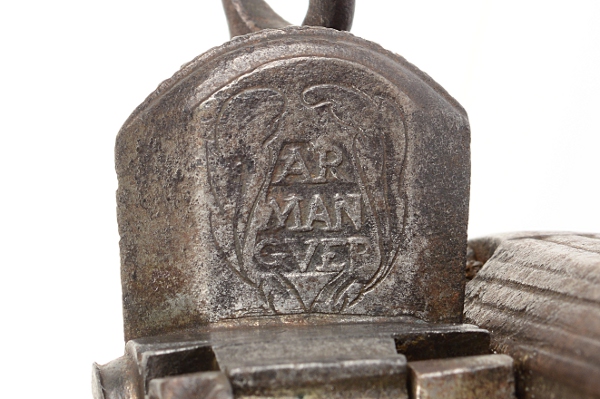

You are right Fernando, it was "famosa". My OCR picked up the text wrong and I didn't catch it.
Armanguer, Ripoll, Spain, Circa 1675
List of Spanish Gunmakers with a Collection of their marks, Page 93 and 98
Spanish Guns and Pistols, by W. Keith Neal (1955)

Puxxzén = punzón = punch

ARMANGUER: Armero y grabador en Ripoll, siglo XVII
ARMANGUER: gunmaker and engraving, XVII century
Ramiro Larrañaga "Sintesis Histórica de la Armería Vasca", page 251
