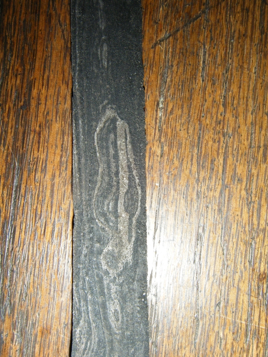

Default keris for charing
keris loek 5

Interesting tambal keris.

hello Sajen
I don`t think you can call it tambal

How you would call it?

hallo Sajen I realy don`t know i think when you will call it tambal ist have to be more round tambal ( meaning band ) and this pamor is not round some one tel me Pamor triman ?????
regards Semar
Hello Hans,
pamor tambal describe/mean a insirted piece of metal, most of the time from an older blade, inside the blade, equal if rounded or squarish and what I can see from your pictures it is just like this.
I have a keris also with squarish pamor tambal, will post pictures.

The word "tambal" means a patch.
This is so in both Javanese and Indonesian.
Pamor tambal is any pamor where a patch of pamor has been welded to the blade, either during its original production, or later in its life. That patch of pamor can be either mlumah or miring.
For those of you who have actually been to Indonesia, throw your minds back to the sign often seen at the side of the road:-
"TAMBAL BAN"
This means
"PATCH TYRE"
In other words:- "tyre repairs are done here", and these repairs are done by patching the tyre.
Pamor tambal has nothing at all to do with shape, or the kind of material used, it simply means that the pamor has been applied as a patch.
