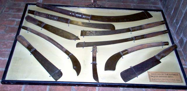

Default Some pre-1889 working dhas from Burma
In case anyone is interested. Not terribly high quality photo, I'm afraid; unfamiliar camera, dark museum, and they were mounted on a wall overhead in a stairway.
These are in the Pitt-Rivers Museum in Oxford. The label reads "Varieties of the Burmese da for various uses. Pres[ente]d by Capt. R.C. Temple R.E., 1889."
I have some shots of Naga daos and spears and some other Asian miscellany from the same museum, if anyone is interested.

Old 5th January 2005, 04:04 AM   #10
Spunjer
Spunjer's Avatar
Posts: 1,730
dennee,
all swords are welcome! please feel free to post your other pics. looking forward to seeing it...

tom hyle
Location: Houston, TX, USA
Posts: 1,254
nice pic, and interesting. Thanks. That one looks really panabassy, don't it?

Posts: 4,717
Thumbs up Good stuff
Dennee:
Please do post more pictures.
Like many museum collections, mislabeling is quite common. In the photo you show from the Pitt-Rivers, the bottom one on the right is a form of tool, similar to a heavy knife still used for splitting coconuts. The bottom one on the right is also a heavy utility knife.
The second from bottom on the left is a pisau raut (rattan knife), used for splitting rattan into strips. This style is common today in northern Thailand/Cambodia -- the long hilt is rested against the chest and the blade lies on a flat surface, with the rattan being drawn along the cutting edge towards the cutter who is seated. The second from bottom on the left appears to be a heavier bladed variant of the same.
The rest are knives and short swords, some of which are probably Burmese, but a couple of the longer hilted ones could be Thai. Hard to make out the detail of the hilts. Interesting collection of blades.
Thanks for showing these.
Ian.
Old 5th January 2005, 08:43 AM   #13
wilked aka Khun Deng
wilked aka Khun Deng's Avatar
Location: Oahu, Hawaii
Posts: 166
Lightbulb Knife or sword
This is a great thread y'all have really made me think and I even sucked my wife into this discussion to clarify some points on language usage.
Excellent points Tom and Andrew, actually the photo that Dennee supplied illustrates this discussion extremely well. As Ian has already correctly identified these I'll talk about the terms in the Thai language used to identify these blades. "meed" is the term used to identify cutting blades in Thai while it can be translated as knife "cutting blade" is more accurate in actual usage. "meed darb" or shortened to just "darb" specifically refers to swords as does the term dha I believe unless modified by a second word.
The rattan knifes in Dennees picture are also called "meed wai", the coconut knifes are called "meed phraa" (chopping blade) now these terms may vary slightly according to region as may the shapes but they all carry the same connotation, that of a utility blade. They were made with a single usage in mind.
To be classified as a dha (darb) they must at least have a dual use as a fighting weapon (yes knives can be fighting weapons, but NOT a main battle weapon) or be designed solely as a fighting weapon. That means it must have the length to reach through an opponent's guard or past his/her shield. It must also have speed of manuveur. Heavy knives and shorter blades don't meet that criteria (and please don't argue fighting techniques - I'm discussing actual usage of the terms). The two on the right in Dennee's photo have that length and would would meet the minimal dual use criteria and the range criteria and would be referred to in Thai as darb or meed darb.
Tom, I think you should see some difference in intent, however I agree you won't see many differences in design or construction in most of the lower class swords as these were generally made by the same village smiths that made the knives. Only the higher grade swords would show that variance in design and construction, and that was usually directed by the person commissioning the blade. Additionally, as with most things, you have those that make the high-end stuff and those that have found their market niche in the low-end.
That top one looks more like a panabas to me - never seen one like it in Siam.
