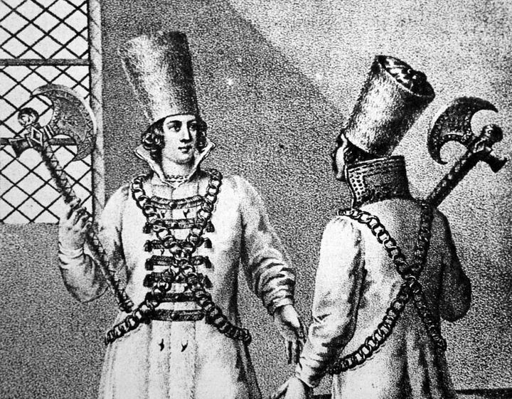

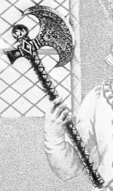

I'm looking for any informations, catalogue pictures and measurements of russian guard axes. I have only this one picture, posted below. I believe they were in use in 17th century, but maybe also earlier and later. They are of crescent shape, quite massive, and in general they seem to be similiar to parade axes known from Persia (tabar-zins) and Turkey.
I really hope you have something like this in your great libriaries

I'm sure axes are Russian. I was looking for them in some Russian books, but I found nothing. This picture is from old book "Risunki odiezdy u wooruzenija Rossijskich wojsk" (I tried to transliterate from Russian alphabet, so excuse me any mistakes.

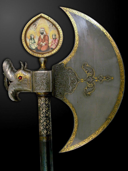

They are very similar to Mamluk tabars.

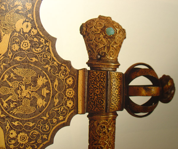

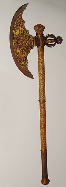

The book Ariel mentioned is beautiful indeed. There is a picture of an axe (my sketch of this axe below), but I wonder is it Guards axe, while in presentation text we can find information about "Ambassadorial Axe". But I believe it's a good hint anyway! On the picture we can see that axe is inlayed with gold wire, there is Russian two-headed eagle among the other plaits.
Regards!

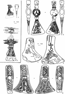

These axes are very different from the ancient rus ones. Attached are status
(lords') axes of the northern areas.

Ha! Rynda! Google search help me to find that they were tar's personal bodyguards recruited from the noblemens, equipped with the best weapons and horses, always close to the emperor. There is a site with "Russian scale models" where is figurine of almost identical Rynda as on my picture, with axe, dated on 16th century. This axes (according to other forum - The Guild forums) are called "POSOLSKI TOPOR", but I have no idea what this "posolski" is meaning . Most of the russian-language people are tending to call such axes "berdish/berdysz". Rivkin, I always thought it's Russian word . Berdishes, in strictly todays meaning, were great axes, with long edge. They were in use first of all in Russia, then in 17th century in Poland. After the years, the "Berdish" word is often assign to just "big axe" I think.
Are you sure AMBASSADORIAL is the same as RYNDA? I always thought that ambassador is some kind of envoy from another country. And if Ambassadors were called Rynda, maybe it's just the same word for two different things? Uh, I think I will need some explanation before I get lost

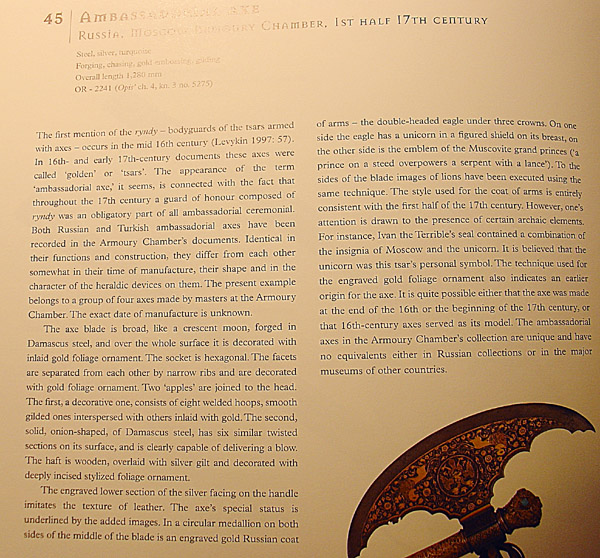

hi michal,
i assume this is the axe that you have drawn (silhouette).
it is thought to be 1st half of the 17thC, but no exact date is known.

Hi Brian! This is exactly the same axe! I'm happy about the date, because I'm looking for the axes just from this period (strictly around 1640-50). Thank you for this photo.

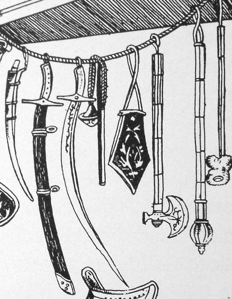

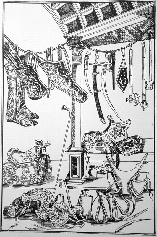

Another picture of russian axe of this type, from known 16th century engraving, where you can also find other Russian weapons and armament. If anyone have other pictures or informations, please post them here.
Regards!

hi michal,
not sure if this is of any use, nor whether you will be able to read it here. if not, i will email you a larger pic if requested. it has the stats at the top.

Arrow
Thank you Brian, everything is legible, and this text is next great help. As we can read, they are great rarity. But this is rarity of ambassadorial axes, I wonder what about simple war axes, or just ceremonial axes (if there were any) like this presented on engraving, with other (most or less) popular or known weapons. Well, we have sabres, bows, saddles, everything what we can find on this picture, but axes
