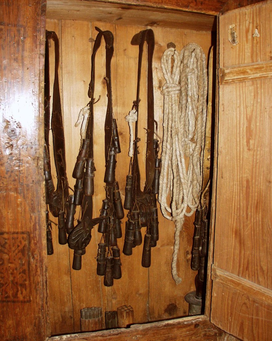

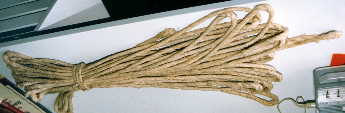

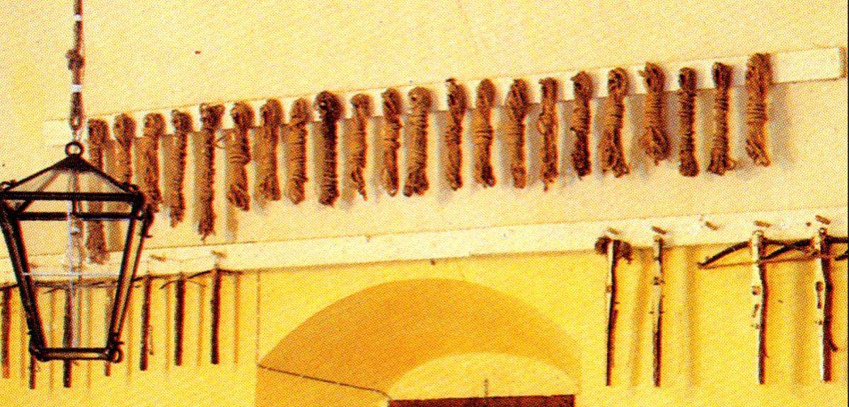

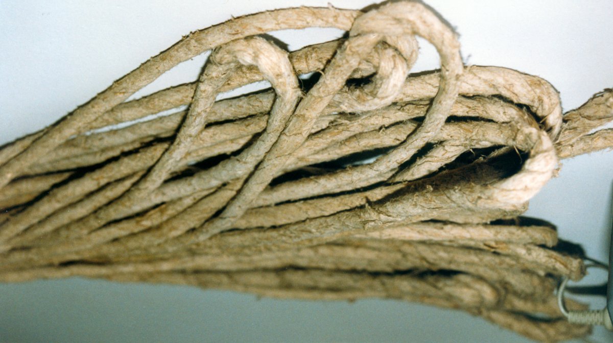

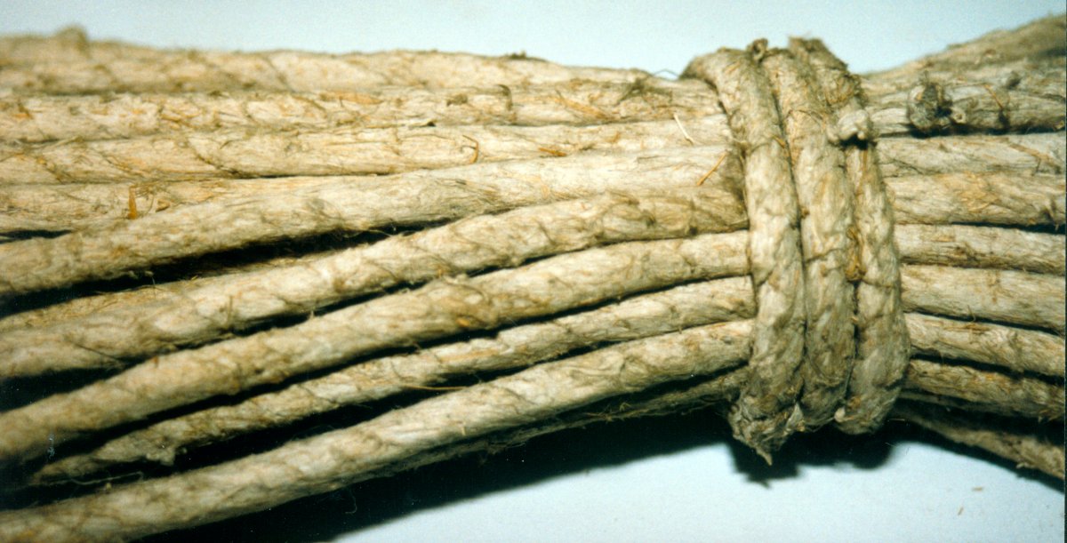

Surviving large bundles today are extremely few, known only in the armories in both Churburg, Sluderno/South Tyrol, and the Fortress Armory of Coburg/Franconia. A great number of them is known to have been kept in the fortress of Hohenwerfen near Salzburg/Austria but was sold together with the complete contents at auction in New York in 1927.

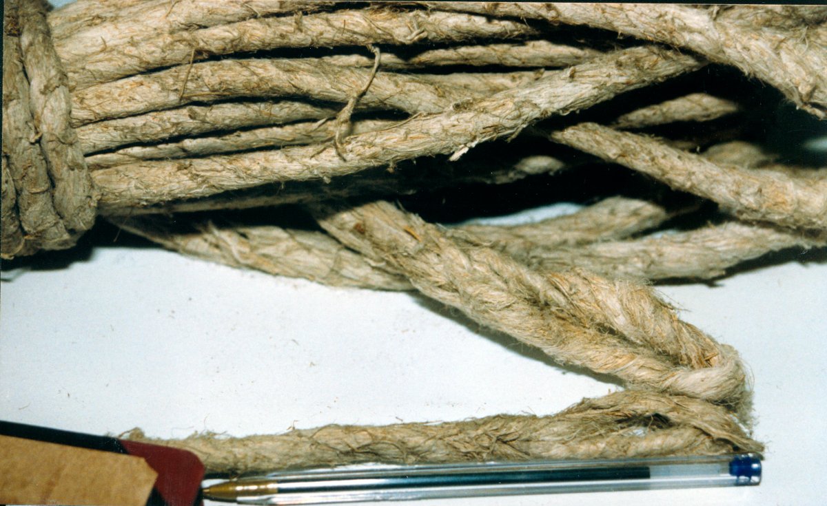

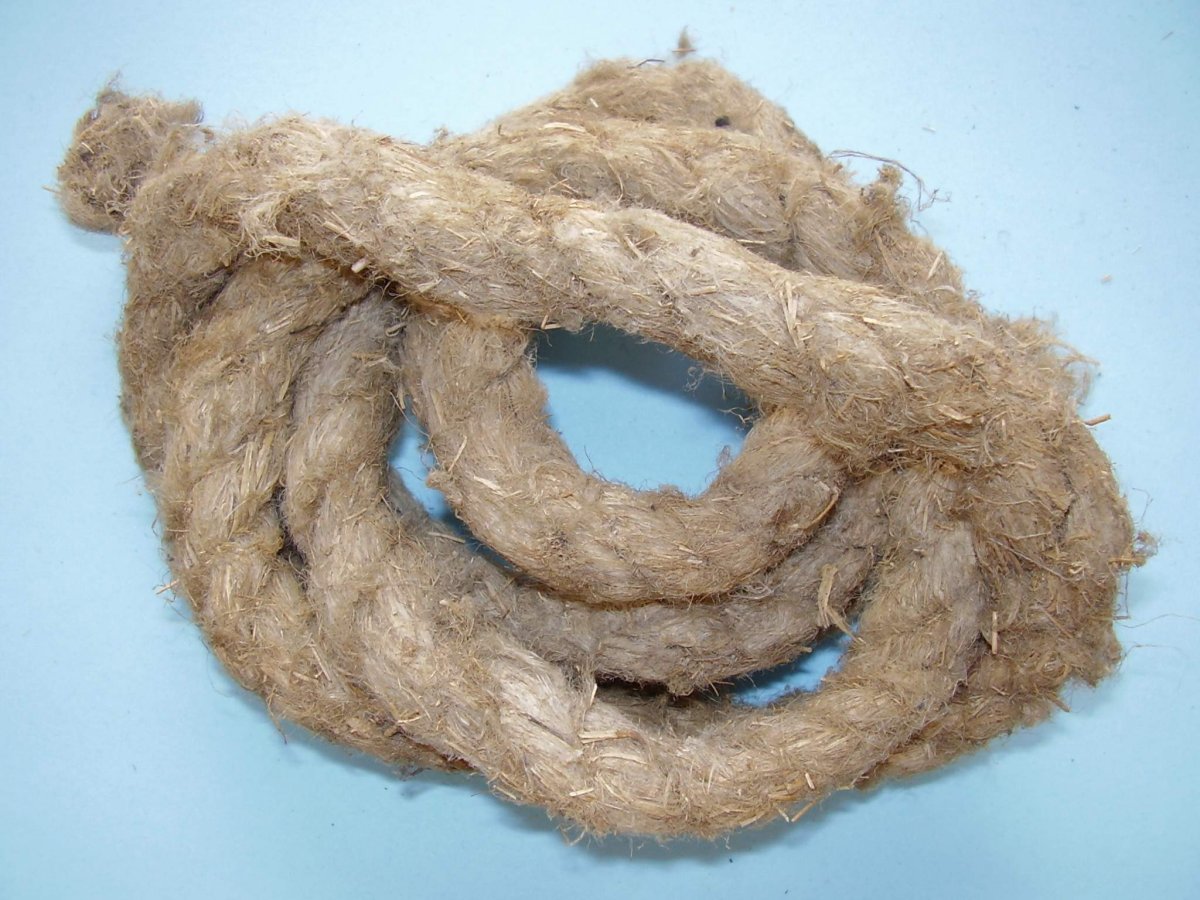

The author was given the chance to closely inspect the bundles preserved at the Fortress Museum (Veste) in Coburg. They measure about 80 cm length in average, each consisting of a great number of loops adding up to a total length of ca. 35-40 m per bundle. Small bundles carried by both musketeers and calivermen only seem to be preserved in the Vienna Arsenal (Heeresgeschichtliches Museum Wien), plus another in the author's collection; they measure approximately two to three meters in length, laid in small loops.

The average thickness/diameter of surviving samples of matchcord varies but, consistent both with depictions in period artwork and the Fronsberg samples, seems to have been as thick as ca. 2 cm in earliest times up to the first half of the 16th century, narrowing down to ca. 10-15 mm by the mid-16th century.

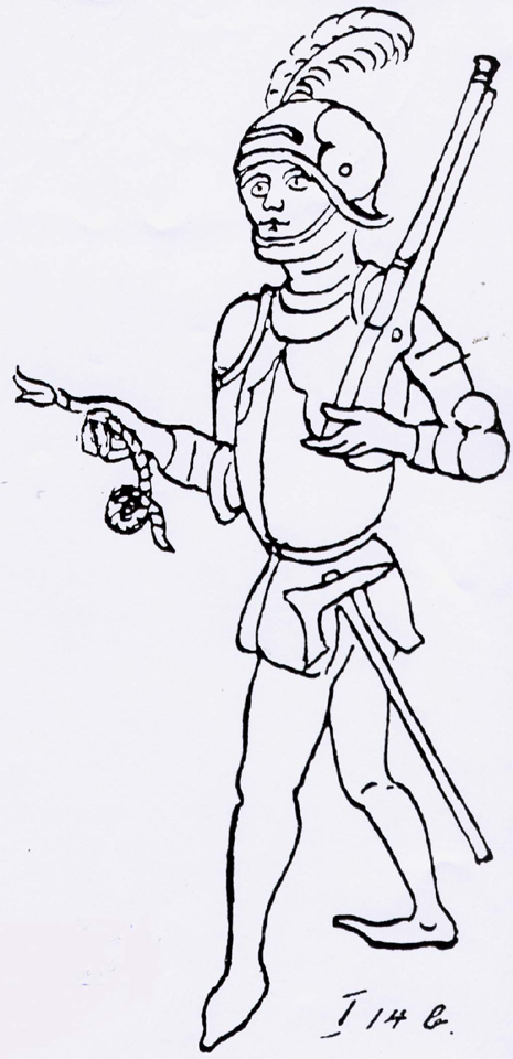

It should be noted that in the earliest times of 'matchlock' mechanisms, from ca. 1410 to ca. 1530, matchcord was way too thick to fit the jaws of the rather tiny early matchlock serpentines of the few surviving Late-Gothic and Early-Renaissance arquebuses. Thus it is depicted to be carried glowing by the arquebusier, either held in one hand or wound around the left arm, in pieces of period artwork from ca. 1480 (Diebold Schilling, The Berne Chronicle) to the 1540's (paintings and tapestries of the Battle of Pavia, 1525, and cardboard watercolors of the Tunis Campaign by Charles V and tapestries woven after these cardboards).
In those times, slow match was only used to ignite a small piece of tinder fixed in the jaws of the serpentine of the arquebus: thus, as the aforementioned instances of period artwork clearly depict, and as I have stated various times before, the actual ignition was achieved by glowing tinder and these earliest mechanisms should consequently be called tinderlocks instead of 'matchlocks'.

ATTACHMENTS, top to bottom:
- Walter de Milemete, Christ Church ms, 1326/7 (4 attachments)
- Walter de Milemete, Holkham ms, 1326 (1 att.)
- bundles of matchcord in the Churburg armory (2 atts.)
- bundles of matchcord in the Veste Coburg and close ups, of rather dense and hard consistency (6 atts.)

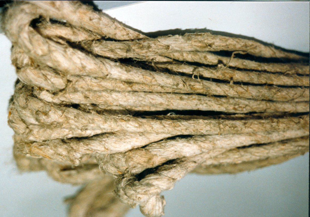

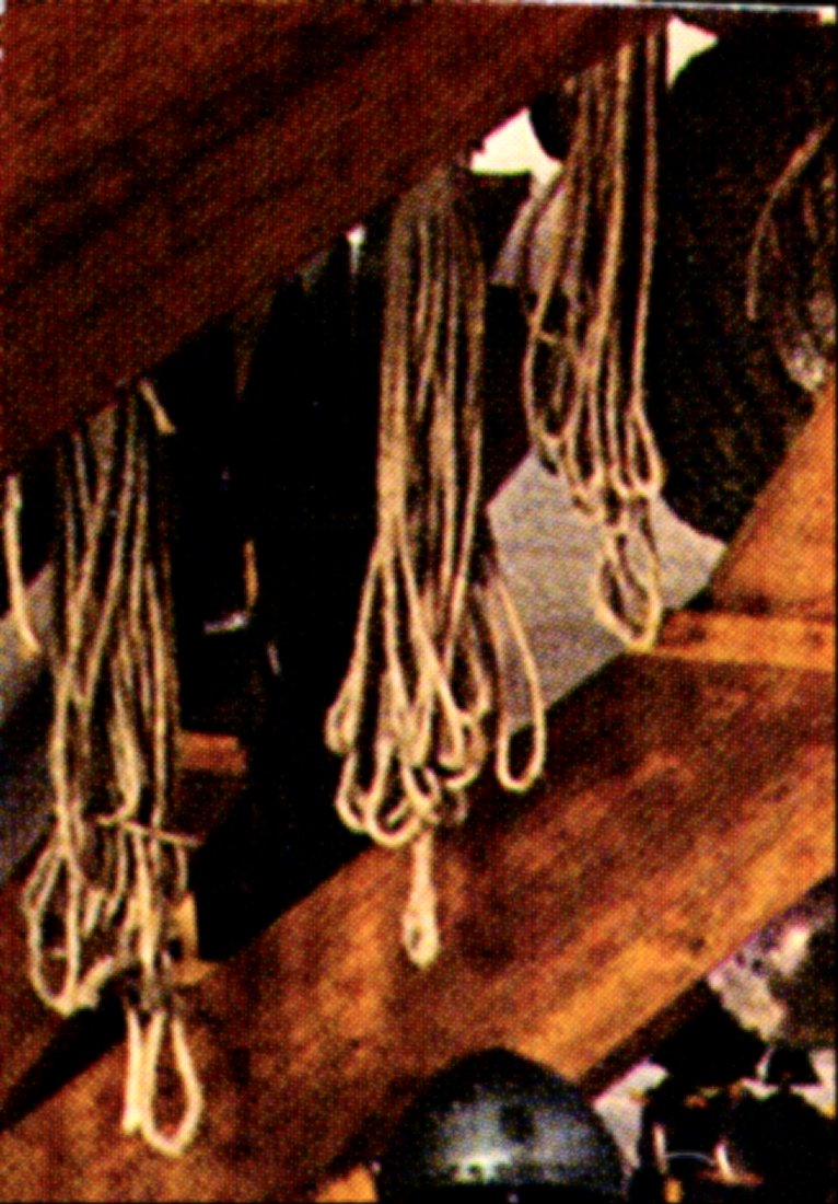

Top to bottom:
- close up of a bundle of matchcord in the Veste Coburg collecctions (1)

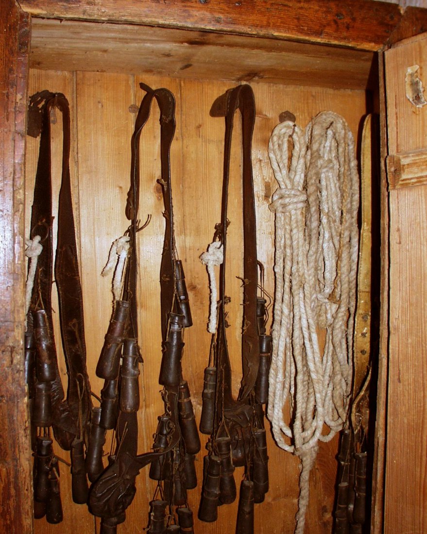

- bundles of matchcord, and early 17th c. musketeers's bandoliers from the Emden Armory, each with an extra length of matchcord; author's colln. (2)
- thick type of earliest matchcord carrried in the hand: Diebold Schilling, Berne Chronicle, 1483 (2)

- earliest known surviving, thick type of matchcord, of rather soft consistency, 15th/16th c.; from Schloss Fronsberg, Styria/Austria; author's colln. (1)

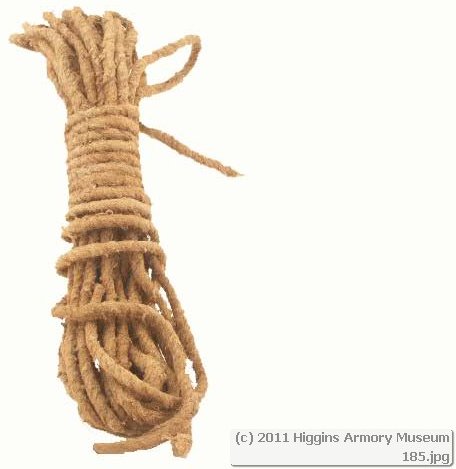

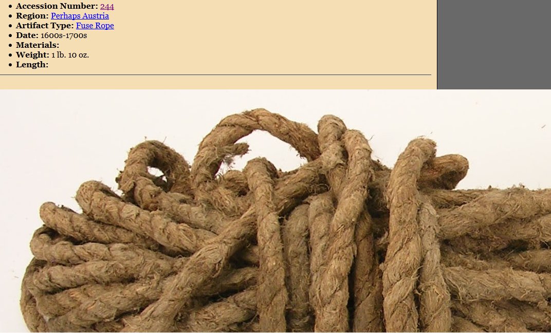

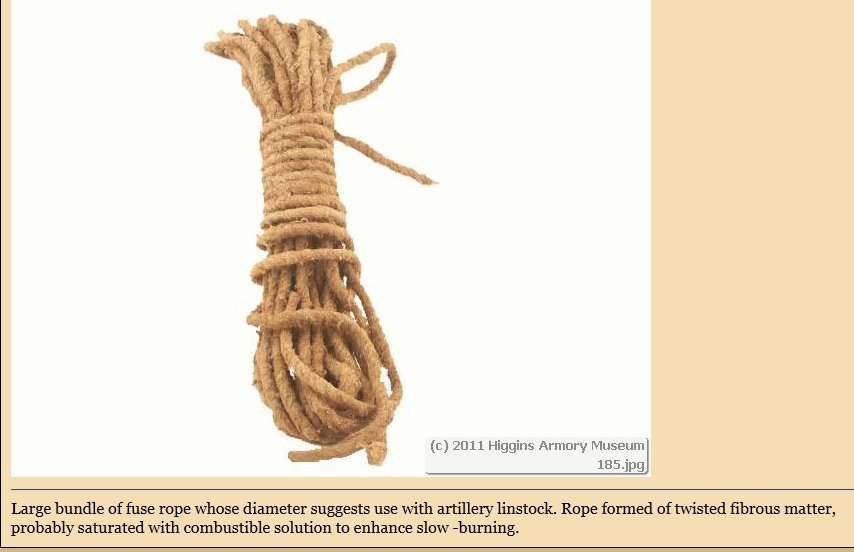

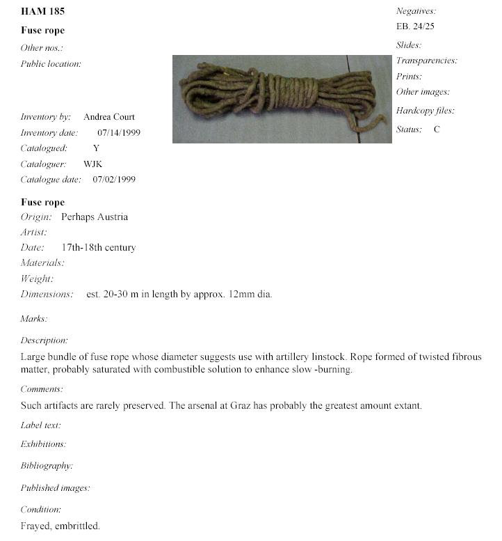

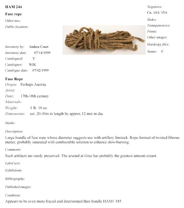

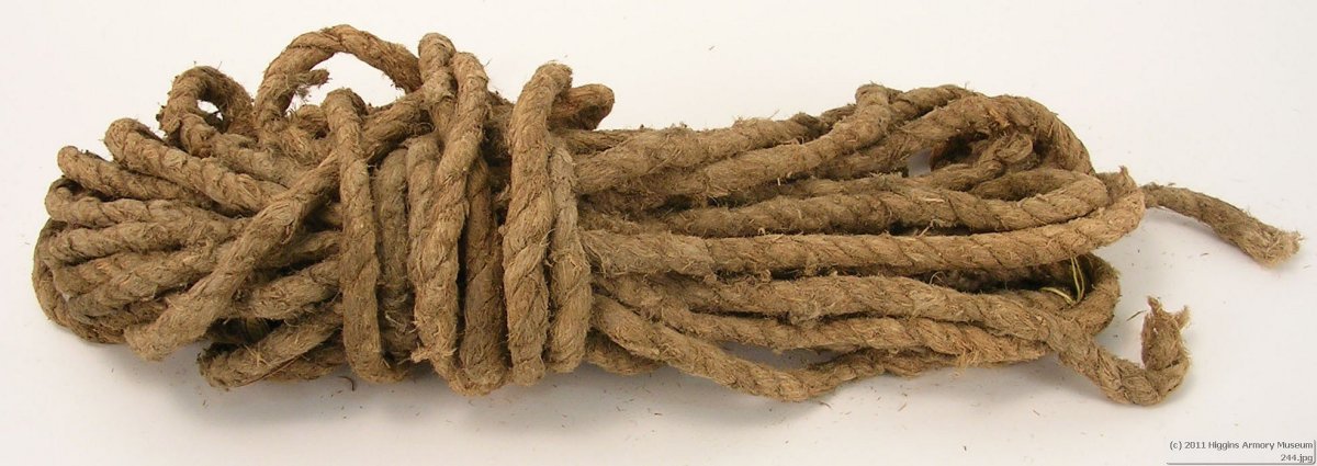

Default Several bundles of Austrian matchcord in the Higgins Armory Museum Worcester
They were acquired from the sale of the complete contents of the Schloss Hohenwerfen Armory near Salzburg/Austria at Anderson Galleries, New York, March 1 to 5, 1927:
The Great Historical Collection of Arms and Armour - the entire contents of the Armoury ... H.I.&R.H. Archduke Eugen, F.M., lots 201-206, 277-282, 705-710, 940-945, 957-962; two 'fuse-rope bundles' were included in each lot!
A copy of the original 1927 auction catalog is in the author's library.
The Higgins inventory gives an average length of 'ca. 20-30 m' per bundle, at an diameter of 'approxim. 12 mm' and a weight of '1 lb. 10 oz.'
It is also stated that their diameter of 12 mm 'suggests use with artillery linstock'. This statement has been contradicted above by the author.
It is all the less understandable considering the fact that the Higgins also acquired a number of matchlock muskets from that same sale; I would suggest putting a length of matchcord in their serpentines/match holders - I guarantee it will fit perfectly as soon as the wingnut has been adjusted!
The cover page of the 1927 sales catalog and a view of Hohenwerfen Castle are attached at bottom.

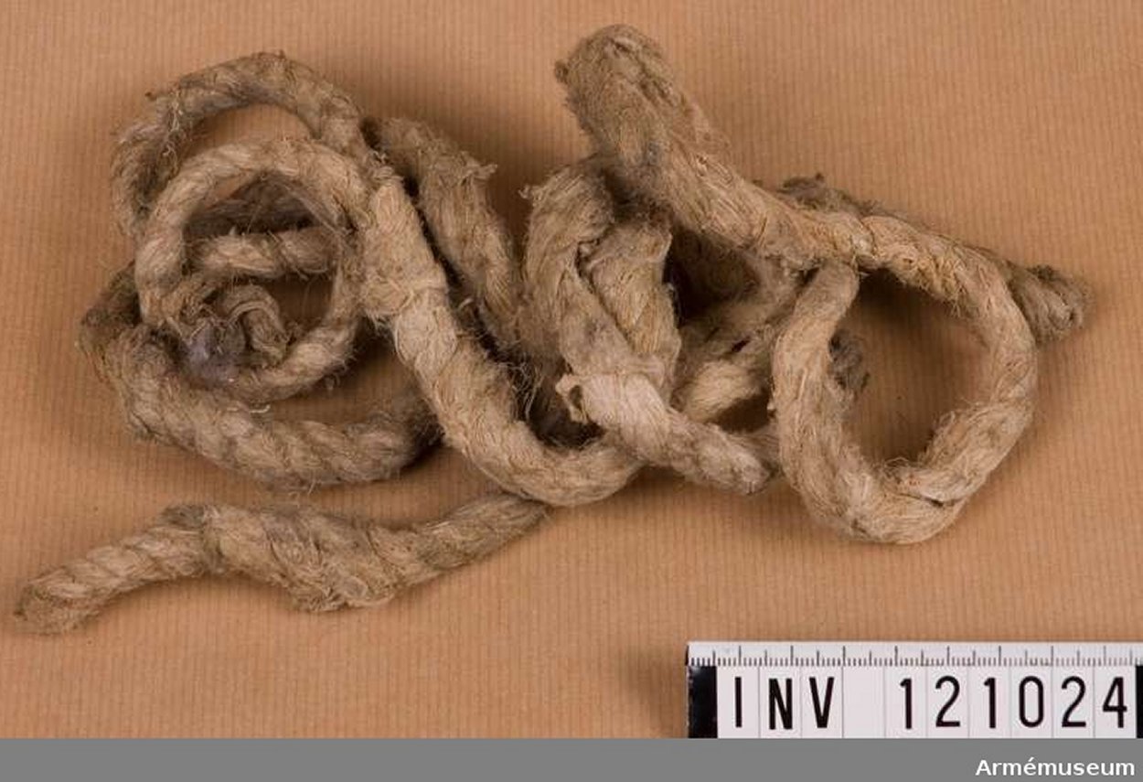

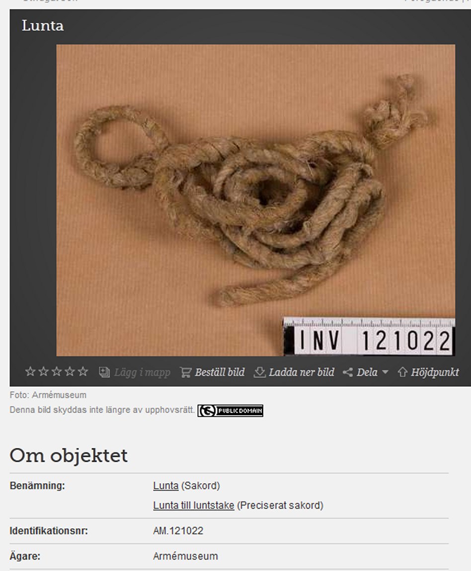

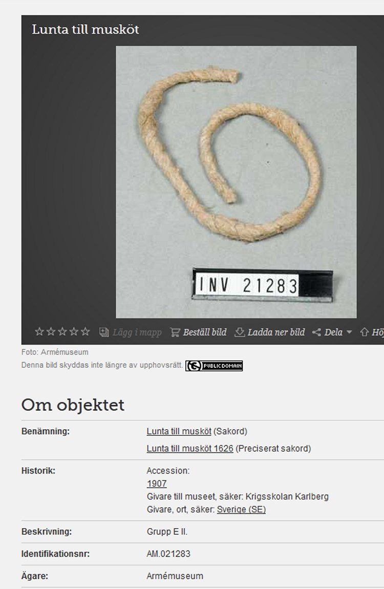

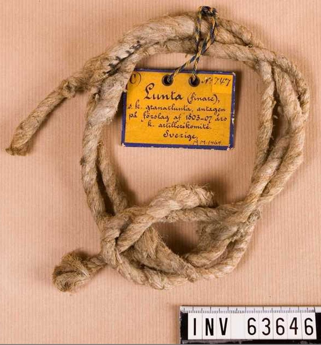

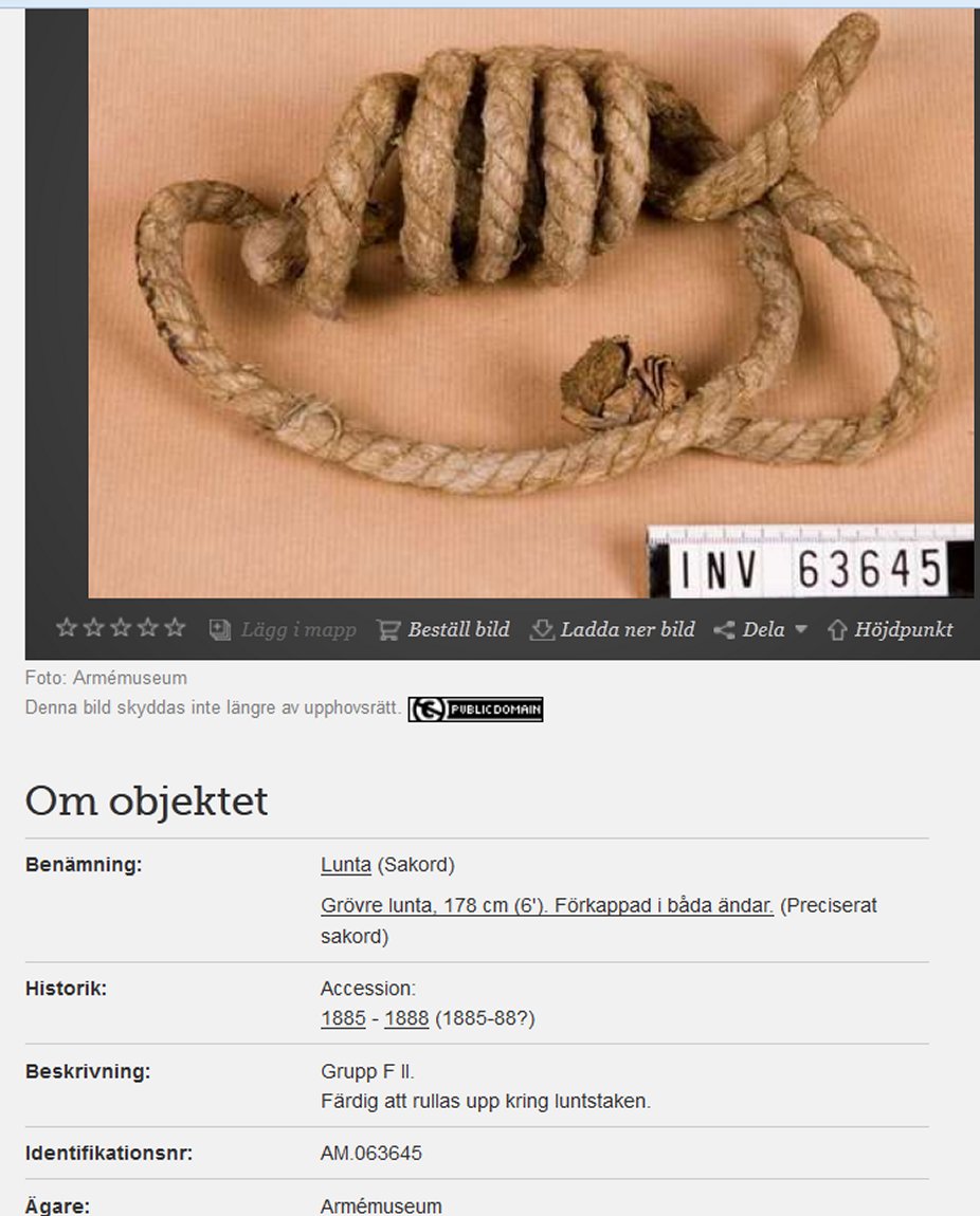

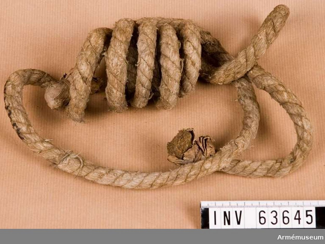

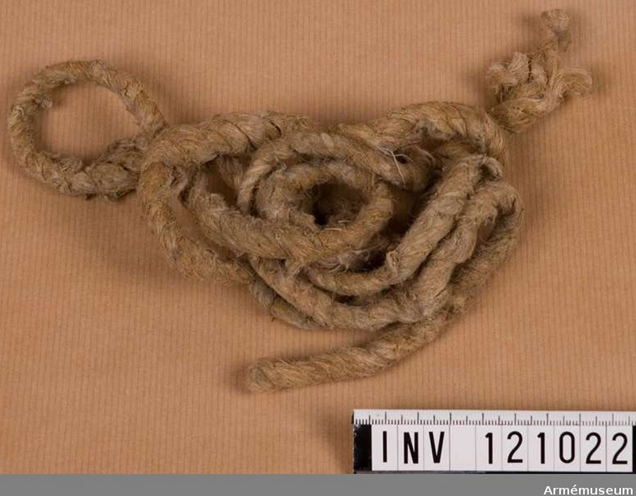

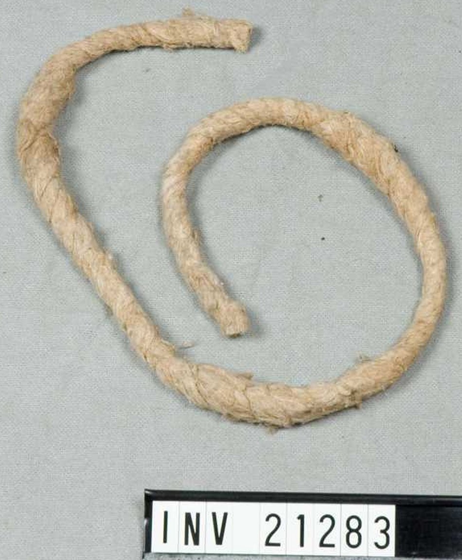

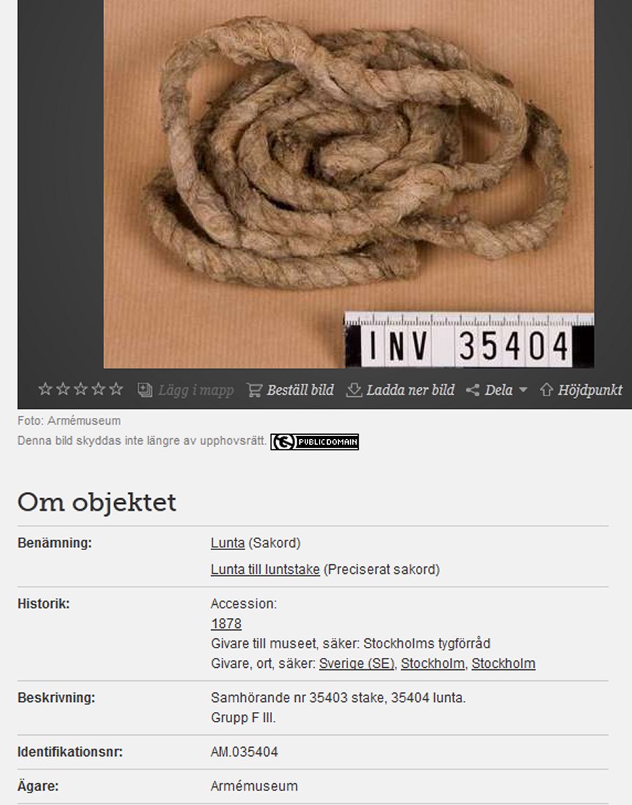

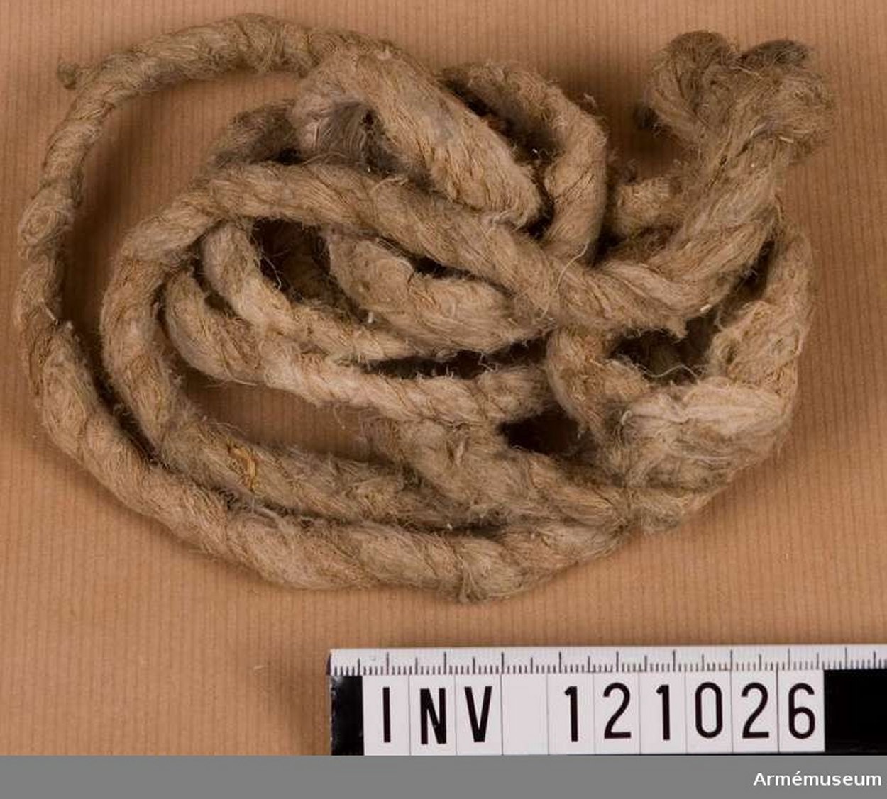

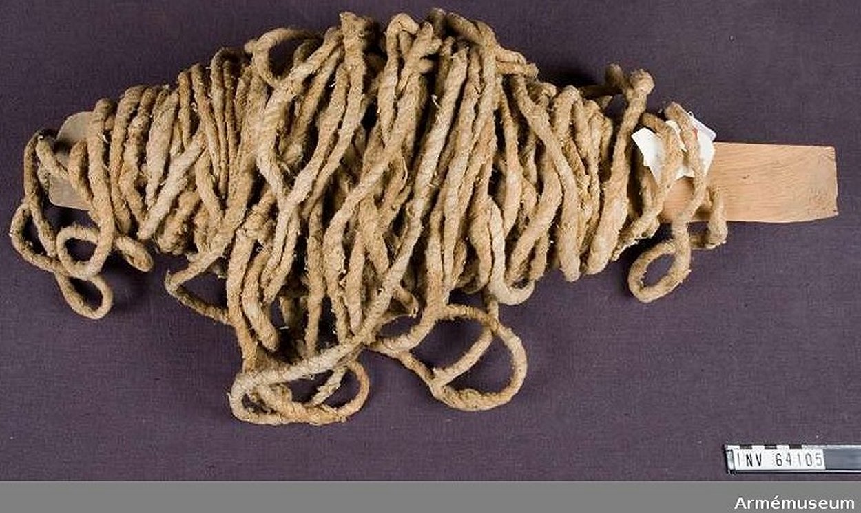

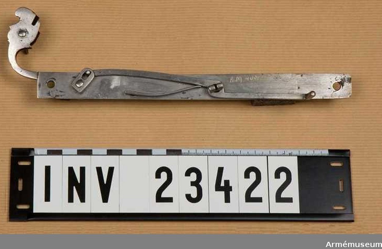

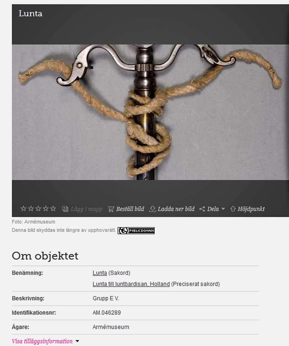

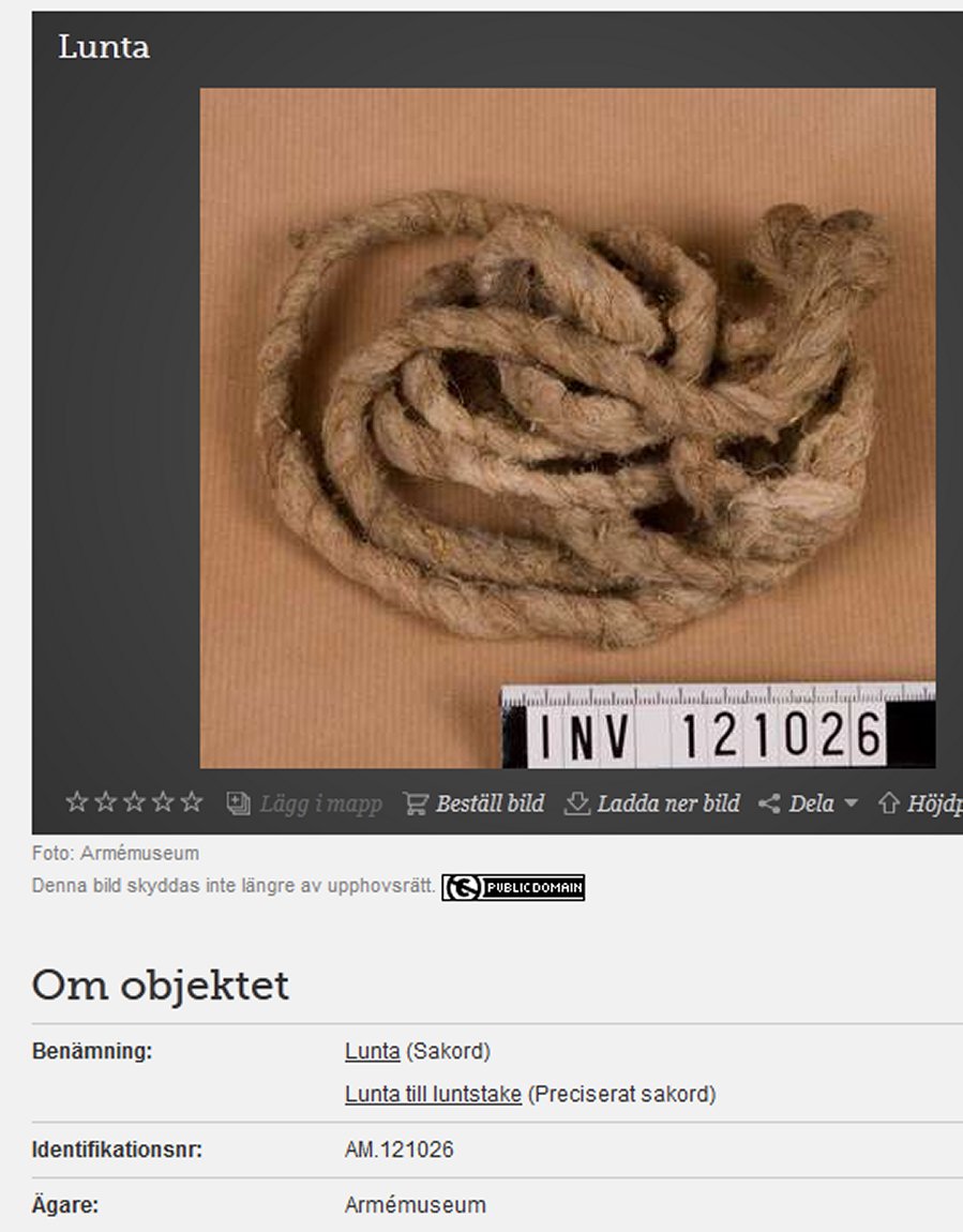

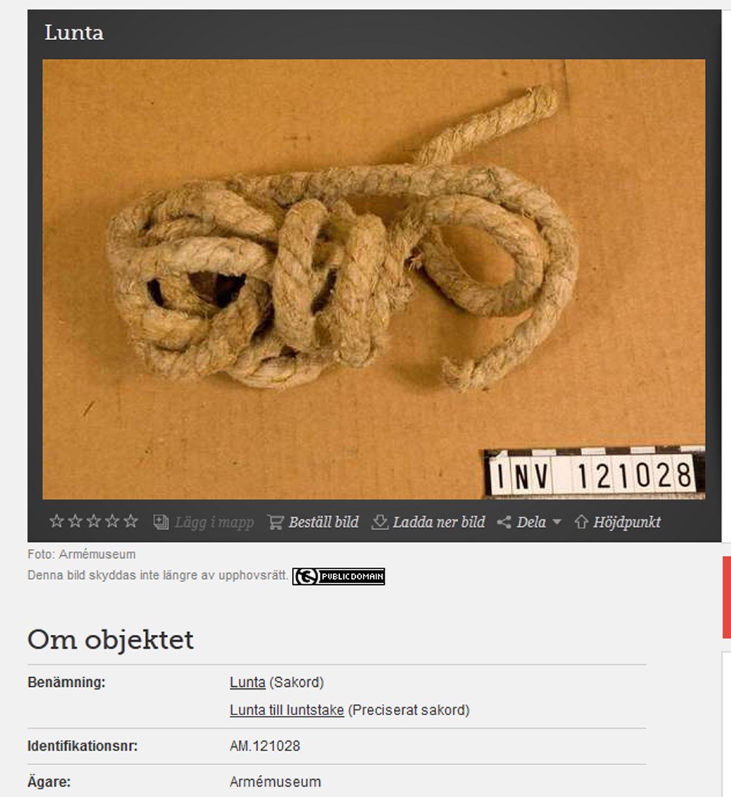

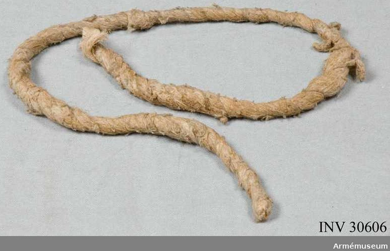

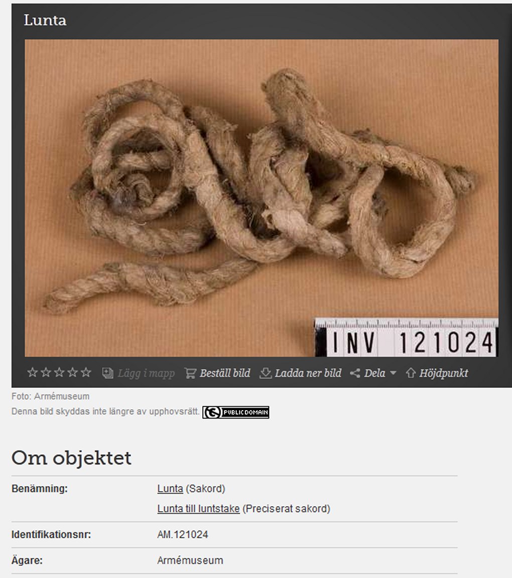

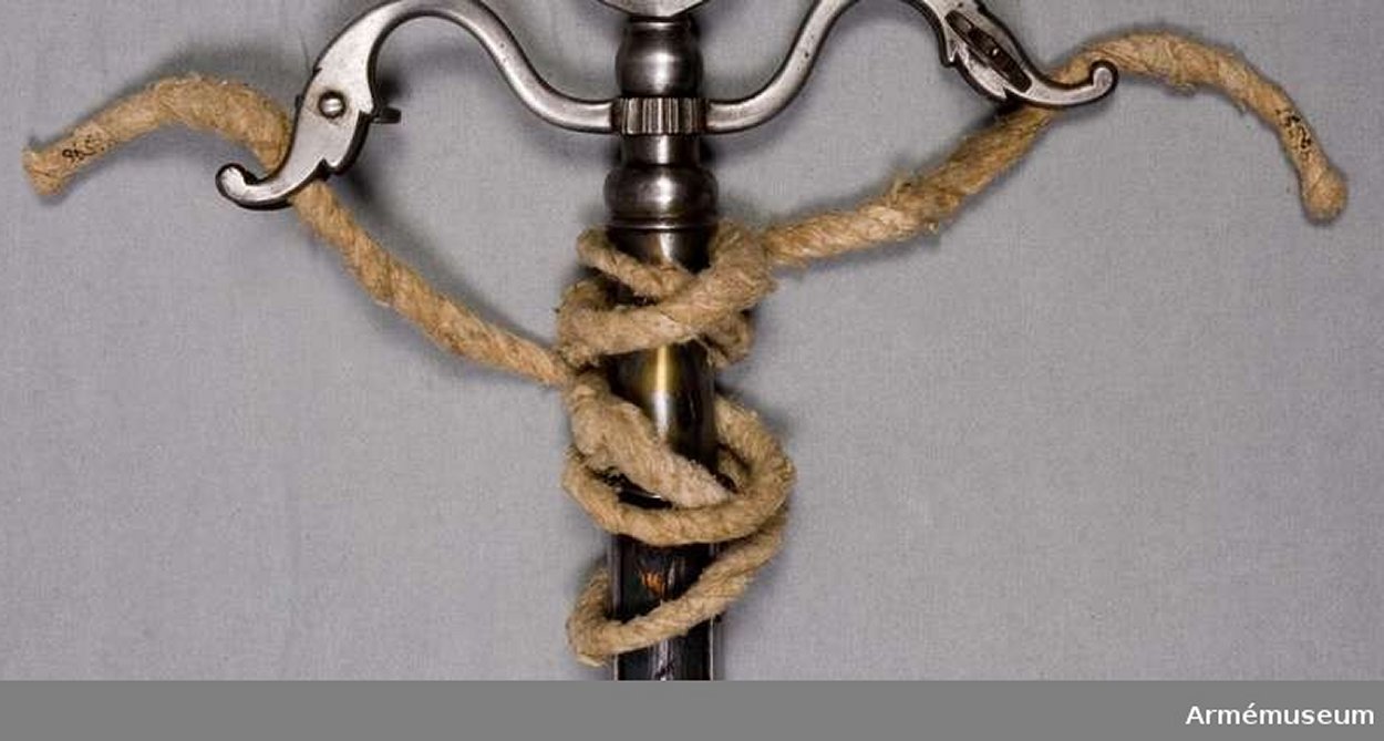

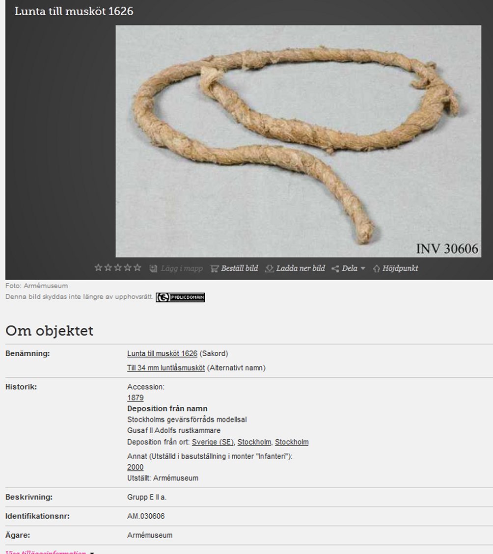

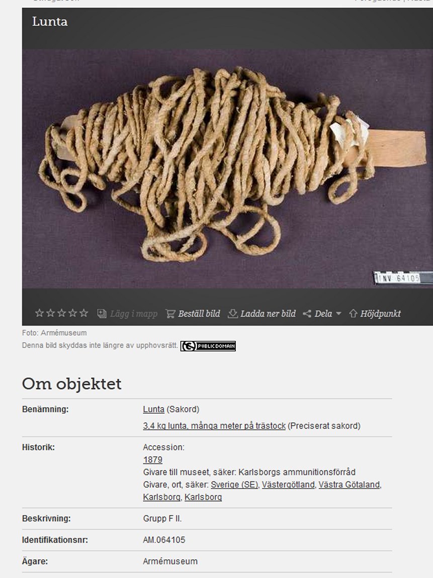

Default A Bundle and Lengths of 17th C. Matchcord, Armémuseum Stockholm
The bundle on top weighs 3.4 kg and might measure 10 m in length.
Simliar to the images I posted before, the close-ups allow to study the characteristic fibrous structure of match rope.

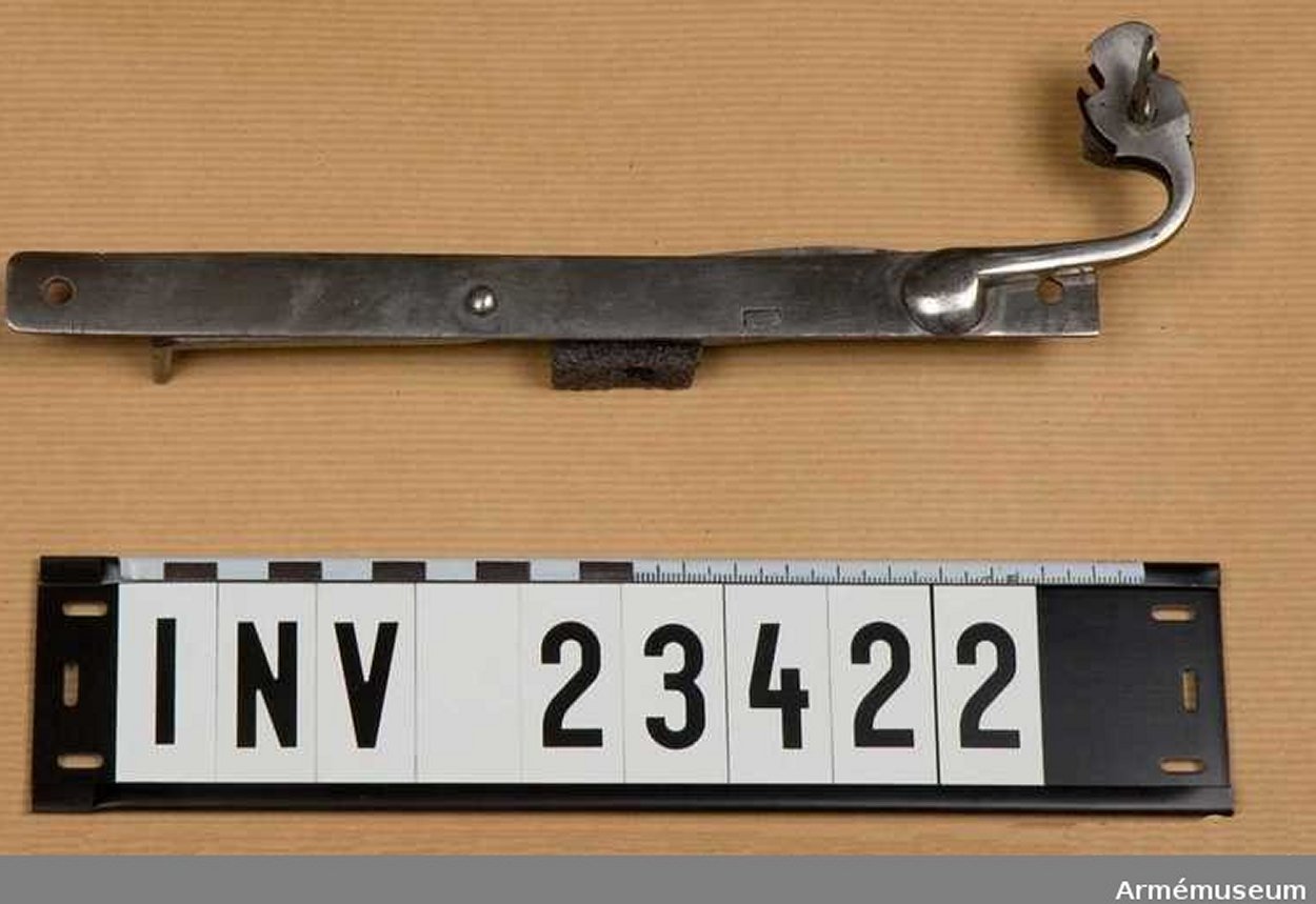

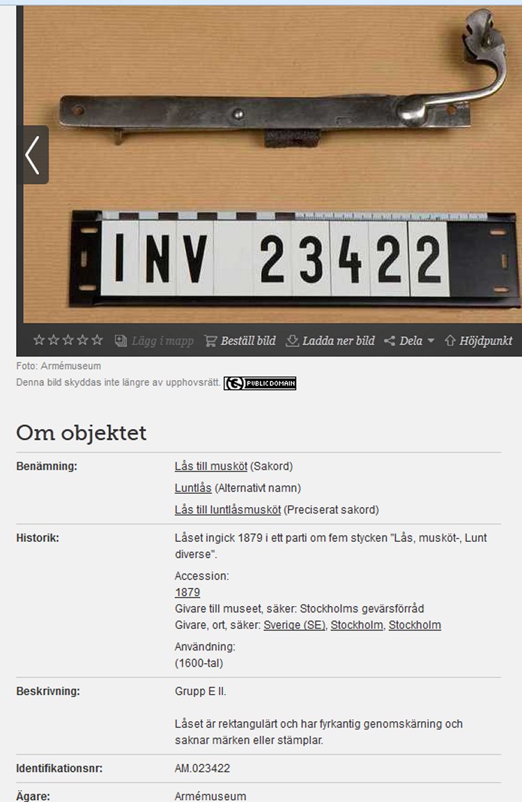

And a detached matchlock mechanism, Swedish, 1620's.

A few more.

And the matchlock mechanism für a Swedish military musket, 1620's.
