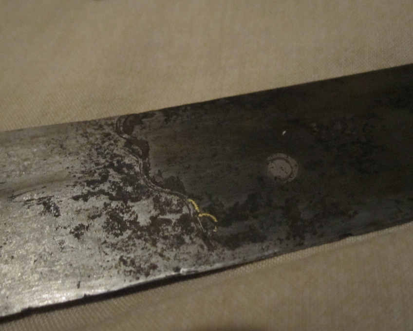

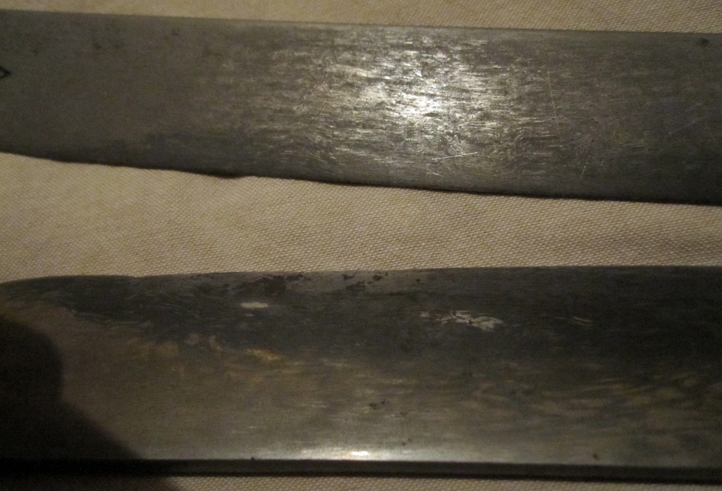

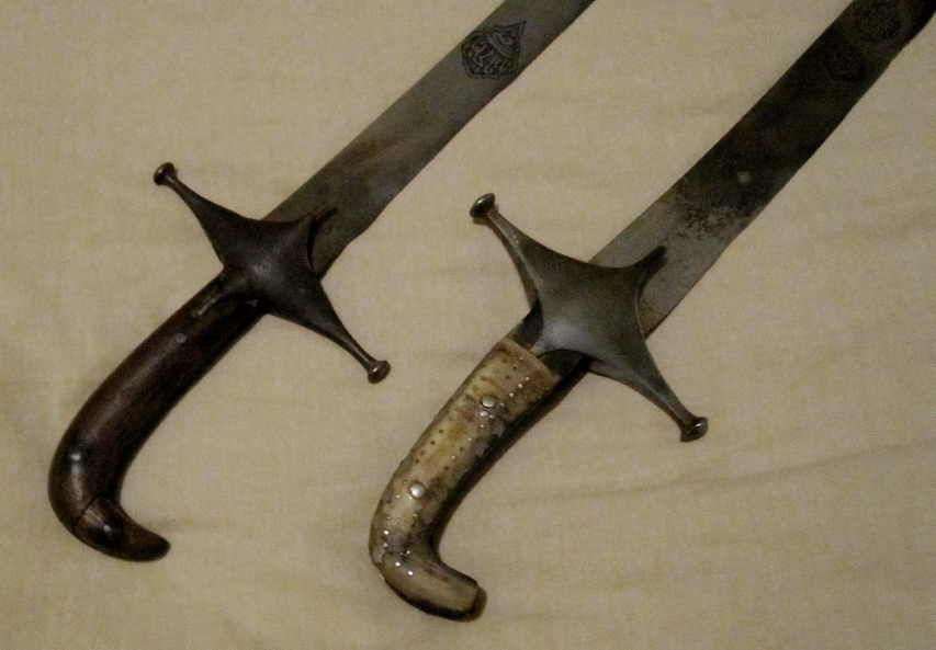

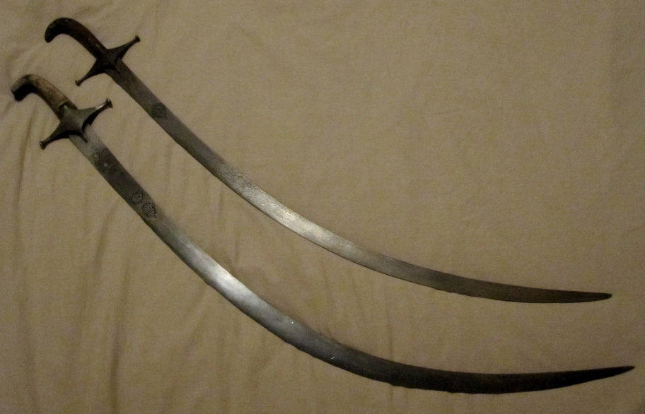

Hey all,

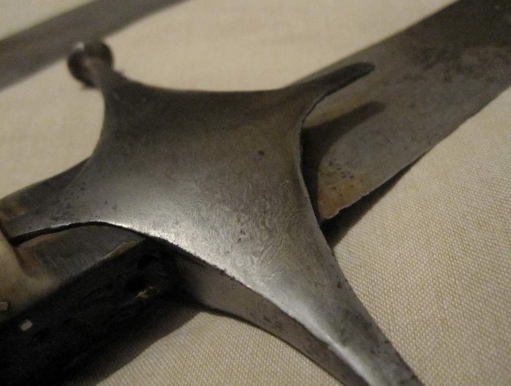

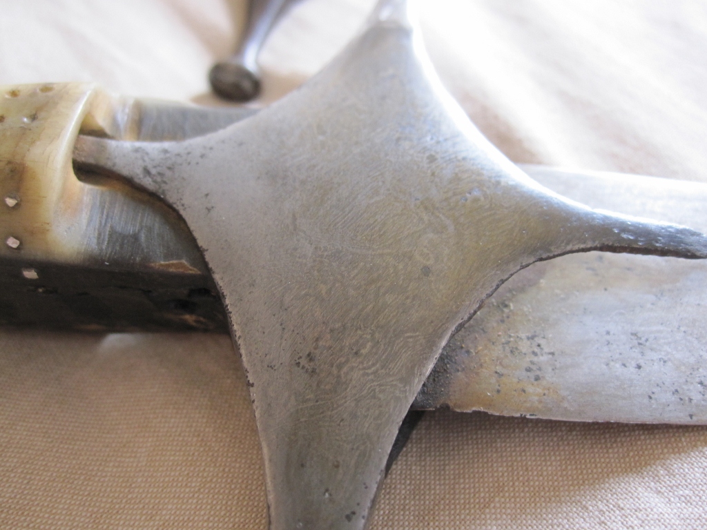

I got these today. Not exactly flashy and all but looks to be real wootz. Top one seems to be Sham wootz while the lower seems to be dark Persian wootz that could use some etching. The bottom one has a wootz crossguard and some strange weld almost like scarf weld but at the spine it looks as if its a discolouration rather then a weld, I'll leave it to more expert comments.
Both swords are Iraqi in use and decoration btw.
Old 9th October 2012, 11:46 PM   #2
Posts: 6,441
Looks like a scarf weld there, Lofty .
Usually this is a weld seen in a wootz to non-wootz blade .
I'm amazed at how clean the line is .
Also, in my totally inexpert opinion; both patterns look kinda loose; like Sham looks .
Pile on folks .

Hi Rick,
Scarf weld for sure.
I believe that the crucible steel manufacturing method often produced a smaller ingot, and the scarf weld process was used to add steel to lengthen the blade?
I've got a rather nice 18thC Tulwar with a heavy rigid Shamshir type blade where there is a similar scarf weld up towards the hilt.
In my admittedly modest experience of this construction technique the scarf weld is always is roughly the same place. I've seen it Wootz to non-wootz/monosteel and wootz to wootz, as it is in my Tulwar.
Lotfy,
These are very nice swords.
Congratulations my friend.
Best
Gene

Nice shamshirs, Lotfy

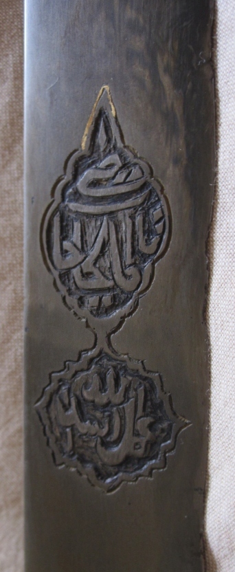

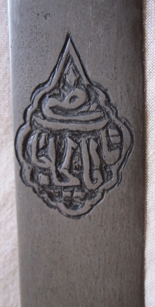

but I am not convinced this is scarf weld. It seems like decorative, gold-inlaid incision. Is it the same on other side?
Old 10th October 2012, 10:41 AM   #10
A.alnakkas
A.alnakkas's Avatar
Join Date: Nov 2010
Location: Kuwait
Posts: 1,340

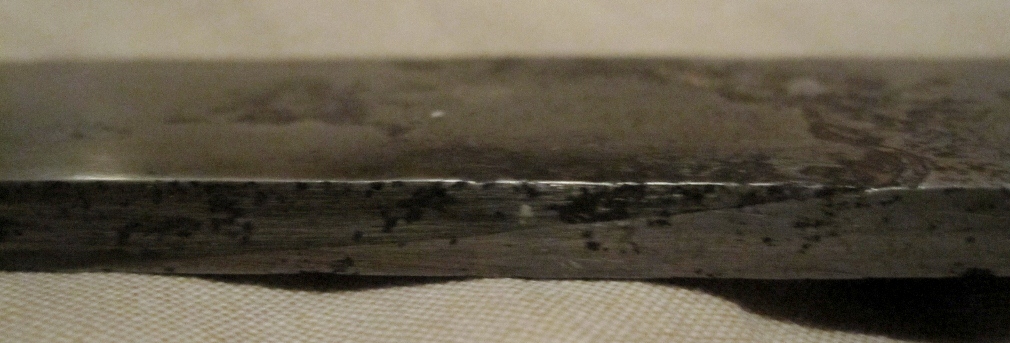

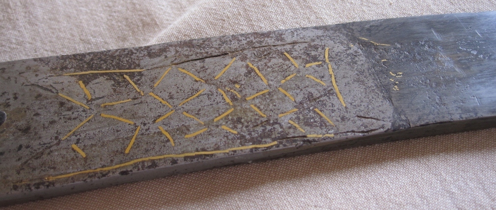

Nice observation mate! here are some photos:
Old 10th October 2012, 11:51 AM   #11
ALEX
ALEX's Avatar
Posts: 936
LOL
...but dont think its old Assad Allah work maybe put on it to give it 'prestige' :P
I agree on both points:-) Both cartuches seem later, and of similar technique. Could they be done recently by the same hand?
Old 10th October 2012, 11:54 AM   #12
A.alnakkas
A.alnakkas's Avatar
Join Date: Nov 2010
Location: Kuwait
Posts: 1,340
Yep, thats very possible. They came from the same source anyways. Though I think these were done in the last 50 years maybe, maybe more cant be sure though one used to have gold inlay.

Appears to be a lap weld to me (some call it a scarf).
I have one tulwar here I got from Gavin that has a rivet and a lap weld....I liken it to both a belt AND suspenders.
On a single blade I have seen from one to three such welds . Always in wootz to wootz...I have yet to hold one that was wootz to something else (though I have heard they exist). I have seen many many with welded tangs just not all that far from the hilt.
Keep in mind I rarely get out and about.
As an aside...I had a destructive bend test done on such a tulwar blade at a laboratory..it withstood as much deflection and pressure prior to breaking as the next four inches of the blade which had no weld. So, if the weld is sound, there is no loss of strength.
As to why they are done...could be
small ingots being used or
small end cuts of larger ingots or
repairing a broken blade or
I have not ever seen contemporary documentation on the subject...which may mean it was not important enough to note.
