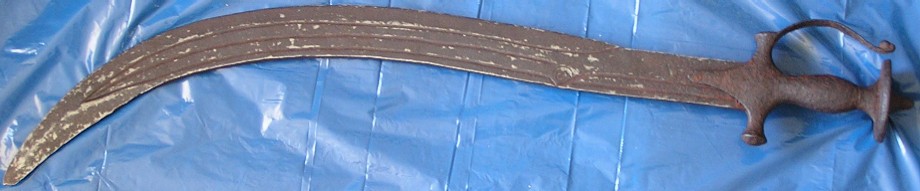

I've got this tulwar, which my father bought on a trip to nepal.
The seller claimed this piece is very old.

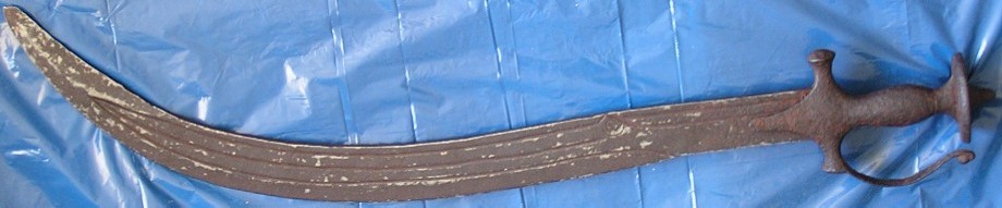

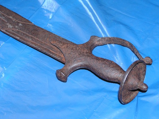

The blade has a straight totally unsharpened segment followed by a deeply curving blade (which has an edge that has gotten dull over the years) . it has markings on both sides, a moon on one, and a sun on the other. it was fully covered with rust, and that's how it looks after some cleaning.
It's surprisingly well balanced, the unsharpened part fits well for gripping the blade with the left hand.
I have searched the internet and haven't found anything that looks like this sword, can anyone identify it? help me date it or determine it's authenticity?
thanks
Yaniv

Could be a Tegha indeed .
Most unusual fullering on the blade, and I haven't seen such a wide/long forte in a Tegha before .
Also, a very strangely angled spine .
Could we have some dimensions please ?

Most unusual fullering, the tegha suggestions as far as we got. What about this fullering, the sun and moon symbols curiously placed at strategic location on blade.

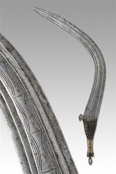

Robert, what an excellent suggestion, and the curvature as well as the scribed profiled lines as 'fullering' does resemble certain Congo 'sickle' type weapons such as the nsakara. There does seem to be a certain merit to this suggestion as it has been well established that there was considerable emigration from India into Africa. It seems there were generations of workers there in Kenya and certainly other regions. Perhaps an African blade might have been mounted on a tulwar hilt.

* attached Congo nsakara, I think this was Luc's

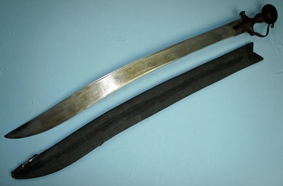

one thing not mentioned, is it sharp on both edges - full length inside the curve as well as outside or partial on one or the other? the tulwar guard placement is correct for an edge on the outside of the curve rather than for use as a sickle type weapon. as the initial photo was ''upside down'' it may have looked more sickle-ish, here it is ''rightside up''

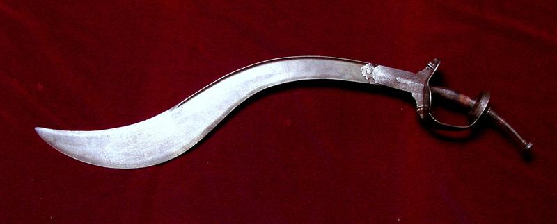

As we know, things can get preety crazy out there:
