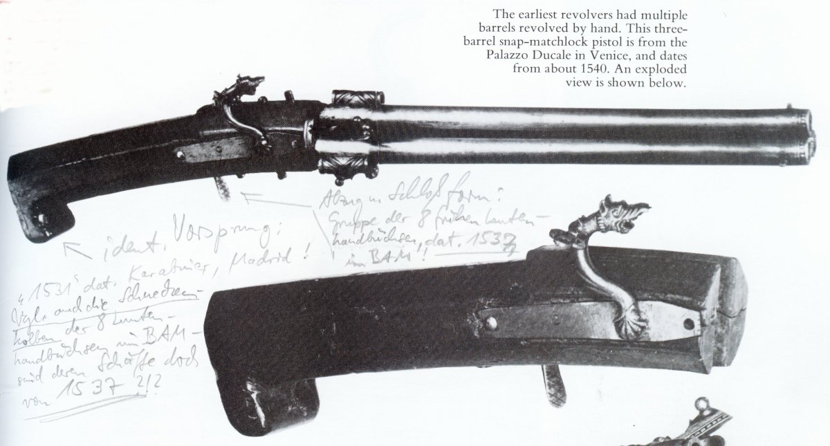

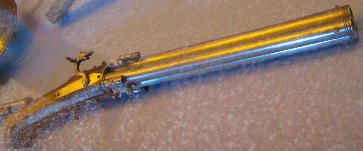

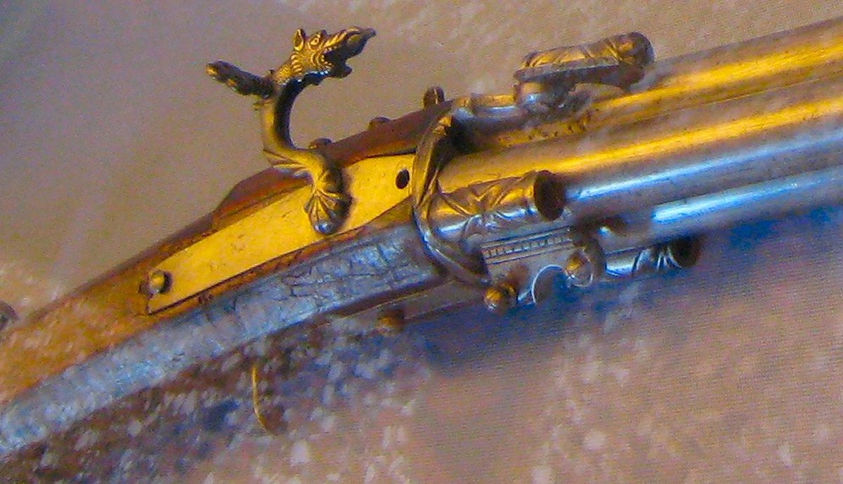

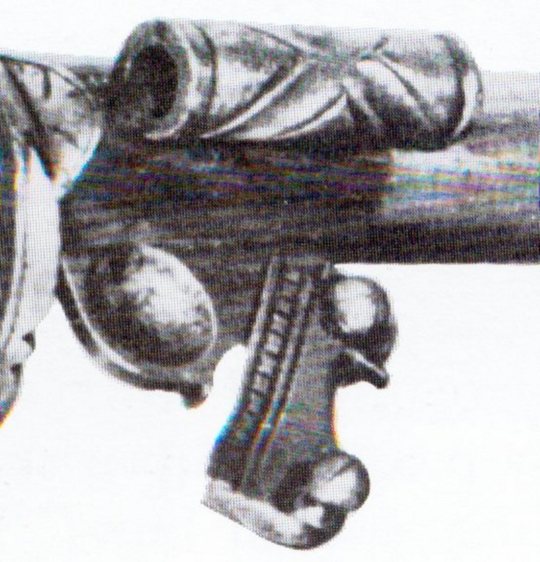

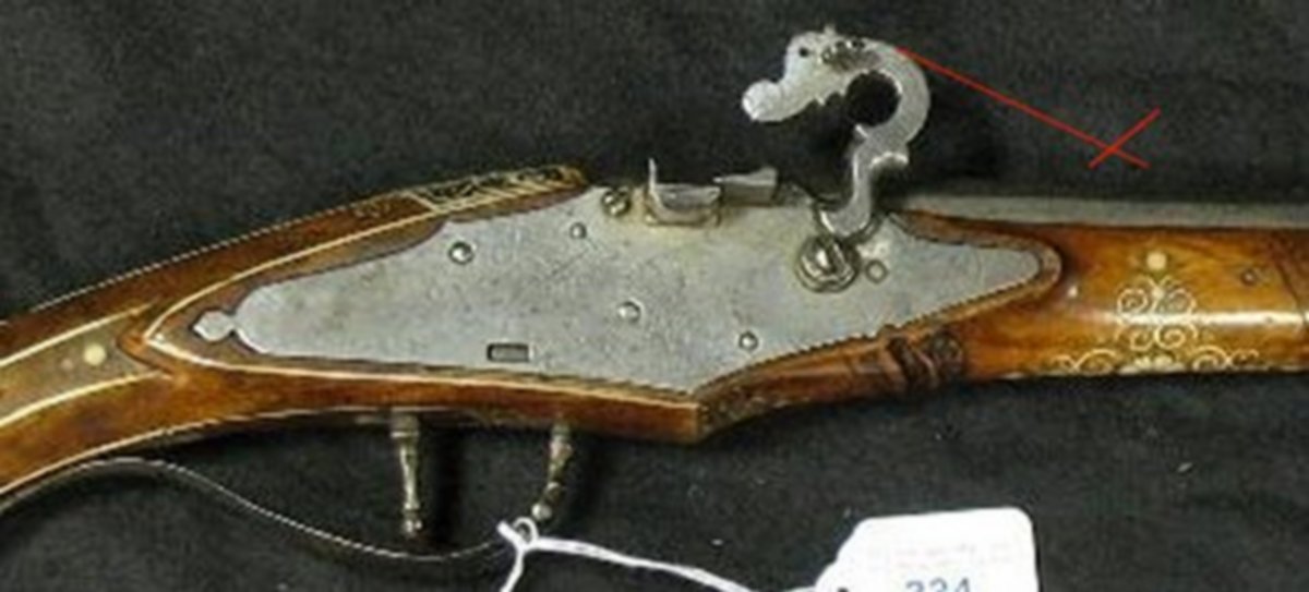

Hi Rick,
This a basic question often asked.
First of all we should define a matchlock pistol, strictly confining it to a small and single-handed firearm that was actually ignited by an attached matchlock mechanism. Just any short 'handgonne' without a matchlock mechanism which had to be ignited externally by either a hand-held length of matchcord, an igniting iron or a linstock is NOT a matchlock.

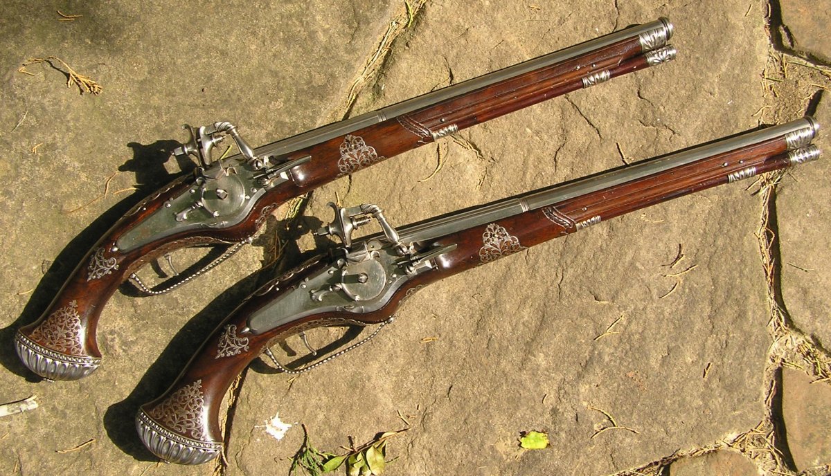

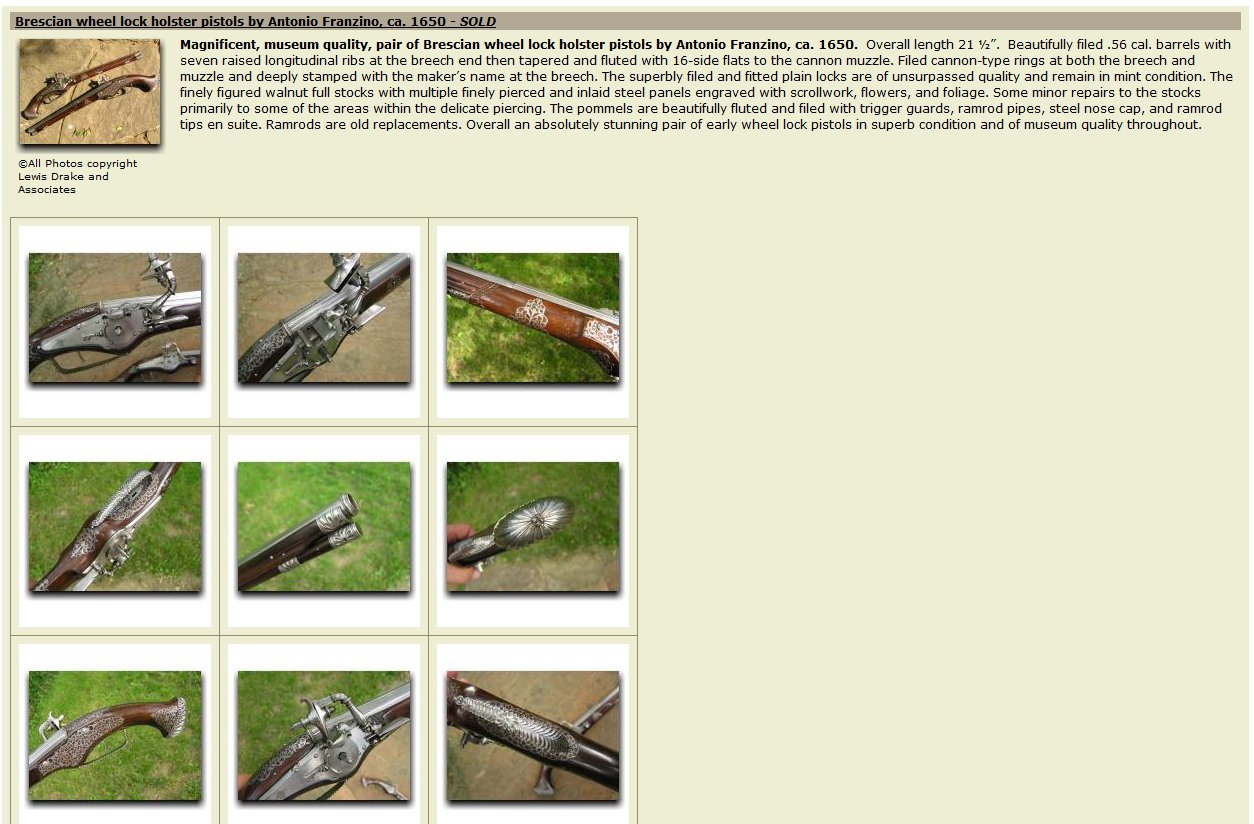

There are many 'reproductions' around, all claiming to be made 'after an original' but none of these 'originals' has actually ever been presented.
Original European period artwork does not give one single evidence of any firearm employing a matchlock mechanism and light and short enough to be meant for single-handed use.
On the other hand we cannot exclude categorically that they existed, however useless as they must have been; remember, pistols in the 16th c. were only used on horseback and all pieces, both actually surviving and such depicted in period works or art, are mounted with a wheellock which in those days was called the self-igniting lock, in contrast to the matchlock.
It is also true that in Japan and other Far Eastern countries matchlock pistols seem to have been in use since the 16th c., and they all are based on (and were made in the same, almost unaltered style for centuries as) samples imported from Central Europe.

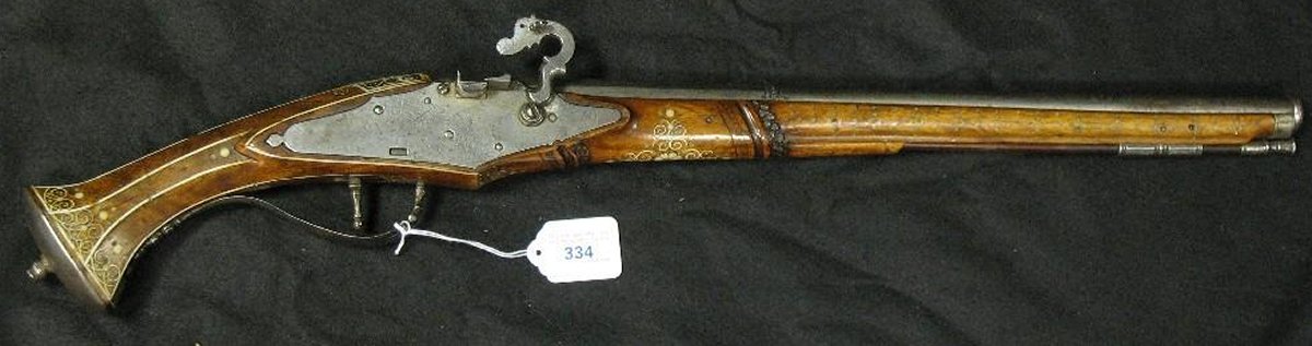

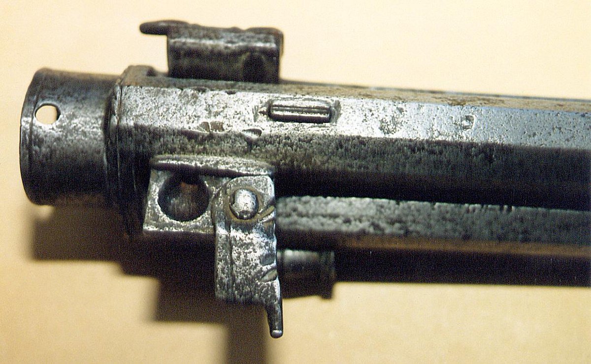

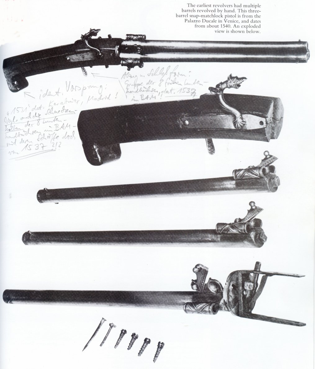

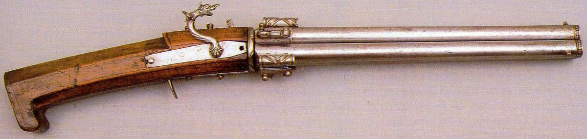

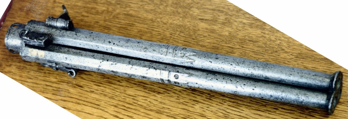

Only one single and completely original 16th c. matchlock pistol is known to have survived but it is clearly an exemptive 'high-tech' weapon: with three manually turned barrels, which actually makes it a matchlock revolver. Each barrel is fitted with its own pan and pivoting cover, plus rear sight with an additional tube and bead foresight; no provision for a trigger guard.
It is made in clearly North Italian (Brescian?) style, ca. 1530's, and preserved in the Doges Palace Venice, inv.no. B 83: 53 cm long overall, the barels 29.9 cm, bore, 10 mm, weight 1490 grams (attachments).
In the reserve collection of the Ashmolean Museum Oxford, I detected and photographed a detached bundle of three barrels, obviously from the same type of firearm but with an additional muzzle ring including a ramrod recess; on two of the barrels the faint rest of an unidentified maker's mark can be seen, and two of the sighting tubes are missing (attachments below).
That's it for European matchlock pistols. Worldwide.
For more information, please see my new thread:
http://www.vikingsword.com/vb/showth...170#post141170

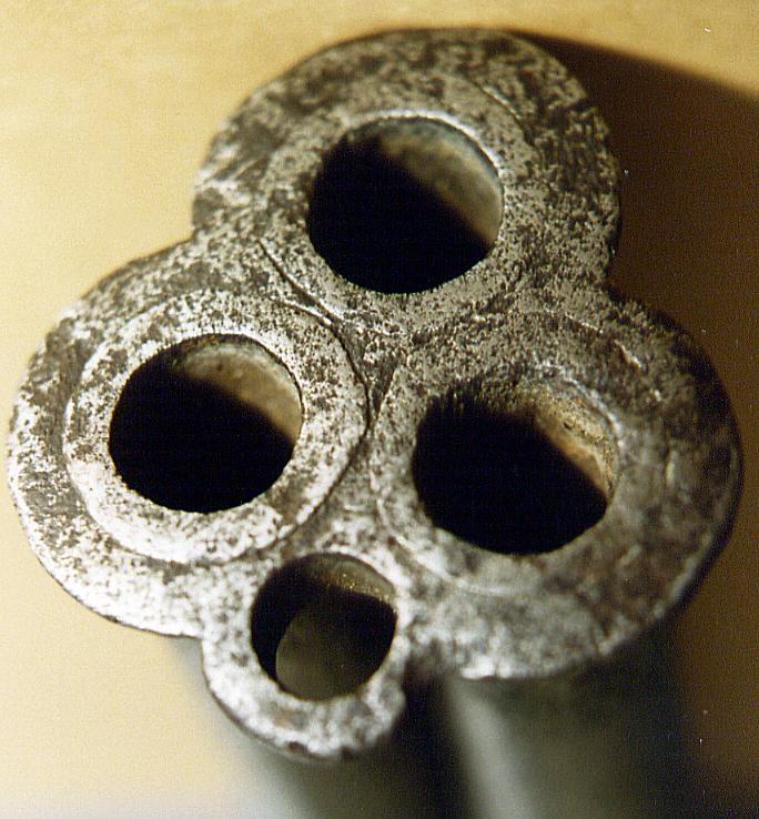

For more on multi-barreled 16th c. matchlocks see:
http://www.vikingsword.com/vb/showthread.php?t=12712

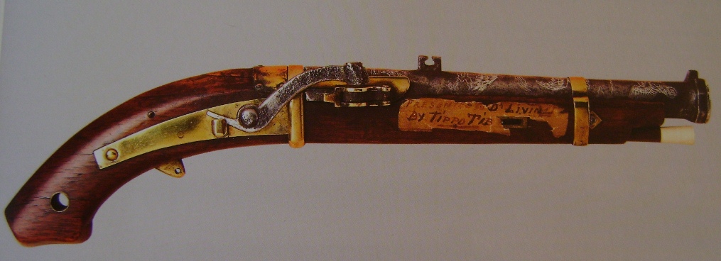

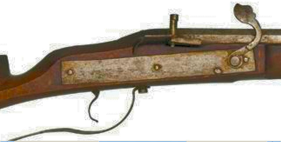

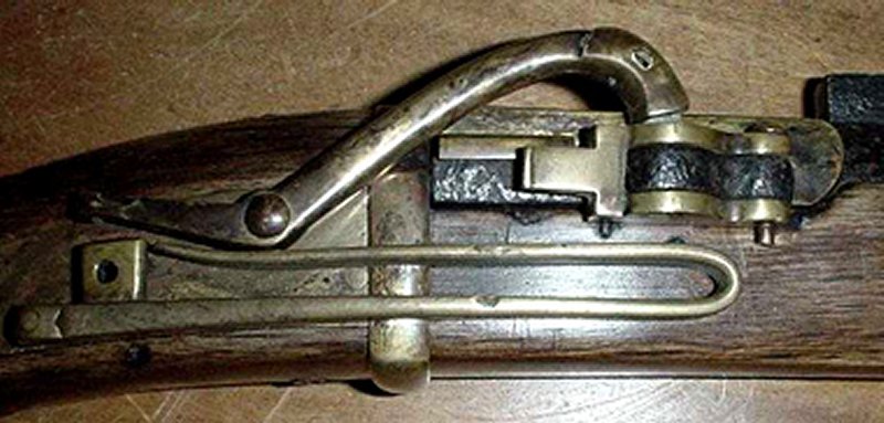

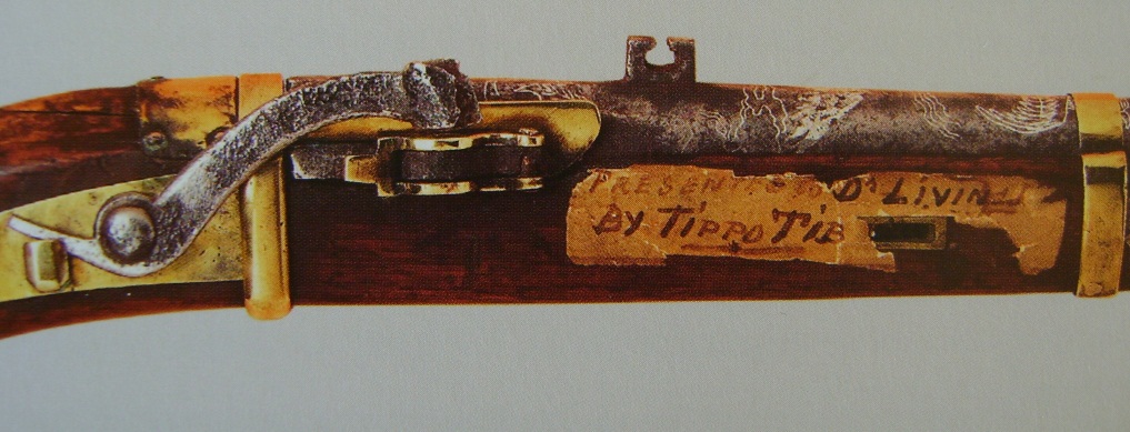

Originally Posted by rickystl
... I know there are examples of Japanese pistols (which I believe were more of a status symbol in most cases) ...
... Like this example offered to the famous Scottish medical missionary David Livingstone by Tippo Tib, a known slave trader of Arab origin, who would have met the famous African explorer, in one of his visits to a slave market in the mid XIX century, as referred in Livingston memories.
The barrel has silver decorations of fruits, mountains and two birds of prey fighting.
The lock has an internal spring rolled spiral wise, one of the Niponic variations of main spring.
(From the book AS ARMAS e OS BARÕES de Eduardo Nobre)

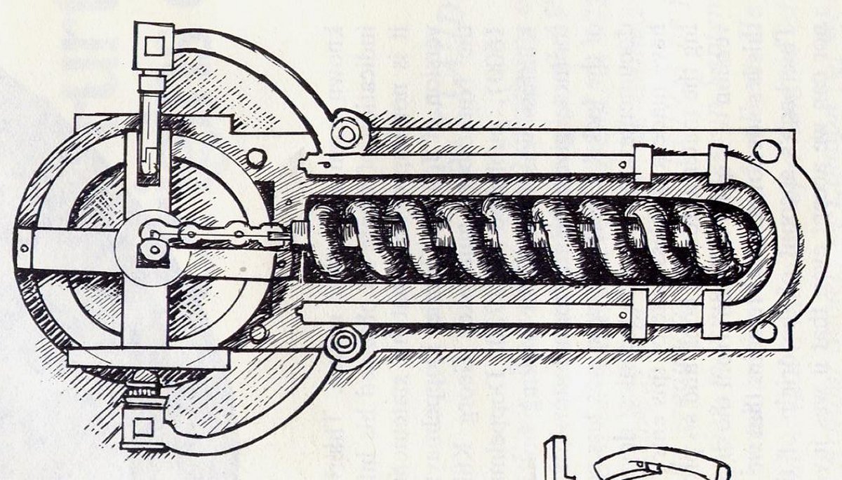

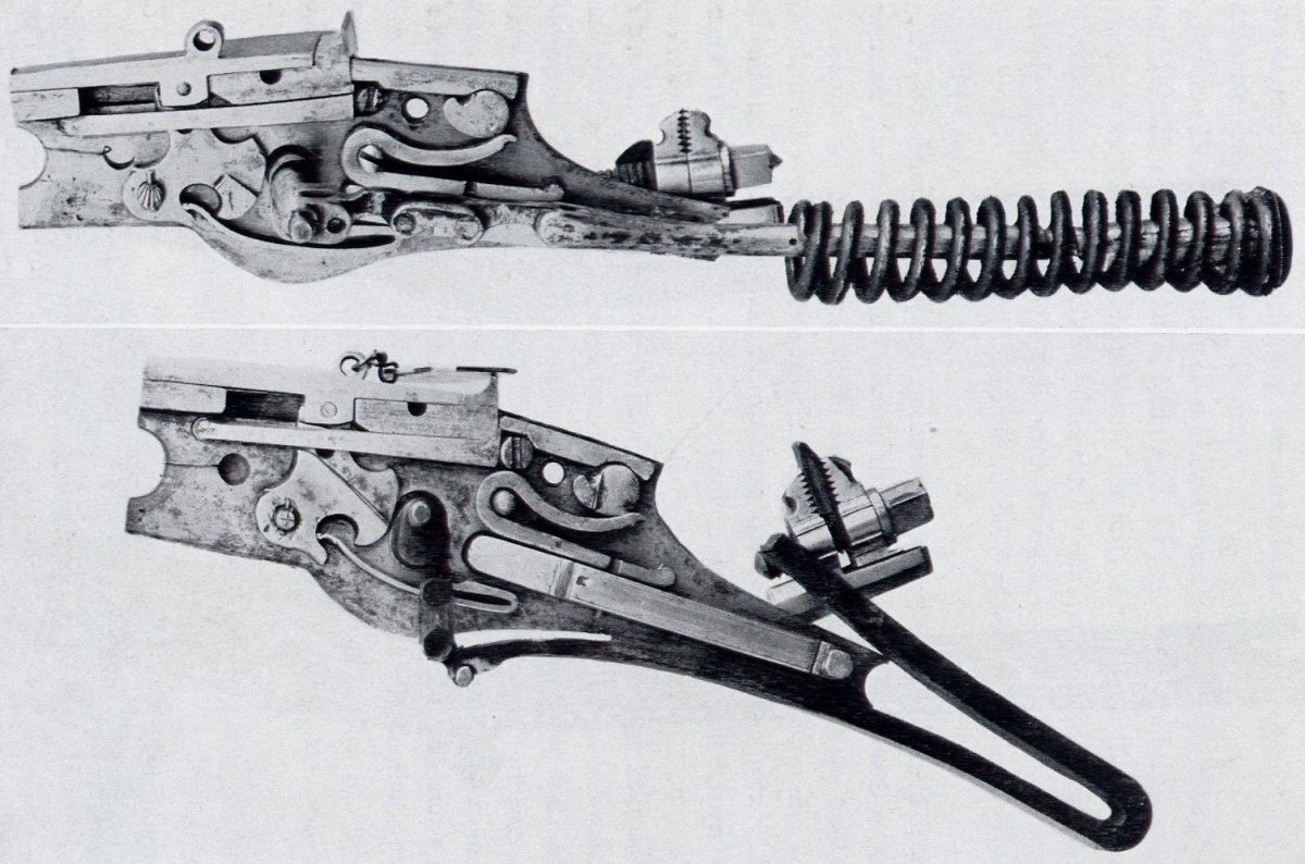

This spirally rolled up spring used in some Japanese matchlocks is not recorded from any surviving 16th c. European, esp. German sample. On the other hand, it just seems a more refined evolution of the rolled up cord for spanning a wheellock, in a sketch by Leonardo da Vinci, ca. 1500-10 (first attachment).
Spiral springs of different device are known from one or two ca. 1550 wheellock arquebuses in the Real Armería. Madrid, though; they seem to be based on another drawing by da Vinci (second and third attachment).

Sorry Michl, i am a bit lost with your comments .
Do you mean to say that this XIX century pistol doesn't have a spiral (helicoidal) main spring ?.
Note this is not my idea; i am just translating the book text. This pistol surely belong(ed) to the author's collection; he must have examined its interior.
... Or am i misunderstanding you ?
Old 22nd June 2012, 09:19 PM   #6
Matchlock
Matchlock's Avatar
Join Date: Sep 2008
Posts: 4,310
No problem, 'Nando,
I should have been more precise:
As far as I know some Japanese matchlocks are fitted with spiral springs and others with conventional leaf springs.
I did not know which sort of spring the one illustrated by you featured.
Now that I saw the description I know.
Michl

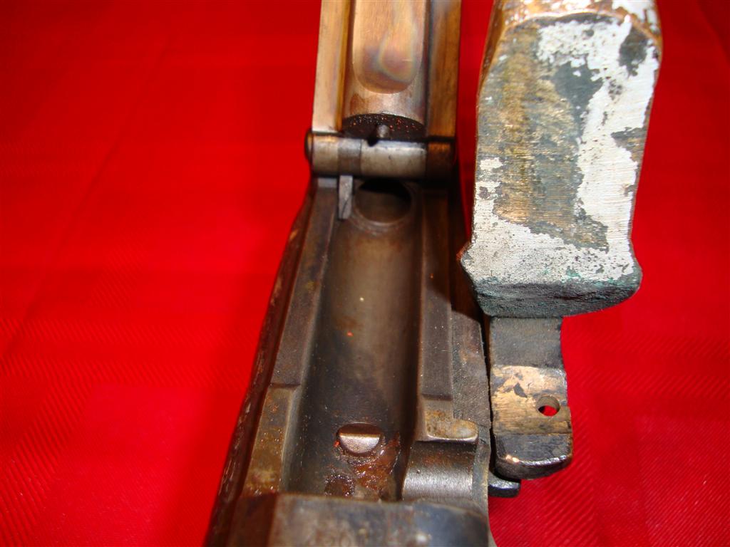

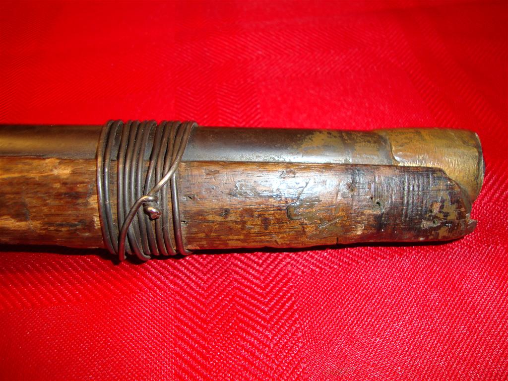

Fernando: Thanks for the photo. What I found most interesting when I dis-assembled my original Japanese matchlock long gun was that the entire gun was assembled with pins. Not a single screw on the gun. It was actually a clever way to assemble. The pins that held the barrel to the stock were bamboo!!
Another question for Michael: Most European mathlocks I've seen have the serpentine pointing towards the shooter. But some have the serpentine pointing forward toward the muzzle (like Japanese guns). In your opinion, is the forward pointing serpentine a later design change? Or just a different design? The question arouse in trying to determine when the forward serpentine started to evolve. Thanks for any help. Rick.

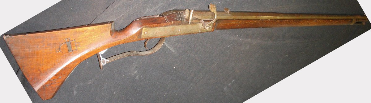

Hi Rick,
I am glad you found my contribution helpful, thanks.

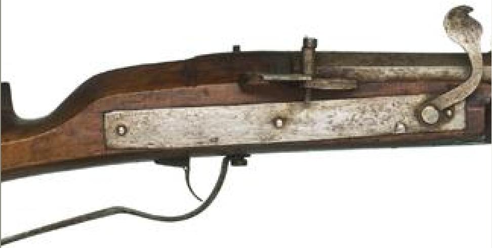

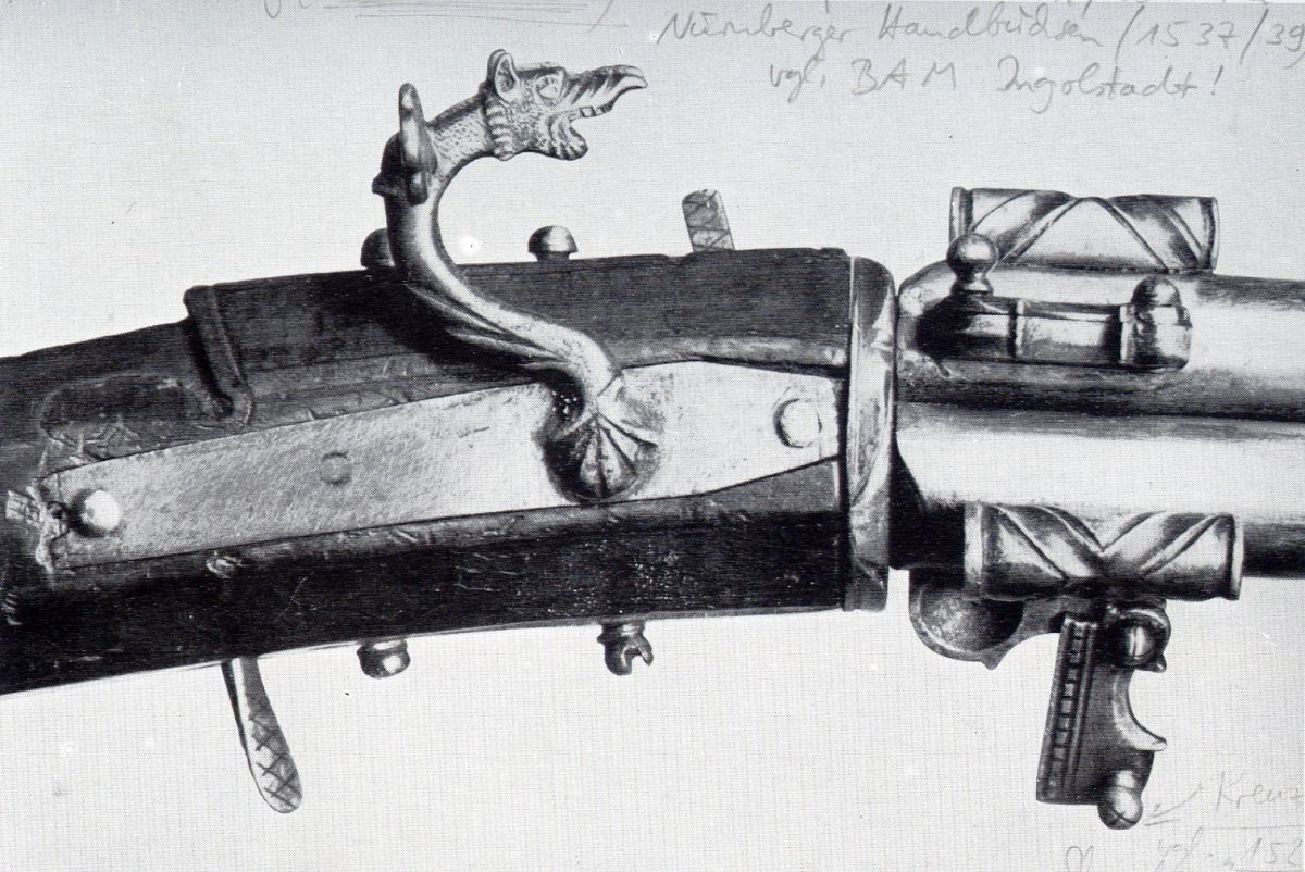

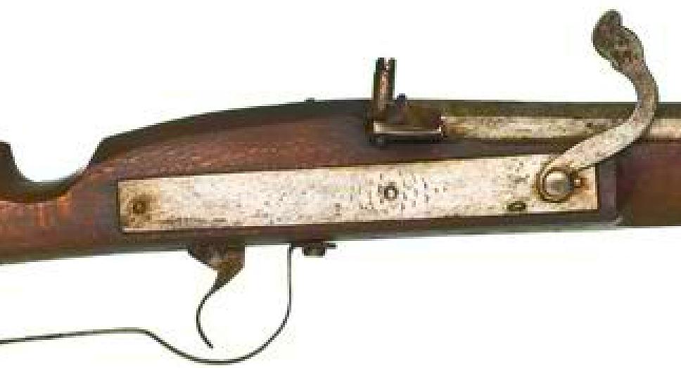

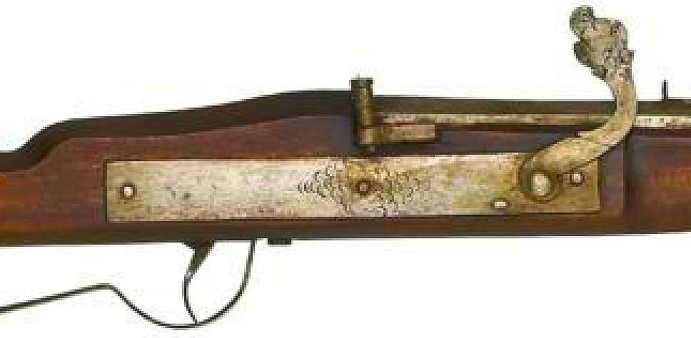

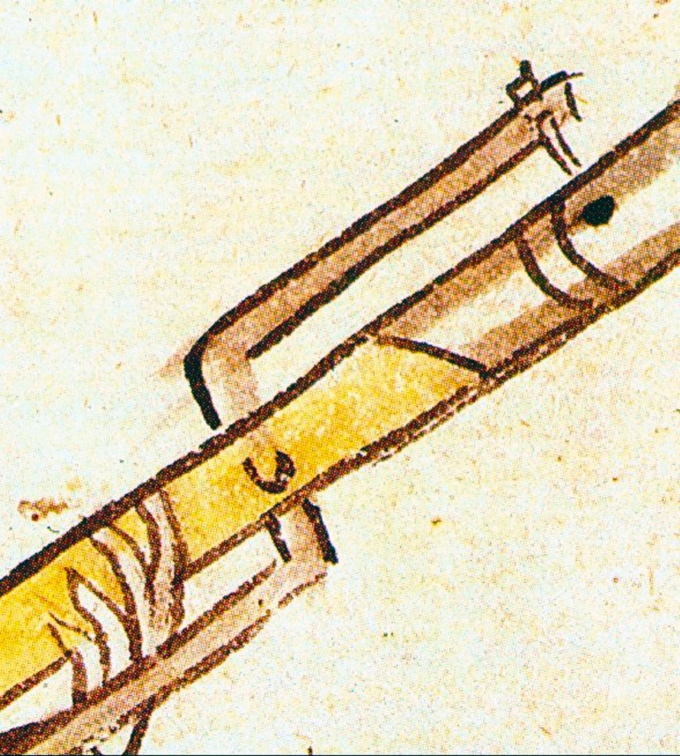

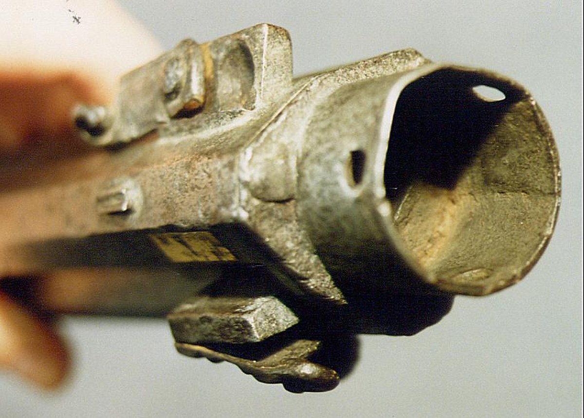

As to the direction the serpentine moved: this is quite a demanding request but I will try and reply shortly within the given frame of this post.

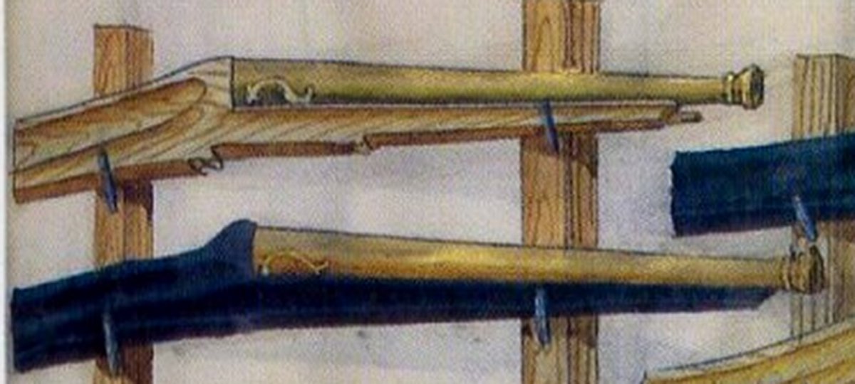

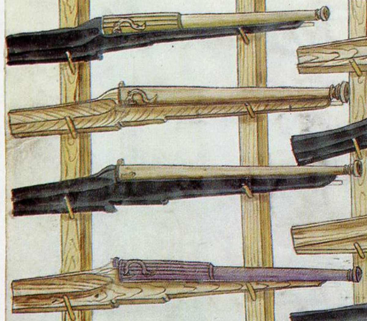

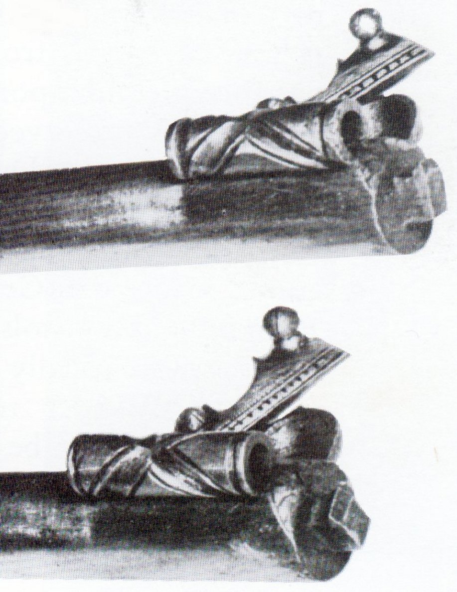

In the earliest known illustration of a matchlock, Cod.vind. 3069, dated 1411, the serpentine - holding not a length of match but a piece of tinder!! - acts forward (top attachment).

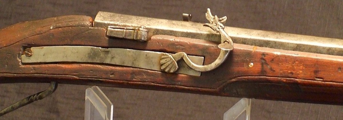

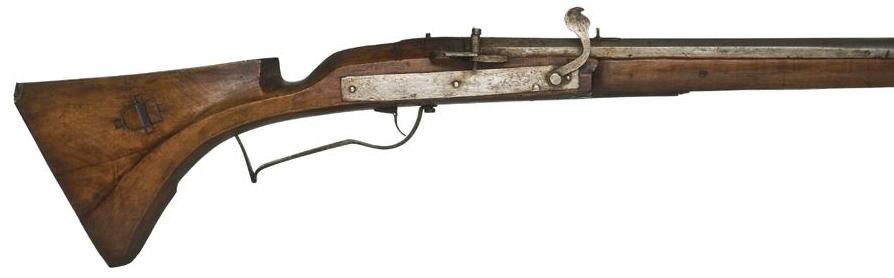

It does likewise on the oldest known actually surviving completely preserved arquebus, ca. 1400-10, the spring-loaded serpentine and hook both working-time replacements of ca. 1430; in my collection (two photos attached).
It is only by the early 16th c. that we find the next-in-line illustrations in the Maximilian armory inventories, with serpentines for tinder depicted acting mostly backward, but in one instance also acting forward.
In the Marienkirche Reutlingen, Southern Germany, there is a sculpture of an arquebusier at the Holy Selpucher, 1513, the serpentine of his arquebus acting backward (2 photos).
In the Museum of the Fürstentum Lüneburg, Northern Germany, I photographed an altar piece of the Last Judgement, of ca. 1520, depicting a skeleton firing his tinderlock (!) arquebus with the serpentine acting forward (1 att.)
On tapestries on the Battle of Pavia, 1525, the tinderlock serpentines act forward, and from the 1530's to 40's we have instances of surviving arquebuses (four in the author's collection, attached) with matchlock serpentines acting in both directions, but mostly backward.
By the 1560's thru the early 18th c., the backward-acting matchlock has established itself as the standard military weapon while on special-purpose guns, e.g. target guns and muskets with combined matchlock and wheellock or combined snap- and lever-matchlock mechanisms, we still find serpentines acting towards the muzzle.

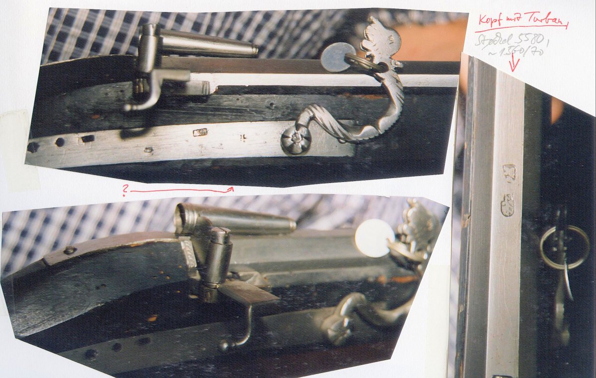

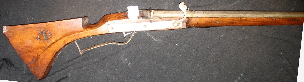

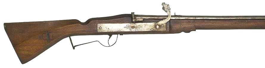

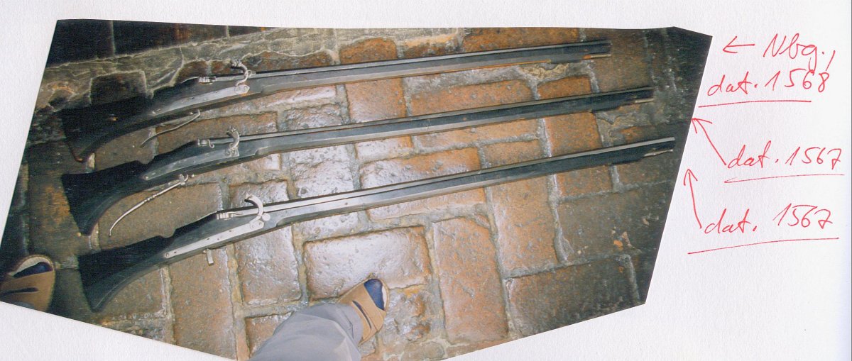

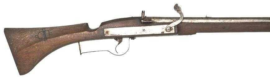

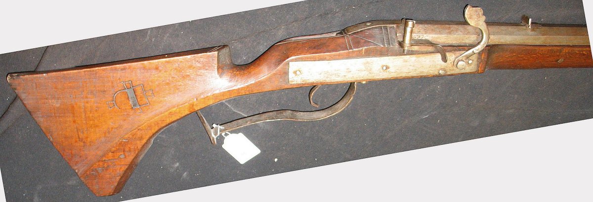

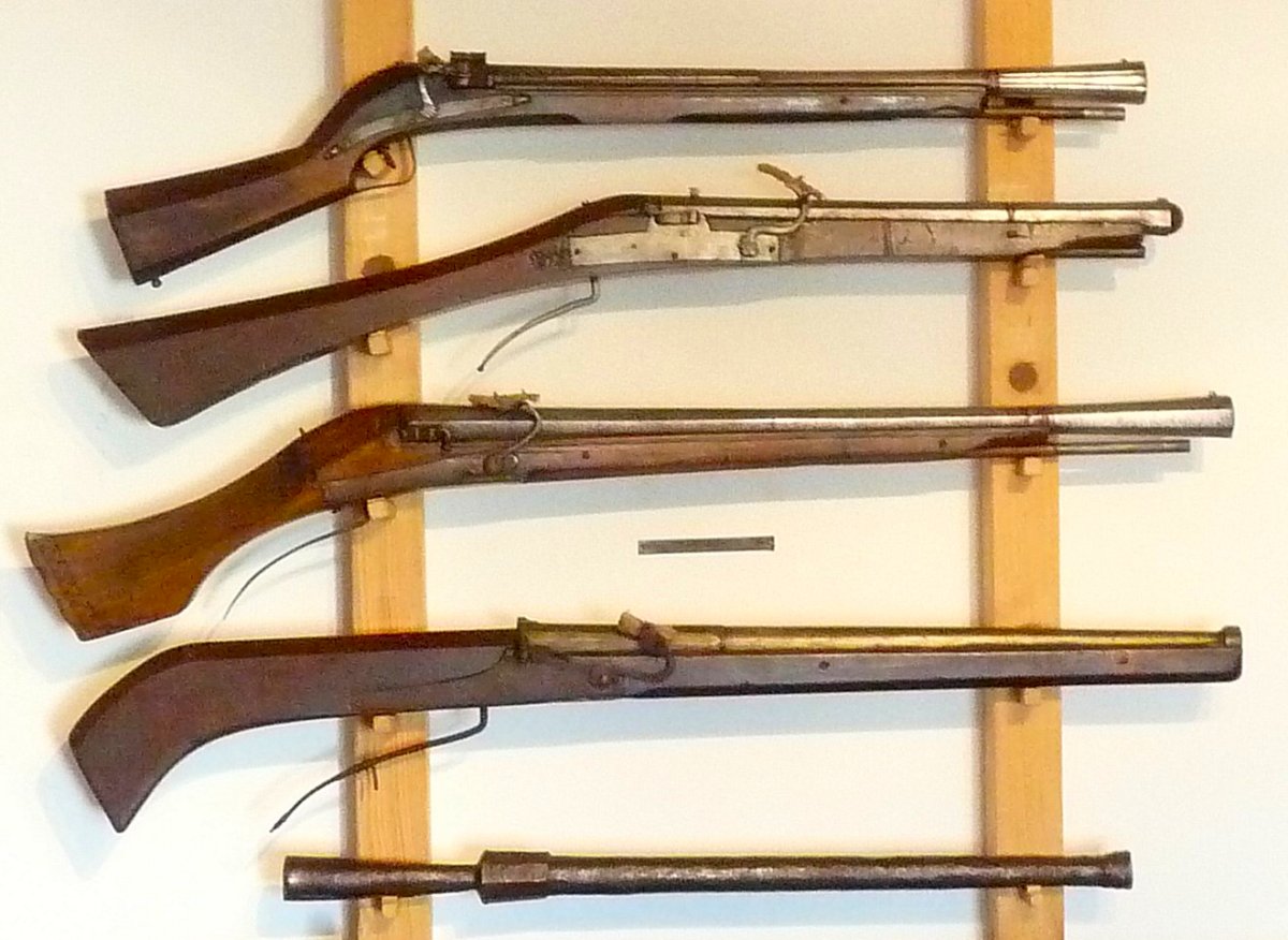

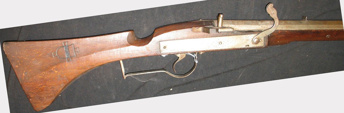

Let's go on with the attachments:
- Battle of Pavia tapestries, 1525 (4 att.)

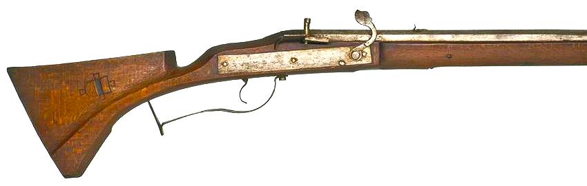

- four Landsknecht matchlock arquebuses, ca. 1525 (top) to 1540, the third from top dated 1539; author's colln. (1)
- woodcuts of Landsknecht arquebusiers, 1530's
- military matchlock muskets, Nuremberg, dated 1567 and 1568, Graz armory

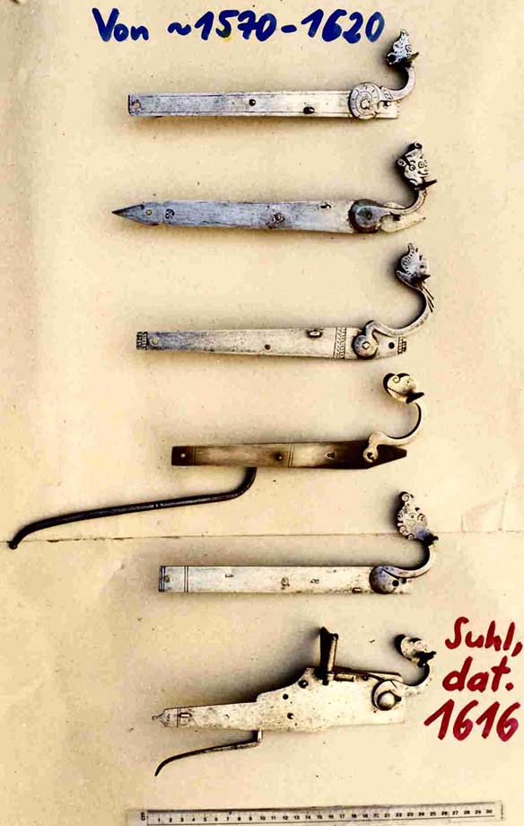

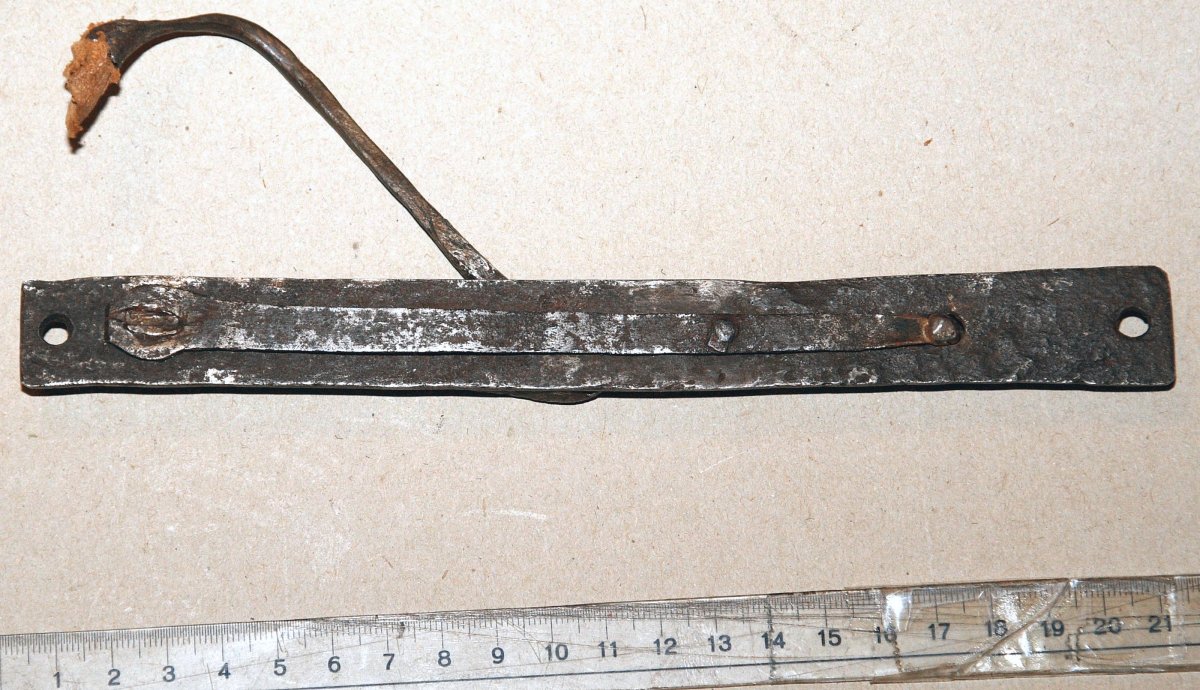

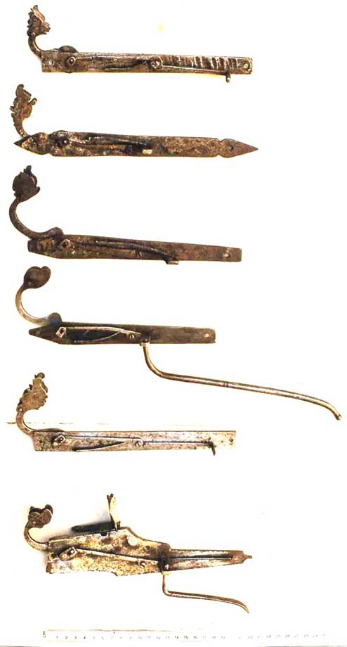

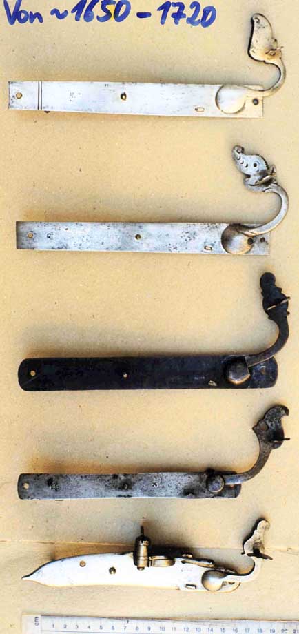

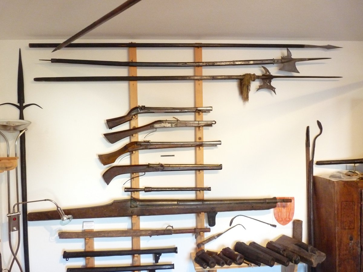

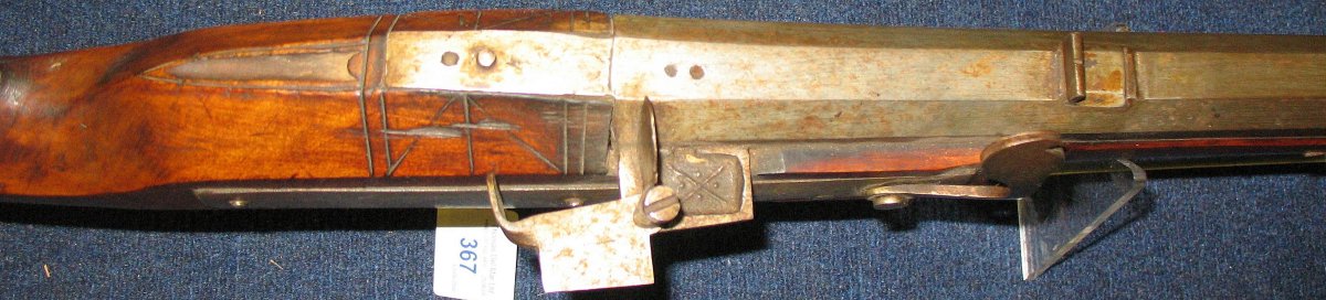

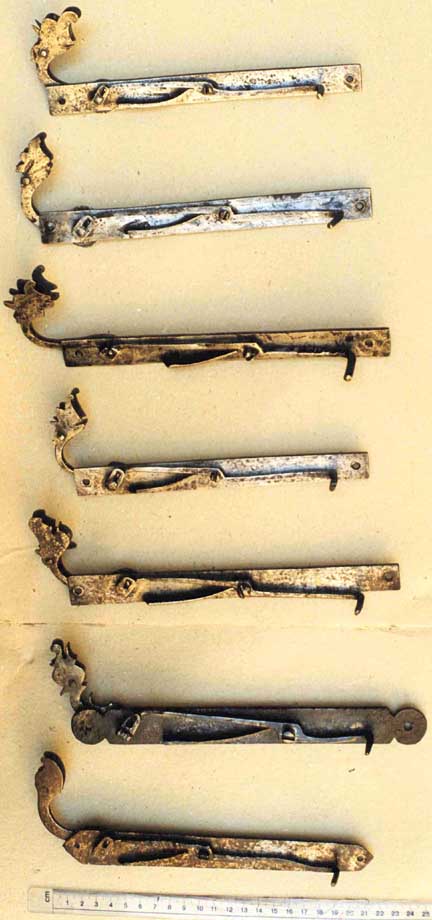

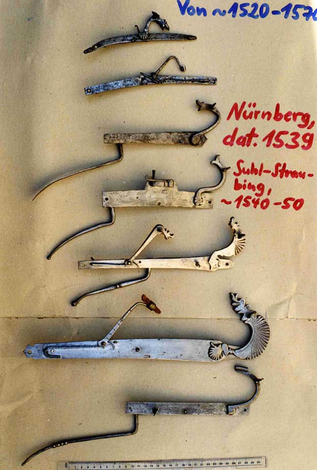

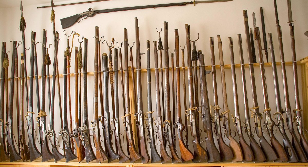

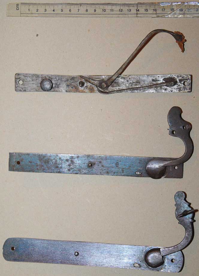

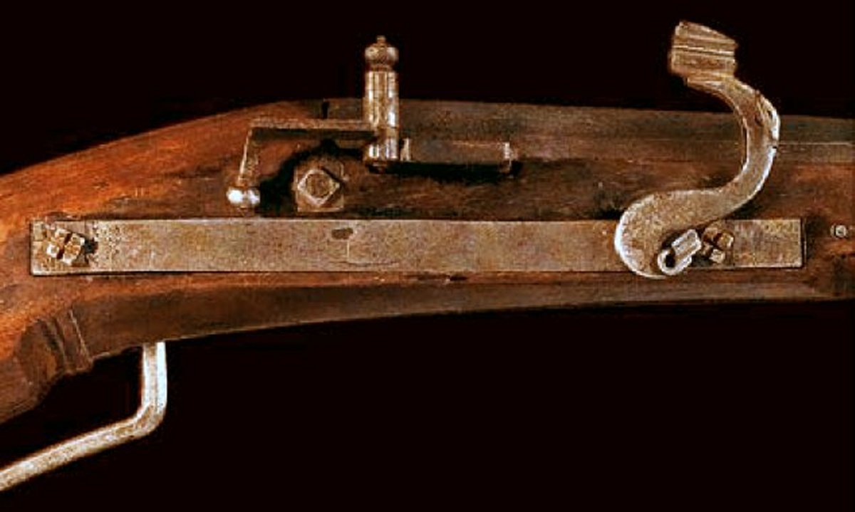

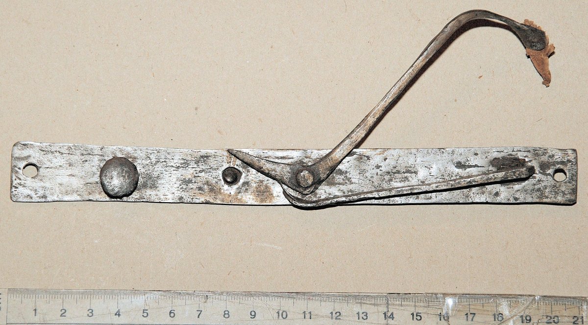

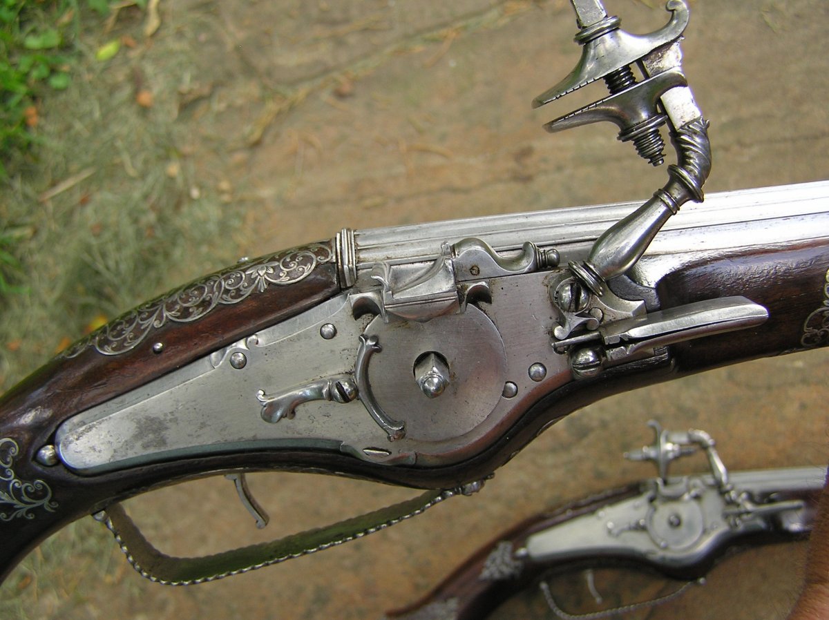

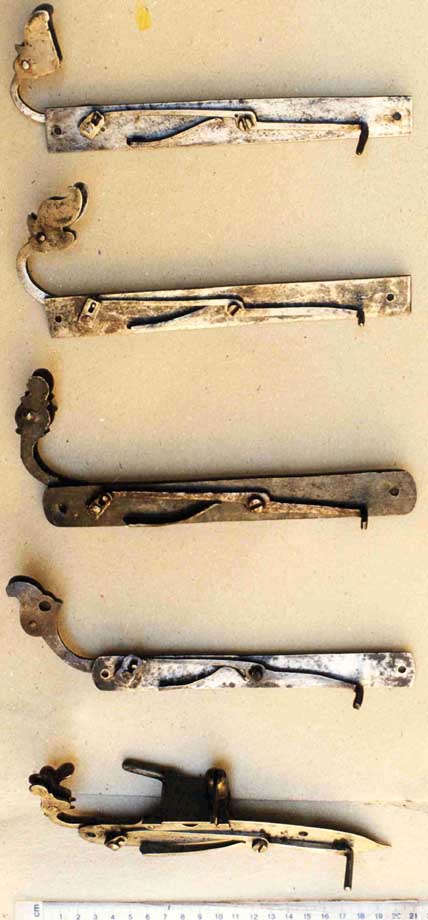

And last not least:
- military matchlock and wheellock muskets, ca. 1570-1720 in chronological order from left to right, author's colln.

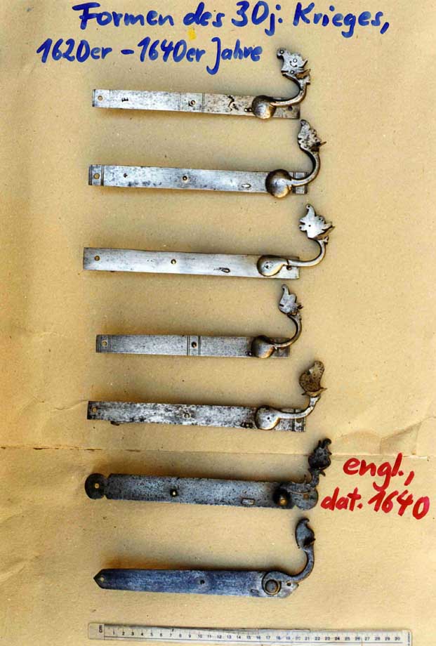

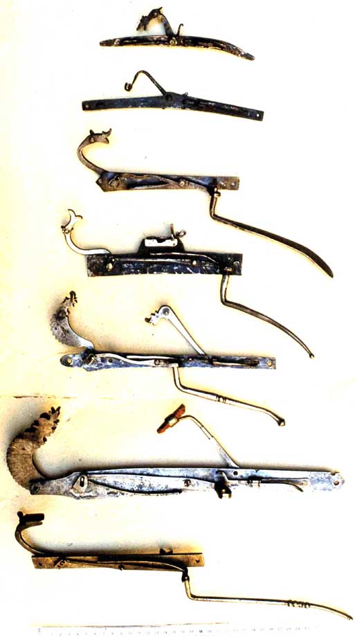

- a matchlock chronology from ca. 1520-1720, all author's colln.

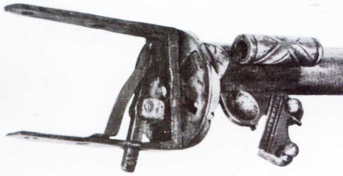

- the earliest known surviving complete snap-tinderlock mechanism with lateral push-button trigger (!), comprising all mechanical parts on a lock plate, ca. 1510, the measurements in cm; autor's colln.
- the latter, together with two detached matchlock mechanisms of ca. 1620 and 1650, retaining all of their original bluing! (author's colln.)

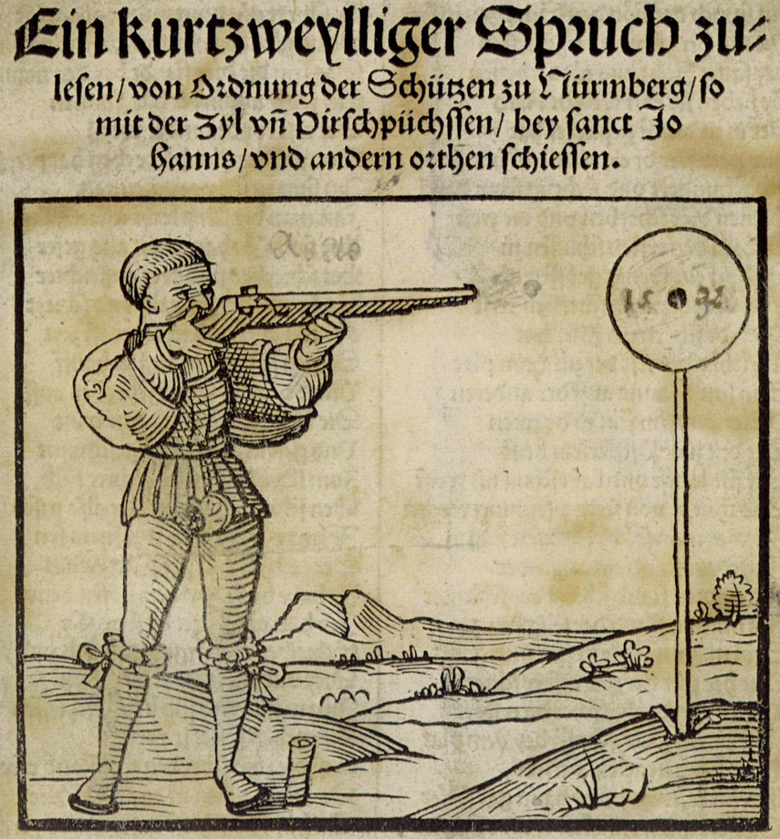

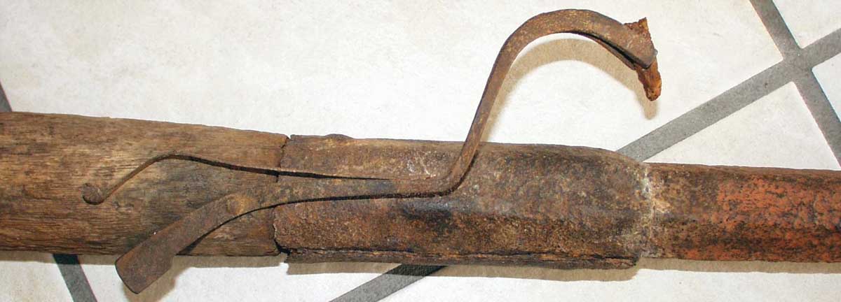

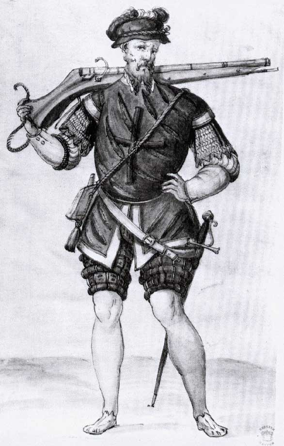

An instance of a tinderlock arquebus with 'back-action' serpentine.
From the record of a Nuremberg training shooting taking place at St. Johanns (corresponding to St. Johannis, nowadays forming part of the City of Nuremberg); dated 1532.

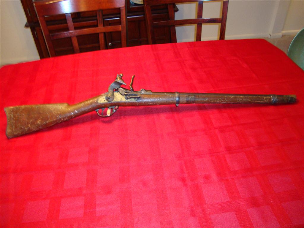

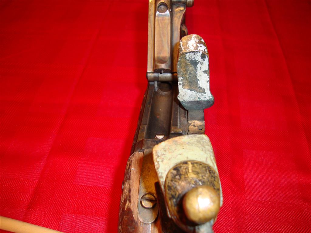

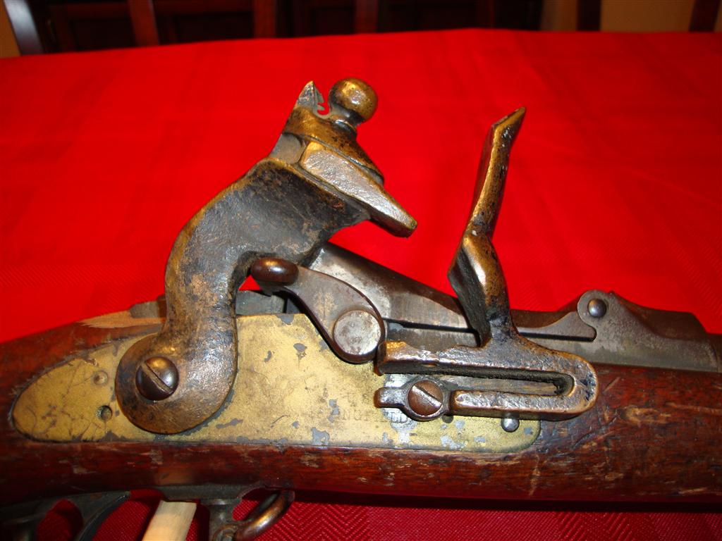

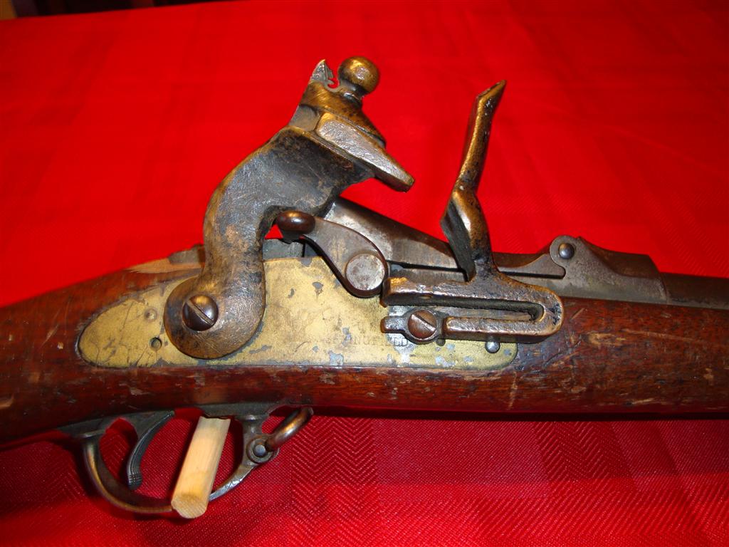

Further down this Thread the conversation went to movie type guns. Thought you all might enjoy these pics. Michael said:
"Flintlocks firing without their frizzen even being closed"
This a cut down M1873 Springfield Trapdoor Rifle made to look like a flintlock -from a distance. These were used in the early movies from the 1930's up to probably the early 1960's. This specimen is from the U.S. MGM Studios inventory. Have no idea what movie(s) this was used in. But it sure has seen a lot of use. These pics don't belong on the European Forum, but thought I would post them in case anyone was curious. Thanks again, Rick.

Hi Rick,
Thanks a lot for your nice words!
Oh yeah,
This former Springfield rifle is an absolutely 'overwhelming' example of a crude and ruthless prop gun!

Hi Rick,
This 'matchlock' pistol is an interesting instance of a former North Italian, most certainly Brescian, wheellock holster pistol of ca. 1635-40, altered probably in the 19th c. to convey the impression of a matchlock. The present lock is a complete dummy, maybe a crude replacement for the missing original wheellock mechanism; the whole item may even be a 19th c. production.
The position of the serpentine is not correct either; it should turn to the right by ca. 45 degrees.

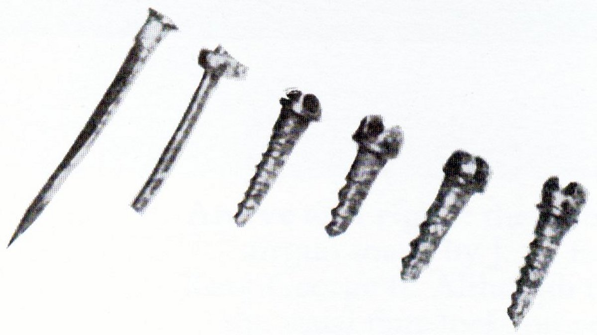

Moreover, original matchlock serpentines were never atached by means of a screw; they were always riveted.
The trigger too is fantasy style.
Attached at bottom please find instances of authentic Breascian matchlock arquebuses, with the serpentines in correct form and place, and riveted.

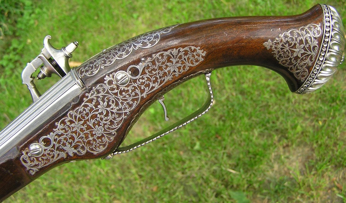

Finally four images of a completely authentic Brescian wheellock pistol, ca. 1635-40; please note the correct form of the trigger!
Thanks for showing.

Hi Michael. That was my thought when I first saw this picture. This is another one of those copies made during the Victorian period utilizing some original parts. But, thank you for detailing the specific inaccuracies. I told the other guys not to get their hopes up. LOL
Now, you would have to show me those magnificent pair of pistols. I'm getting hearburn just to imagine holding those in my hands Thanks for posting for others to see. Rick.

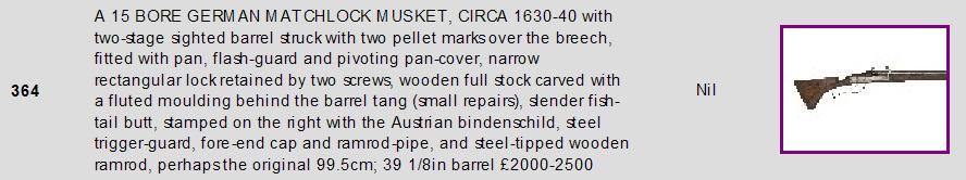

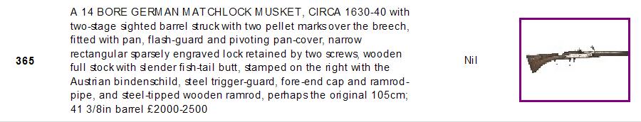

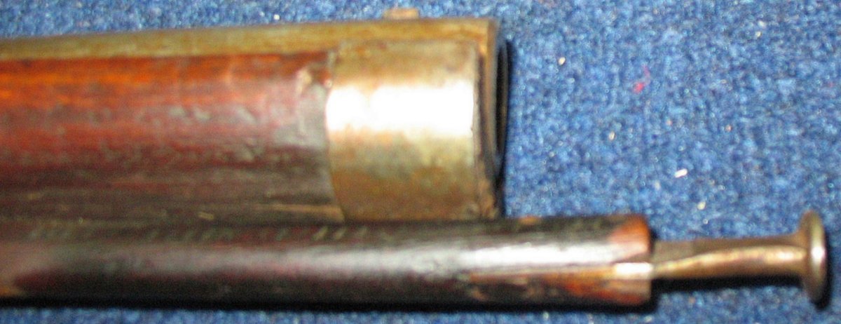

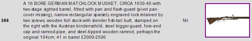

Hi Rick,
I found those pistols on the web; a dealer labeled them as sold.

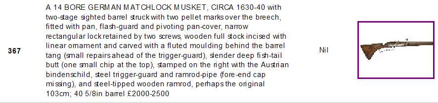

Four original 1640's Austrian matchlocks in optimum, as-new condition (!), were sold right out of an arsenal, and for ridiculous prices (ca. 2,500 USD each) at an international auction in 2008.
They were undamaged original in all parts, including the ramrods!
I am convinced they had never even been fired (some images attached).
That may be double the sum of a replica, or a bit more - but what the heck! They are far better in quality, and imagine their great age and history!
They all went to dealers ...
m
Old 2nd July 2012, 10:15 PM   #28
Matchlock
Matchlock's Avatar
Join Date: Sep 2008
Posts: 4,310
Some more close-ups.
m
Old 23rd July 2012, 08:18 PM   #29
Matchlock
Matchlock's Avatar
Join Date: Sep 2008
Posts: 4,310
Some really fascinating views of the three-barreled matchlock revolving pistol from post # 1 - dismantled!!!
m
