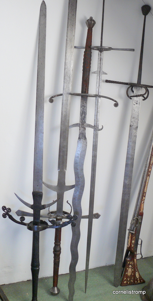

maybe we can get this fascinated weapon structured.
(in my house the twohanders are still a chaos, see pic.)
Landsknecht two hander? 16thC fighting twohanders ? Stantler twohander ?
when did the two hander became processional ? did they also fight with processional two handers? different flamberge blade types ?
the beautiful Braunschweiger twohander? fishtailpommels? difference in swordstyles between countries
looking forward to the reactions?
best regards

That`s one beautiful and rare collection you have there!
Great to see, and I would love to see some even closer details on some of these.
Two handed swords have been used as procession swords for as long as they have been around. For official ceremony or parade, the two handed sword is a clear and mighty symbol of power, status and justice.
There is however a difference between two handed swords made exclusively for ceremony and those made first for practical use that may also have been used for ceremony.
From your photograph, all the swords shown there appear to be practical two handers, all crafted for practical martial use (and there`s a couple there that I bet fly nicely )
It is possible that these have been used as processional swords at some stage in their life, but without contextual provenance, is impossible to prove.
Processional swords that are designed for ceremonial use firstly are evident by their form, dimensions or construction, which may all be outwith practical considerations and requirements.
