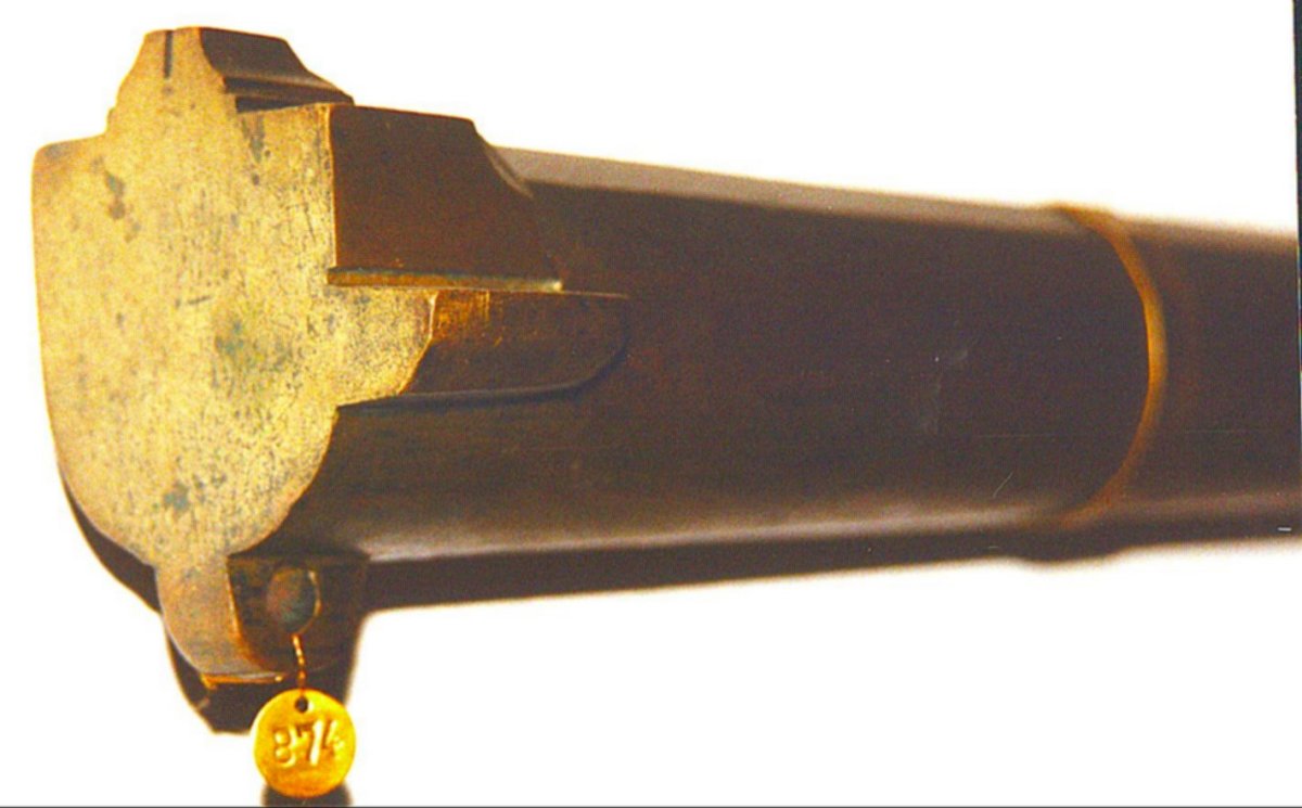

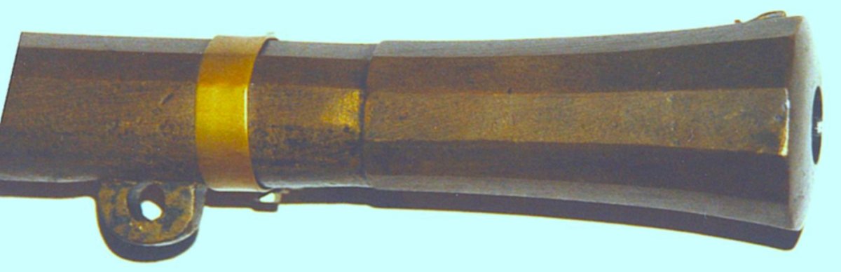

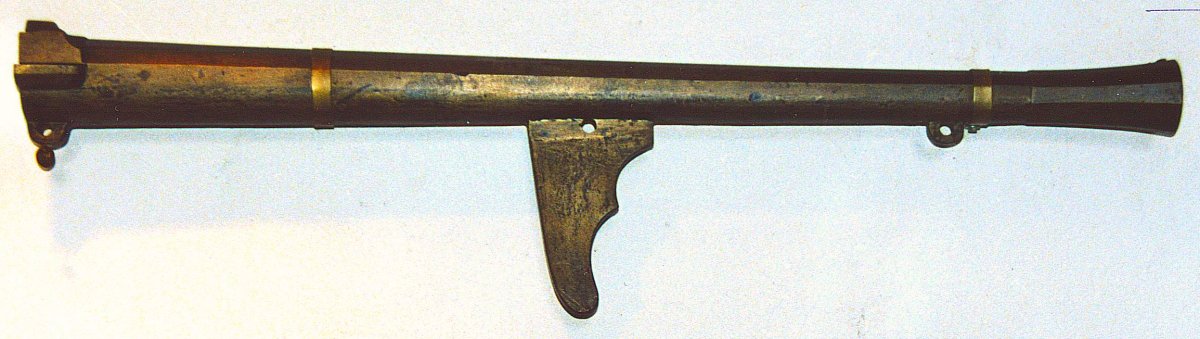

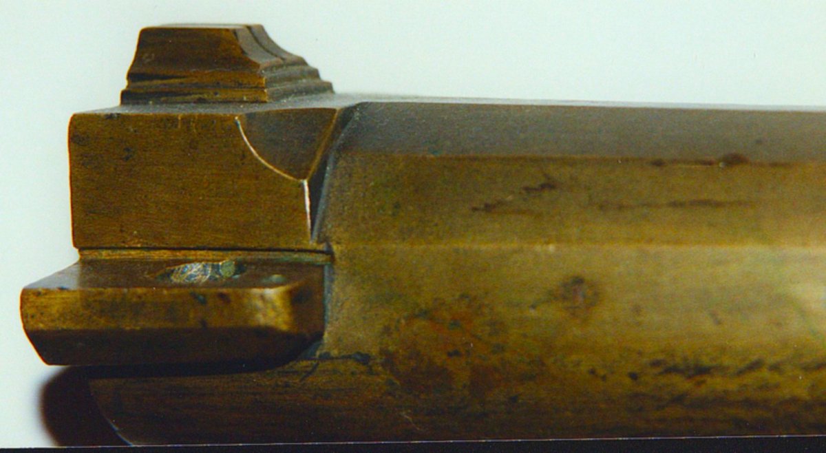

In the Heidecksburg museum Rudolstadt, Thuringia, the former arnory of the Princes of Schwarzburg.
The barrel cast in two stages, with integral back and fore sights; the original swiveling pan cover missing; two loops (and the hook pierced) for the missing stock.

As the Heidecksburg barrel can be dated to the third decade of the 16th c., its accentuated muzzle section is notably longer than the short and swamped muzzles of ca. 1500. The muzzle plane is slightly convex forming another dating criterion of barrels of the 1520's to ca. 1540.
Author's photos, 2000.
