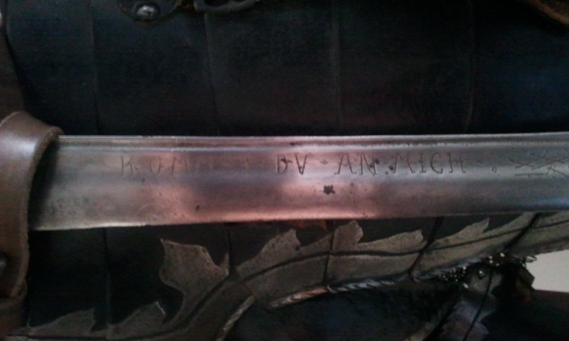

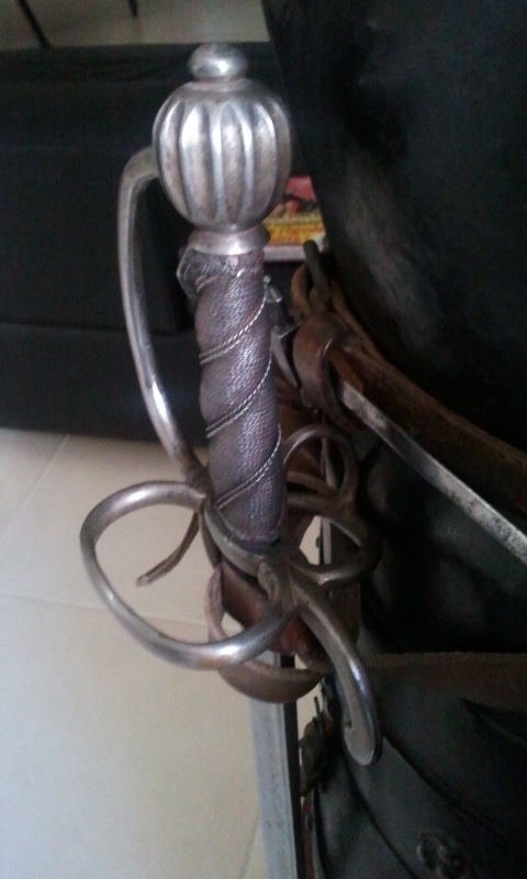

Please, do you know what is the exact model of this German sword dating to the late 16th century ?
Thanks,
jm

Hi JM,
nice sword with single edged blade?
from about 1585 to about 1620 knuckle guards of some types of hilts ends in a disc of greater diameter than the breadth of the quard, like the sword you posted.
The hilt is a good example of norman type 13(probably 1515 onwards)
the first illustration of this type named by Norman in The Rapier and Small-sword is a drawing known as "Aneli mit dem prunkschwert" by Urs Graf dated 1518.
However, the pommel of this sword, Norman pommel type 30, points to a later date namely , pommel type 30 came in the first quarter of the seventeenth century.
it is therefore likely that the sword is also out of the first quarter of the 17thc.
best,

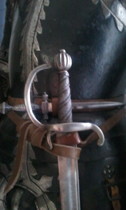

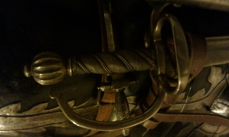

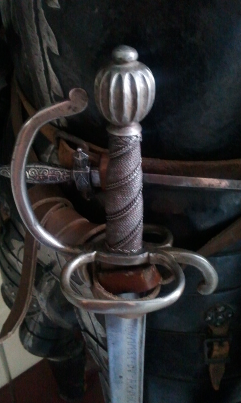

Hi Cornelistromp,
Thanks for all the details on this sword.
Here are a couple of additional pics of it.
My best,
jm

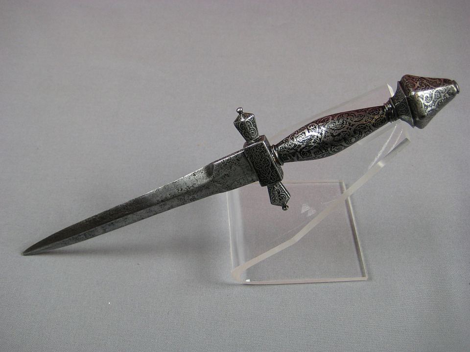

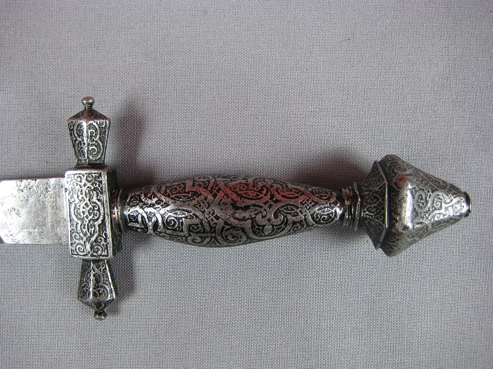

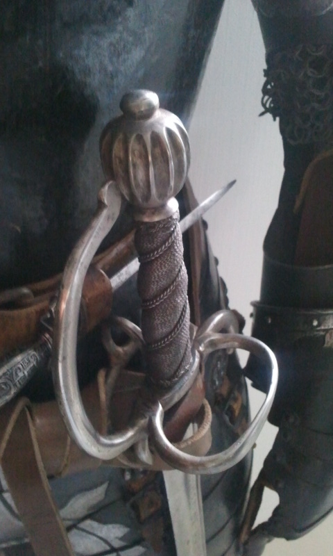

Also, any information on dagger shown on pics is welcome (Nuremberg, ca. 1580)...
Size 25 cm
jm

Ah, it is a late developement of the dussage! the dating remains, first quarter of 17thC.
to say something sensible about the dagger you really need to post better pictures.

I do. The dagger should be Nuremberg, ca. 1580 (Germany).

thanks for the pictures, this dagger looks good! , I must only confess that I don't understand the allocation to Nurnberg....... why Nurnberg?
I know this type of etching only on arms from Augsburg around 1560-1580.
best,

Hi Cornelistromp,
Thanks for the interesting comments on dagger. Augsburg and Nuremberg are two cities which are both in Bavaria, Germany. This indicates this is a Bavarian dagger of the renaissance period. I bought this dagger at 'Historica Arma' in Germany (the seller said it is probably Nuremberg).
My best,
jm

In any case, my impression of the dagger is good!
