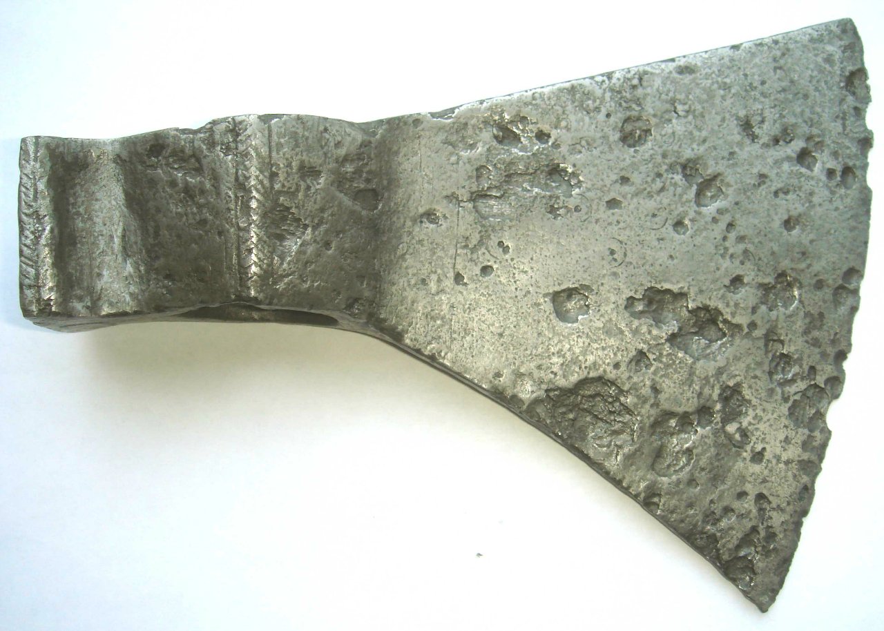

Dear colleagues,

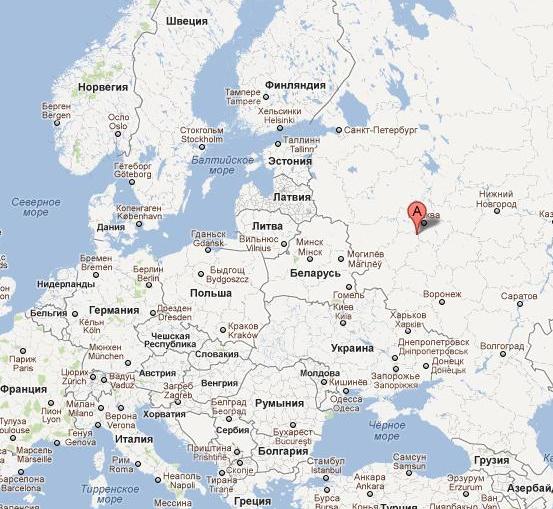

I would be very grateful for the help in identification of this battle ax found in the European part of Russia, near this place:

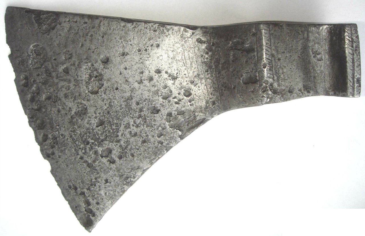

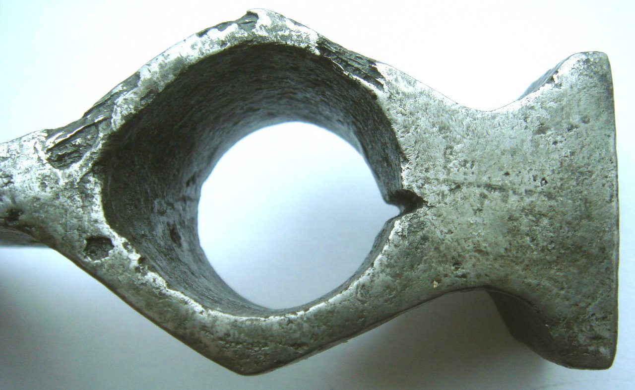

here is the axe

Too much inside Russia to be Scandinavian ?

However looking at the opposite side of the blade, with that "hammer" head, i would ask: why do you consider this a battle axe ?
Old 30th March 2012, 05:47 PM   #8
Evgeny_K
Evgeny_K's Avatar
Join Date: Mar 2011
Posts: 217
I think it's too ornated to be used in household.
Sagaris has a hammer shaped edge - it's normal.
http://en.wikipedia.org/wiki/Sagaris
Evgeny_K is offline   Reply With Quote

Evgeny
Always a pleasure to talk to a fellow Eugene
These small axes are difficult to pinpoint.
Sizes and weight might help to identify it.
Have a look at this thread, it might give you some ideas:
http://www.vikingsword.com/vb/showthread.php?t=13791

Judging by both its general Late Gothic formal criteria and the roped frieze decoration, I would date this axe head between ca. 1500 and the mid-16th century.

here are dimensions of the axe:
lenght - 175 mm
width - 135 mm
Thank you, Michael!

Default russian

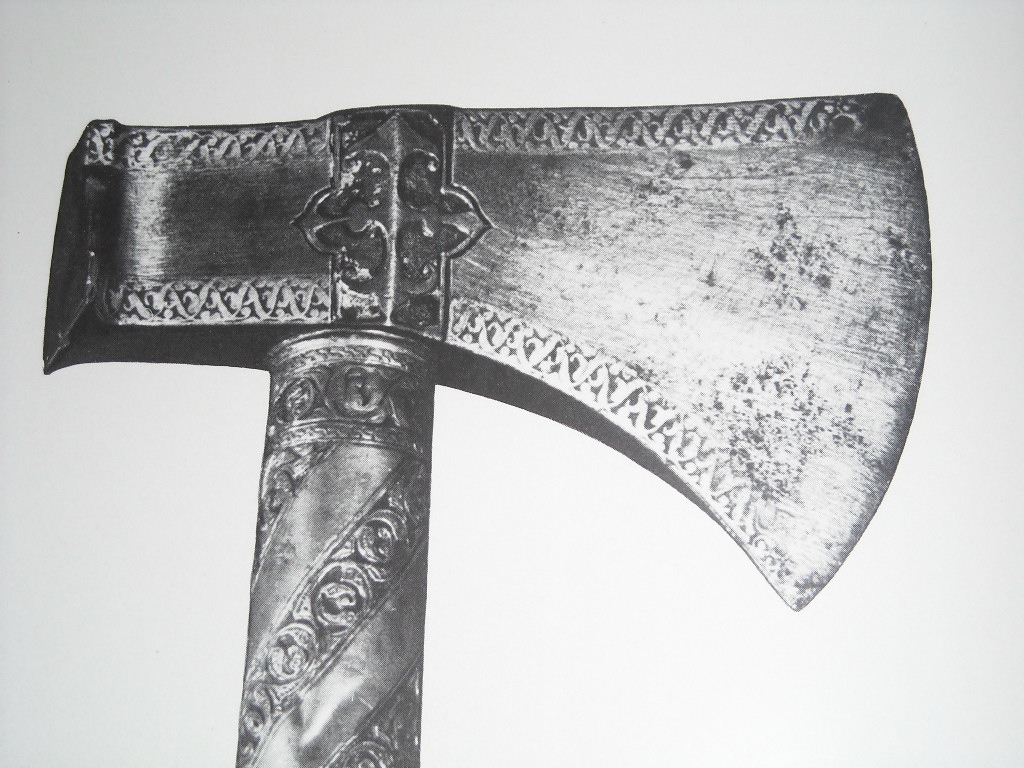

Hi Evgeny,
i might be a russian item, because it was found there also.
Here is a photo out o the book:
"russian arm and armour"
This axe is called a parade hatchet from 17 century.
Hope this helps a bit.
Dirk

Hi Dirk,
This is a ceremonial axe, which explains for its 17th c. assignation.
The basic Late-Gothic stylistic criteria are as I stated.

Dirk, Michael
Thank you!
Could it be a Polish axe, what do you think?
Old 8th April 2012, 04:05 PM   #16
Matchlock
Matchlock's Avatar
Join Date: Sep 2008
Posts: 4,310
A Polish origin is imaginable, Evgeny,
Eastern European in any case.
