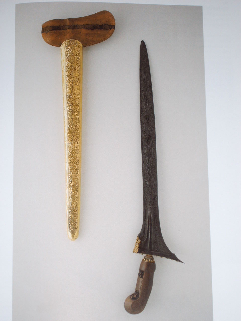

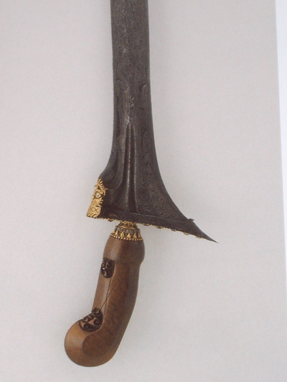

Old 28th February 2012, 01:24 PM   #12
Gustav
Join Date: Jun 2009
Posts: 1,346
Dear All,
here are the pictures of Keris, which belonged to Diponegoro, according to notices of George Lodewijk Weijnschenk. He acquired this Keris in Yogyakarta, 1886 he's collection came to MVK Wien.
Total length 48,7 cm, blade length 40,5, which is very big for a Yogya kris. Also atasan is very substantial.
