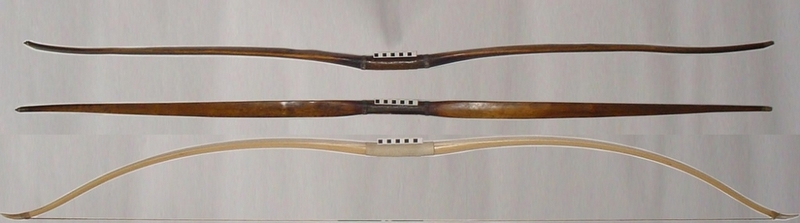

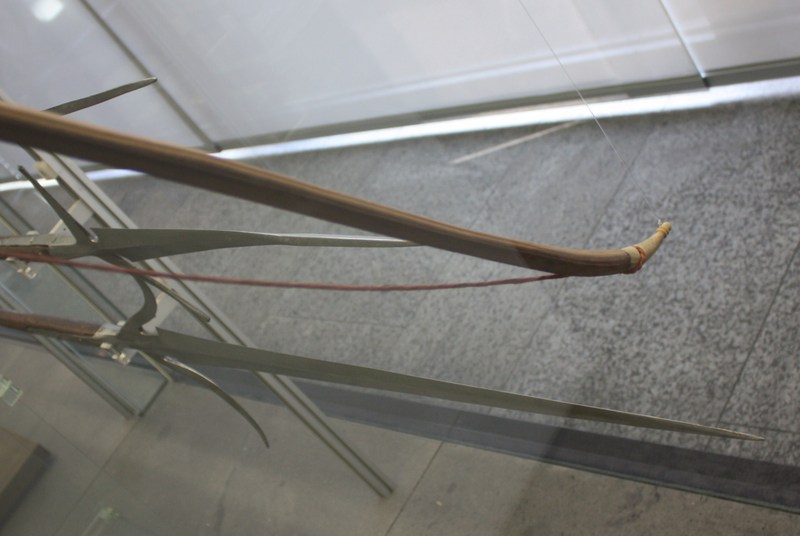

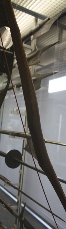

There is one wooden burgundian bow exposed in the "germanisches Nationalmuseum" of Nuremberg which originaly came from Schloss Hohenaschau. It is made of laburnum which looks a bit simular to yew because it also has sap- and heartwood. The bow has a reflex in the handle area and the last 10cm before the tips are also slightly reflex. The tips which hold the sinew are made of antler or ivory and they are nicely carved. Both limbs have a pentagonal shape which are grooved around each edge.
The broadness of the bow is 33mm in the handle area and 13mm at both tips.

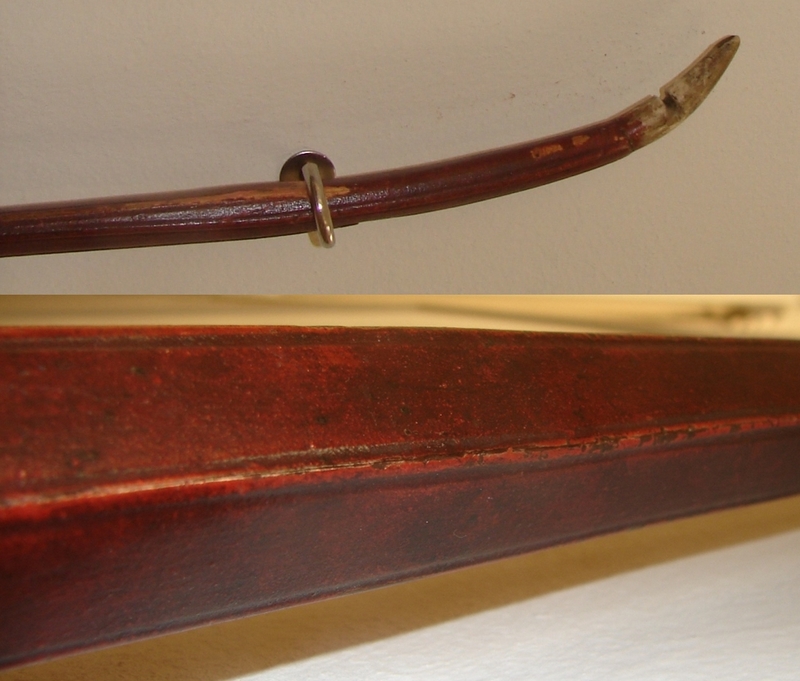

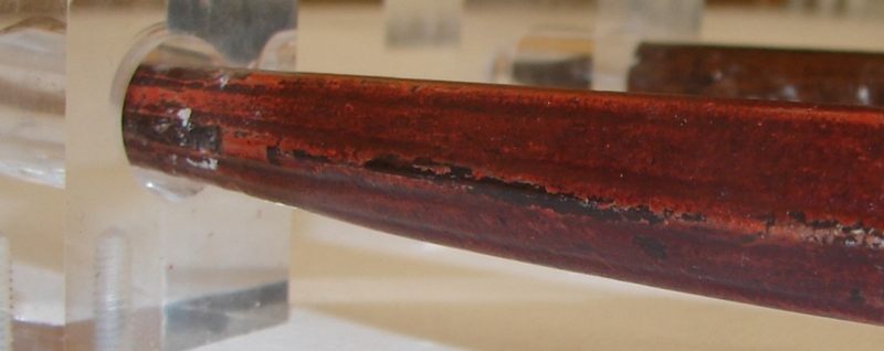

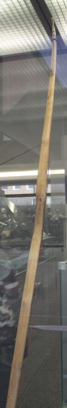

Some pictures of the burgundian bow from Hohenaschau...

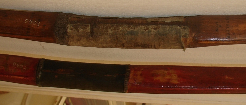

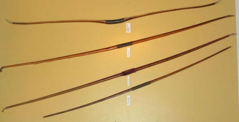

some other burgundian bows of the 17th or 18th century.

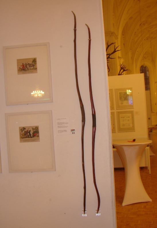

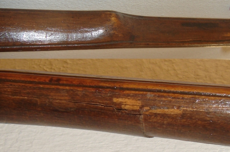

some other burgundian bows. The two bows which ar next to each other are exposed in the Jagd und Fischereimuseum of Munich. Both bows are from Lyon and they are from about 1700. But the basic style is still the same!

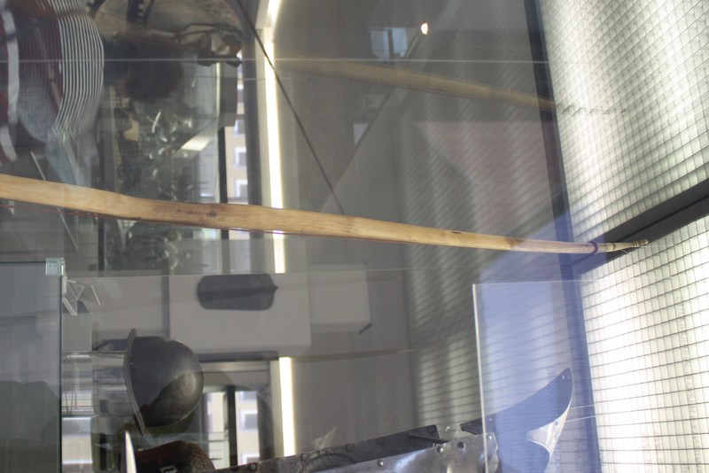

one more...

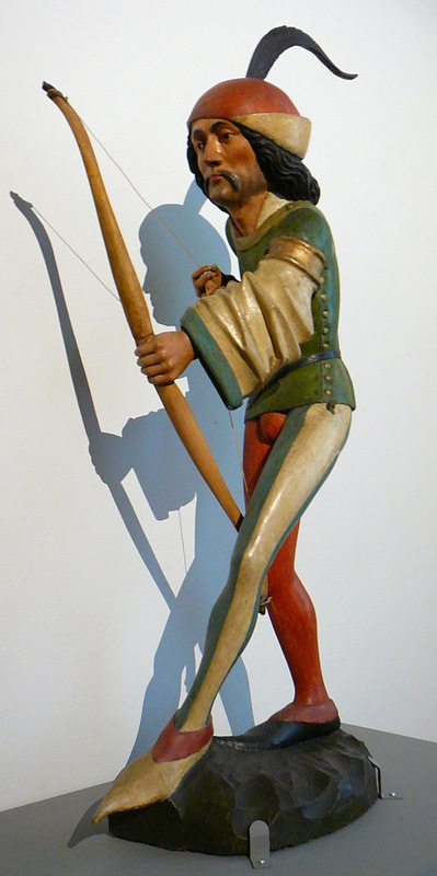

more pictures...
