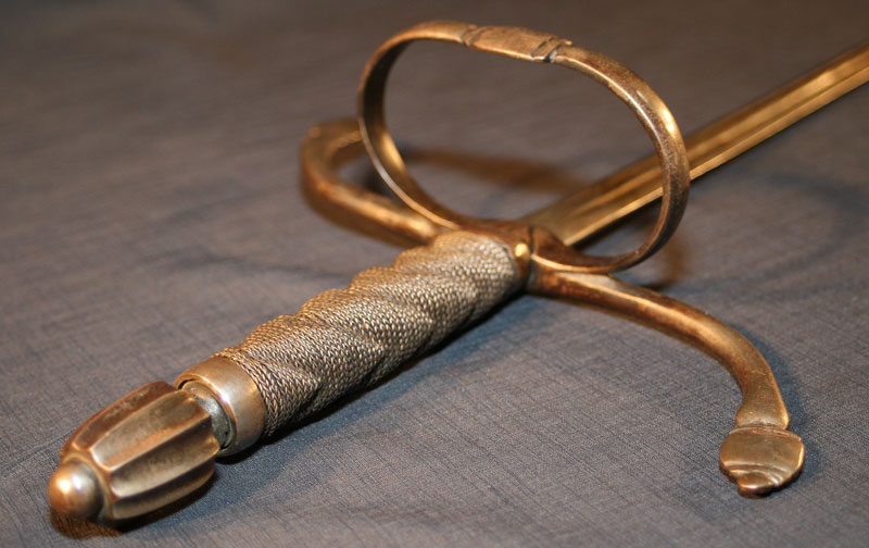

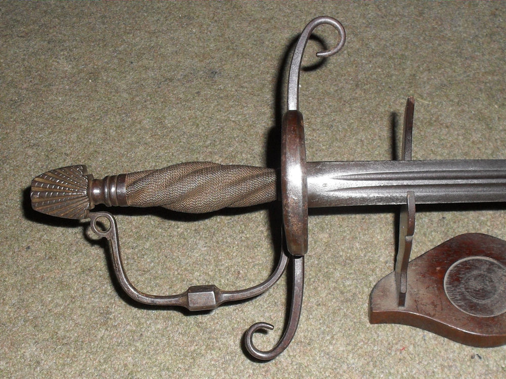

Here is my latest sword.
Some stats, blade 32", overall 38". Point of balance 3-1/2" down the blade. Balance is beautiful.
I'm just going to post pictures and let Jim (if he wouldn't mind) tell you about what he has found for me.

Hi Gene,
In my opinion, your rapier can be classified as a 19th c. Historismus (Victorian) hilt in late 16th c. style, with an older blade recycled.

Exactly, 'Nando,
The blade is of early 19th c. date.

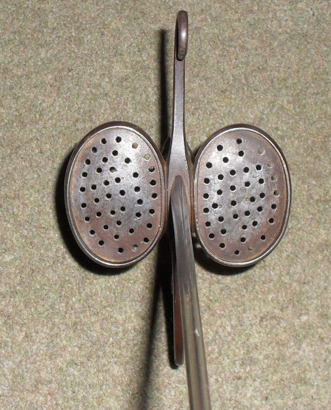

Hi gentlemen.
Another teaser pic. Notice that one shell is slightly larger?

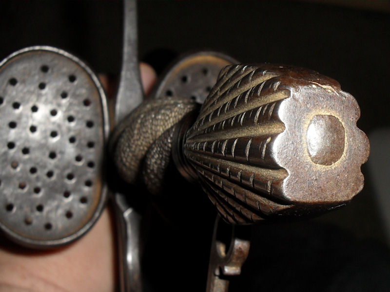

Nicely peened tang

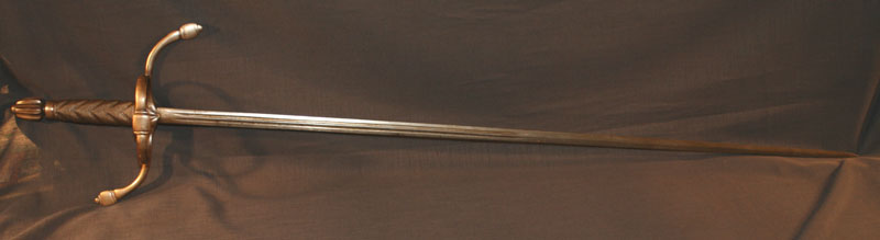

Comparison with other rapiers and swords showing the similarity in length to 19thC sabres

Originally Posted by Atlantia
Hi gentlemen.
Other things have such particularity

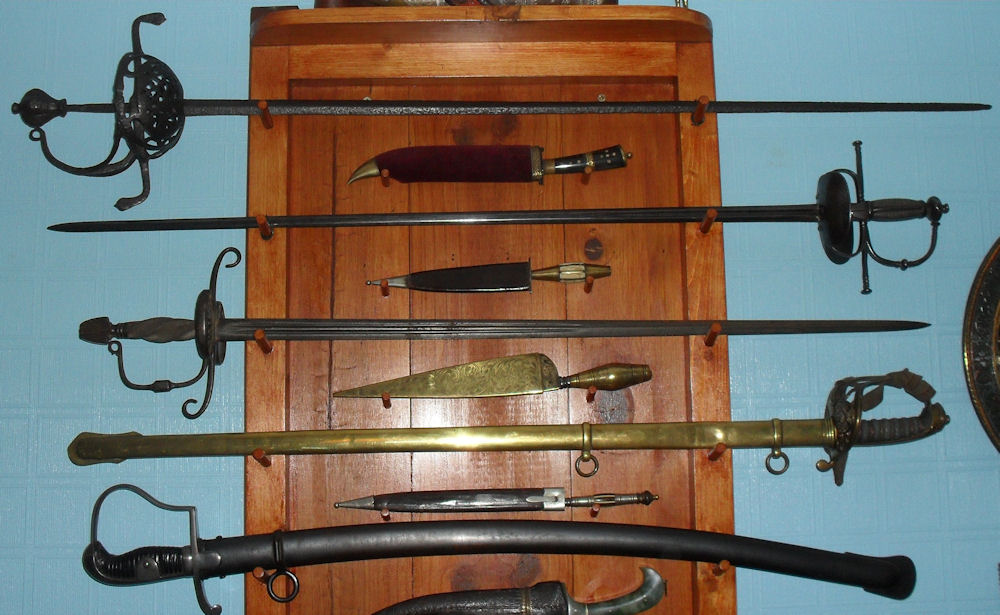

Old 22nd November 2011, 02:26 PM   #30
Atlantia
Atlantia's Avatar
Join Date: Jun 2008
Location: The Sharp end
Posts: 2,928
Originally Posted by Dmitry
Very nice Dmitry!
Not as 'beautiful' as mine of course, but not too shabby
What's the balance like? Interesting similarities to mine. Is the tang 'peened' or does the pommel screw-on? I find that this reinforces my view that these might be more than decorative!
Do you still have it? Where is the point of balance, can we have some stats please?
Thanks for sharing
Gene
