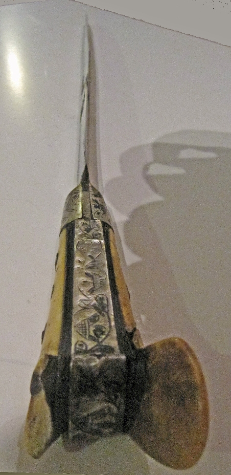

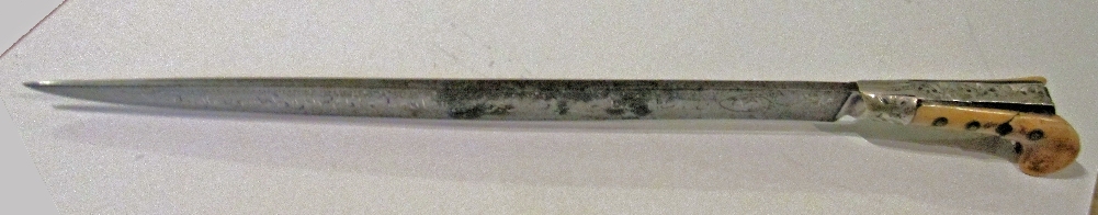

Anyhow, I was wondering if someone might be able to help with a translation on the blade of this knife. The handle makes me think it is Ottoman, but I am far from an expert on the matter, it may be Arabic. Particularily any help on the inscribed name and date would be most appriciated.
The 2 pictures of the entire blade were pieced together in an attempt to have the whole inscription legible and in one piece. I hope it worked alright, it looks piecemeal, but thats the limit of my photo-software knowledge and/or camera skills
I can try and take more pictures if necessary.
Thanks all!

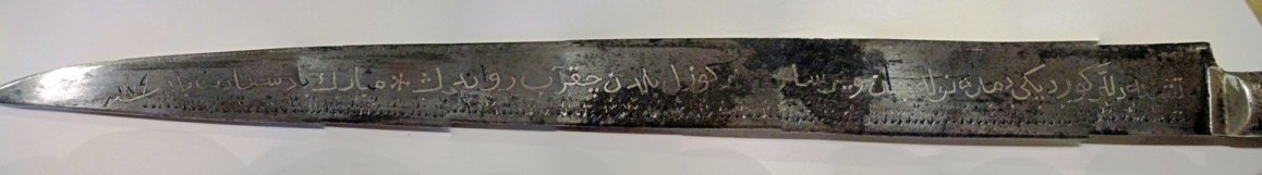

the reading of the tuğra is as follows:
Amel-i Muharrem, sahib Molla Muhammed
work of Muharrem, owner Molla Muhammed
The language of the inscription is Turkish, if you can provide partial pictures like the one of tuğra, it will make it much easier for me to read it.
Sure, hope these help!
I little our of order, I think it made the last piece first, but the others should be in order down the blade.
-J

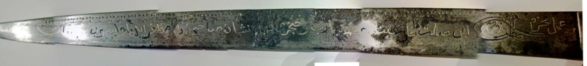

j118
Join Date: Nov 2011
Posts: 6
and side 2, same as above...
again, cant seem to get the editor to take them in order, sorry about that.
this one is in the order 6,5,4,3,2,7,1
j118 is offline   Reply With Quote

Sorry for responding late to this thread, but the reflections on the blade as well as erased parts made it quite difficult to read it. I only read one side and I am still trying to figure out the other.
To pick up where Dom left:
sine-i 'adaya yarıp bu hançeri kıl nişan
sahibi daim muzaffer eyle olsun alişan
Let this knife be a sign on the bossom of the enemy
Let its owner be glorious and high in fame

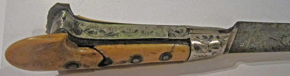

The straight blade, small ears and the niello decoration are typical for the early yataghans from the 18th century. You may find similar examples in the Astvatsaturyn's book.
I have also a similar one, which bears the date 1182 (1768) on the both sides. Please notice a top quality hamon (bright and having a uniform width), which you may expect from a Japanese master smith
