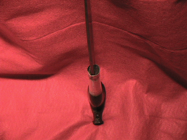

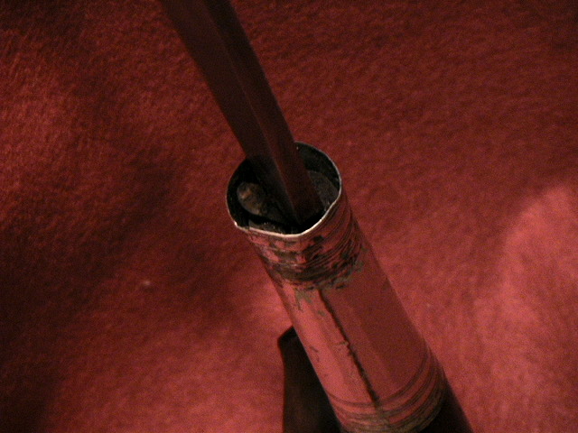

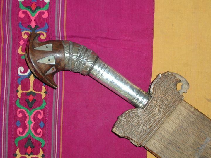

i have a barong that, well, looks great. the only thing that's distracting the over all picture is the part where the handle connects to blade. it's not ovbious if i intend to just display it on the wall, but i'd really like to care of this wonderful piece, and that includes making sure everything is in tiptop shape.
the blade is still securely attached to the handle; there is no play at all. the only thing is, it look rotted where it meets. also, i'm worried that moisture might get in and further weakens the connection. my questions are:
a) how do i prevent it from rotting even further, and
b) how do restore this gap?
can i fill it up with some type of clay or is there anything i can buy over the 'net to remedy this problem? please note that my woodworking skills is between negative one and zero. it goes up to one when it's life threatening.

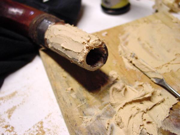

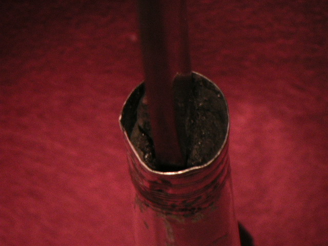

Hey Spunger, nice barong. The only way to really fix that is to pop the hilt off, straighten the punto, and then carved the little wood shims that fit between the punto and the blade. That's if you want to do it the correct traditional way. I'm sure Battara would agree with me about that.
BUT...
As Lew mentions, the wood epoxy putty works pretty good and is a lot easier than than carving those anoying little shims. Plus, you can stain them to whatever color you like.

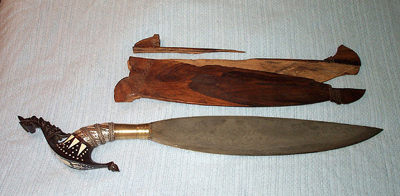

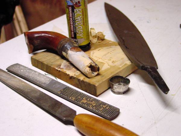

Here's some photos of a barong restoration I did about a year ago. Shelley and I were at a collectors arms show here and this seller sold me this little talibon, a dagger from Luzon, and this junked barong for about the price of a carton on smokes and a few six packs (i.e. dirt cheap ) The barong was in such sad shape that Shelley passed it up. I couldn't refuse. Anyways, the hilt was off and there was a huge chunk of wood missing from the side of the hilt, the wrapping was mostly gone, and a little chunk of wood missing from the beak of the kakatua. The only redeeming quality of the barong was the blade...it was covered in cosmoline and it had a complete scabbard (which also needed work.) I took it home cleaned off the cosmoline and then etched the blade to find a wonderful damascus pattern. I then decided that since this is going to be a total restoration of the hilt or rebuild, I didn't care too much about traditional methods and opted for modern conveniences. It wasn't a datu class junggayan hilt, but your ordinary fighting barong. So here are some pics of the stages of restoration. The first pic is the hilt off the blade with some epoxy putty I used to build up the missing chunk of wood. The second pic is fitting the hilt onto the blade to size things up. The third photo is adding more epoxy putty to build up the grip area. The last photo is the grip area filed down and sanded into shape

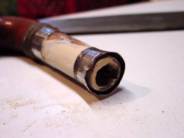

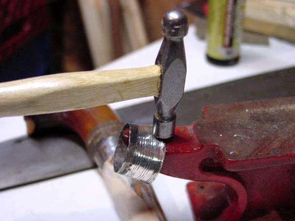

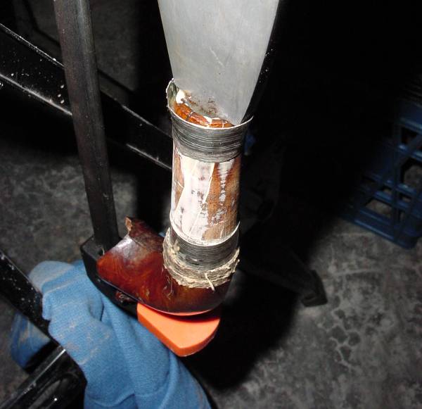

The next set of photos shows more work on the punto. The first phot show how mangled the punto is. The second photo shows me straightening out the punto on a miniature anvil I have with a tiny ball peen hammer...I got both of these at a gunshow awhile back. The last photo shows the somewhat better rounded punto on the hilt.

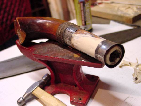

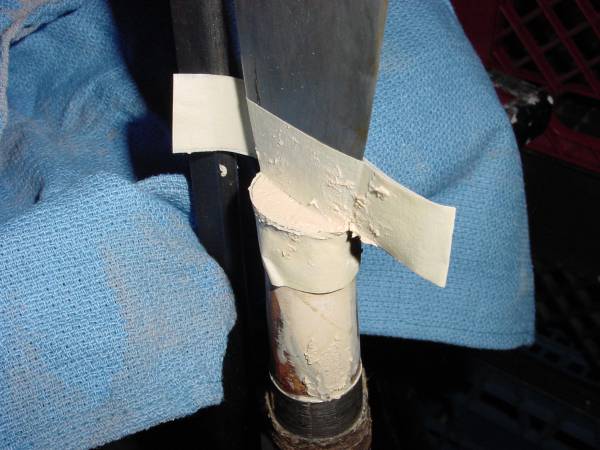

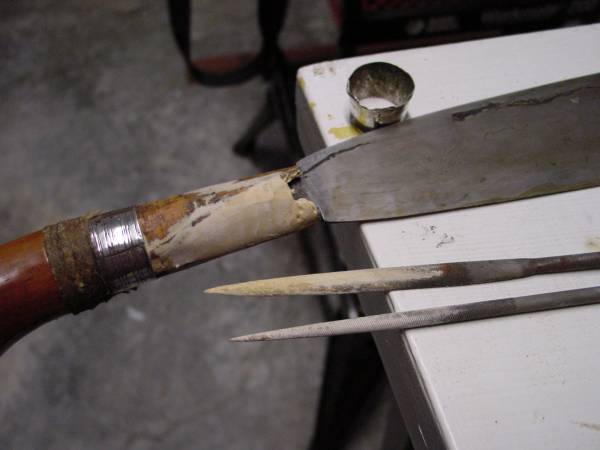

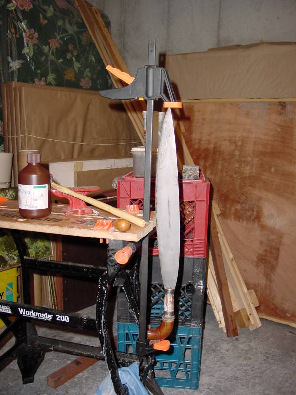

These two photos show how I jigged up the blade and hilt for gluing. I used a putty type epoxy here as well, but the darker stuff for metal. I used one of those squeeze clamps to hold the blade in place to the hilt. I then clamped this upright on my little B&D workmate. This way the epoxy would seep out even though it was a putty form. Worked great.

You could round out the ferrule edge by working a rod from the inside before you decide on pitch or epoxy. Pitch is traditional and easier take back out, also it gives when its ready to be changed again and good since the blade is still secure as opposed to hard epoxy. Clean and remove loose particles to get a better bond. I prefer the gel type epoxy on my practice swords but you only get one chance on the set. With the gel or putty you can buy a stain made for epoxy that you mix in before applying. Cover the blade and ferrule with tape when you're ready for the pitch/epoxy, keeps glue where you want it and makes for a neat clean up, if you over fill it you can still go back and sand it the desired shape, if you under fill it you can add another layer.

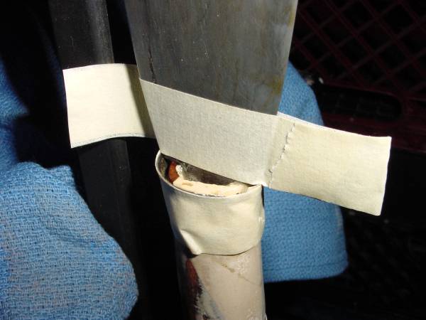

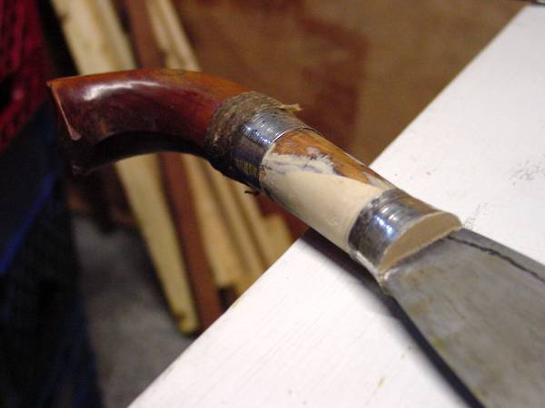

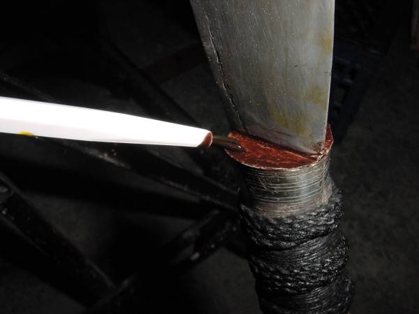

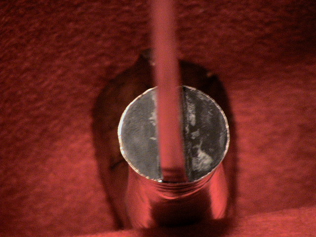

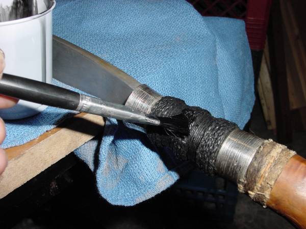

This is the part that will interest you, Spunger. Once the blade is firmly glued into the hilt. I taped off the punto and the blade with some masking tape. This is so the putty wouldn't get onto the outside of the punto and on the blade. I then added some putty into this gap between the punto and the blade. Use a putty knife to smooth it out. I also had this jigged up just like before when I was gluing the blade to the hilt to keep it pretty level. Once the putty sets, sand down the putty to your liking. It's probably safer to leave the masking tape on until your done sanding. Once your done, remove the tape and do whatever sanding is necessary...I did more final sanding to the hilt.

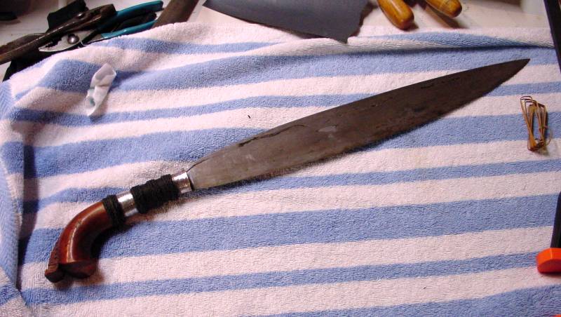

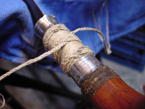

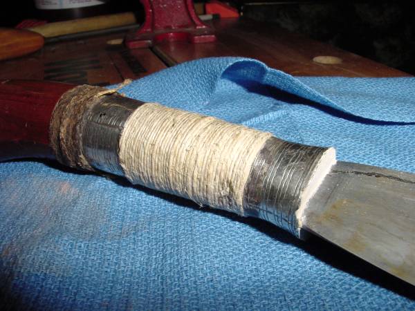

Finally, add your finishing touches. For this barong. I first did a single layer wrap with hemp. For added grip, I added a second layer of braided hemp in short sections. I would have done it the way the do this in Sulu, but I can't figure it out and is way too complicated. I could have asked my father, but it's been a long time for him do something like this. The next photo shows me laquering the hemp grip. Traditionally, you would use pitch, but since I decided to use modern methods from the beginning, I mixed up some clear laquer (believe it or not its the Testors model airplane stuff you get at hobby store) mixed with some black pigment (I used this India ink I had laying around in an old calligraphy set...HEY IT WORKED !) The laquer also helps bind the fibers of the hemp together and seals it. Finally, the last step was to stain the wood putty in the punto. I chose a dark stain...I forgot what color it was...I think rosewood. Looks real enough to me. The last photo is the completed barong. I wish I took a better pic of it. See...it wasn't that hard to do.

Take something hard and round, like a small phillips or thick nail and slowly work the ferrule edge round. I'd tape everything up hilt, blade and edge to protect all the parts and just in case the sword wants to bite you...

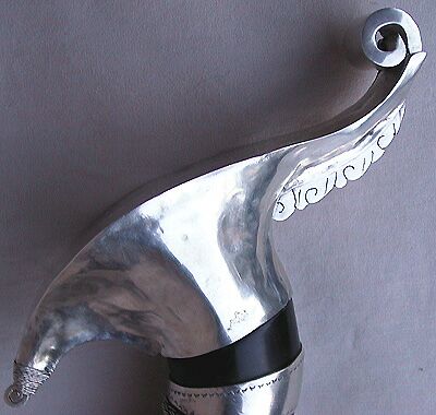

Have you or anyone done any Plume or Beak Restoration on the kakatua pommel on a barung? Any help or suggestions would be appreciated?

Ibeam the only real cockatua restoration would be to recarve the cockatua down or to replace it completely. I would not suggest tacking on a new crest or beak, as there would a number of problems.
A. finding the banati would in the first place is difficult,
B. finding banati of similar grain and color
C. hiding the joint
One could try staining to hide, but as the wood ages, the contrast would become apparant. Ironically ivory is easier to do this with, as joint lines can often be mistaken as stress cracking. But, with wood, I really havent seen anyone add pieces that werent obvious replacements. The only thing I could think of, if you really want a bigger cockatua, perhaps add silver tips (eg. beak and crest) to the cockatua. Jose/Battara could probably whip something amazing up.

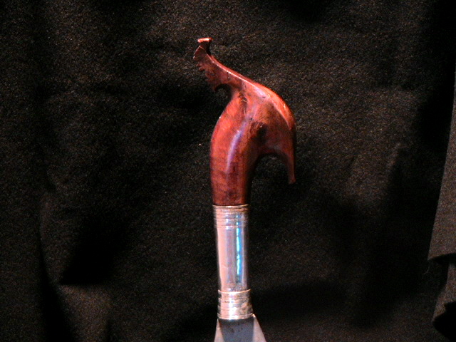

Here is one of the pictures missing in the post that I think Spunger is refering (thanks Spunger). It is a pic of some of the work I did for Ian on his barong - I created a silver cockatoo head that was missing on his barong:

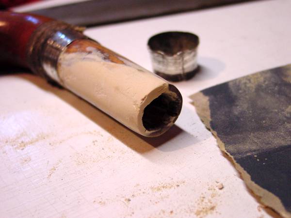

well, for one, can't find any pitch in this great metropolis of chillicothe. even went to columbus. no such luck. so i ended up using this product called "plastic wood", epoxy, testors flat black paint and emery board. i would like to thank you all for your great input...

Came out nice !

ibeam
For a picture of a piece with twisted silver wire, please look at the silver pommel I did for Ian. No other pictures of "snout work" besides this. However, here is a picture of my barong before restoration:
