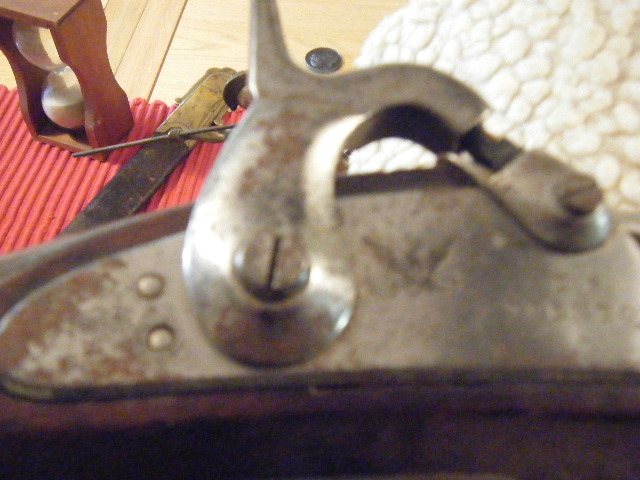

hi chaps, whats the best way of removing rust without wreaking the look of the lock. thanks, michael

Hi Michael,
I've often posted my philosophy that doing less is more. It this were mine I would take out the lock, put a layer of olive oil on it and gently rub with fine steel wool. Never touch the dry iron with steel wool! This way you will get a nice bright polish, with just a few gray stains remaining.

I rely on #0000 steel wool and 3-in-1 oil, working just the area with the 'active' rust with just enough pressure to remove it. I then wipe it dry with a paper towel, wet another one with 3-in-1, and wipe the treated area until I see no more red on the paper towel. Sometimes I have to revisit the spot with the #0000 (again in conjunction with the 3-in-1) and repeat the process.
#0000 steel wool is equivalent to somewhere between 600-grit and 1000-grit sandpaper, so with oil your safe. You would have to try really, really hard to remove patina.

Given the form of patina varies from medium to medium, in the context of steel, I would consider 'patina' to be the stabilized, i.e., non-active rust (black/brown vs. the red/brown of active rust).
However, I never remove patina... at least not intentionally! The "try really, really hard" comment was meant tongue-in-cheek, as it would take a lot of pressure and elbow grease to remove stable patina with #0000 (which is why I consider it safe ).
I like olive oil as well, BTW. I think I revert to the 3-in-1 as much out of habit as for anything else, as I prefer like the "feel" of a thinner, lower viscosity liquid. Personal preference I guess...

Salaams, Try using aluminium foil ~ use as you would use sandpaper. Fold a few pieces up as it falls apart quickly. This works at sub atomic level and though it requires a lot of rubbing it does work. Over on the Ethnographic forum we have a great thread on restoration which hopefully and with more support could become a "Sticky" In my estimation rust has to be the big thing collectors want to eradicate and remove. Did you try dropping the lock into coke cola for a day or two? 0000 grain will shift it also. Olive oil is good as is Sewing Machine or gun oil. For worse rust lemon salt is good. Best preservation afterwards has to be antique preservation wax.(Renaissance Wax)
