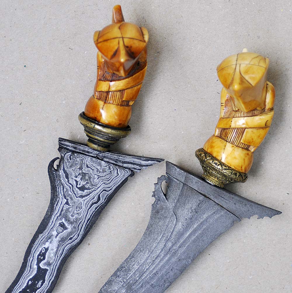

Really want to know, whether these are of Riau-Bugis kerises and hilts. The two hilts are of "gigi duyung" (dugong tusk) with certain sign of (according to one of my Bugis mentor) "temu ure" along the hilts. I can't even explain, what "temu ure" is, and what is the philosophy on the "ure" (or "urat" in Bahasa Indonesia)...

Hello Ganja,
this could be Peninsula keris as well, look here: http://www.vikingsword.com/vb/showth...ight=peninsula
The "temu ure" are the small black dots along a line which are normally typical for hippo ivory which I think to see at your both hilts as well so I think that it isn't ivory from dugong but from hippo.
Others with more knowledge than I am will be able to tell you more about the origin of this both nice keris. Do they have both a sarung? Can you post pictures when they are inside?
