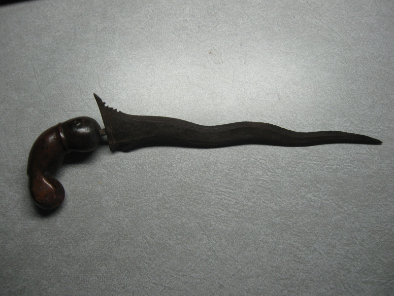

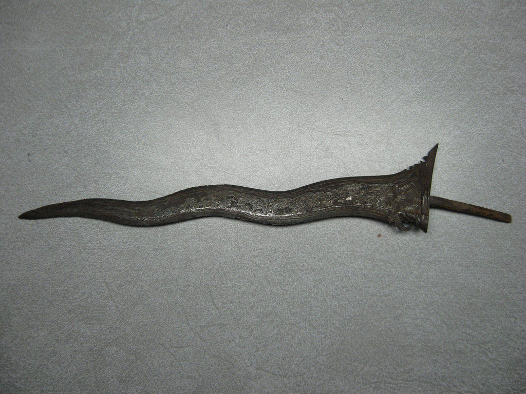

Hi,
I have had this keris for a few years. I bought it an estate sale and have always wanted to know more about where it came from. All I know about it is that the gentleman whose estate I purchased it from was stationed in the south pacific during WWII. Any help you could provide as to its possible age or origin would be great. I know that is in rough shape and has little collectable value, but I think it is a neat piece and I would enjoy knowing more about it.
Thank you,
Matt

Welcome to the forum, Matt!

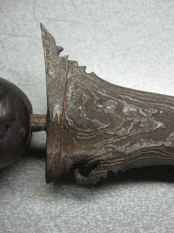

Not a royal heirloom piece but certainly looks like a genuine, antique keris from the Bugis-influenced sphere.

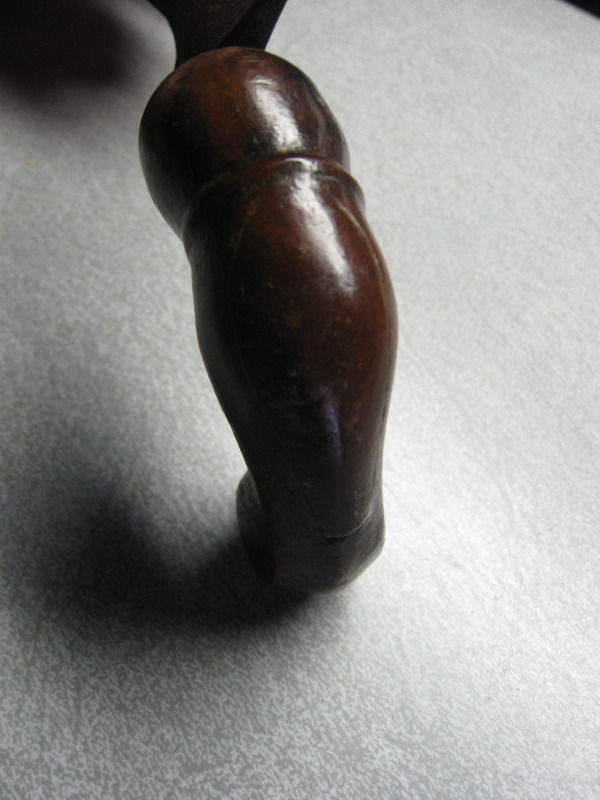

It will look better if you obtain a fitting pendokok/selut for it: a cup-shaped bronze/brass piece would suit the ensemble IMHO.

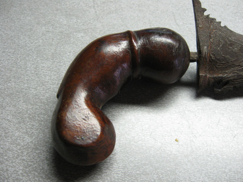

The hilt shows some wear and may be a village version. I've seen hilts of similar shape being referred to the Riau/straits region but I may overlook details hinting at another origin.
All in all a nice piece of history and certainly a very decent start for a keris collection!

Thank you kai, the hilt does look similar to pictures of other Riau hilts.
Would this blade have been something that was made for the tourist trade and was sold to the gentleman during the war? Or could it be something older that he picked up while he was there? I always like to imagine the kind of history a genuine object has, and a souvenir piece doesn't spark my imagination much!

Doubtful it is a keris made to sell to tourists Matt .

Hello Matt,
It's certainly not the most common type from that area.

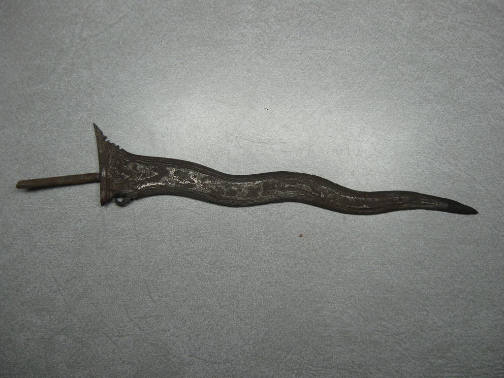

Can the hilt be carefully removed? Maybe try to take a pic of the blade without shadow - this will allow the shape to be seen better.
Nah, not a tourist piece. If picked up during the WW2 period, both hilt and, especially, blade were likely decades old.

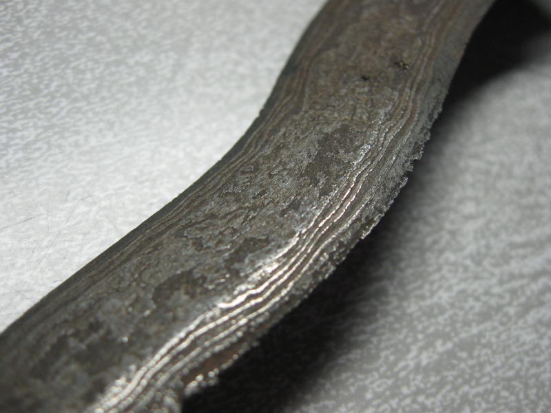

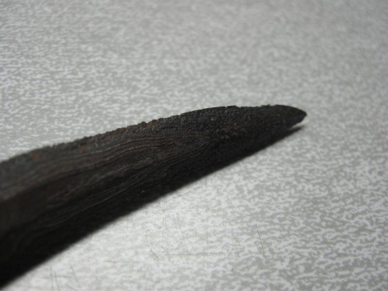

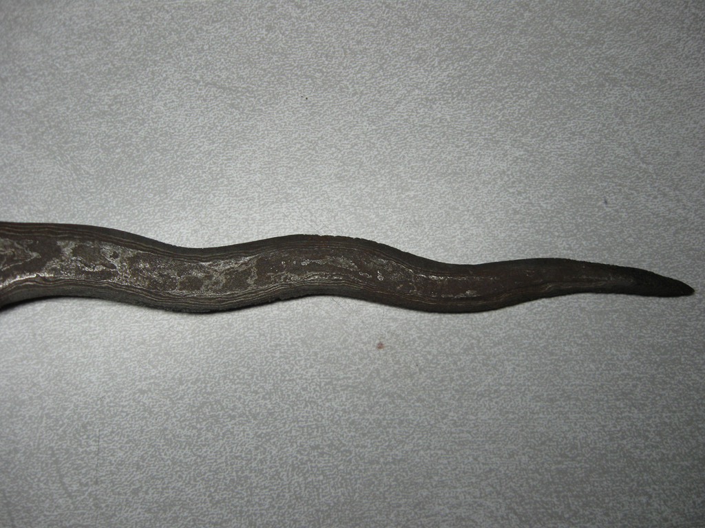

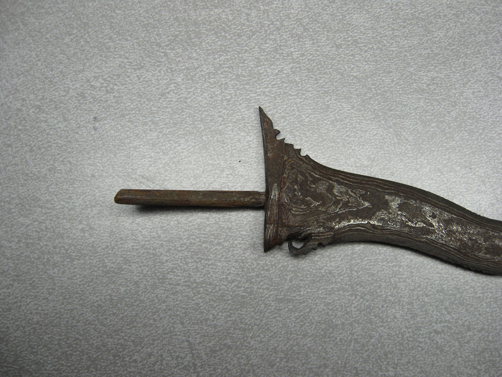

Here are some pictures of the blade flat on the table with no shadow. I forgot to mention that the overall length of the blade is just under 11" (just over 27.5 cm).
