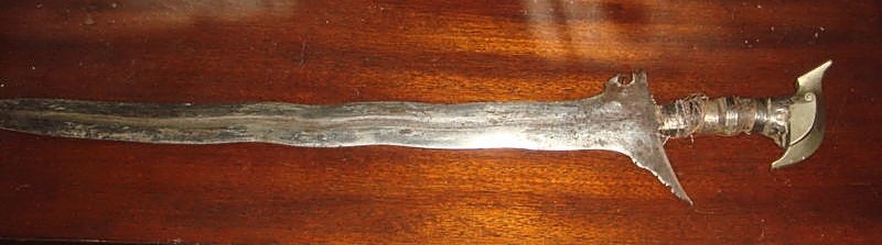

Here is the last piece in the small collection bought for me by my wife, a Kris with what could be either a low grade silver or nickel pommel. It seems to be the only piece from this collection that did not fare well during storage. The hilt itself is loose from the blade and it is missing the asang-asang, I just happen to have an old beat up silver spoon that has volunteered to be made into a replacement. The cord wrap on the hilt is in tatters and the throat piece on the scabbard is also broken. Fortunately the brake is under the brass band and will not be seen after the repair has been made. It looks to me that the blade might have become lodged in the scabbard and someone decided to try to remove it by pure force, or it could have been stepped on at some point in time. Either way there is quite a bit of damage. The single fullered blade is 21-5/8 inches in length. These picture are what it looked like (with the hilt slipped back on in the wrong direction ) when it arrived. At the present time the hilt has been dismantled and it is being readied for new cord wrapping and the broken pieces of the scabbard are being glued back together. I will post pictures of it when it is back in one piece. Comments and opinions on this as always are greatly appreciated.
The grip bands appear to be silver (maybe except one) - given the distinct patina, I'd guess at white brass rather than a low silver alloy for the pommel. Perferably have this verified on a hidden surface before reassembling the hilt though.
Doesn't look too bad - you'll remember some threads of much more wrecked kris/keris that looked really nice after some careful restoration.
Looks promising - also late 19th c. I'd guess. If you're going to etch some of your Moro pieces, work on this removed blade first (much easier and more forgiving). I'd recommend staining with diluted vinegar which results in a more subdued contrast than ferric chloride but is practically identical to the traditional "coconut water" (i. e. coconut juice gone sour).
BTW, what's the length of the other kris? Any chances that the scabbards got swapped? Regarding style and age, I believe this scabbard would suit the kris with ivory pommel very well and vice versa! Some linseed oil will help protecting the wood and bring out any chatoyance, especially with the nice crosspiece.
Please take pics of the disassembled pieces. If the old cord is not long/stable enough to redo the wrapping, please store it separately for later analysis rather than tossing it out.

Kai, the pommel of this piece was covered in lacquer when the picture was taken and might account for the strange color and lack of patina It was after removing this protective coating and showing the true color of the metal that I made the statement that it might be either low grade silver or nickel. I never gave a thought to the possibility of it being made of white brass like you have suggested but testing will tell. The bands on the other hand are a mixture. While the two main bands, the one next to the hilt and the one next to the pommel and the two narrower bands are silver plated copper the other band that I believe was centrally located on the hilt is silver. Due to the blade length there is no possibility that the scabbards were ever swapped by accident. I have hand rubbed the wood of the scabbard with linseed oil a couple of times now and will continue with this until the wood is re-hydrated and with luck it will help restore some of the color and bring out the grain of the wood. I do plan on etching this blade in the manor that you suggested to bring out any pattern it might have. Unfortunately the original cord is nowhere rear long enough to reuse in the restoration. Being the pack rat that I am I would never have thought to throw away the original cord as it could possibly be used in some future restoration project. Again my thanks to you for all your help and suggestions on the restoration of this piece. I will be posting pictures of my progress in the restoration in hopes that by doing it in stages that if I make any mistakes in my attempt someone will point it out before I do any permanent damage.
Pepperskull, thank you for your kind words about this Kris. I feel very fortunate to have acquired it in the manor that I did regardless of the condition it is in at the present time.
Jose, Thank you again for all the help you have offered me on this and all the other items that I have posted over the years and for the possible place of origin of this piece. I am starting to believe that this Kris as well as all of the other items in this collection could possibly be of Sulu origin. As far as the clamps are concerned I can find no evidence of it ever having more than the one clamp. After removing the bands and what was left of the cord wrapping on the hilt I found that the anchor for the clamp is set into an inset in the wood and that there is no matching inset on the other side of the hilt to accommodate another anchor. There is also no tell tale shadow on the blade to suggest to me that it ever had two clamps but I could be totally wrong in my assessment.
