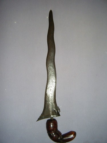

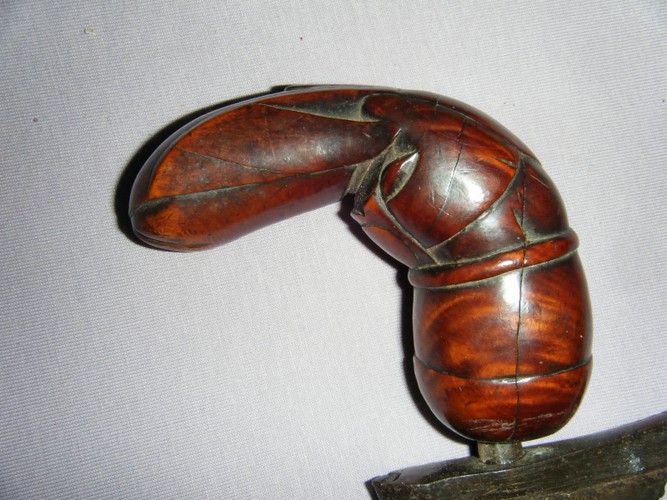

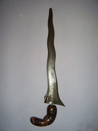

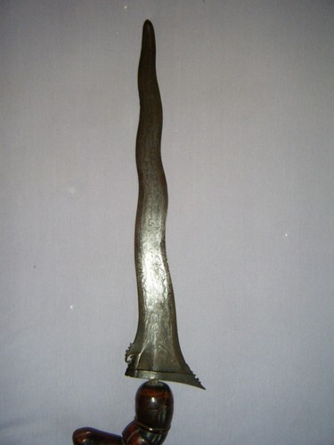

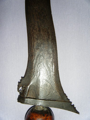

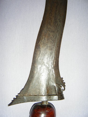

I have bought some time ago this old Bugis blade with 7 luk. Since I think this blade is worth to get a "house" I looked around what I have. I am unsure if the sheath and hilt is fittingly. Here first the pictures from the blade.

Hi Sajen,
From the sheath and blade, looks like a Sumatran Bugis keris.
I've always doubted the age of the full silver sheath Bugis kerises. I thought they were a Javanese manufacture.

Old 26th June 2011, 04:39 PM   #5
Originally Posted by BluErf
Hi Sajen,
What you need is a sheath like this:
Hello Kai Wee,
thank you very much, your knowledge in this area is welcome.
I get both not together, the sheath from silver and hilt is already long in my hands. The blade I bought recently. It has my feeling also that the blade is Sumatran Bugis, but only from the shape of the hilt I have had this feeling.
Of course I can't say for sure that the sheath is old but I get it heavily patinated with this poor blade. And what I am able to say is that I have a second keris with silver sheath (gilded) where I am sure that it have a good age. But I have no knowledge if there have been sheath's like this.
But what have been my main interest was if blade and sheath are matching and I understand from your comment that you don't think so.
Thank you,
